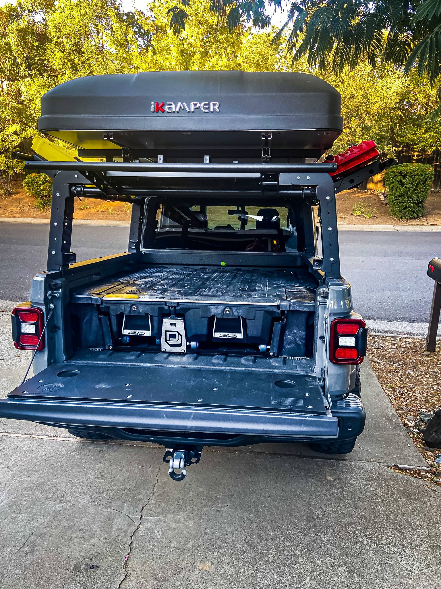

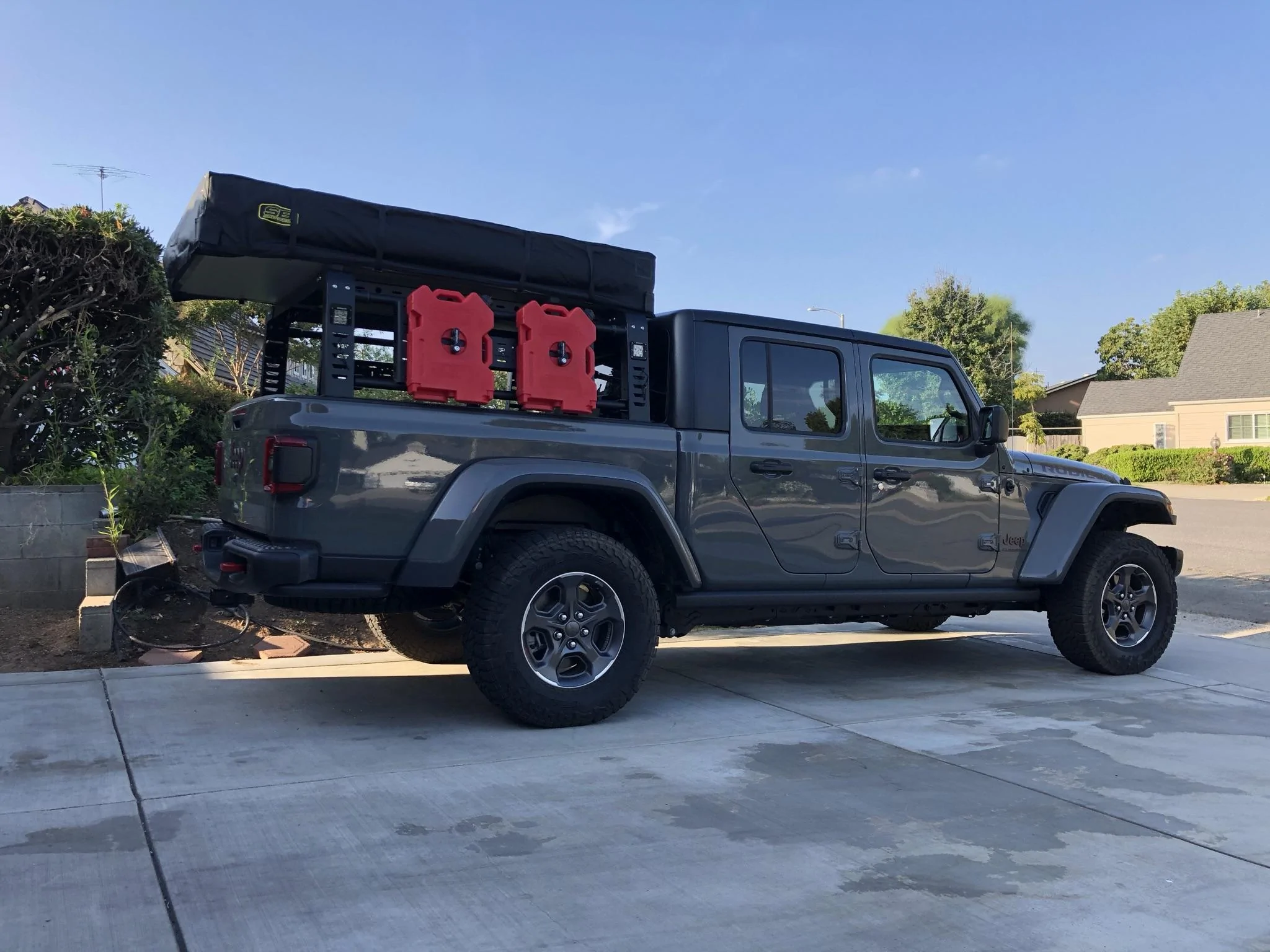

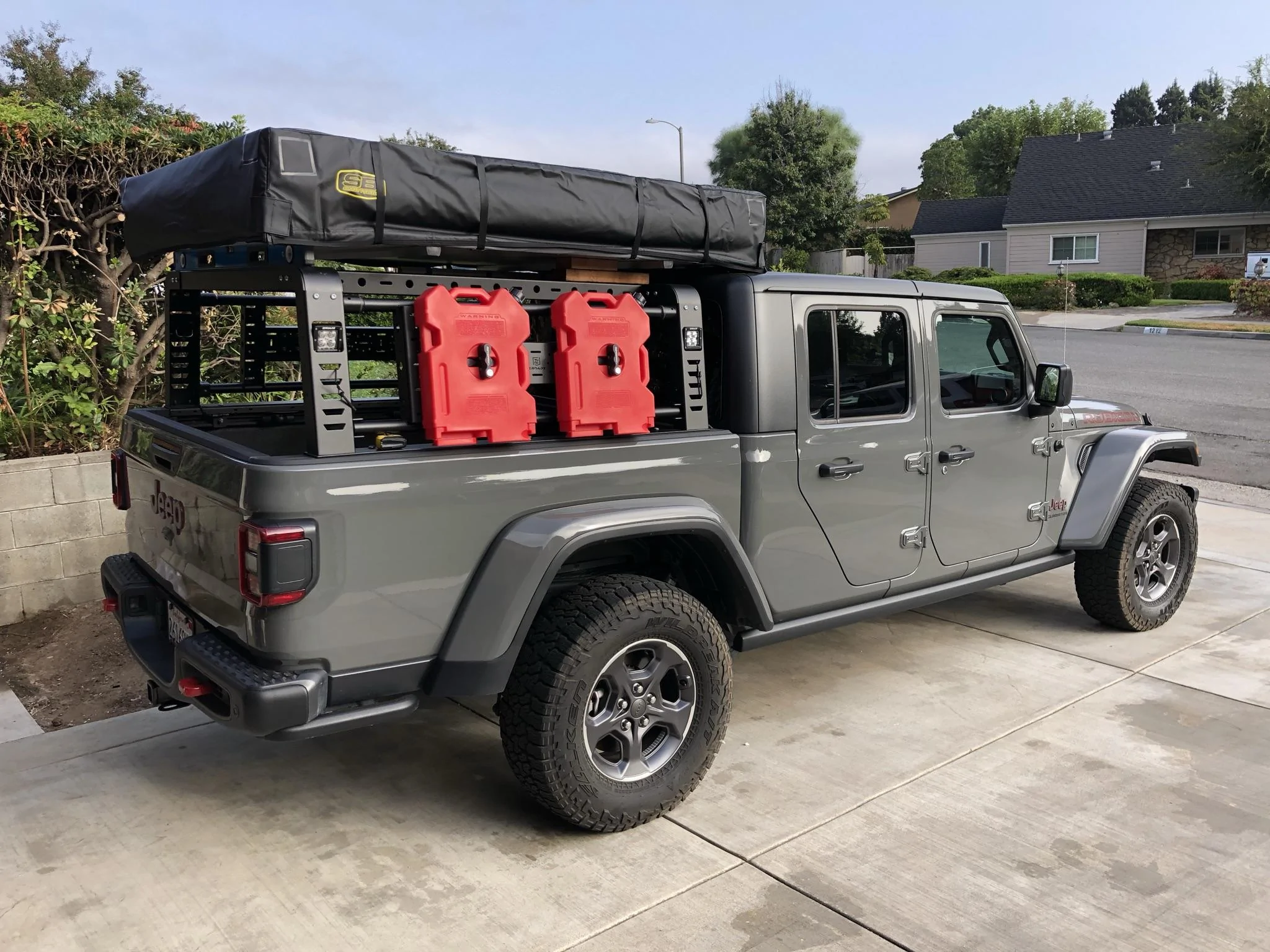

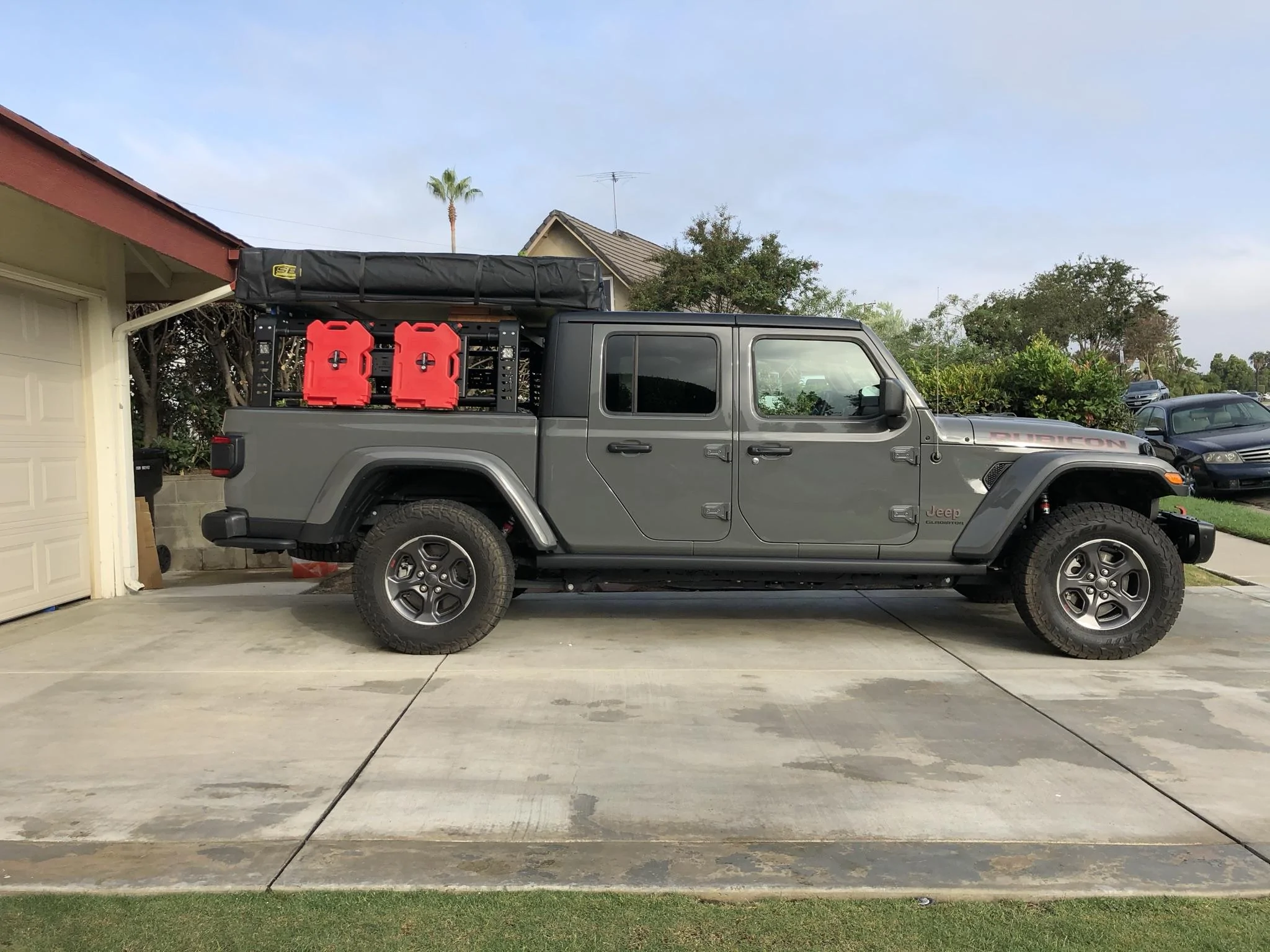

I had the same problem with my smittybuilt XL RRT. I hated the way the tent hangs off the back of the truck. I contacted them about making something to address it and then they made the cross bar accessory that is sold separately to raise the height. Not I’m able to slide the tent slightly over the cab. It’s a pretty heavy duty crossbar. Here is some before and after
Jeep Gladiator ZroadZ Rack 9841F9AF-B1CC-4CB9-8487-C635BEAEC325
Jeep Gladiator ZroadZ Rack A57B3028-9832-4C2F-9748-37C69EA861BB
Jeep Gladiator ZroadZ Rack 7D427305-F829-48ED-A191-D85725BFE8BF
Jeep Gladiator ZroadZ Rack 33D9057D-071C-4021-BA34-43E3D4336C91

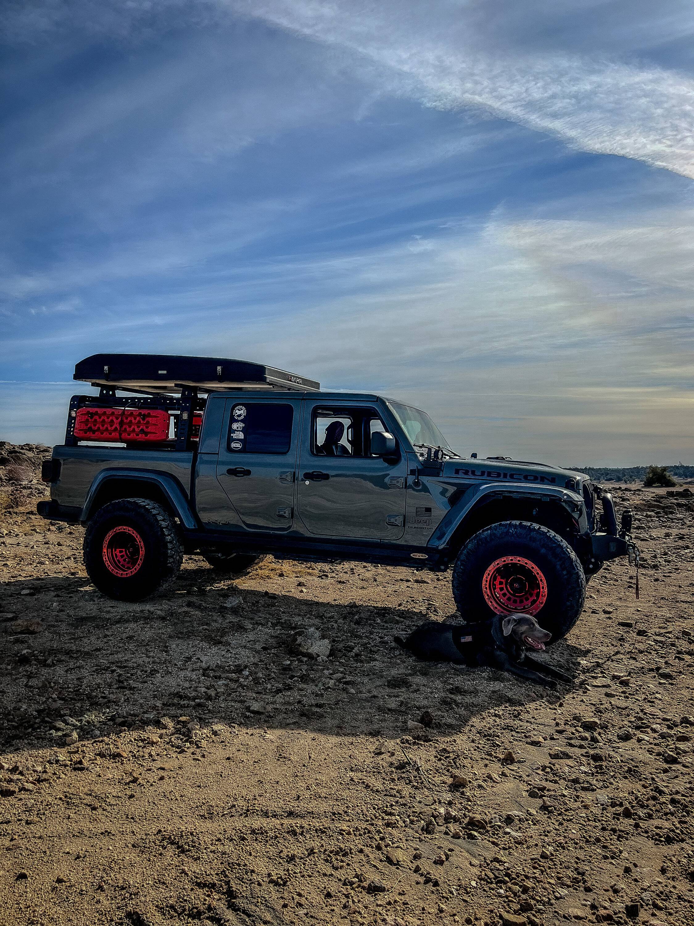

Love my ZroadZ rack.

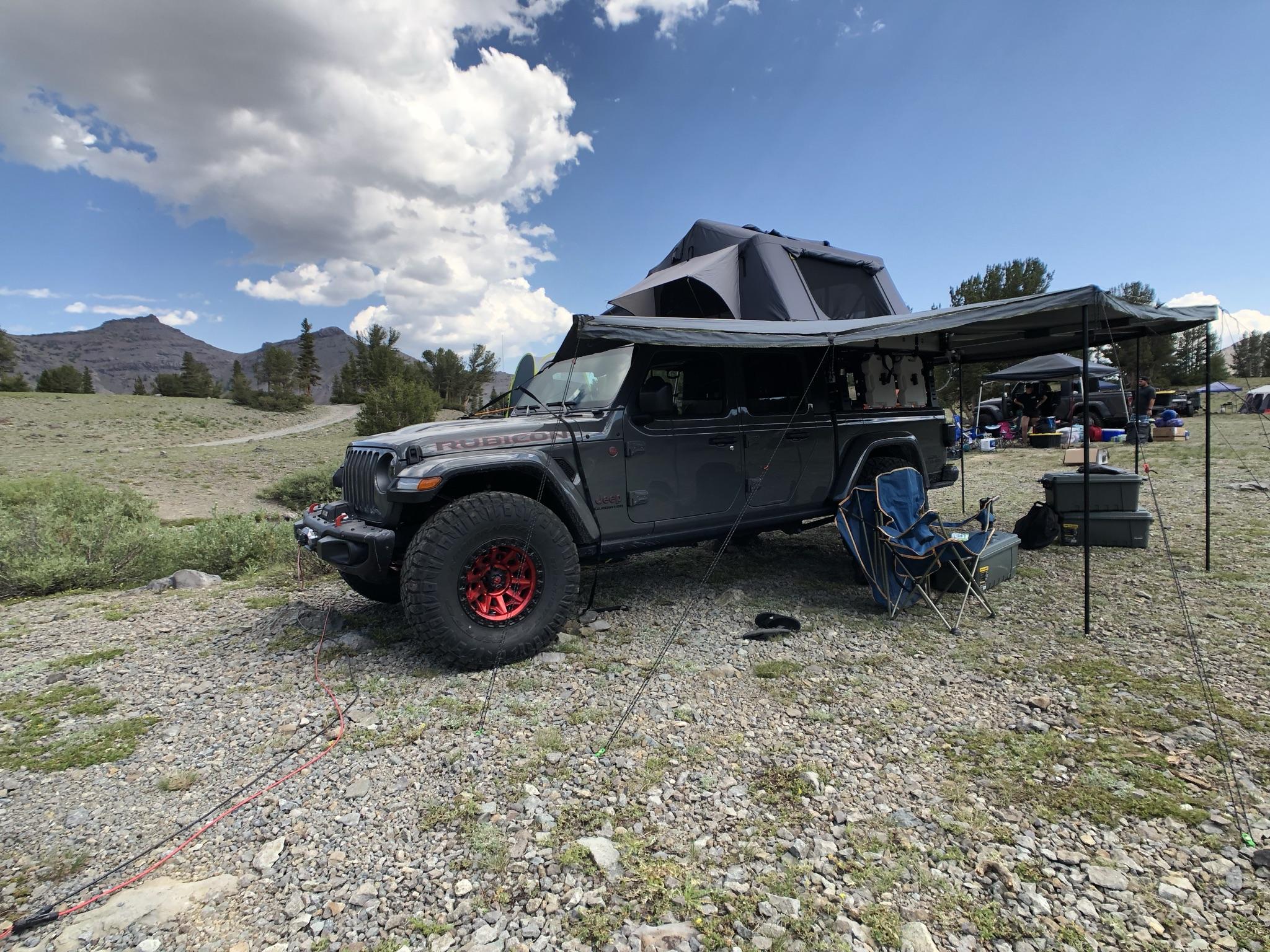

I'm running a CVT Mt Hood RTT on custom 3" spacers
Jeep Gladiator ZroadZ Rack IMG_20230422_164345_452
Jeep Gladiator ZroadZ Rack IMG_20230420_211249_870

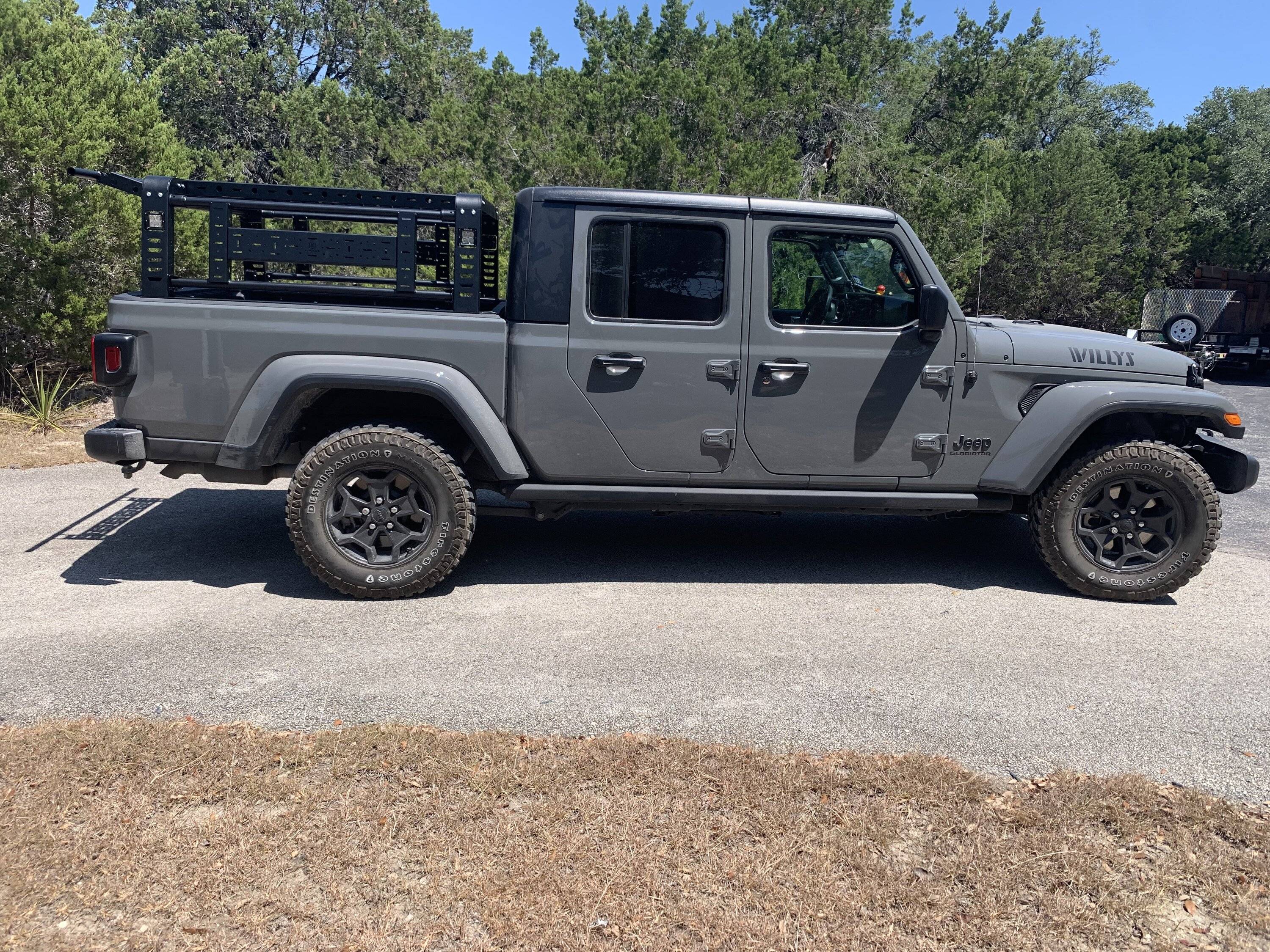

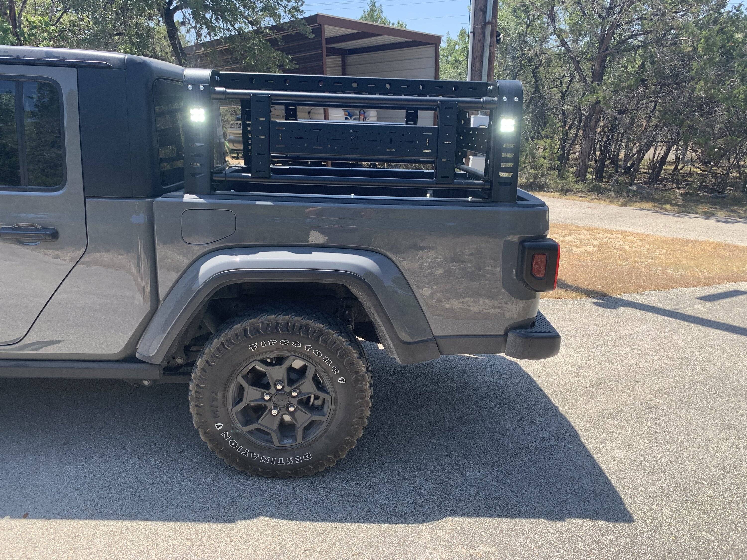

I'm happy with my ZROADZ rack (3 gates). I don't have the trail rails so my rack mounts to the bed with bolt on clamps. My rear gate latch holes didn't line up (the pre drilled holes weren't through the center of the tube), but it wasn't anything that the drill press couldn't fix although taking the rack apart again was less fun than putting it together. I'm looking forward to adding an awning in the future. Thanks for the great ideas on this thread!
Jeep Gladiator ZroadZ Rack IMG_6172
Jeep Gladiator ZroadZ Rack IMG_6171

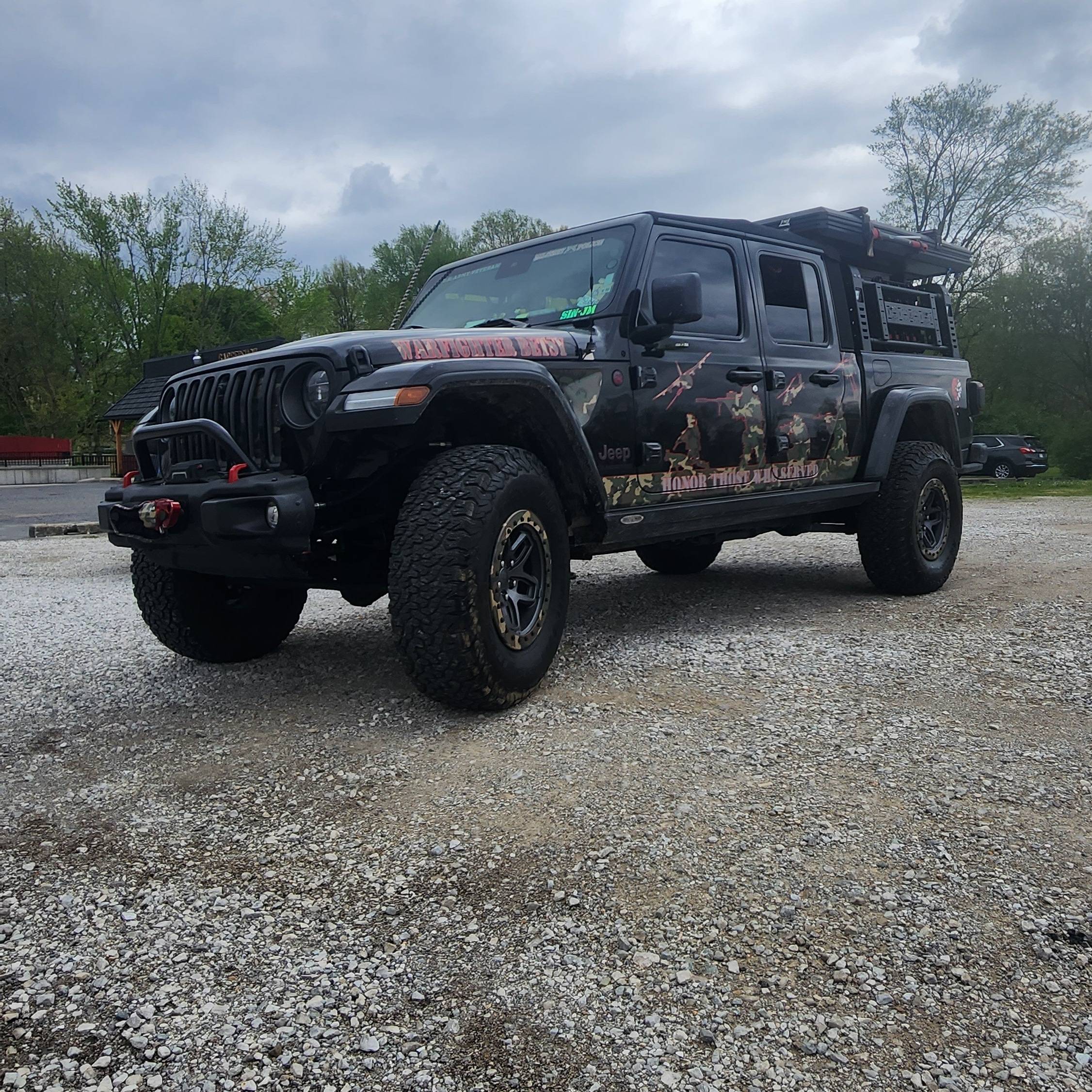

Little Update. I finally got the rear gate that was missing from mine.
I have upgraded to a Tuff Stuff Alpha 2 and a Tuff Stuff 270 XL awning.
