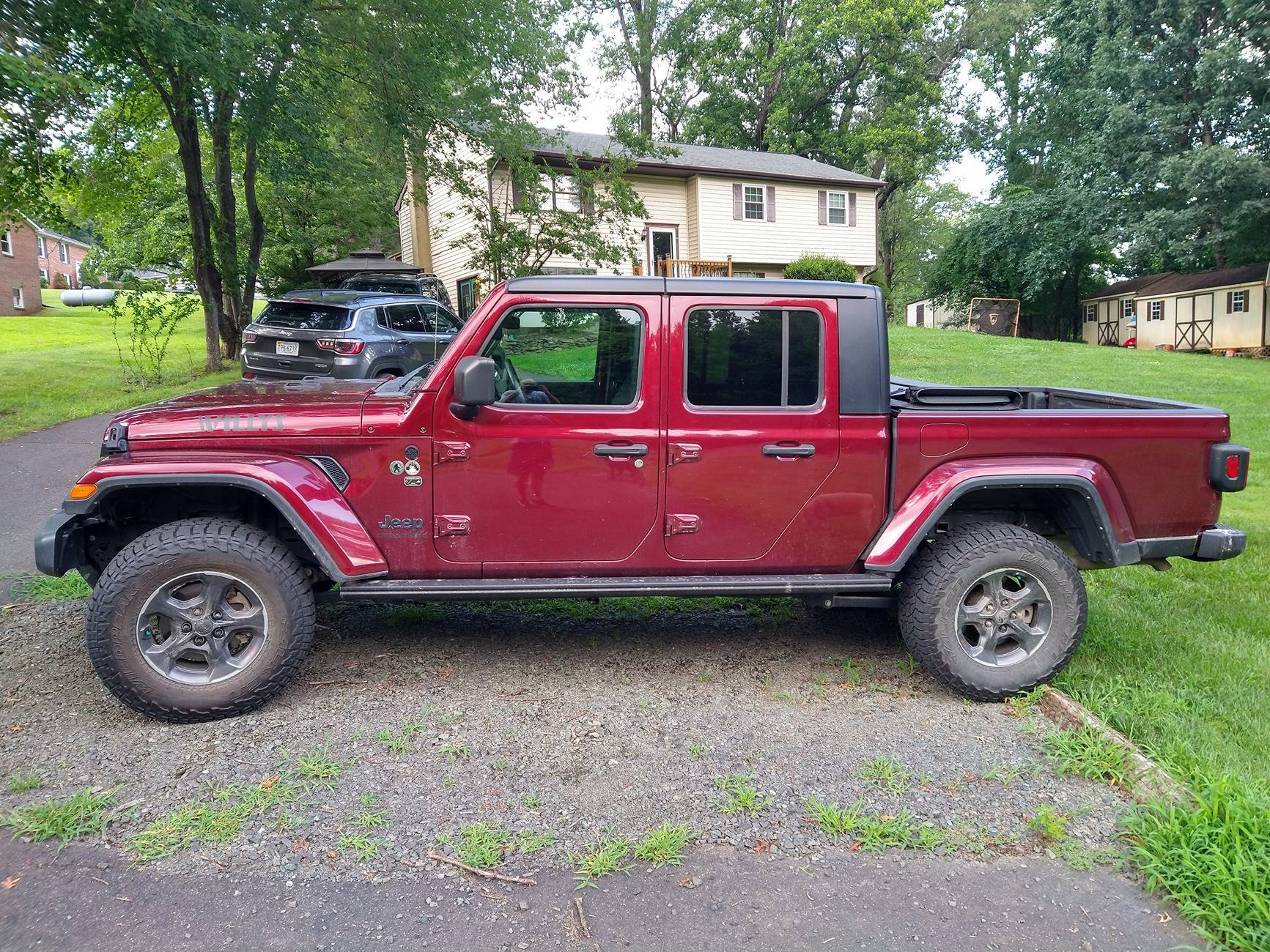

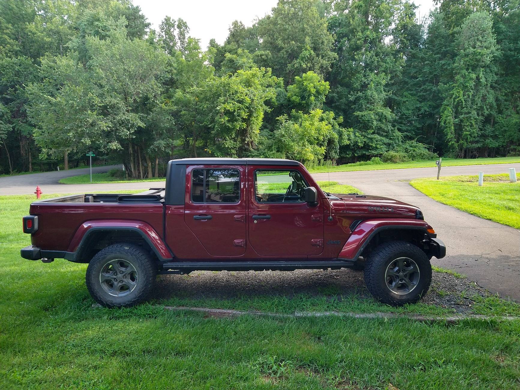

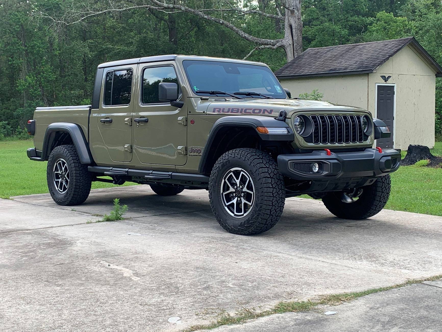

Awesome! Can you post photos?
Will do. I updated my results. After driving several hundred miles over the weekend, I did lose 1/4" in the front due to the suspension settling, but I'm still very pleased.

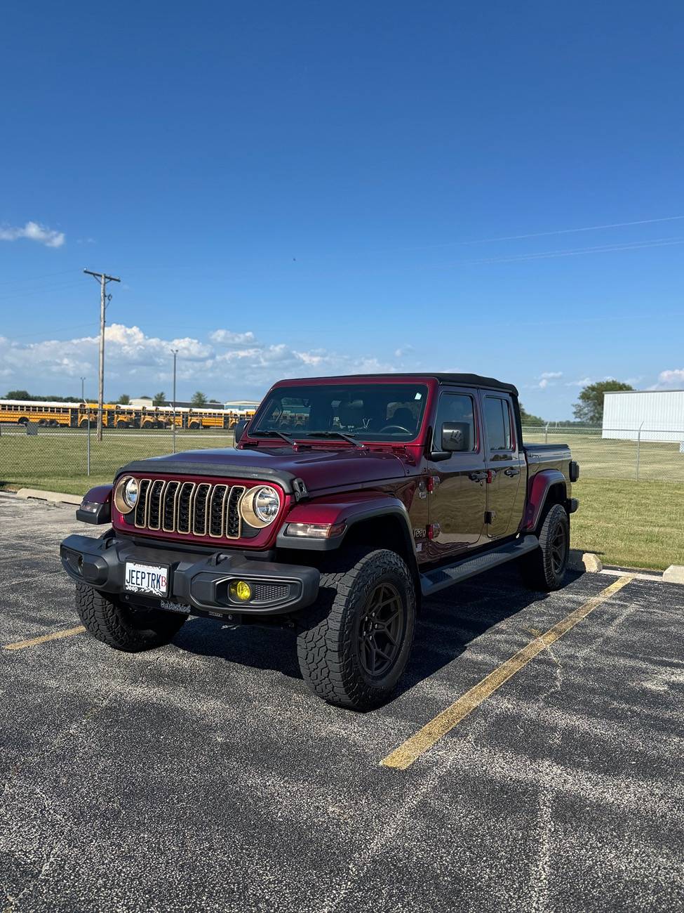

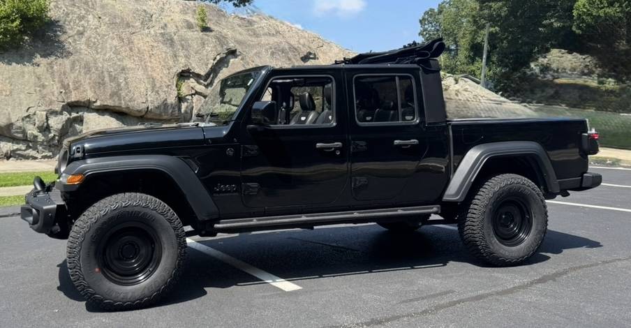

I plan on putting 1.5 TF spacer and 0.75 spacer on the rear of my JT - I'd like to also swap out to Rubicon springs as well, are there other needed parts? Do you need to replace the stock shocks or can I do that at a later date?
Nope. Stock shocks will be fine. I did the same thing and the only other thing I added was the Mopar longer LCAs from the Mopar 2" lift kit. They are cheap and honestly my Gladiator rides better than stock now.
68322798AA These LCA's work?
put the springs, spacers, mopar lift lower control arms. Replace shocks when you’re ready; price point option here being bilstein 5100s
