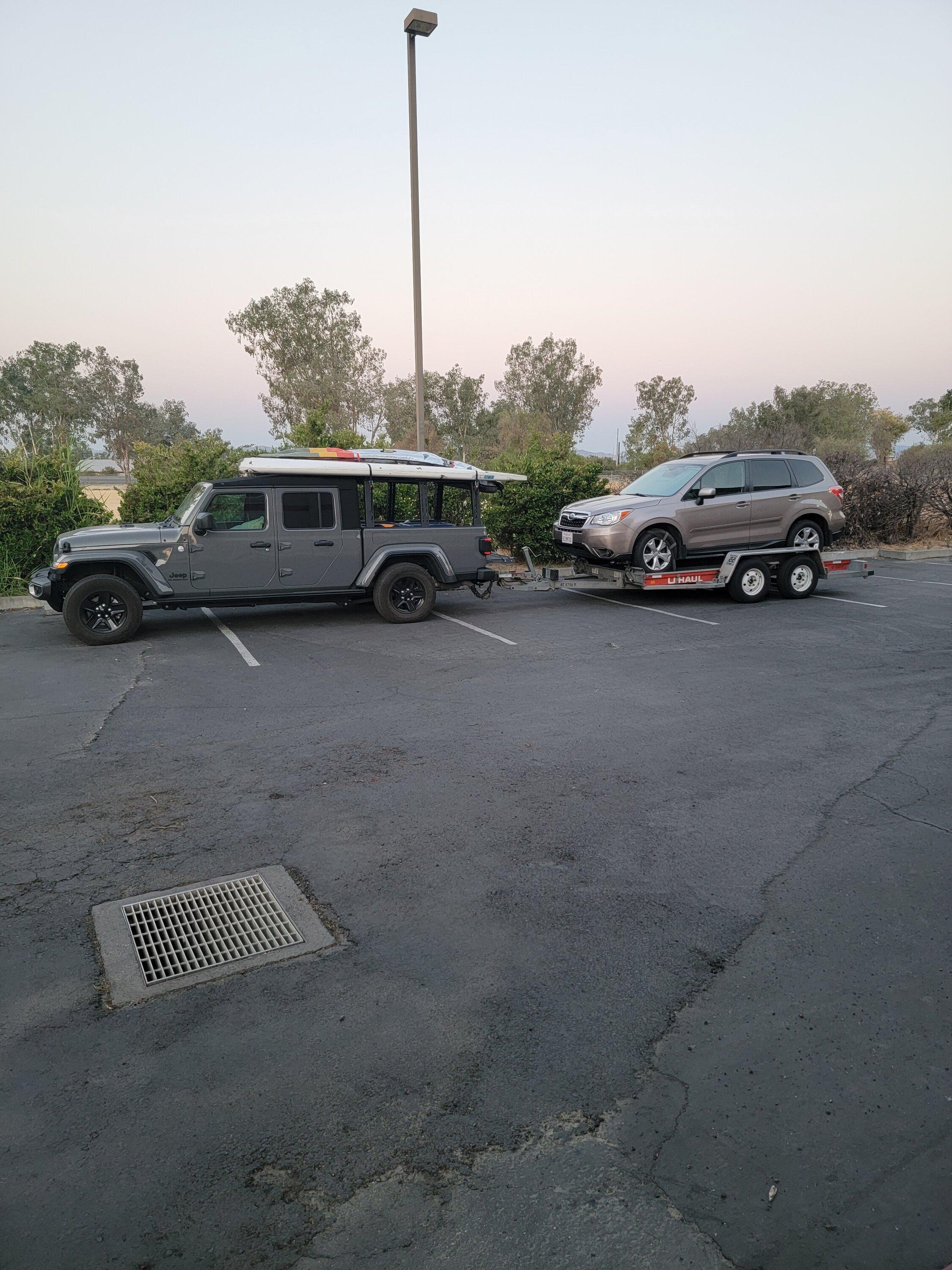

I pulled 6500lbs. from San Diego to Washington State. I kept the speed at 62mph. The 3.6 got 14 mpg. The squat was obvious but she drove straight and I never felt uncomfortable. I don't care to go 7650 in my max tow though.

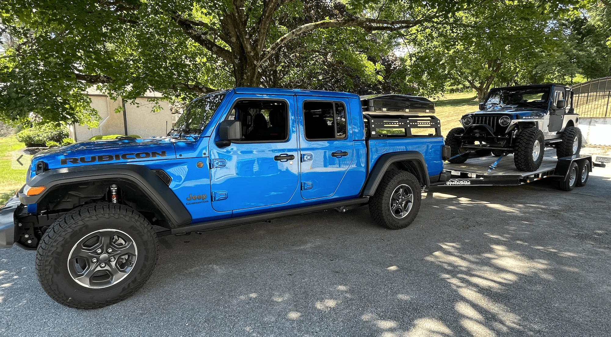

That sounds like my experience towing my TJ. Every time I do it I always get exactly 13.7mpg (non uhaul trailer, it feels a lot better with a brake controller than surge type.)

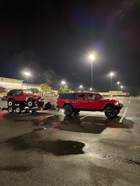

I don't use manual mode too often and get around 11 or so towing my TJ, I have an Aliner (small camper) that I tow as well I'll get 14ish with that.
Jeep Gladiator 1,516 miles towing with my Gladiator, 11.2mpg IMG_1784
Holy cow your rear end was squished.
I get 13MPG when I tow the TJ
Jeep Gladiator 1,516 miles towing with my Gladiator, 11.2mpg 1667163069231
