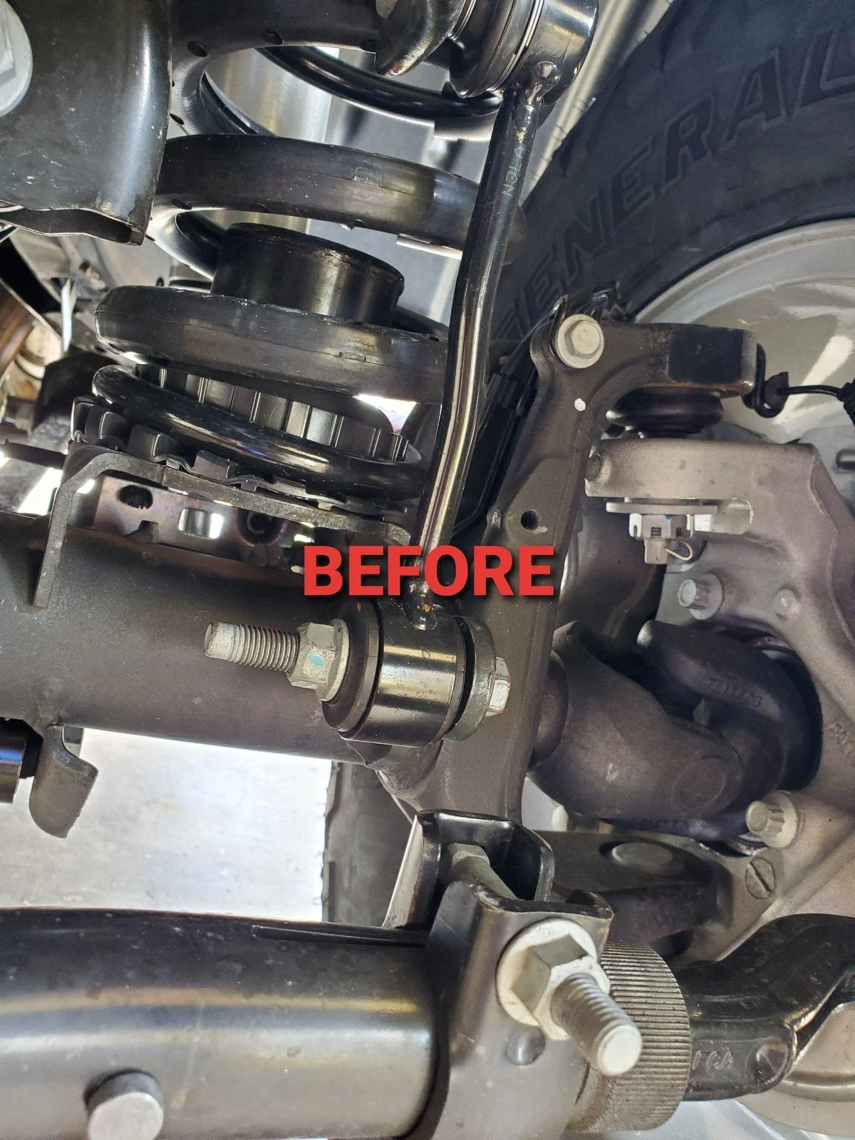

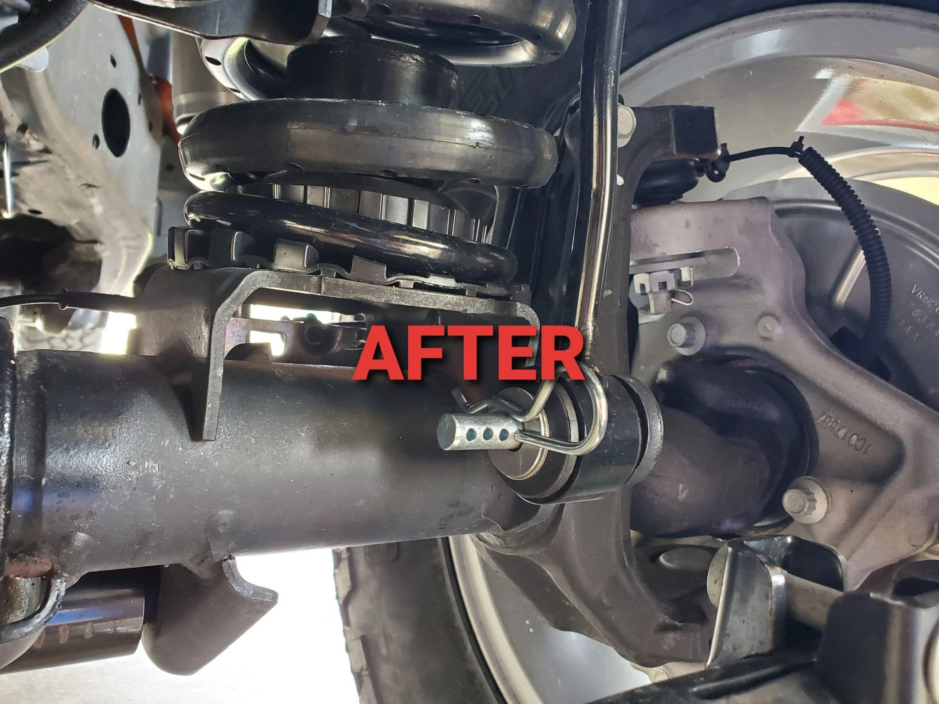

That pin isnt really designed to do that....
what needs to happen is to weld another tab to the axle so the pin goes through 2 holes..
Double shear vs single shear
I think since the factory bolt is using a single shear application, this pin should work decent as long as it's tight. I used the factory washer on both sides and spaced it so that it has no wiggle room like the factory sway bolt. It's held up fine for me so far.

Correct. it would have to be VERY tight.
Otherwise, it would start loosening up, and once that starts, it's downhill from there.
Looking at the application....what I would do...is keep the bottom mount stock, and change the link to a clevice type at the sway bar.
From there, you can use a pin like you have, or a pip pin - since it would be double shear at that point.
Only downside is that the links are attatched at the bottom and therefore need to be tied down somehow (a bungee or a zip tie) on the a arm to keep from flapping around.

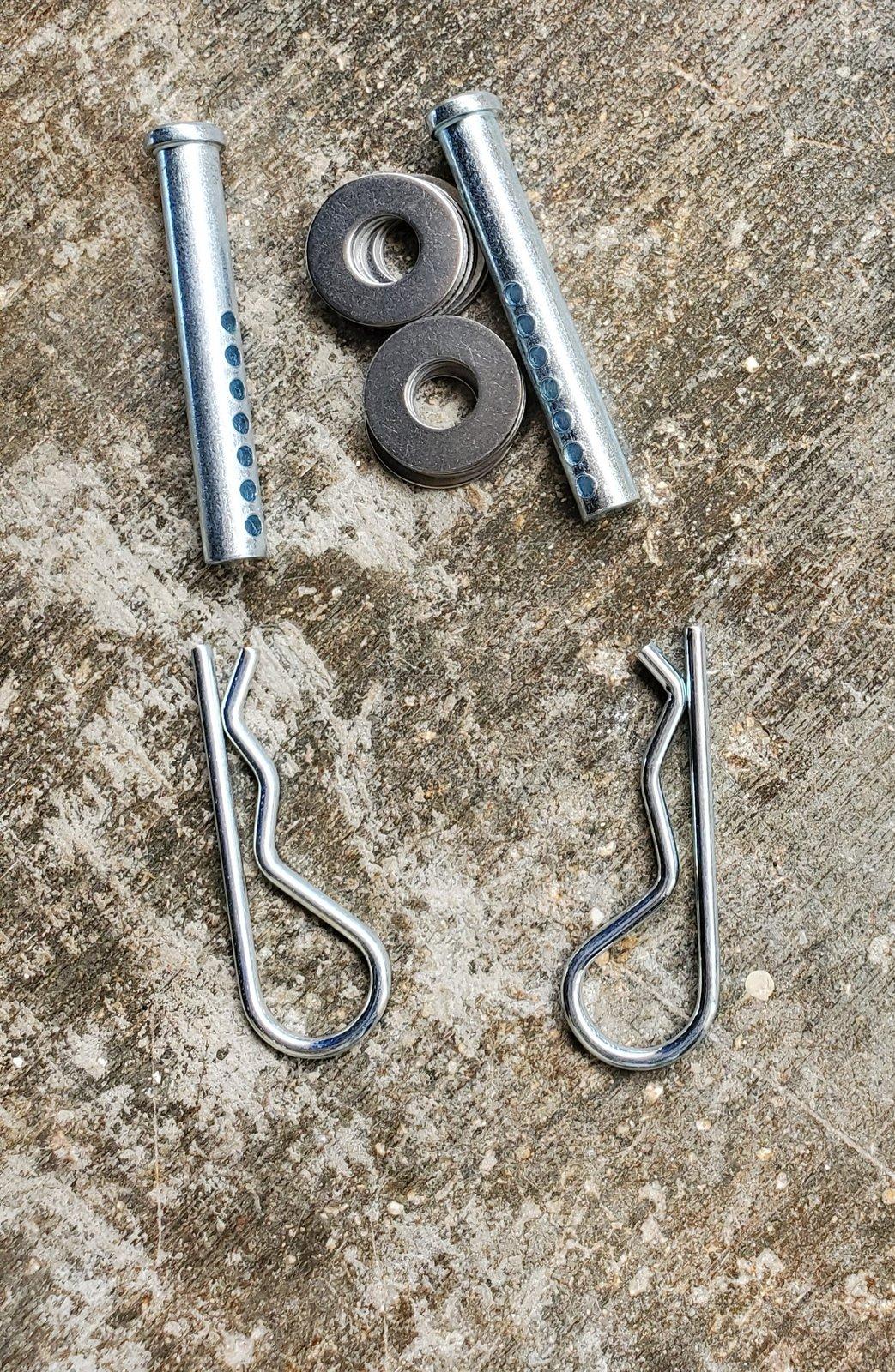

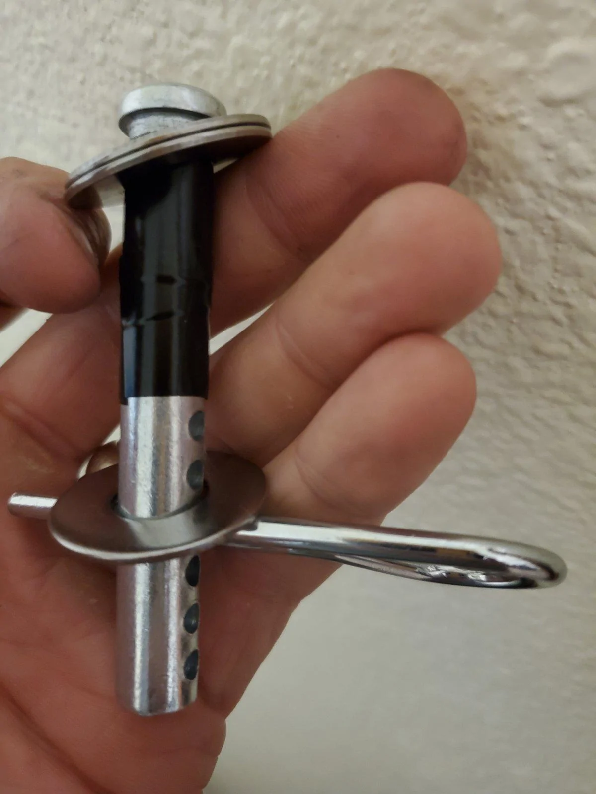

Here's how I used the clevis pin:
The day before I know I'm going off road, I switch the stock nuts/bolts with the pins.
At the trail I remove the pins. Before I head home I put them back in.
Finding level ground on trails is not easy sometimes so I have driven (slowly) to somewhere level where it is easier to put the pins back in. If perfectly level ground can not be found I can use a pry bar of some sort to move the sway bar enough to push the second pin in.
When I get home I replace the pins with the stock parts.
This way I don't wear them out or have to listen to them clank around when I'm on the road.

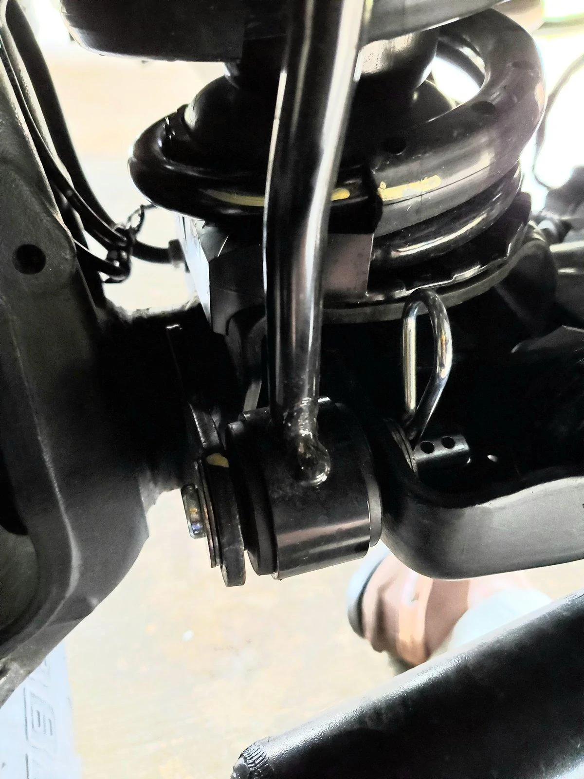

Lol, this isn't your YJ or my old TJ. The passenger side is double shear, it wont wobble, ever. Double shear is when the bolt or pin is supported by two points of the bolt. The driver side is being swapped out with a quick disconnect stud from rubicon express. So the orange justice quick disco 2.0 will be coming when I get the part. Still be better than a 200 dollar disco. Well because you made it yourself.
Another location to get that (mounting pin) at is a tractor supply or farming supply store. A other option is to use a shock mounting bolt. I should have added that when I read this way back.
