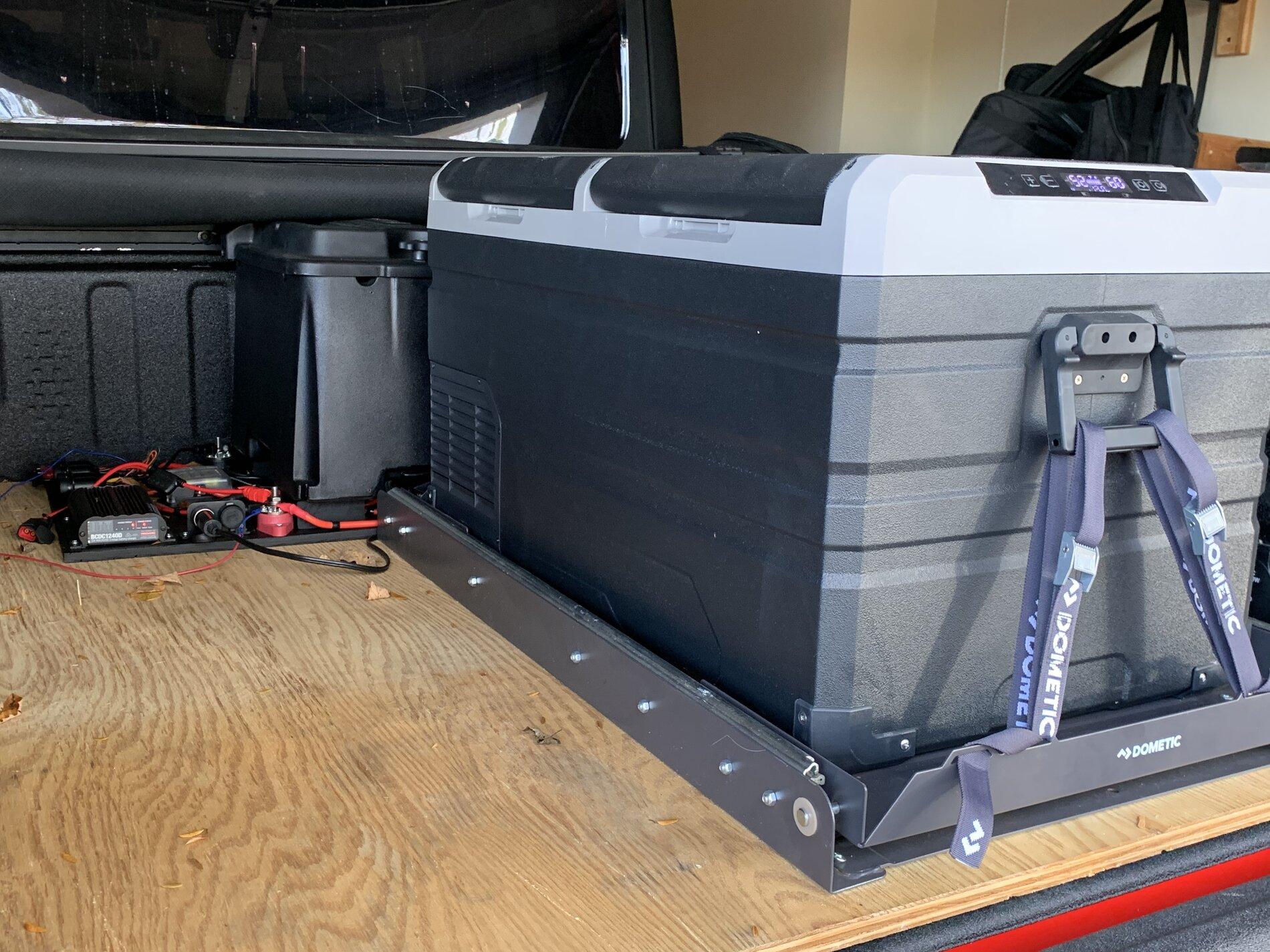

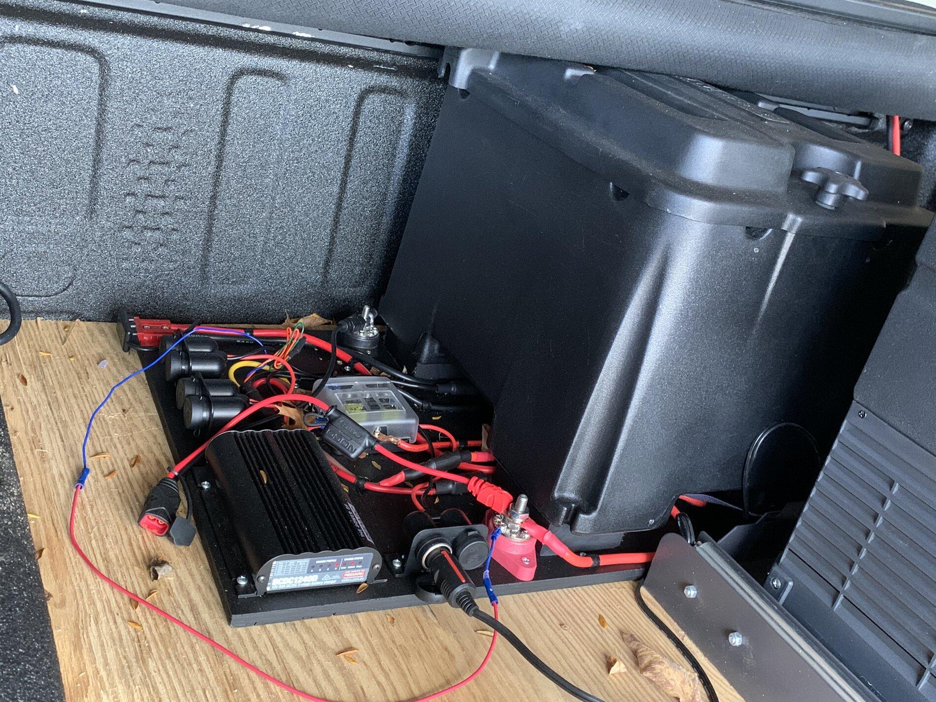

There are cheaper options than the RedArc but as a full timer I’d go with quality over price. Batteries matter too. If anyone can justify the cost of LiFePO4 system you can. Double the useable capacity at half the weight. My entire 200Ah setup weighs less than a single 100Ah lead acid battery. Plus I get to use all 200Ah rather than just half. My LiFePO4 batteries are rated at 3000 cycles at 90% original capacity. Not to mention that they power my fridge for a week without recharging.

Great setup wish I had that fridge
