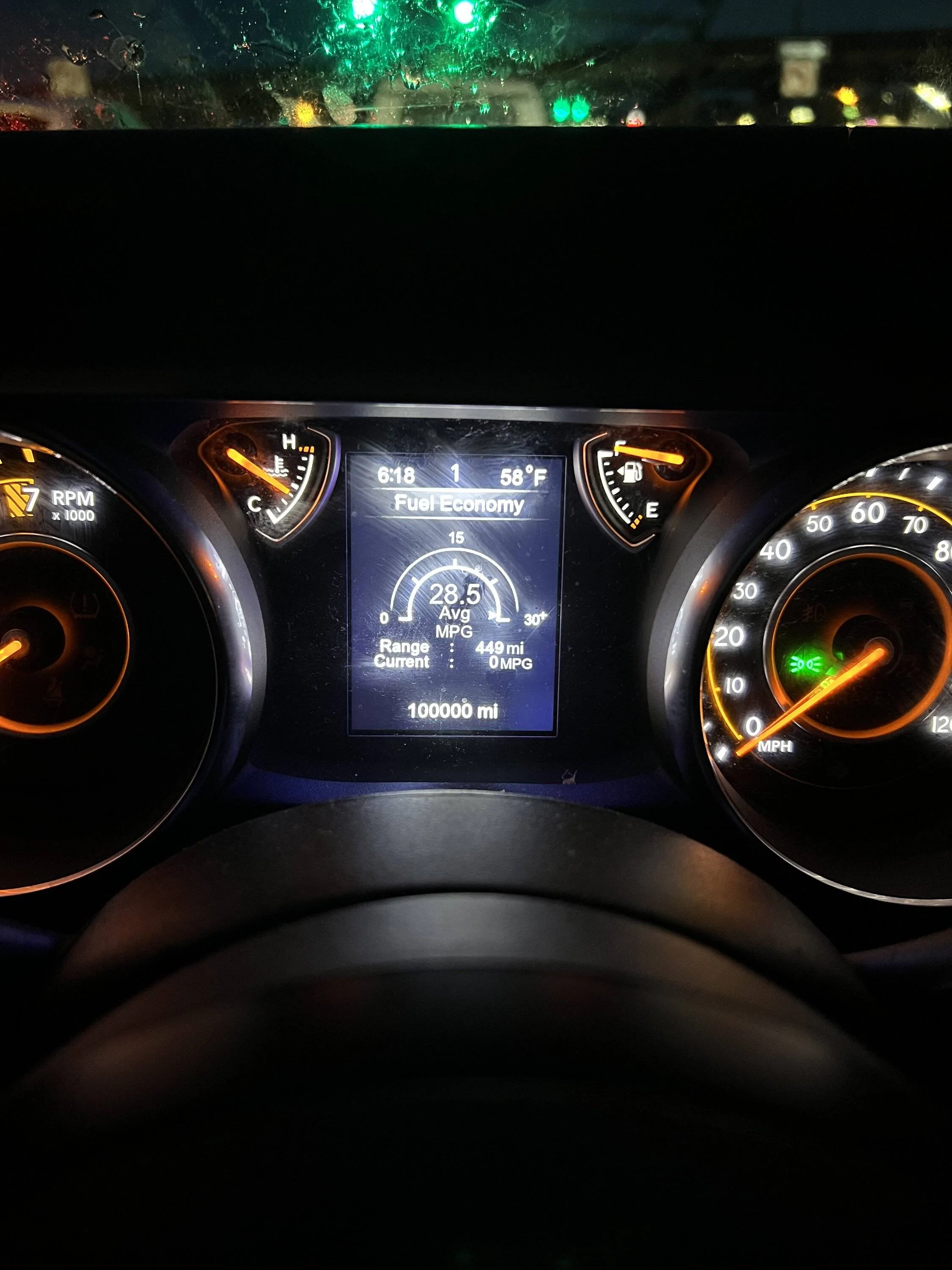

Jeep Gladiator 100,000 mile Gladiator review IMG_4540
2020 Sport S, she hit 100k today. I changed the auxiliary battery in February. Also, I had a leaking back window. I repair it with weatherstripping from the hardware store. The shocks are pretty tired so I plan to replace them and install a 2” lift soon. The majority of the miles are from my commute. ~ 140 miles daily.
