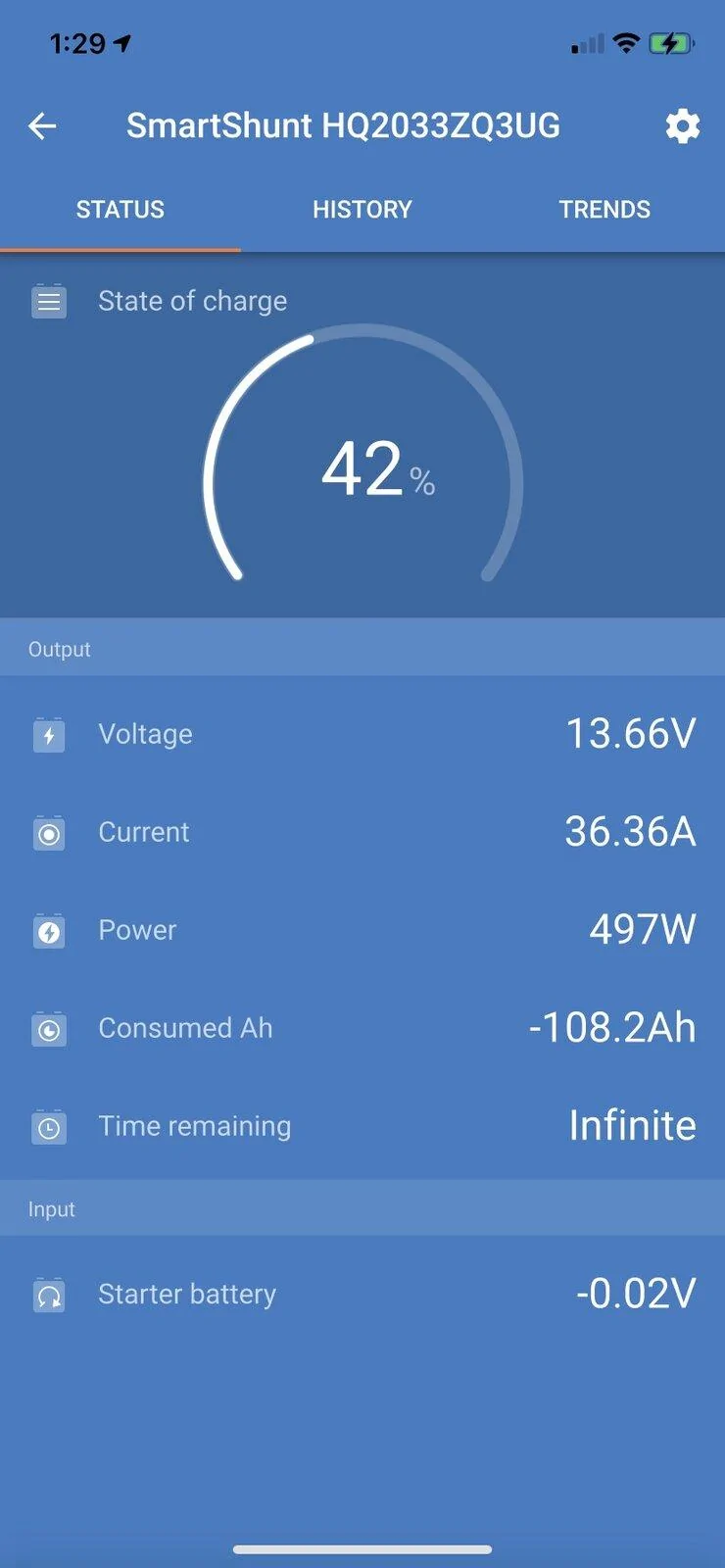

I may have a solution to help with your inverter not liking the variable voltage put out by the alternator. I have two 100ah LiFePO4 batteries in my bed powering my accessories and I have a RedArc BCDC40 to charge them. My alternator voltage can be at 12.5V but the RedArc conveys it to 14.4 to charge the batteries. My volt gauge will show 12.5V and the Victron on my battery setup will show 14.4V and 35A going into the batteries. The attached photo shows it in action. The reading is for battery outage not input
Great info I have already saved there site to my home screen and will be adding that to it thank you
I was looking into a normal isolator but these look way better
