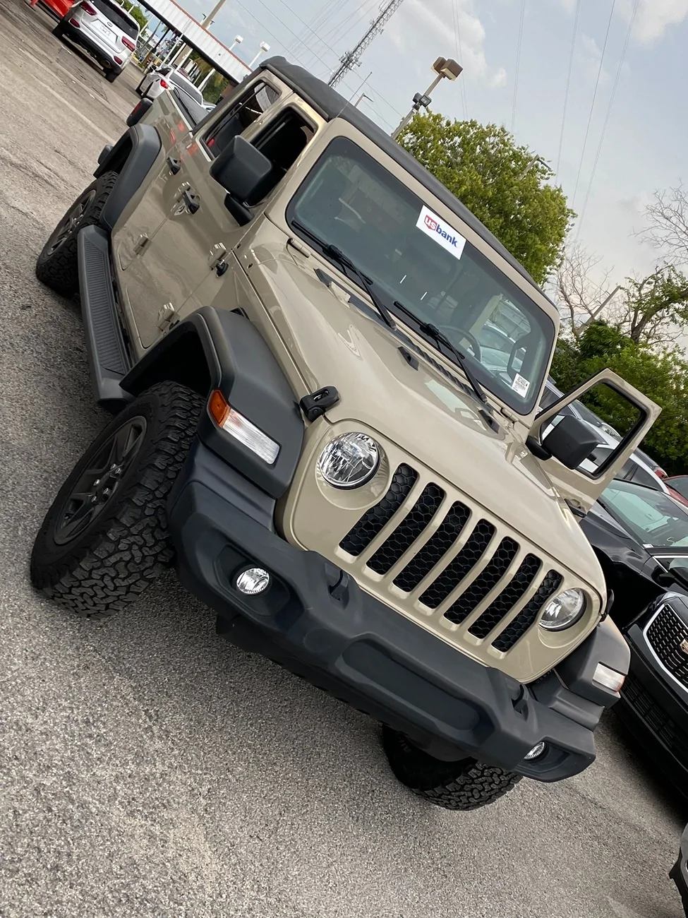

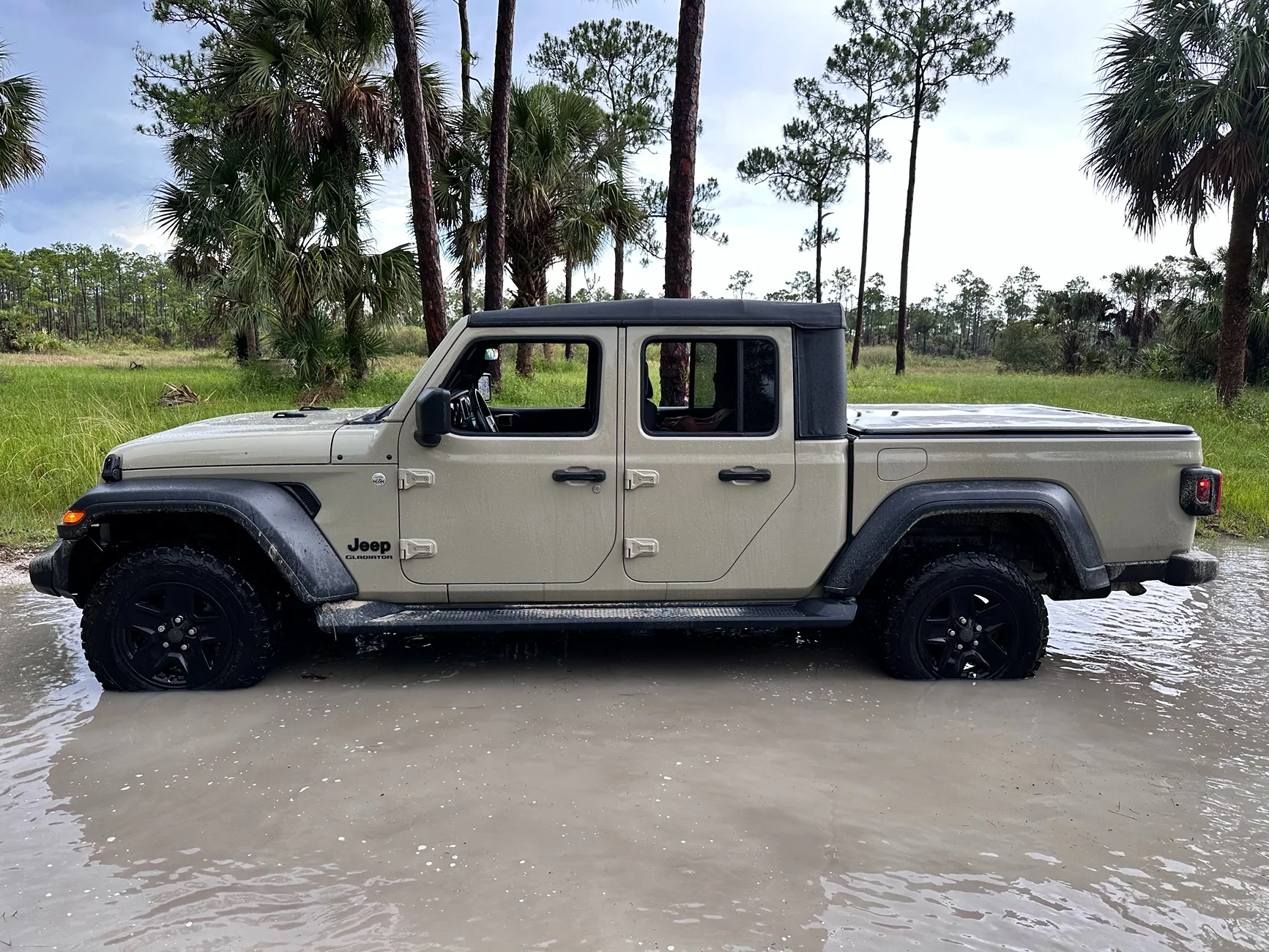

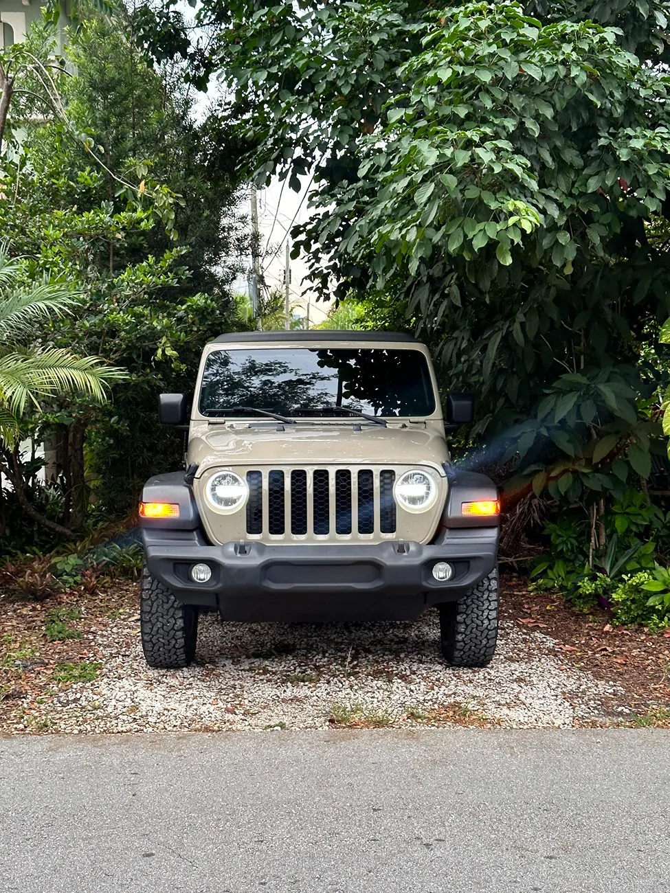

A little about where this truck started to where it is, and whats planned. I had never been a Jeep person and I'll admit, I didn't do enough research or I'd probably have started with a Rubicon instead of a Sport. That being said, this journal really has three parts. The first iteration where I didn't know sht, the second iteration--before the collision, and the second iteration--after the crash.
The weekend I got it, my kid and I went to some light trails down here in south FL, JW Corbett WMA. The first thing I did was change the headlights.
Jeep Gladiator 2020 6MT Gobi Gladiator on 40's 70648658342__EEE99B19-76CD-45EC-A8CE-48AF83753096
Jeep Gladiator 2020 6MT Gobi Gladiator on 40's IMG_5539
Jeep Gladiator 2020 6MT Gobi Gladiator on 40's IMG_5656

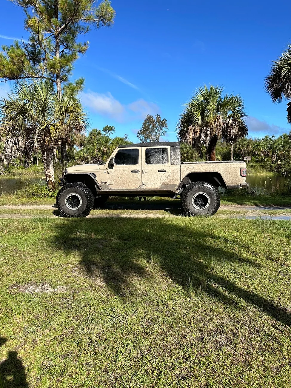

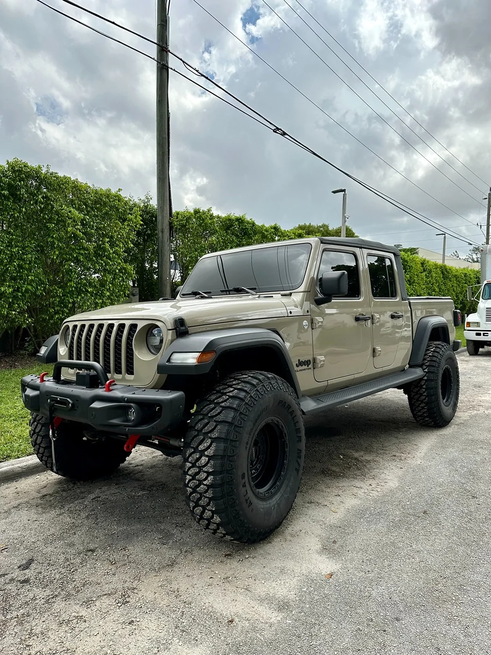

Within a month of owning it, I purchased an 'off the shelf' Tereflex 4.5" lift with Falcon shocks, a (please dont judge me) Rough Country double stabilizer, Rubcon steel bumper, Black Rhino 17's and crappy Atlas Paraller 40" tires, Yukon 5.13 gearing, Rough Country 12s winch:

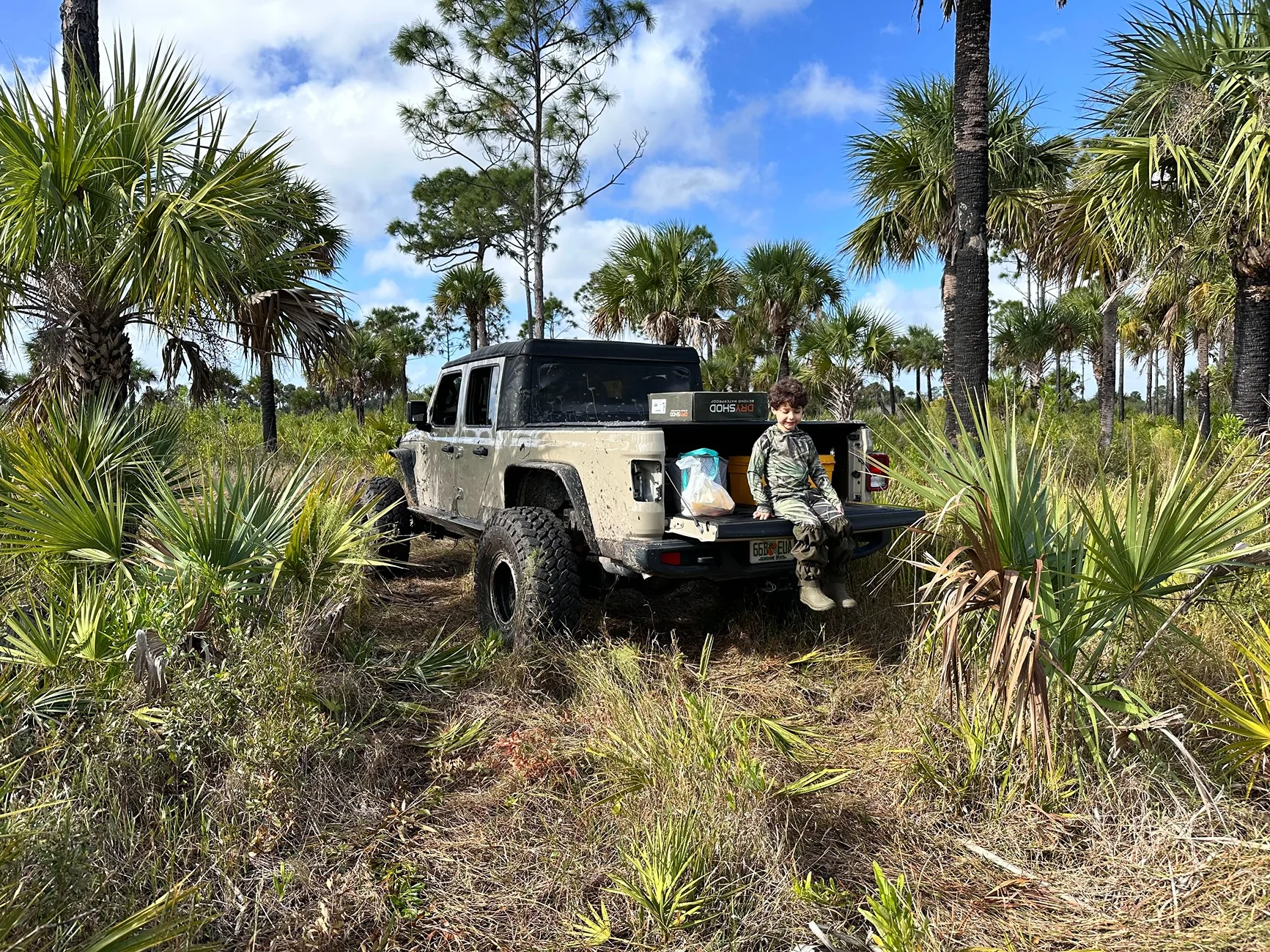

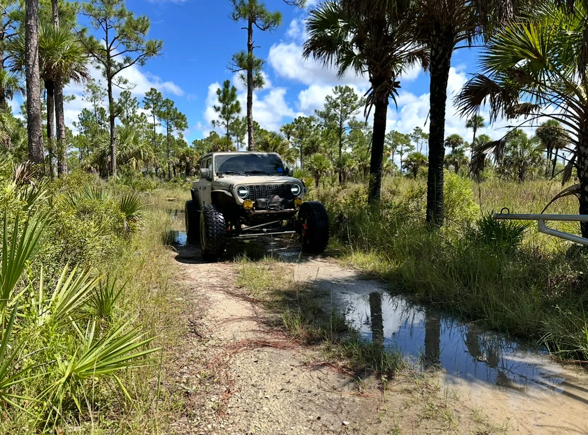

I built this thing to use on trails here in south Florida, as I hunt backwoods in the everglades and I need a vehicle capable of getting in and out. I went to some soupy places, and well, got stuck. The front and rear open diffs on full display. My friend has a vid where front and rear just stop turning and it bogged down. Cue the Eaton front and rear lockers.
Jeep Gladiator 2020 6MT Gobi Gladiator on 40's IMG_8855
Jeep Gladiator 2020 6MT Gobi Gladiator on 40's View_recent_photos

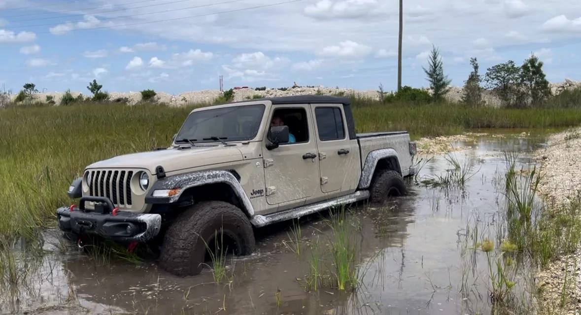

Even aired down before getting stuck, lol. Trying out two trail compressors, the Milwaukee won.

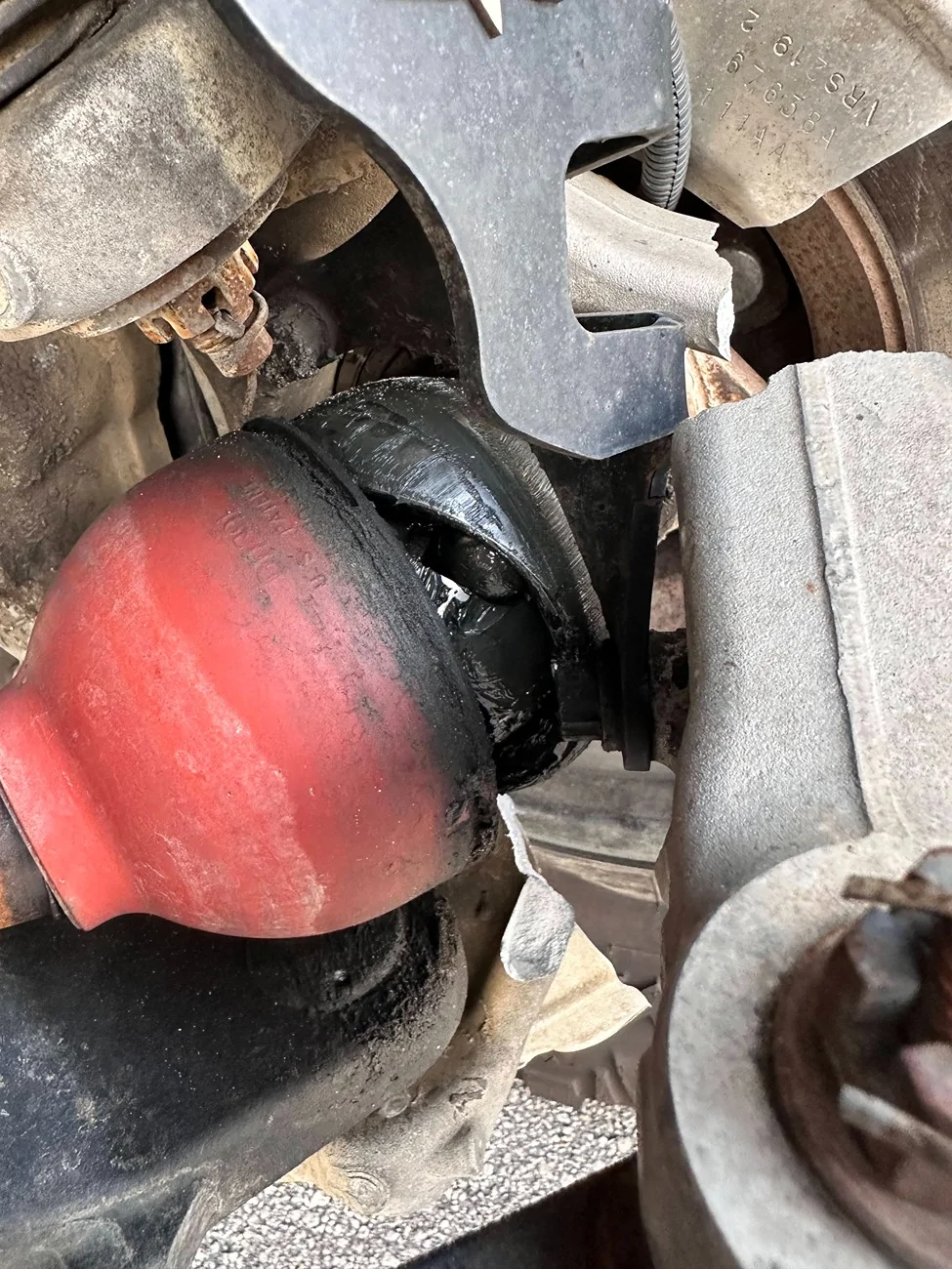

Along with lockers, I put on RCV front shafts. That C-clamp for the FAD helped us invent new words:

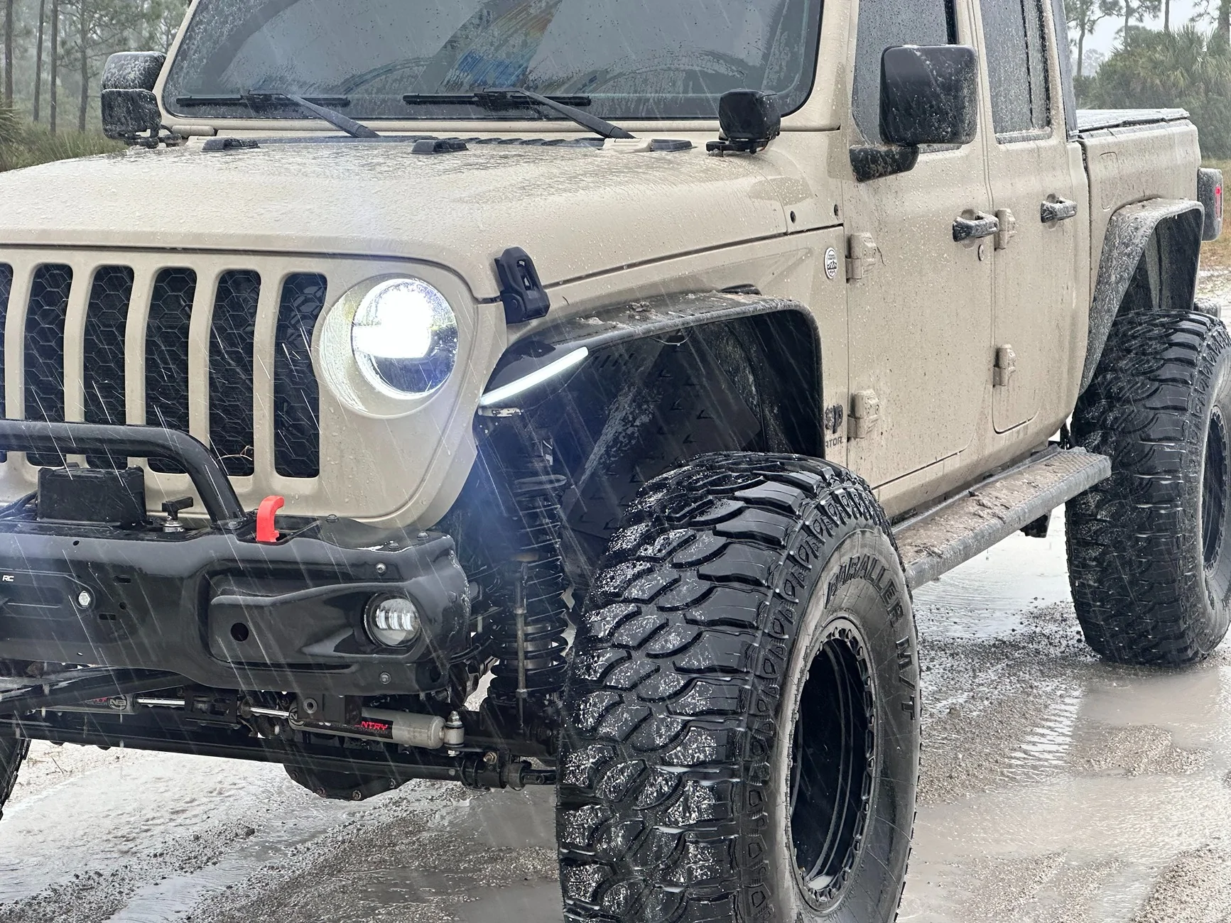

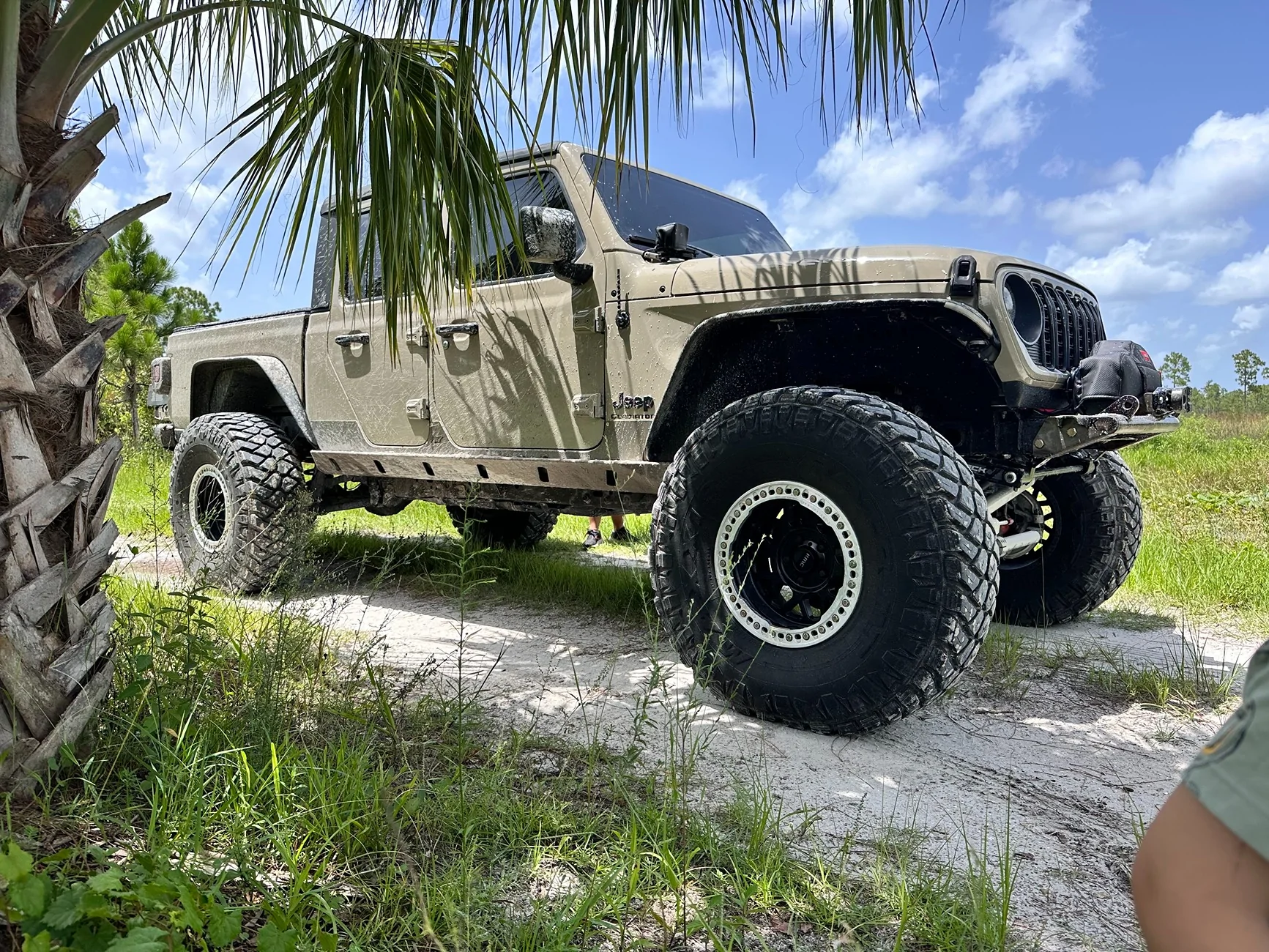

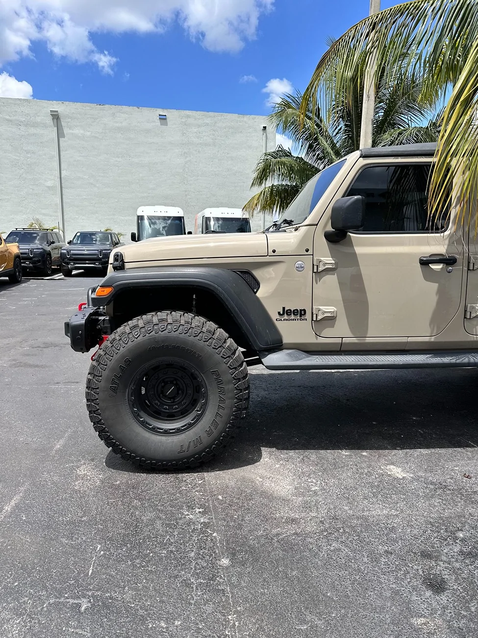

Then it was time for proper wheels and tires, Nitto Trail Grappler (later shiddy Parallers) and KMC Grenades. Oh, and somewhere along the lines, I did Motobilt sliders with the side-step PC'd in clear:
Jeep Gladiator 2020 6MT Gobi Gladiator on 40's IMG_4770
We get a ton of rain in south Florida...

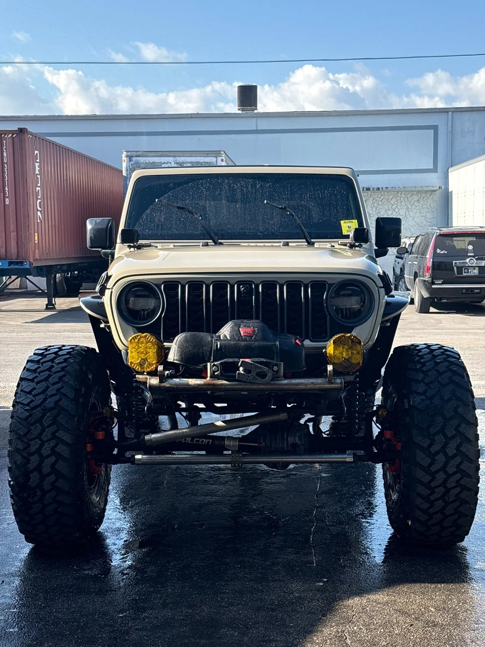

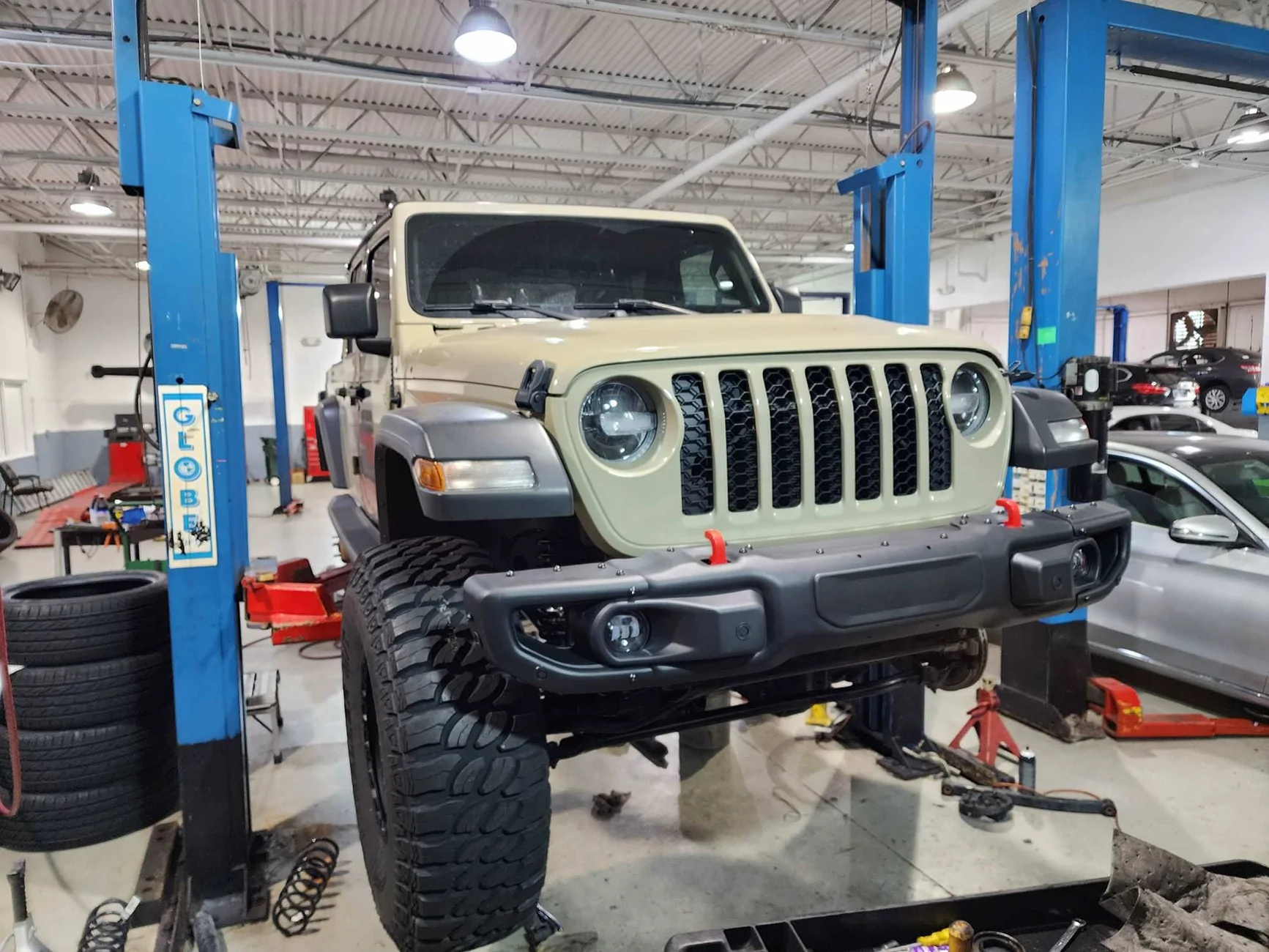

Whole front refresh! Front and rear adjustable Tereflex upper control arms (the off the shelf lift had fixed uppers), New bumper? Send it! Krashfab frame chop front bumper and a Warn VR Evo 12000. Updated Grille to the 25+. Also added GK knuckle lights and yellow Baja Designs S1's and twin yellow LP6:
Jeep Gladiator 2020 6MT Gobi Gladiator on 40's IMG_7710
Jeep Gladiator 2020 6MT Gobi Gladiator on 40's IMG_8249
Jeep Gladiator 2020 6MT Gobi Gladiator on 40's IMG_8384
Jeep Gladiator 2020 6MT Gobi Gladiator on 40's IMG_1473
This setup was good enough for my first trip to Windrock. 700+ miles driven up, not trailered, four days of wheeling blues and blacks, and the 700+ mile trek back. Solid as a rock, and fell more in love with this thing than ever.

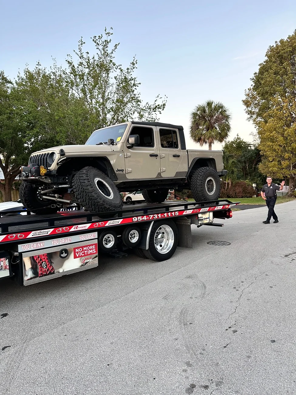

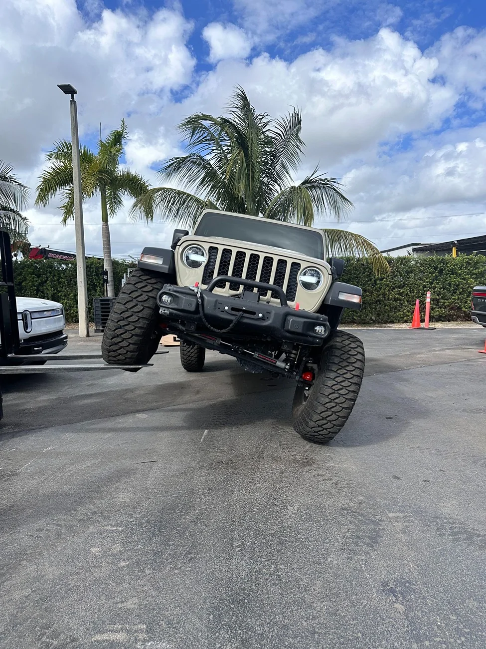

Windrock was Thanksgiving week last year. The truck stayed like that for the most part until March. I took it out to pick up some beer, it hadnt been used much, I rotate a coupe cars. On the way back, on my residential street, a lady ran a stop sign and I couldnt stop in time. I was only going about 20 but she lurched right out in front of me last second. I was truly baffled 🥴 at first glance, I thought it was just the weak alum knuckle that took a shit, but no, damage was done.
Jeep Gladiator 2020 6MT Gobi Gladiator on 40's IMG_2636
Jeep Gladiator 2020 6MT Gobi Gladiator on 40's IMG_2645

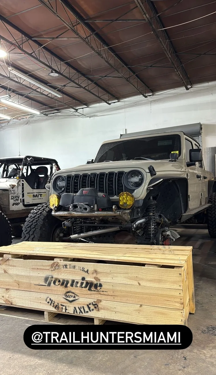

Luckily, Danny at Trailhunters isnt so far :) I should have forked out the rest and just done Dana60's. This decision will likely haunt me for many, many years. Anyways, we went with the beefed up Spicer Advantek Ultimate Dana44. No more RCV's for a while...

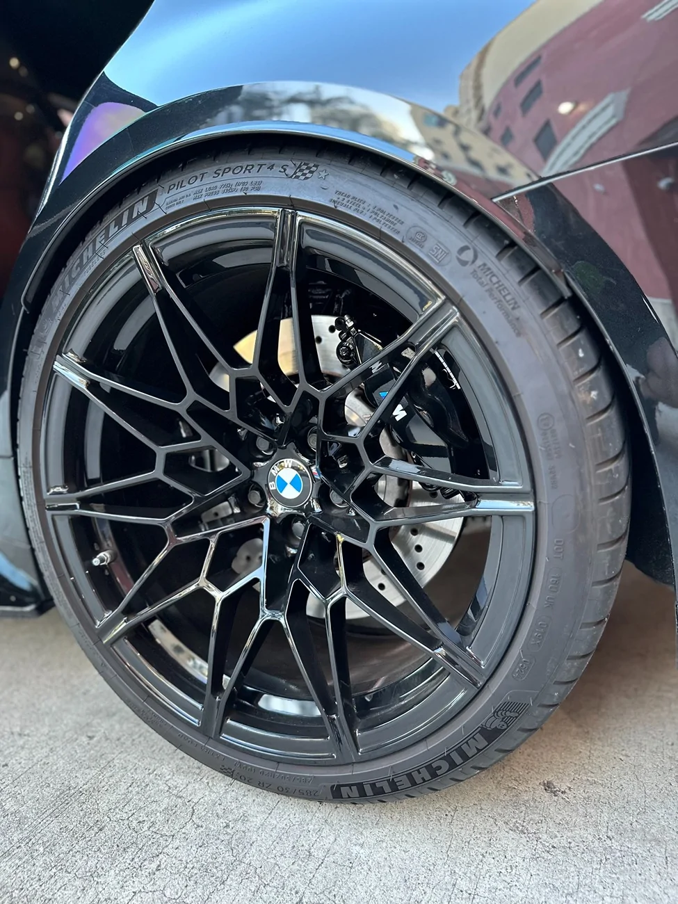

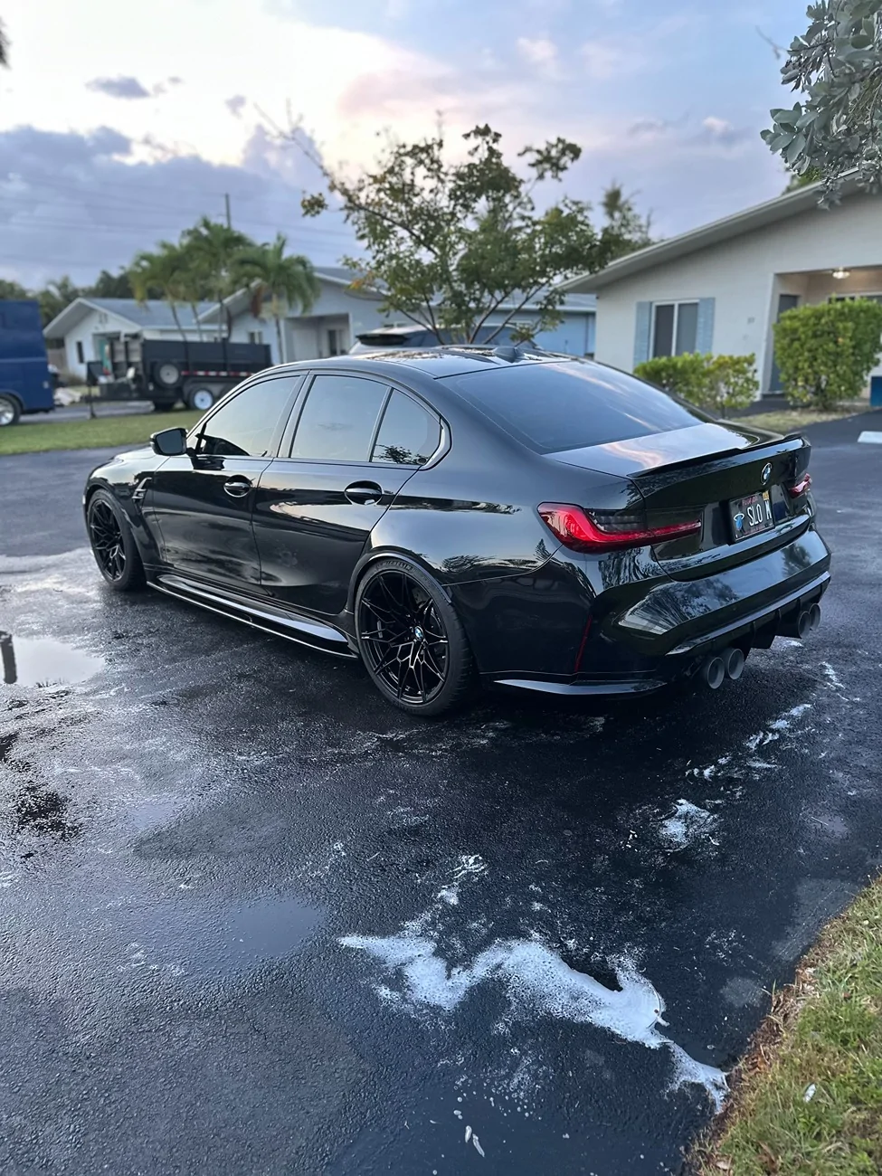

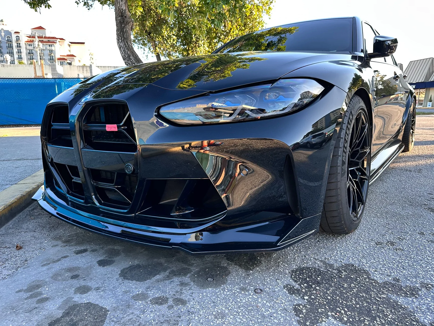

This is my other project and why things don't get moved on as quickly on the jeep. I have two cars that split my money and two kids that take my time. I also wouldn't have it any other way.
Jeep Gladiator 2020 6MT Gobi Gladiator on 40's IMG_2598
Jeep Gladiator 2020 6MT Gobi Gladiator on 40's IMG_2595
Jeep Gladiator 2020 6MT Gobi Gladiator on 40's IMG_6973
Jeep Gladiator 2020 6MT Gobi Gladiator on 40's IMG_6980
Jeep Gladiator 2020 6MT Gobi Gladiator on 40's IMG_6968

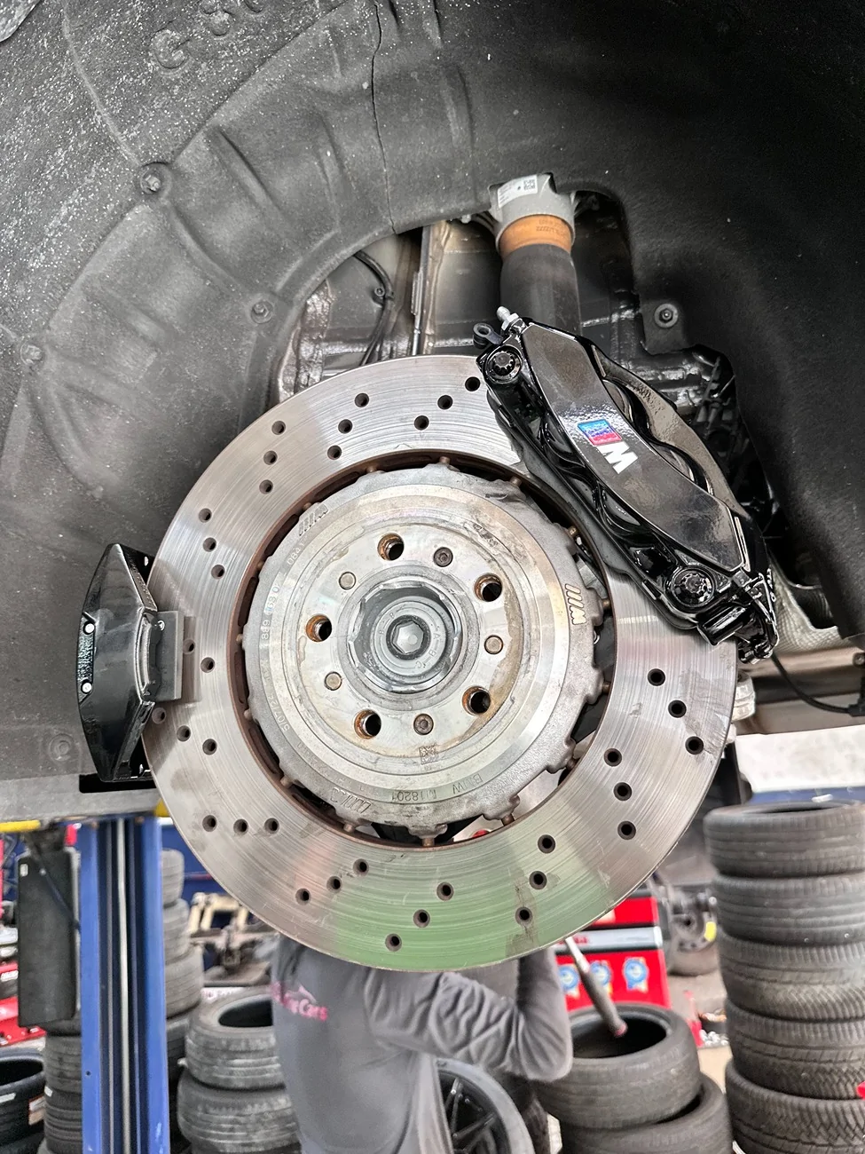

Upgraded the rear brakes to get rid of the ugly floating caliper:
