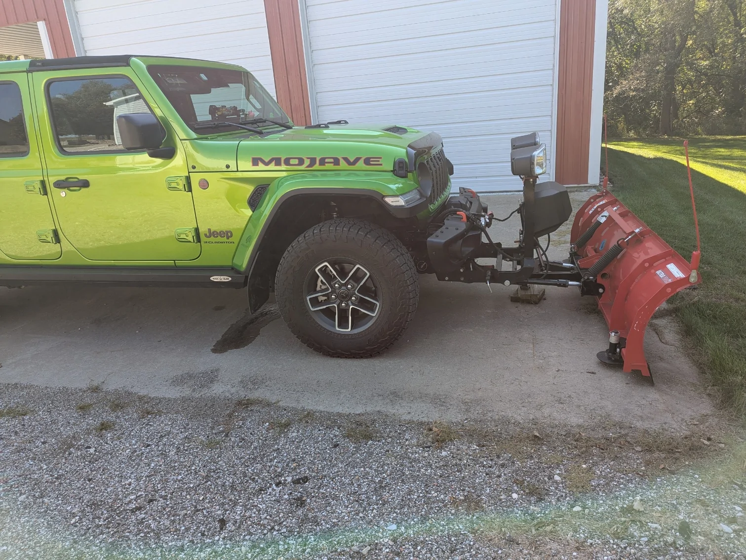

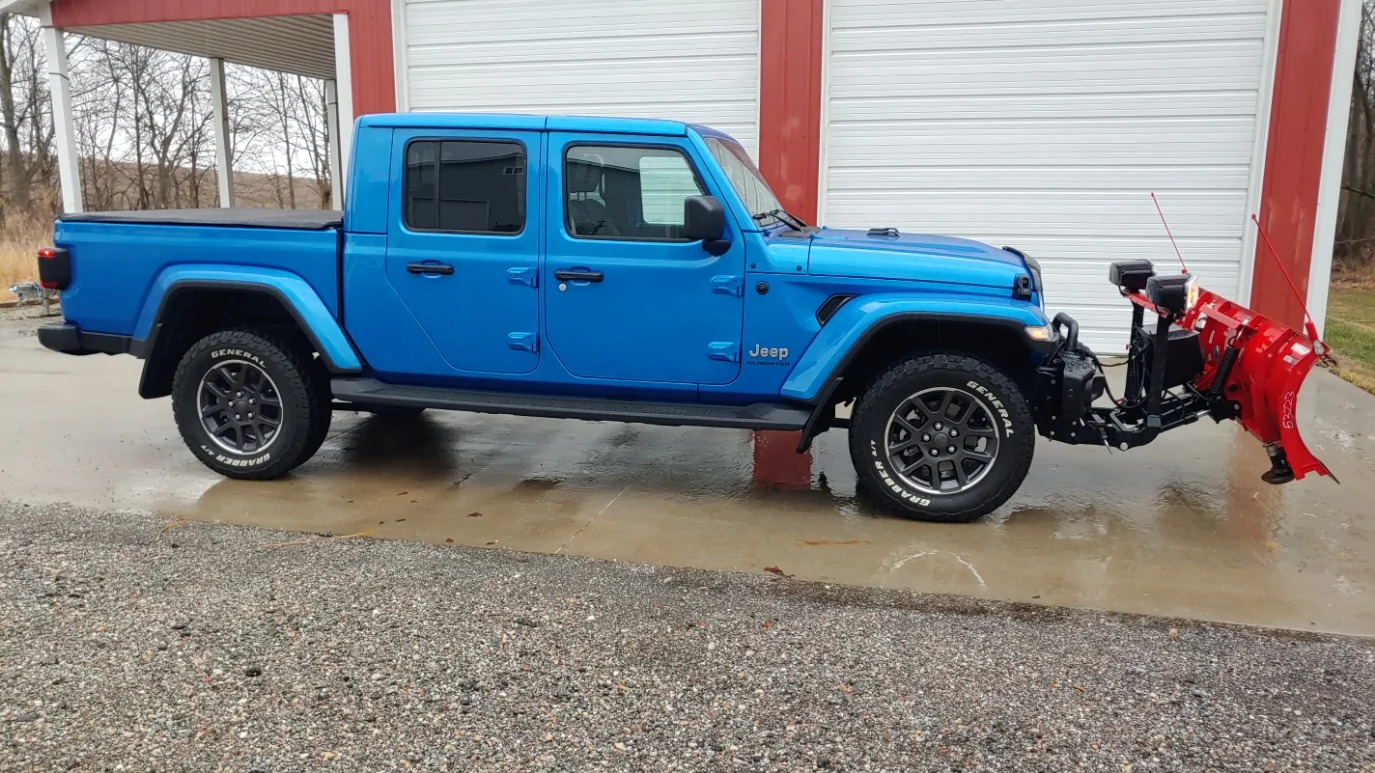

They only sell the Defender for Overland and another model or two of the Gladiator, but I wanted the Mojave this time around and had the Defender already here, from my 2022 Overland.
When I looked at the Mojaves on the lot, I did a lot of measuring, comparing of pictures of my Overland to the Mojave (X) and decided that aside from the possible "soft" suspension on the Mojave, the biggest challenge would be the shock reservoirs. The reservoirs and the hoses from the shocks were indeed a head-scratcher.
I decided to go for it, worst case, relocate the reservoirs and lines - and suffer with front suspension too soft.
The Mojave X frame sits just 1/8" or so higher than the Overland did with the Synergy springs under the front. It's close to needing the different brackets, but the winch install put it right at the break point for different brackets. So that worked out.
Advantage of the Mojave X is that the trail cam helps line up with the plow when mounting it for use.
The latter I had already been through. I had to put Synergy 2" springs under the front to handle the extra weight of things when the plow was mounted in the winter. They were dual-rate.

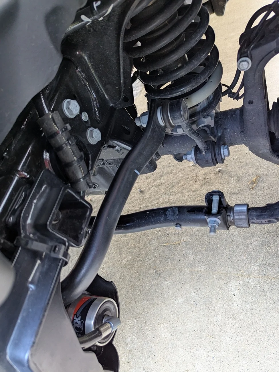

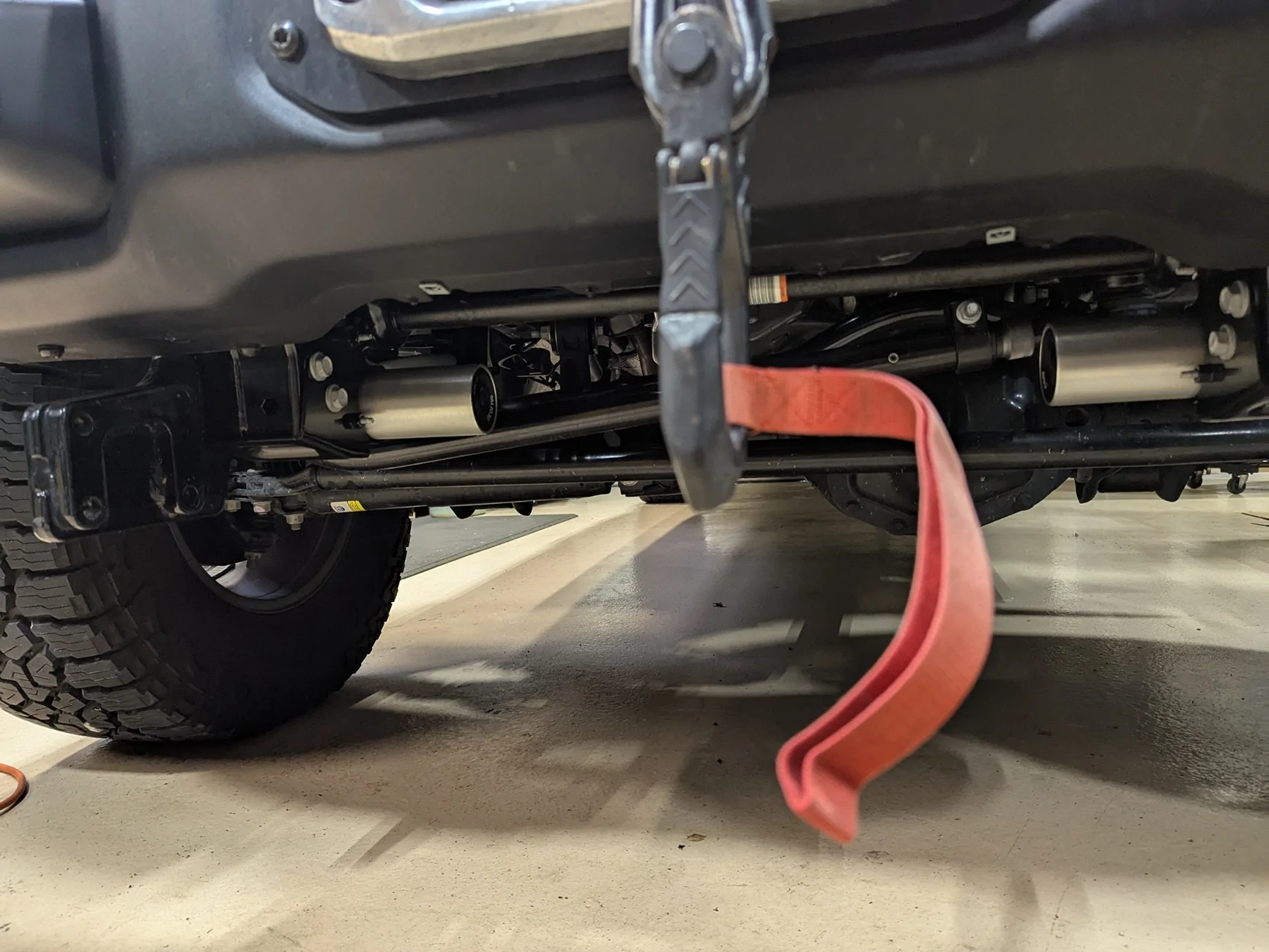

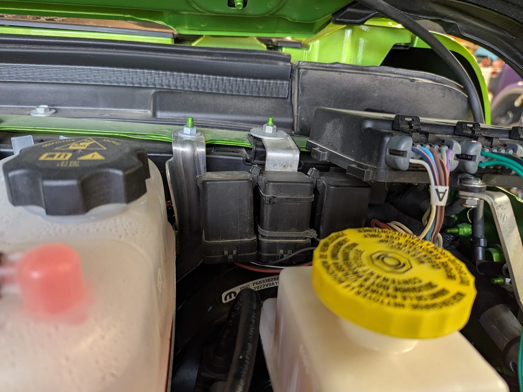

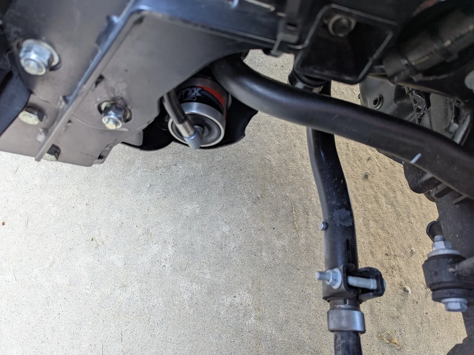

I prepared by purchasing reservoir relocating brackets, just to be ready. I ended up not using either pairs of brackets.

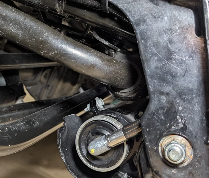

The solution to the reservoir issue was to loosen the screw clamping them into the lower skid plate bracket and slide the reservoirs to the center of the truck.

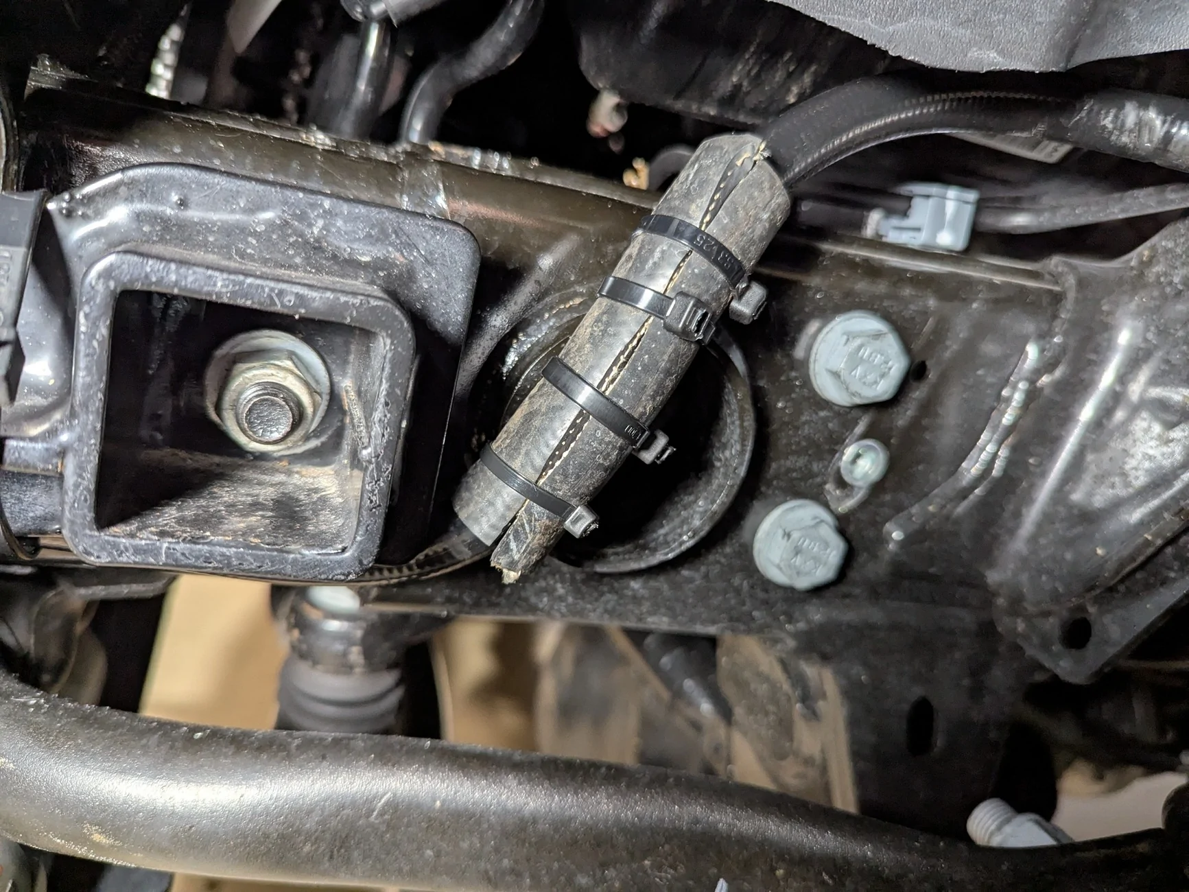

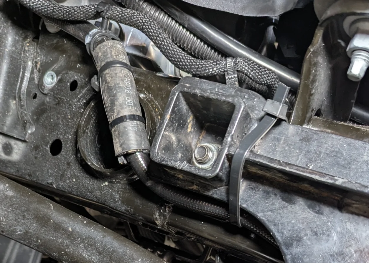

As far as the hoses or lines - that's a bit more complex and may be refined when I pull the snow plow brackets off the frame for spring.

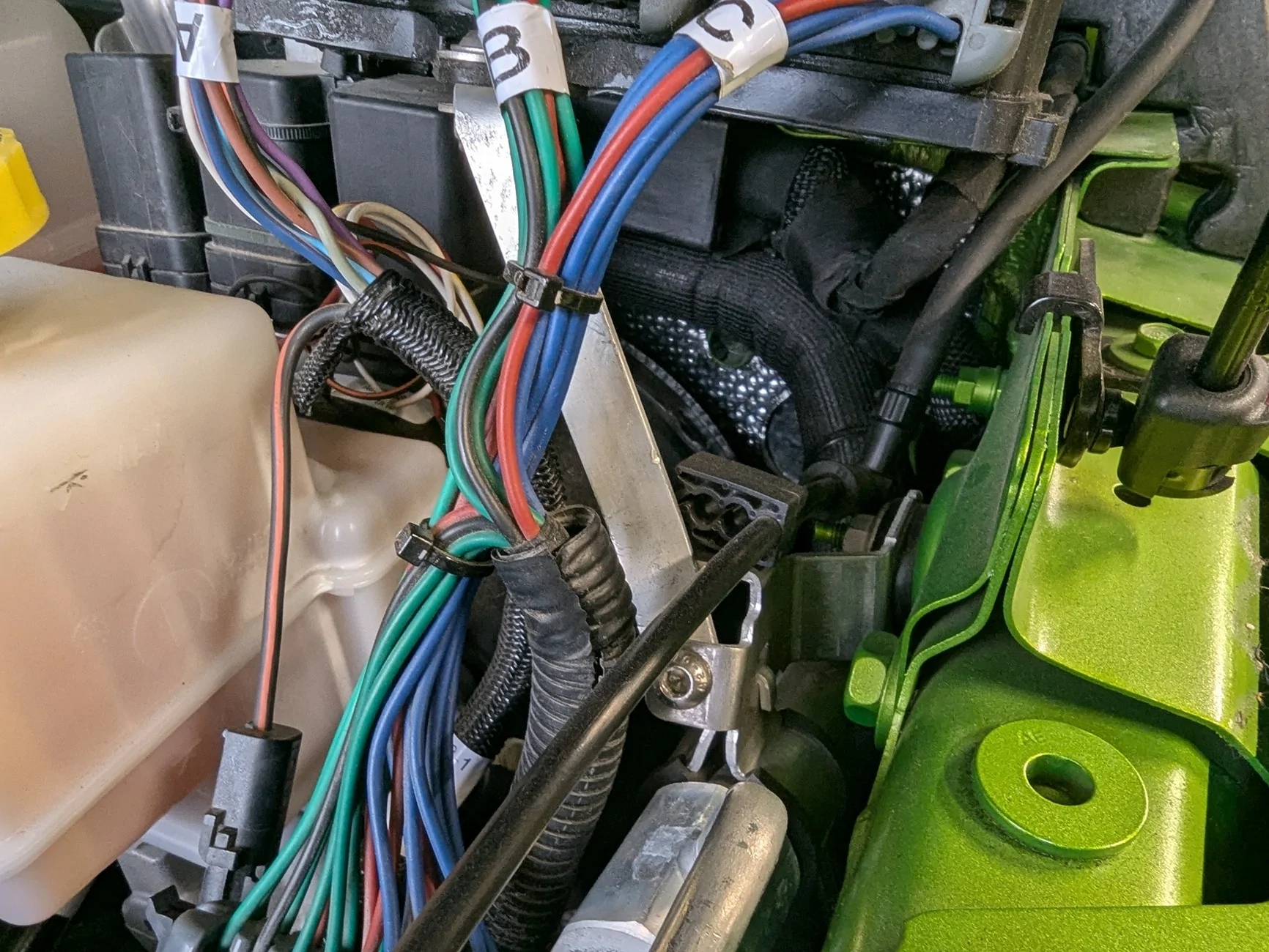

I was able to put all of the plow wiring and relays and adapter box where they had been in the Overland. I did make one wiring change - the wire harness I had run back beside the battery (engine side) to the firewall, then to the driver's side along the top of the firewall/cowl area, I instead ran it forward and across the top of the radiator area, under the top bracket there.
This time, the fender liners were also pulled down and out of the way to access the wiring for the turn signals/parking lights. On the Overland, I did it all from the engine bay and under the truck struggling to disconnect the factory connectors and get mine in place. When removing the wiring from the Overland, I found how much easier it was just to take a few fasteners out and access the factory connectors that way. Plus - I wanted to install the DiodeDynamics clear lens marker lights in the fender flares.
Some of the pictures may be from my 2022 Overland because some things are just the same, otherwise - here's pictures and suggestions if anyone wants to break the rules and use a snow plow on a Mojave.

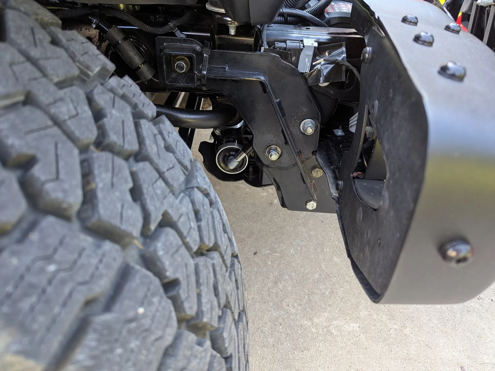

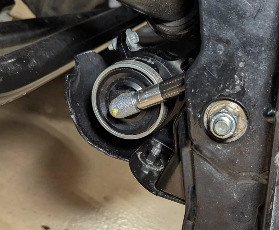

You will need to remove the bolts that hold the reservoir lines to the frame and remove the clamps and wire holders from the hoses.
The top bolt shown here can be loosened to slip the reservoirs inward.

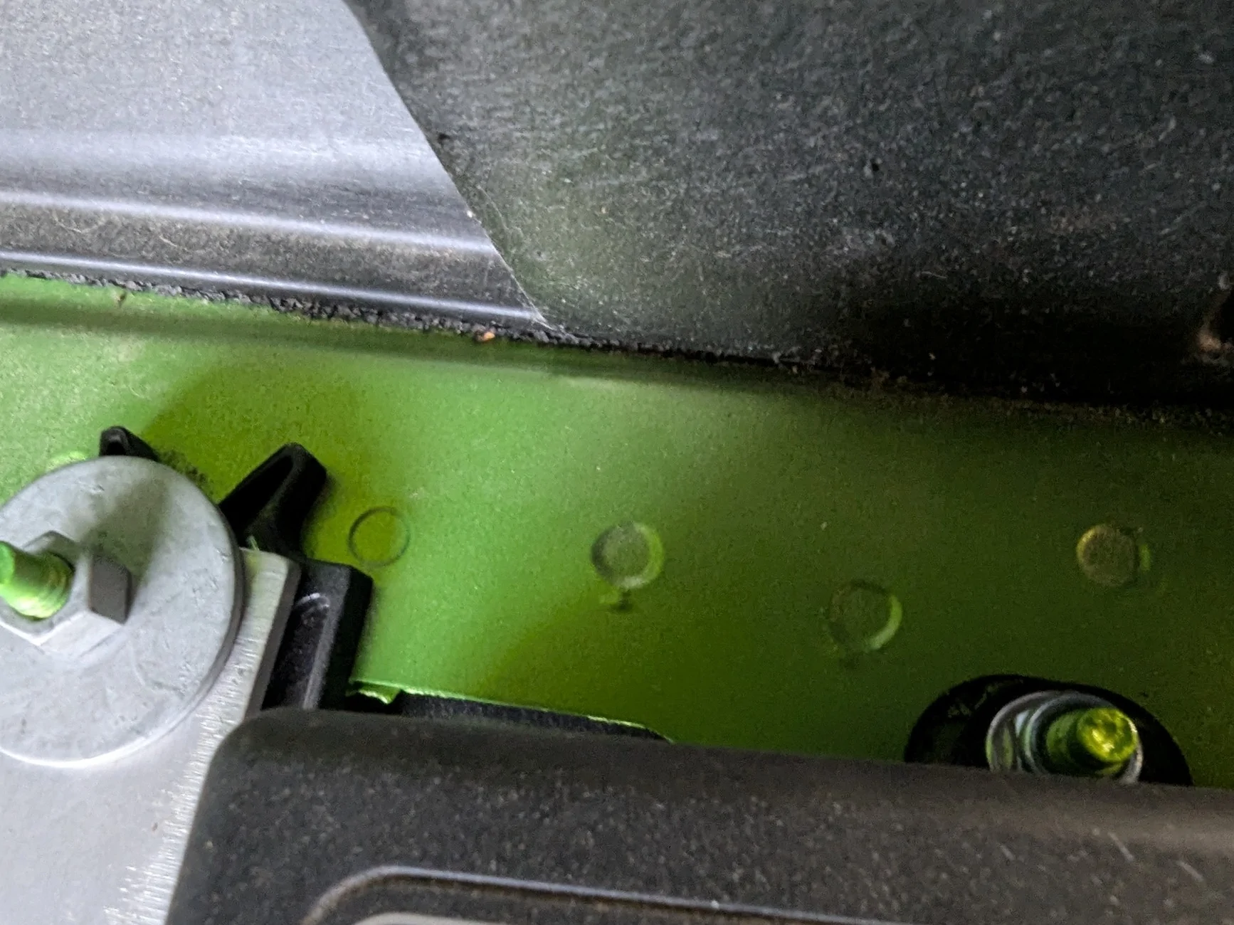

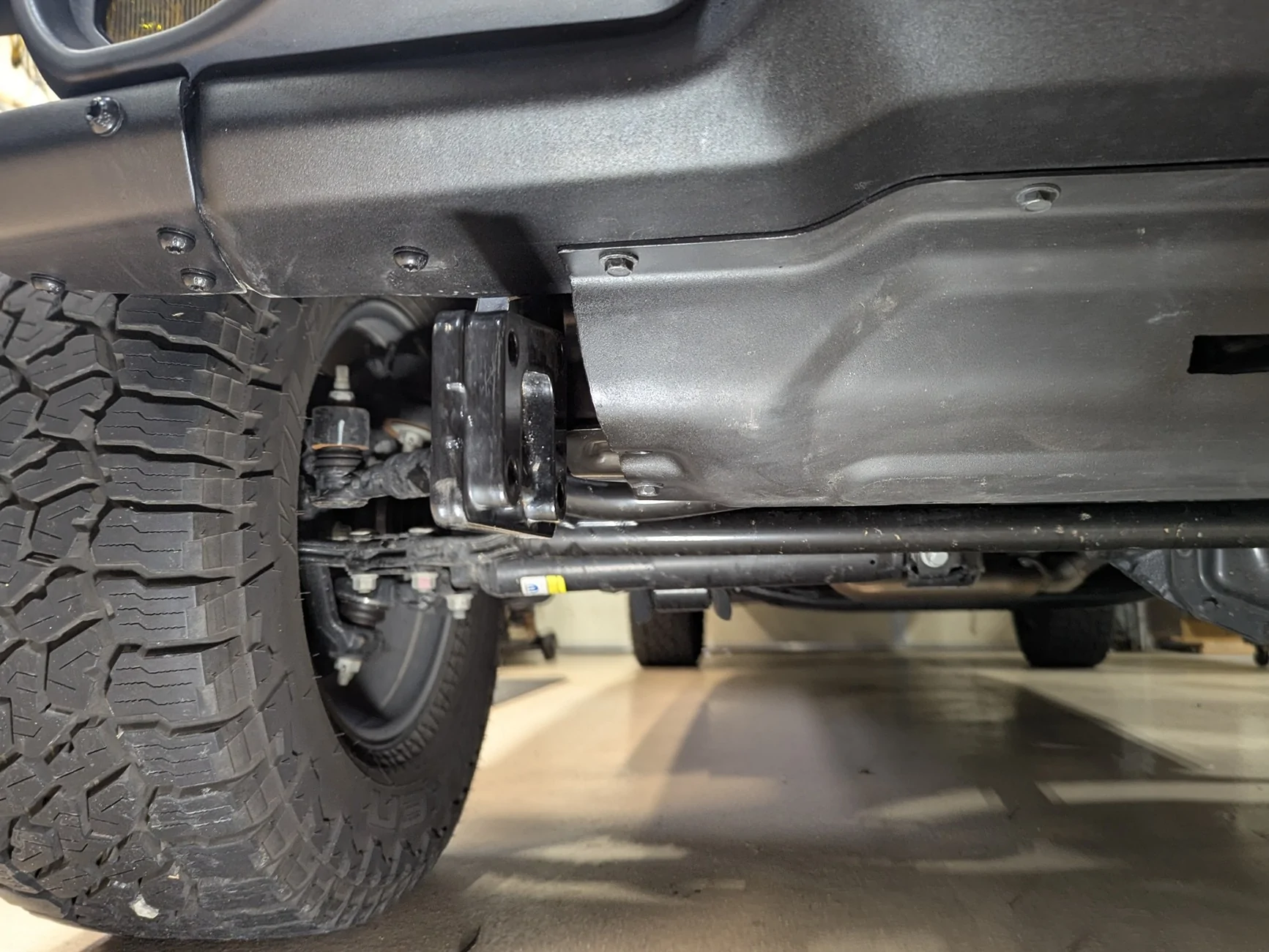

The round brace welded through the frame is very rough cut. It's sharp on mine, like they used a band saw or chop saw and never cleaned up the ends, so I cut pieces of fuel line and wrapped around the reservoir lines to pad them against abrasion.
There's enough of a gap between the JT frame and the snow plow bracket that the hose can fit up between the two. You'll need to make sure the shock hose can't move around. I'll do something different or better next near when I remove the brackets for the summer.

The reservoirs end up really showing in the middle of the frame. It's critical, IMO, to protect them. So I used a skid plate I had from my other truck and cut the ends off to fit between the snow plow brackets. I wasn't going to run it this way. (I'll look for another skid plate in the near future as I can do a lot neater job of cutting it to fit between the brackets and not leave as large a gap)

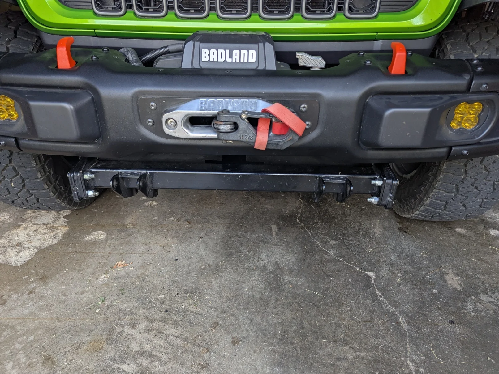

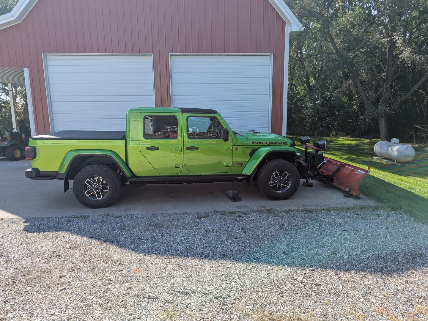

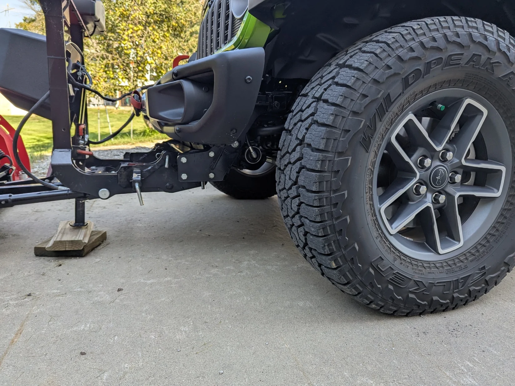

Skipping ahead a bit because I'm not sure how many snow plows there are on a Mojave X at this point in time -

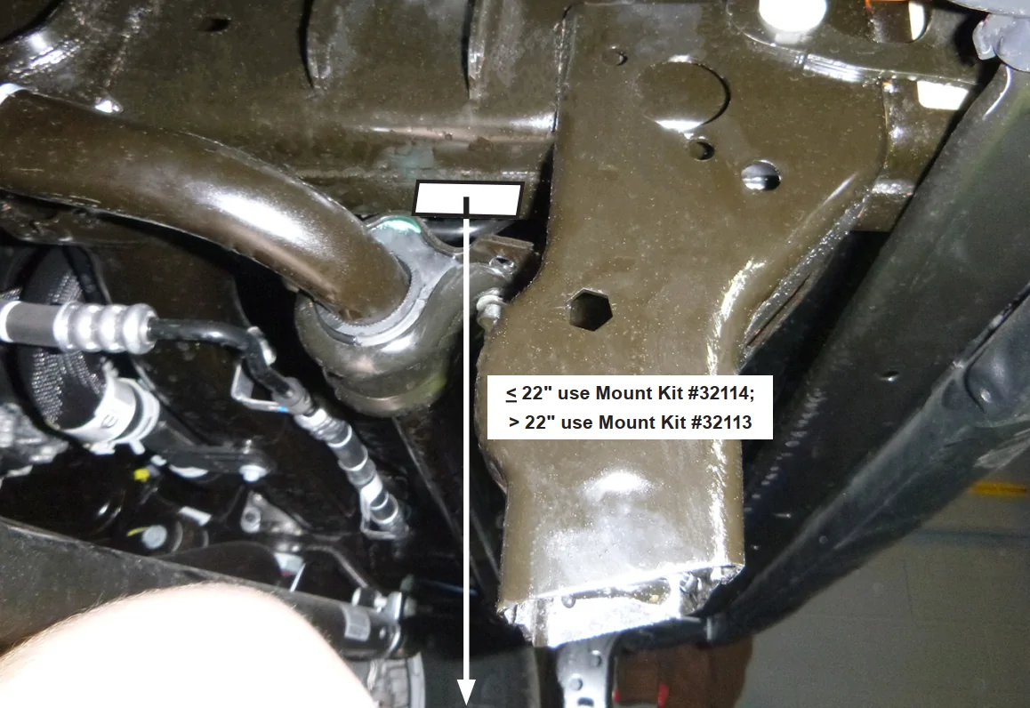

Height of the truck is important. They have a spec and the Mojave X comes in at 22.125-22.25" where the standard brackets are for less than or equal 22".
My Overland with the 2" Synergy front springs was sitting at 22".
once the winch was added to the Mojave, it settled to just a tad over 22 - I figured that's fine as it will have the weight of the brackets and such as well, and the softer suspension will settle some.
Jeep Gladiator Western Defender snow plow install on a Mojave X 1761763121176-ra
The want the snow plow framework - between truck and plow when the plow is resting, to be as level as possible. I believe that is accomplished. (the stand is not touching the wood blocks - they move, so it's truly resting on the truck and the blade is against the ground.)

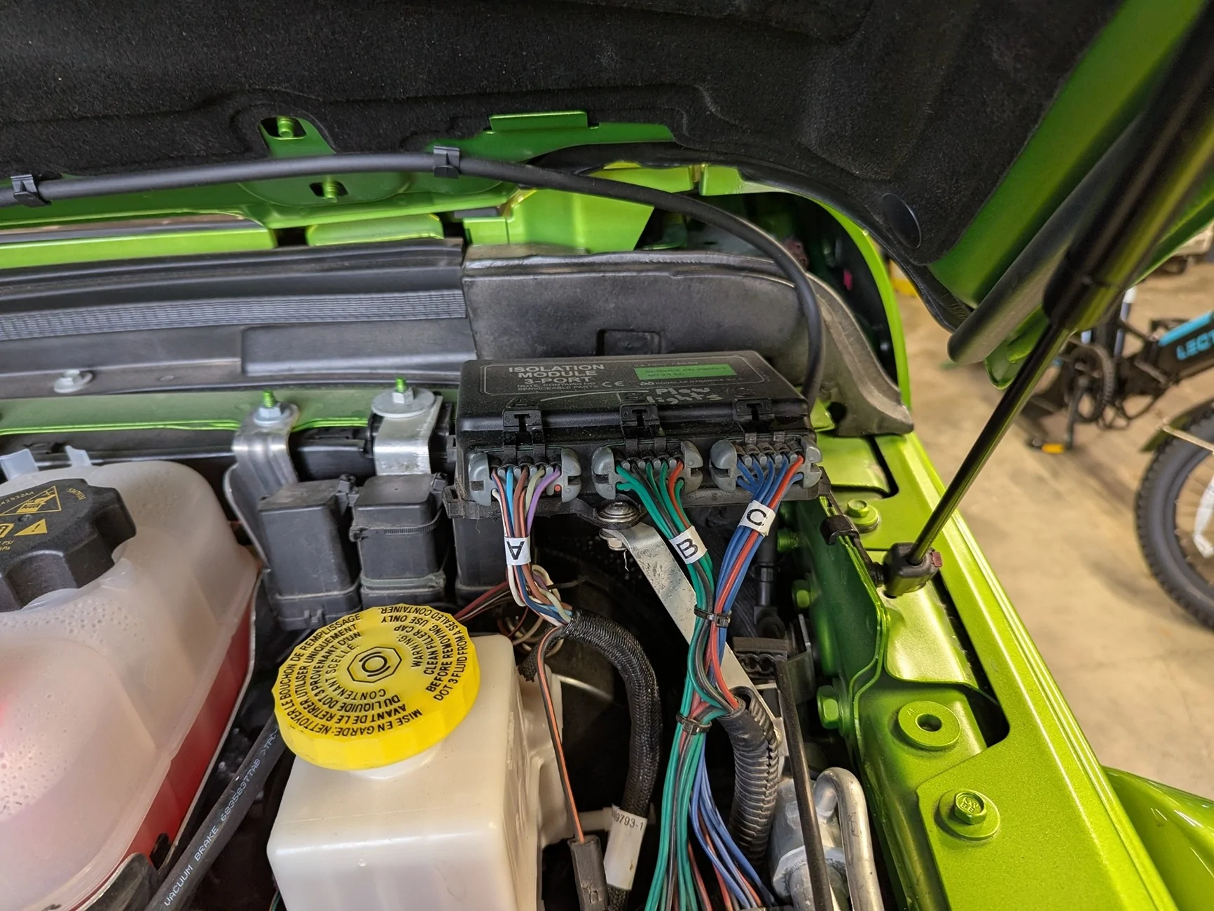

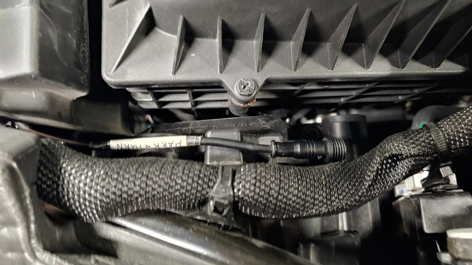

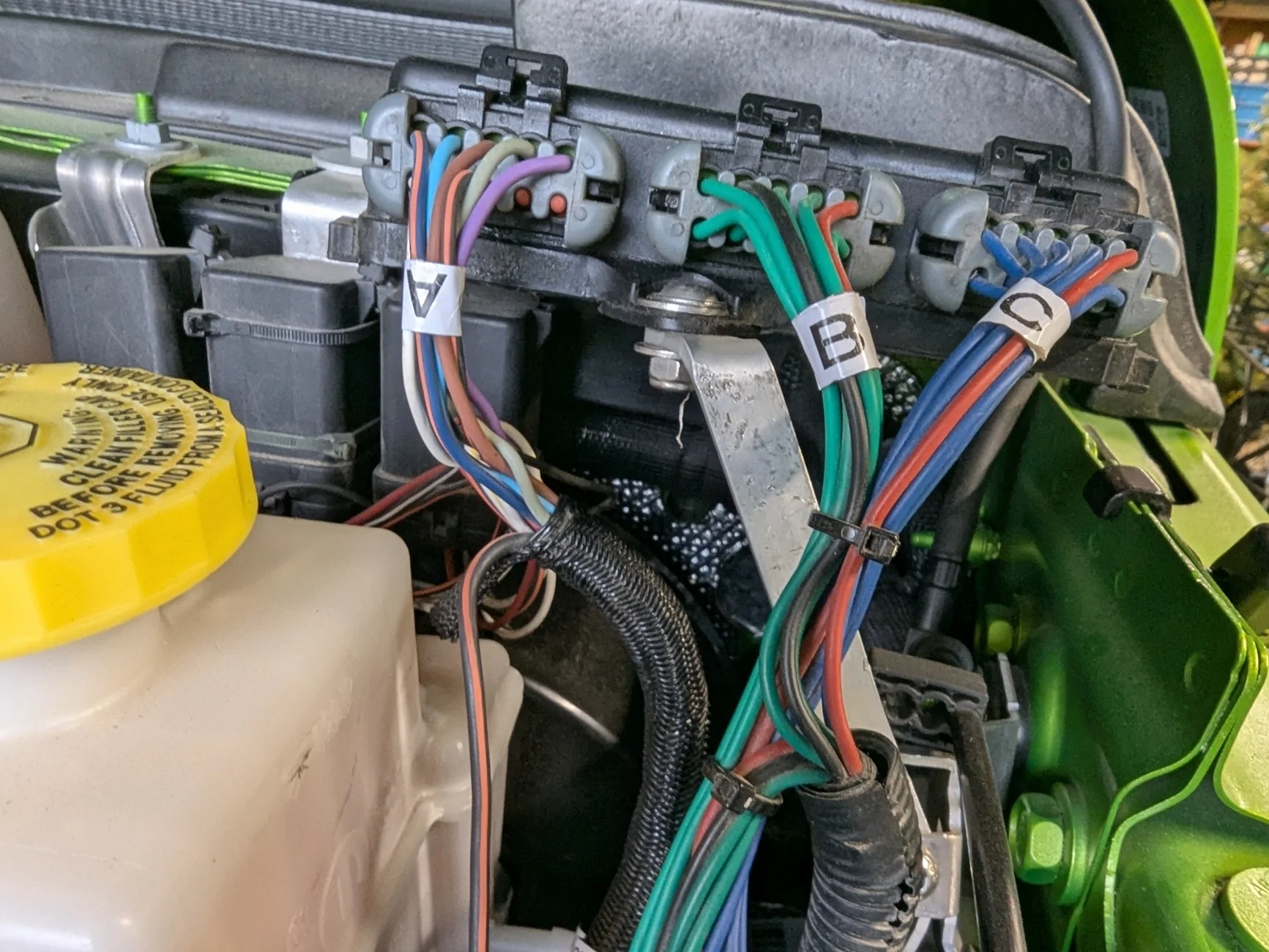

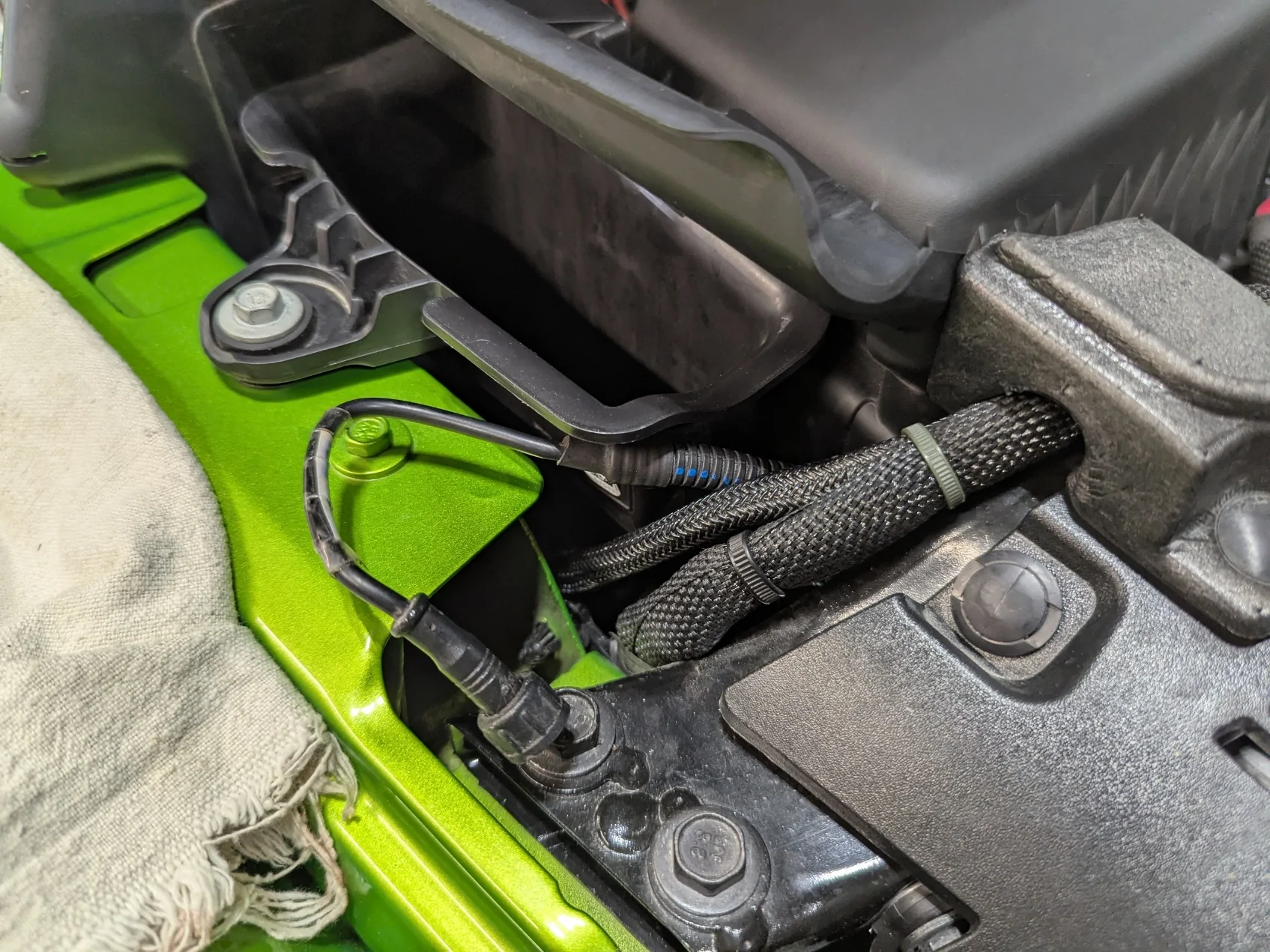

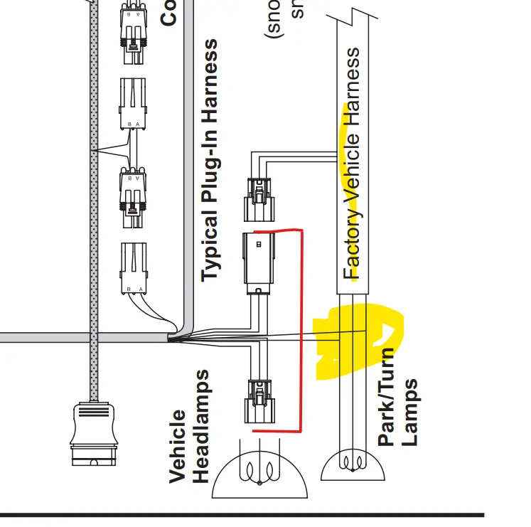

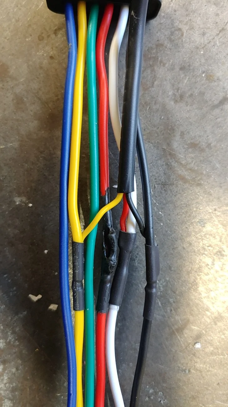

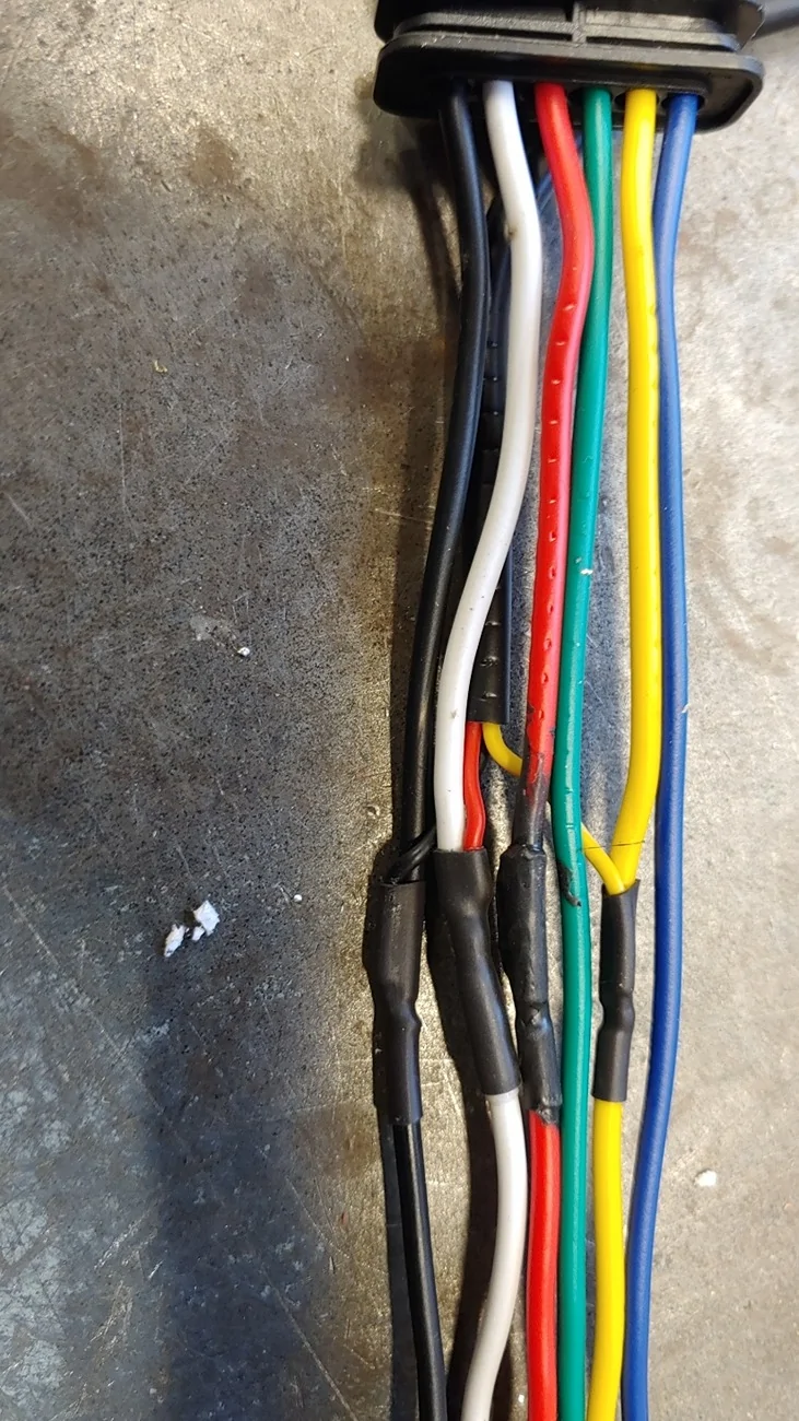

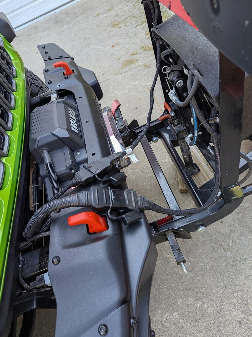

This is how the section of plow harness came out by the filter box. The other connector there goes to the pigtail I made that connects into the turn signal/park light harness.
The instructions say to cut into those wires, wrap, solder, and seal them but I don't like cutting a factory harness so made my own connector. You need to pull the fender liner down to access it, but it's really pretty easy to do.
Jeep Gladiator Western Defender snow plow install on a Mojave X PXL_20250920_193349288
This is my connector from the turn signal pigtail I configured - it connects to the screw connector shown above. I bought those on Amazon as they seal nice and are small.
The other parts are from Oracle - they are the pigtails that their lights use to tap into the Jeep's lighting wiring. I needed to modify them just a bit for my use but that was simple with soldering iron and marine type sealing heat shrink.
They furnish the connections to go to the headlamps - you remove headlamps, disconnect factory harness, plug their harness to the headlamp, then connect the factory harness to theirs (all in red bracket)
But for the turn signals and parking lights, (yellow) they want you to cut the factory wiring and use BUTT splices. No way, sorry. My way made it easier to remove the whole harness when I traded my Overland in on the Mojave - unplug from Overland - cut no wires - plug back in to Mojave.

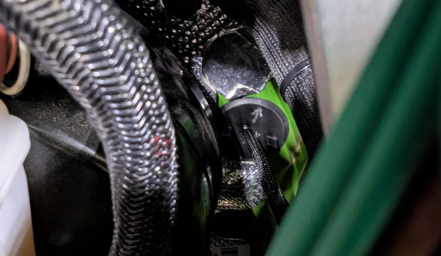

As with the Overland, I removed the plastic cap that plugged the clutch rod hole, drilled it, put a rubber grommet in it, and fed the plow's hand-held control harness through and put the plug back in place.
Jeep Gladiator Western Defender snow plow install on a Mojave X 1761763748410-qx

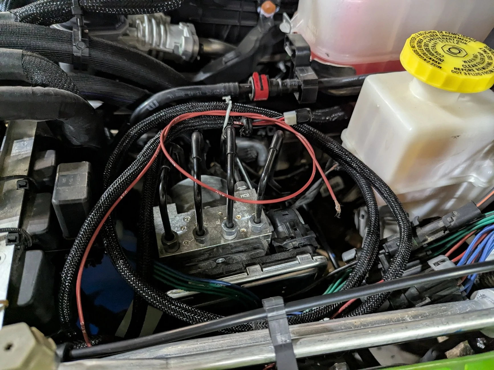

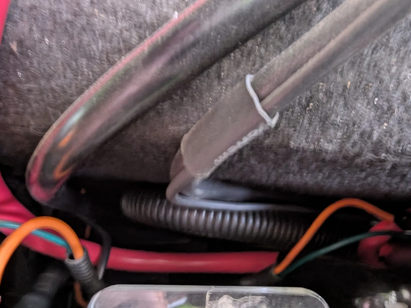

Here's the harness/cable that fed through the grommet above. The red wire goes to ACC power (on only when ACC is on or truck running) and the other is the connector that goes to the hand-held snow plow control.
Jeep Gladiator Western Defender snow plow install on a Mojave X PXL_20250920_193325465 - Copy
I fed the above up and over some brackets under the steering column, the red wire went back behind the center stack over to the AUX switch wire that is hot only with ignition or acc on. It was simple to feed it behind the center cluster - plenty of space between it and the firewall/floor.
More later - going to get some other pictures to show some of where the harnesses routed this time, making it actually easier than I did on the Overland............
More pictures showing some detail of the wiring, the harnesses and so on.

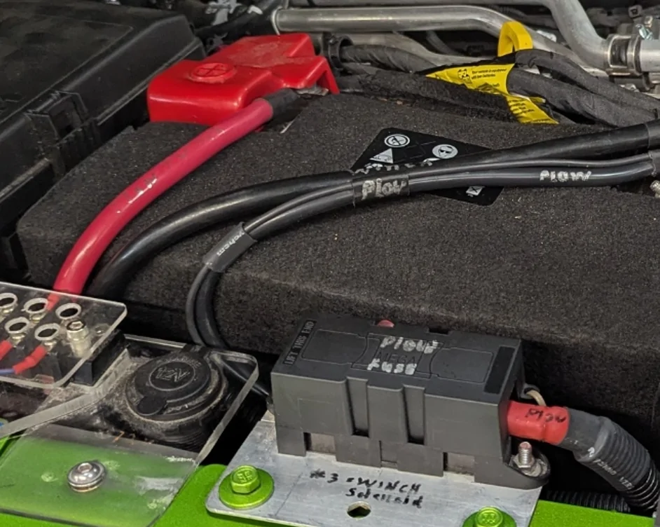

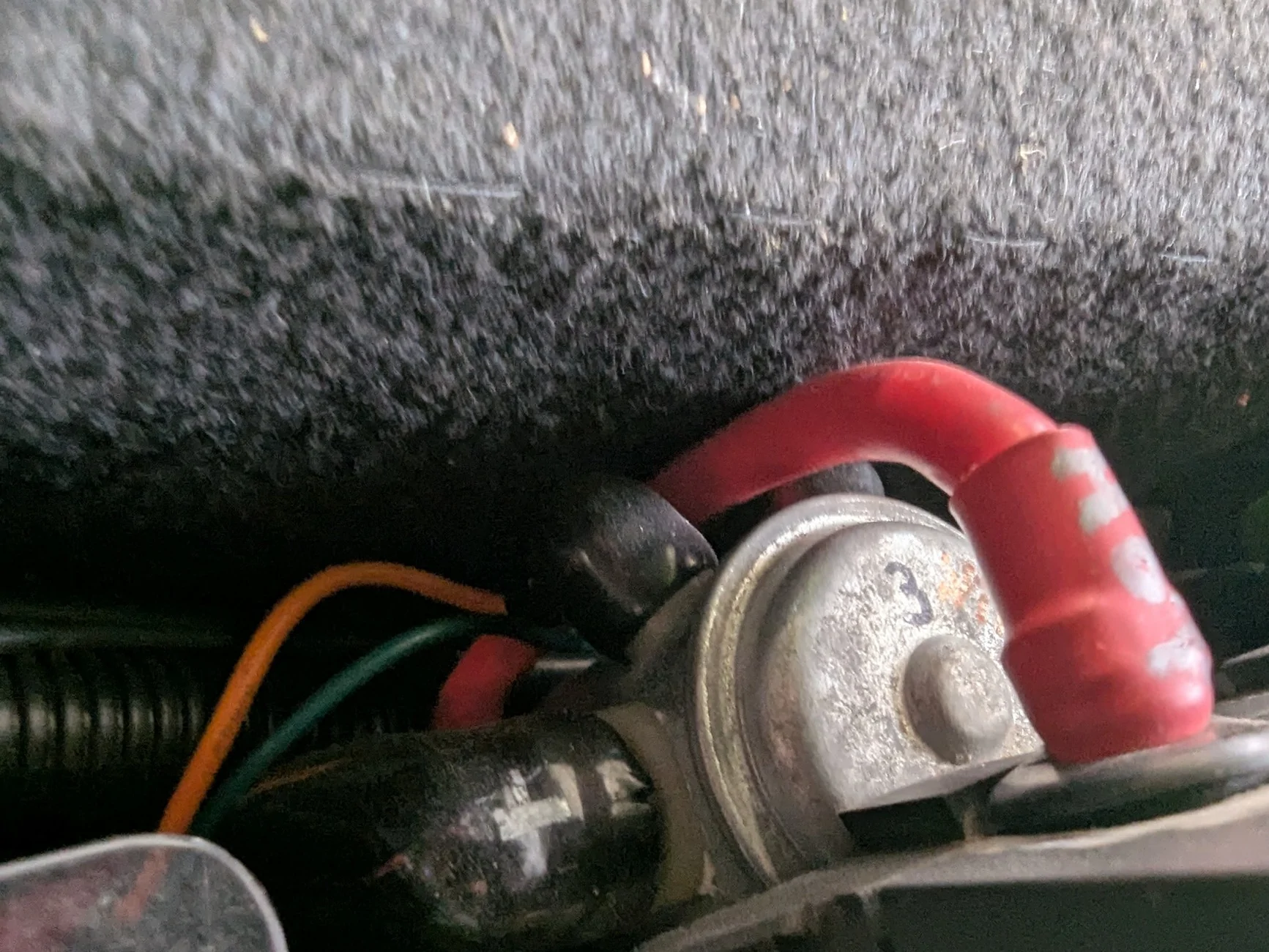

Since I have a winch AND the snow plow and they both want to be connected to the battery's positive post, and I don't like a whole lot of cables all over the place, I ran my snow plow positive from the battery side of the winch solenoid - using it as sort of a terminal block.
I used one short cable from battery positive to solenoid, then another from the battery side of the solenoid to the snow plow fuse.
Jeep Gladiator Western Defender snow plow install on a Mojave X PXL_20251030_144731305
Jeep Gladiator Western Defender snow plow install on a Mojave X PXL_20251030_144721302
Jeep Gladiator Western Defender snow plow install on a Mojave X 1761842888394-2

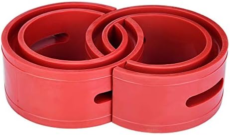

Back when I had the heavy RTT on the rack, shifted way back because the rack was too low compared to the cab, I got spring rubbers for the rear springs to help with the load. I ended up putting 2 in each rear spring.
You could try that for the plow, depending on the weight distro. It's a quick, easy fix to determine if you need springs or bags.
Amazon has them in different "spring rates," A-F, with "A" being the stiffest. I had type "B."
Jeep Gladiator Western Defender snow plow install on a Mojave X 419NRZgJ88L._AC_
Jack up the truck, spray some WD or silicone spray on the end of the spring rubber and stuff it in the spring. If concerned about them popping out, a zip tie around the coil and the rubber work.
We used these religiously in racing.
Too bad the shocks aren't adjustable, you could dial up the compression to help slow the transition.

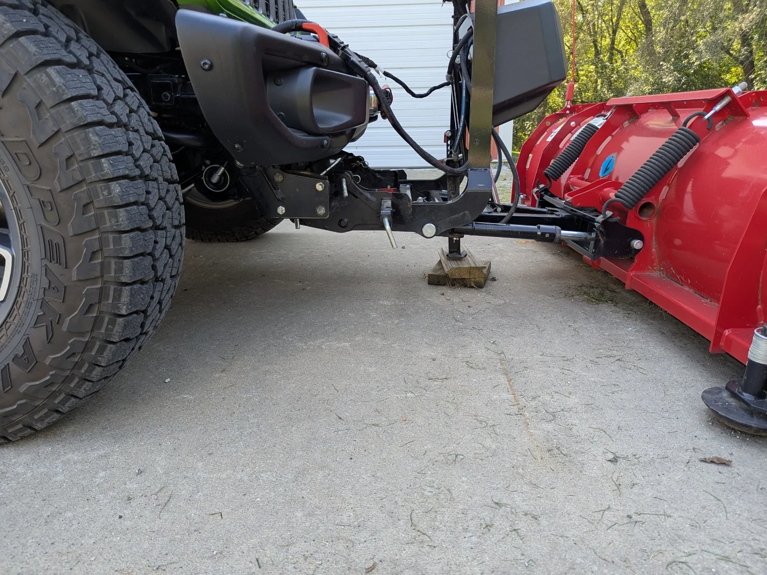

The only real concern is with the plow on it in case I need to drive it and can't mess with taking it off and then back on.
I've never seen anything like those before!
I normally put 210 pounds of sand (three 70 pound bags) in the rear for ballast. On the overland, I found I couldn't mount the plow and then drive up the gravel hill/driveway to get to the front of the garage and house area. The rear end was so light it just sat and spun.
I'll run ballast again- in part due to experience, and because they do recommend it...............

Question for you Bill- how is the float with the plow hanging that far off the frame? Not questioning if its correct (I know it is because you wouldn't have mounted if it wasn't) but I've only pushed snow with HD trucks and as I recall the plow frames were a lot tighter to the front end than yours. Seems to make sense why you'd need so much ballast with it sticking that far out.

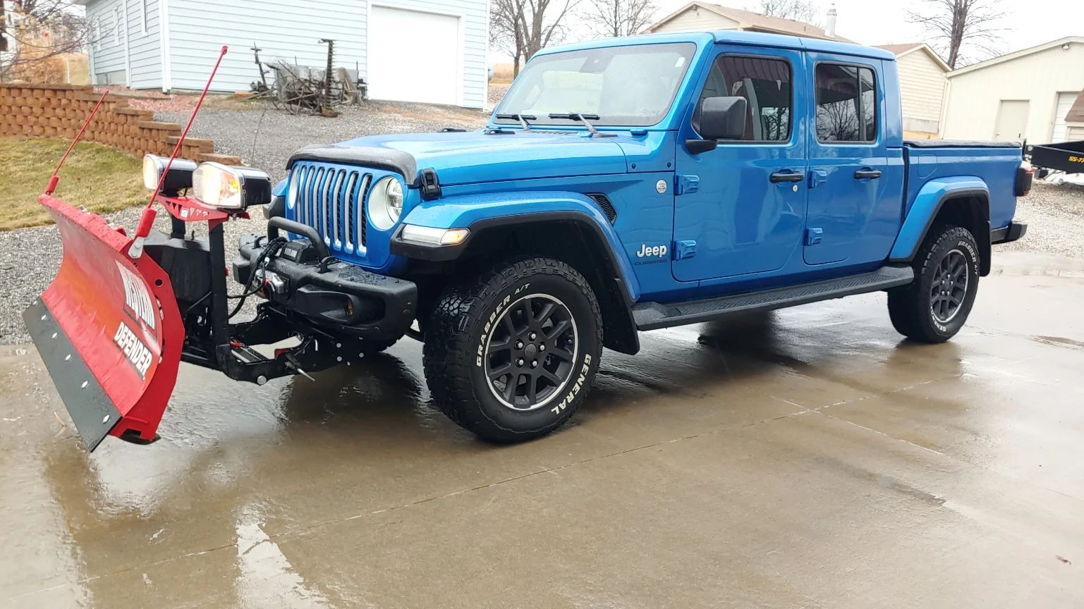

I've had it full-lift on this truck, but just to test functionality - lift, drop, float, left and right tilt, etc.
Here it is, fully raised, on the Overland. I needed the ballast as it made the butt of the Overland really light.

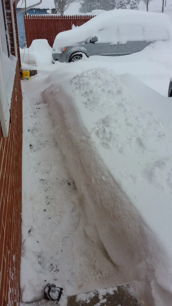

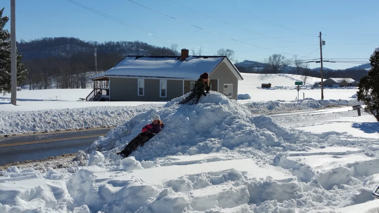

Yeah we got 21" just in January and in some places in the mountians received 150" ,...our record for January is 36.5 ..this past January was probably our worst sin ce 2016 when we got hit by a noreaster..

Bill I was surprised that you were not familiar with that type of coil spring spacers. I've used some as a way of assisting bump stops even. I think it was with my XJ first to help old tired springs then later for that to keep tires out of fenders.
The Mojave X looks interesting with a plow. Now you need to photo shop it in a desert background. ;)
Go for it! That would be fun. My wife talks about maybe a move to Florida some day, I asked her - but we just got a snow plow and all of this winter stuff......... but someone pointed out the plow could be used to clear roads after storms.
I'd seriously never seen that sort of spacer, but it seems like if the plow causes winter issues, it would be better than a permanent spring change. It only needs help when the plow is on, or the heavy brackets are on in the winter.
I remove the brackets in the spring.
The company says "you can leave all mounting hardware in place" but I don't like the loss of ground clearance in the better moths. And I did dig the frame side brackets into the mud that weekend at the Jeep/4x4 weekend.
I'll get more pictures tomorrow, a bit more detail on a few things and post more. And of course if my wife has her way, I'll be plowing snow in November and will get pictures of that as well.
Found them on Amazon - I just need to determine what size might be needed for the Mojave X
This was the first hit -
https://www.amazon.com/Front-Rear-Coil-Spring-Spacer-Accessories/dp/B0DL9TDV1J
I really like that idea - can put them in for winter and remove in the summer.
