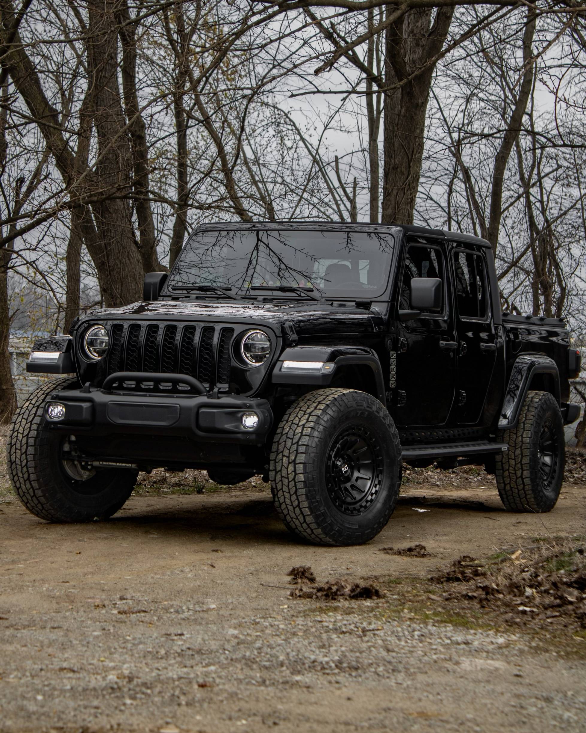

I have 35s on 18s and love them. Perfect world I would go 37s (still on my 18s) but I don't want to regear. I'm content with my 35s even if they were on 17s.
Reason I'm on 18s is cause the Overland comes stock with 18s and shortly after purchase I got rid of the rental car looking tires and bought new Coopers for the stock wheels and ran that for awhile. Rather than buying all new tires when I decided on an aftermarket wheel, I just stayed with 18s and remounted the tires to the new wheel.
But mine are 18x9 with a 0 offset. I don't like a lot of poke. Just enough for me.
Obviously there's more tire options with 17s and both wheels and tires are cheaper. But 18s aren't terrible if you did decide on it

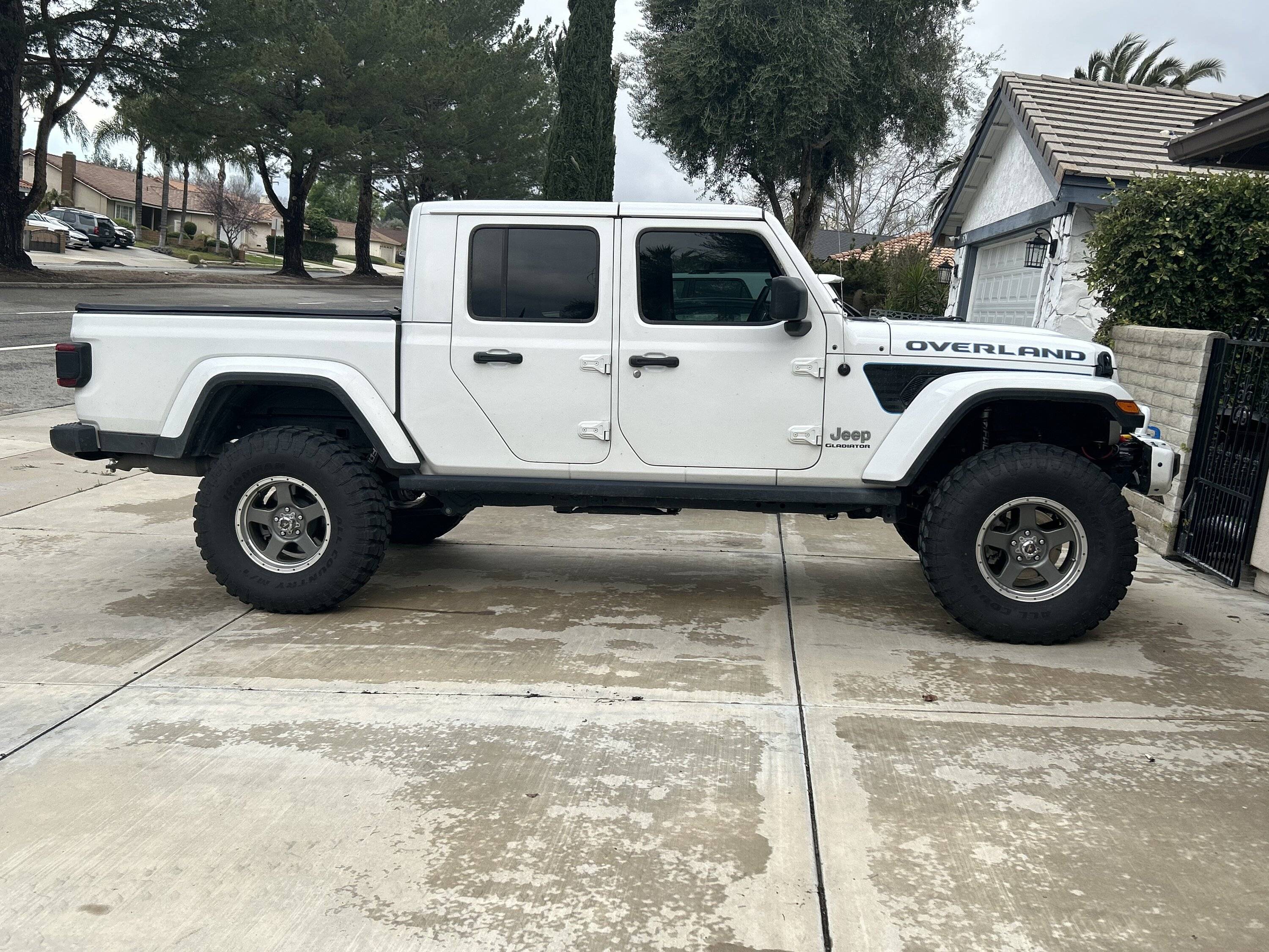

Another vote for 17s, tires are way easier to get than with 18s. I went straight to a 37 on mine.

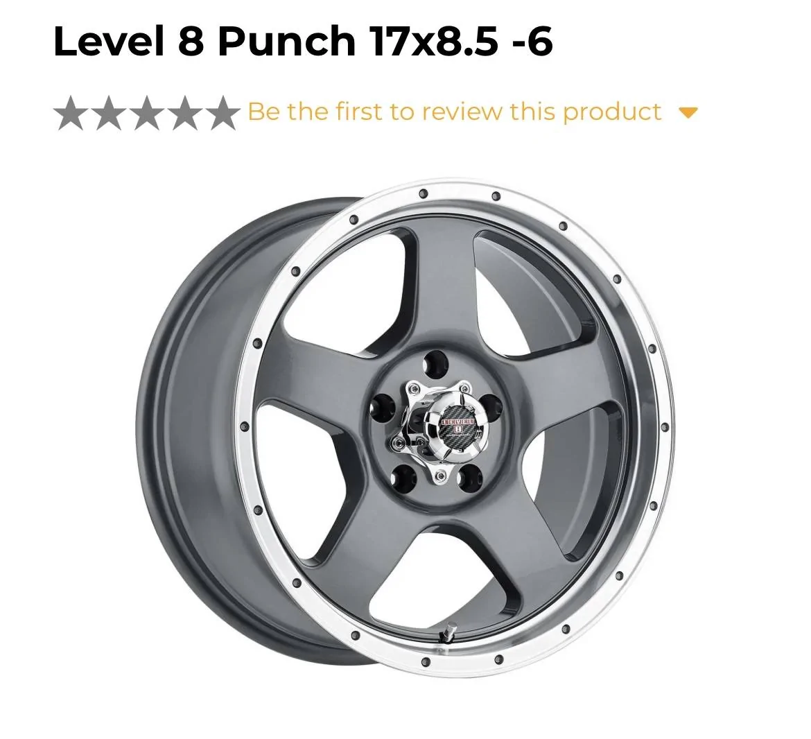

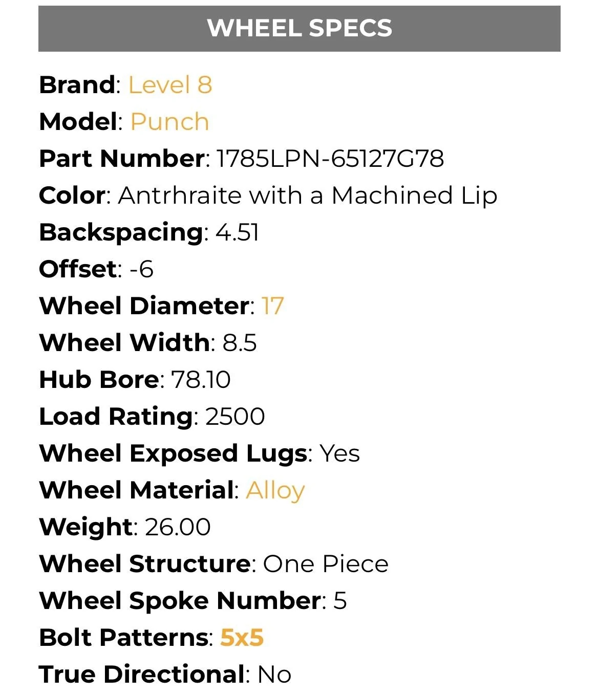

What rims are those? And specs please.
Camaroboi13
Aug 22, 2022
1,810
2,902
SoCal
LEO - Life in Chino
Jeep Gladiator 18" or 17" Wheels? 1427AB7E-F319-4013-AA1D-CDF5D544A509
Jeep Gladiator 18" or 17" Wheels? 7150515A-3B1B-415D-AAF6-1FF3DF86B26B
I bought five of these for $300 bucks new when they were discontinued. Simple, easy to keep clean. I love them.
