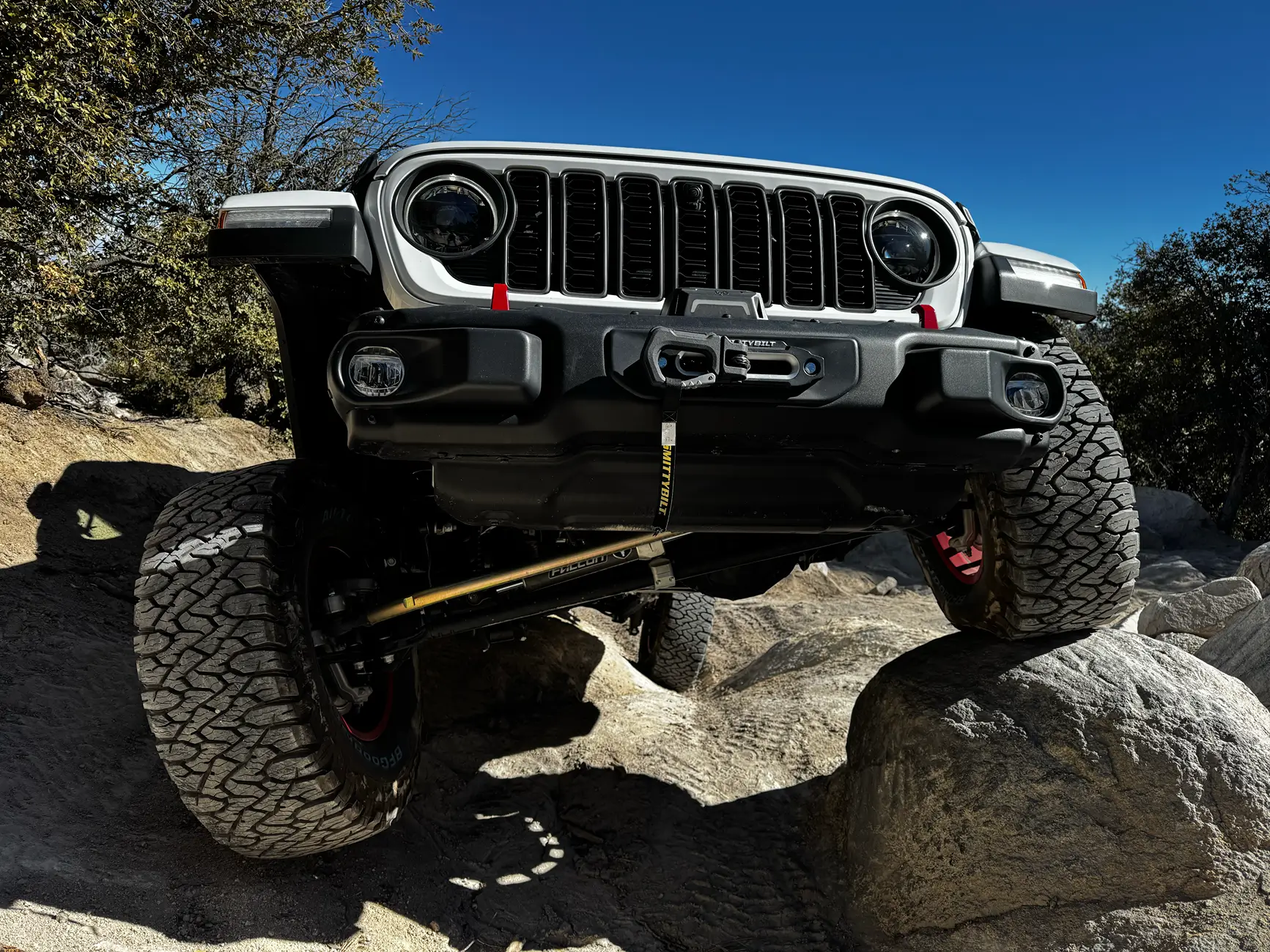

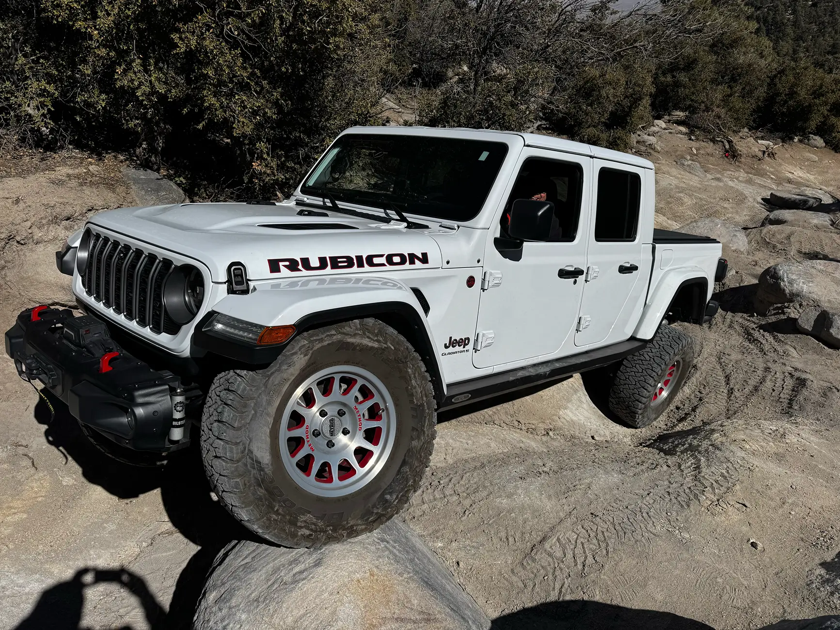

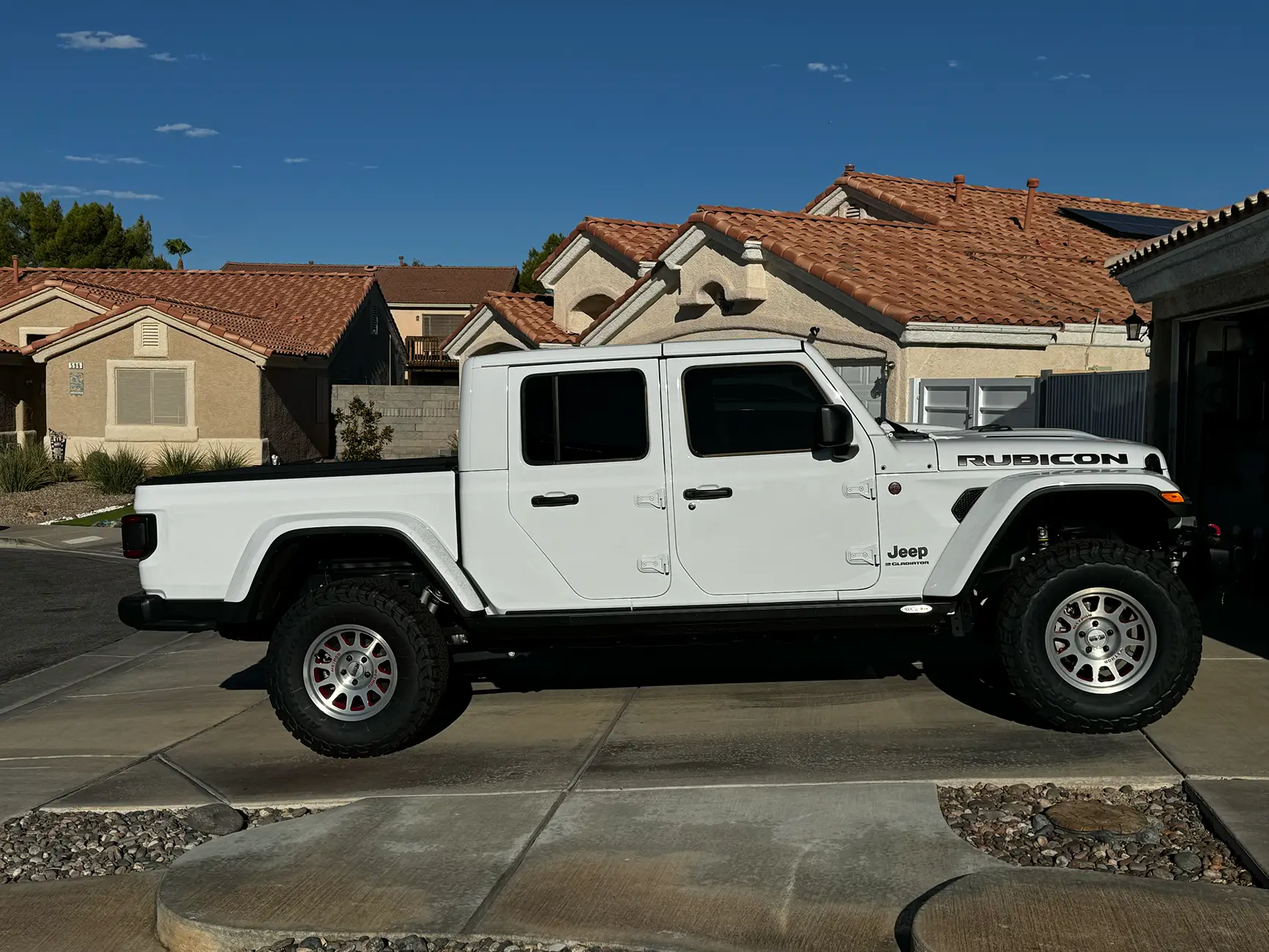

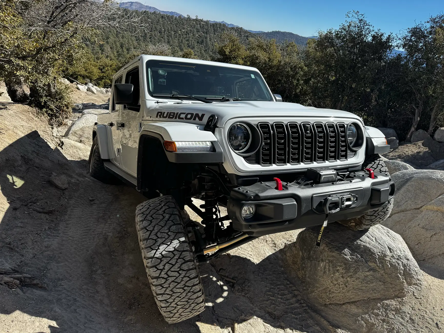

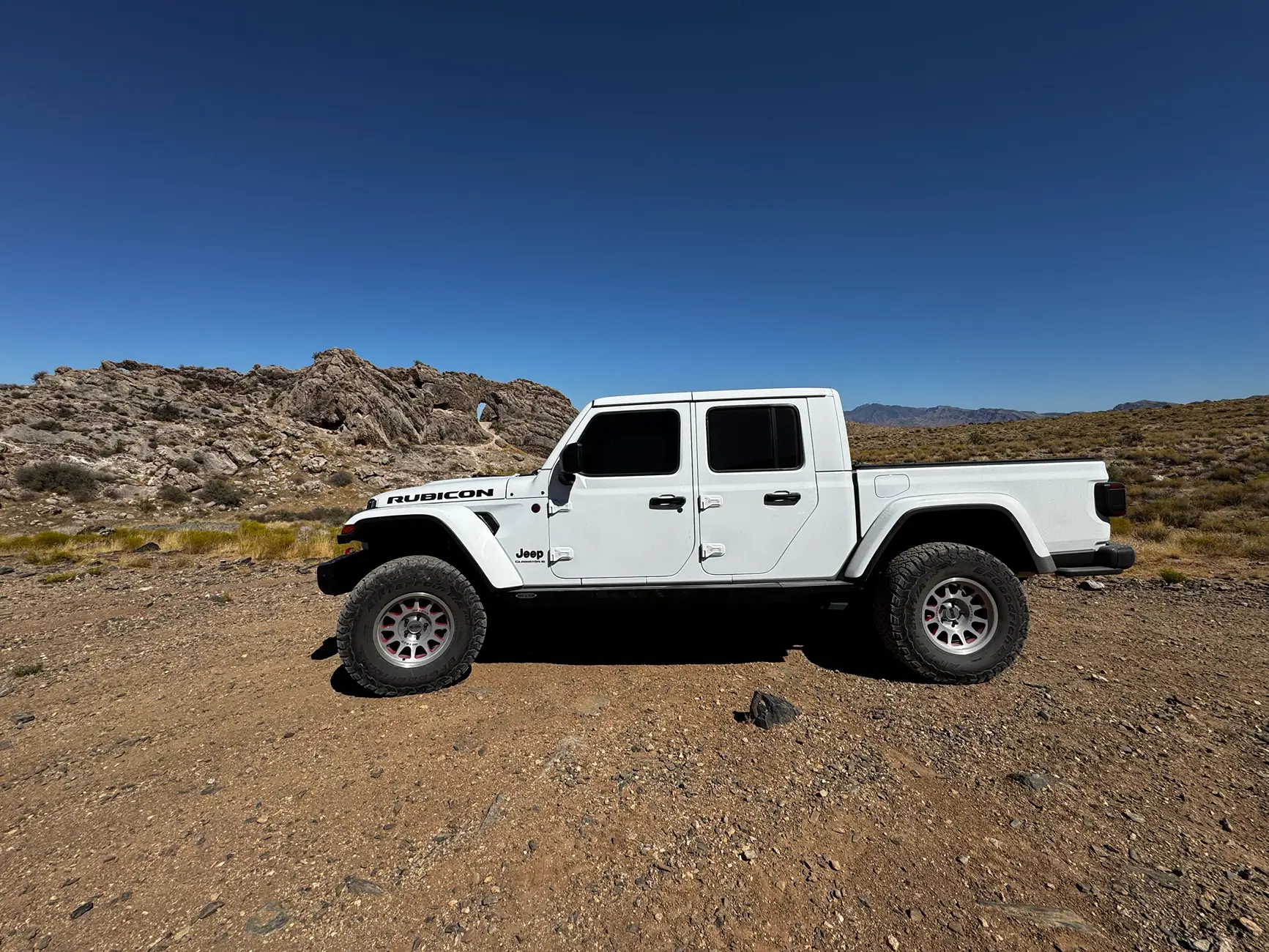

my 2 cents. 24 rubicon, 2" Mopar lift with bilstein shocks. I added Falcon Steering damper and Metal cloak drag link. No drop brackets.
This by far is the best riding truck I have ever owned.
