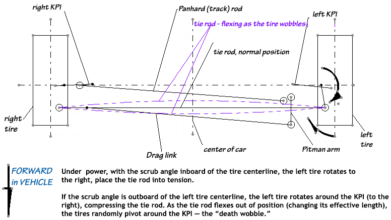

Track bar flexing, loose or worn parts, wheels and tires changed, impacting scrub radius (when people change things for looks rather than function and design and go outside of the engineered parameters)
This is from experts (real ones, not arm-chair experts on the web) -
Norm Layton: "Jeep death wobble" is basically a shimmy, and can affect any suspension with a continuous tie rod (which nearly all solid axles have) to connect the front wheels.
A major cause is improper toe-in or toe-out, with oversized tires.
.....has little to do with design flaws, until design parameters are tampered with, or damaged. It's been around since at least the 1950s, and is not limited to Jeeps.
A steering damper is not a fix, it's a band-aid used to mask issues with either worn components or poor design. Dampers did not start appearing on stock vehicles until the late 70s, mostly associated with the trend to larger (wider thus heavier) tires on older designs.
On a properly designed and well maintained system, a damper's purpose is to mitigate the effects of bump steer and the sudden encounter of unexpected objects, such as hitting a rock in a trail at 50 miles per hour.
On an improperly designed and/or poorly maintained system, a damper is used as a crutch to mask issues with suspension and tire errors.
Jeeps and other vehicles experienced shimmy way before the 1960s, and before the advent of lifts and larger tires. Worn components are just as much at fault as jury-rigged suspensions.
This is from a suspension ENGINEER -
Jeep Gladiator 2021 gladiator death wobble death-wobble
