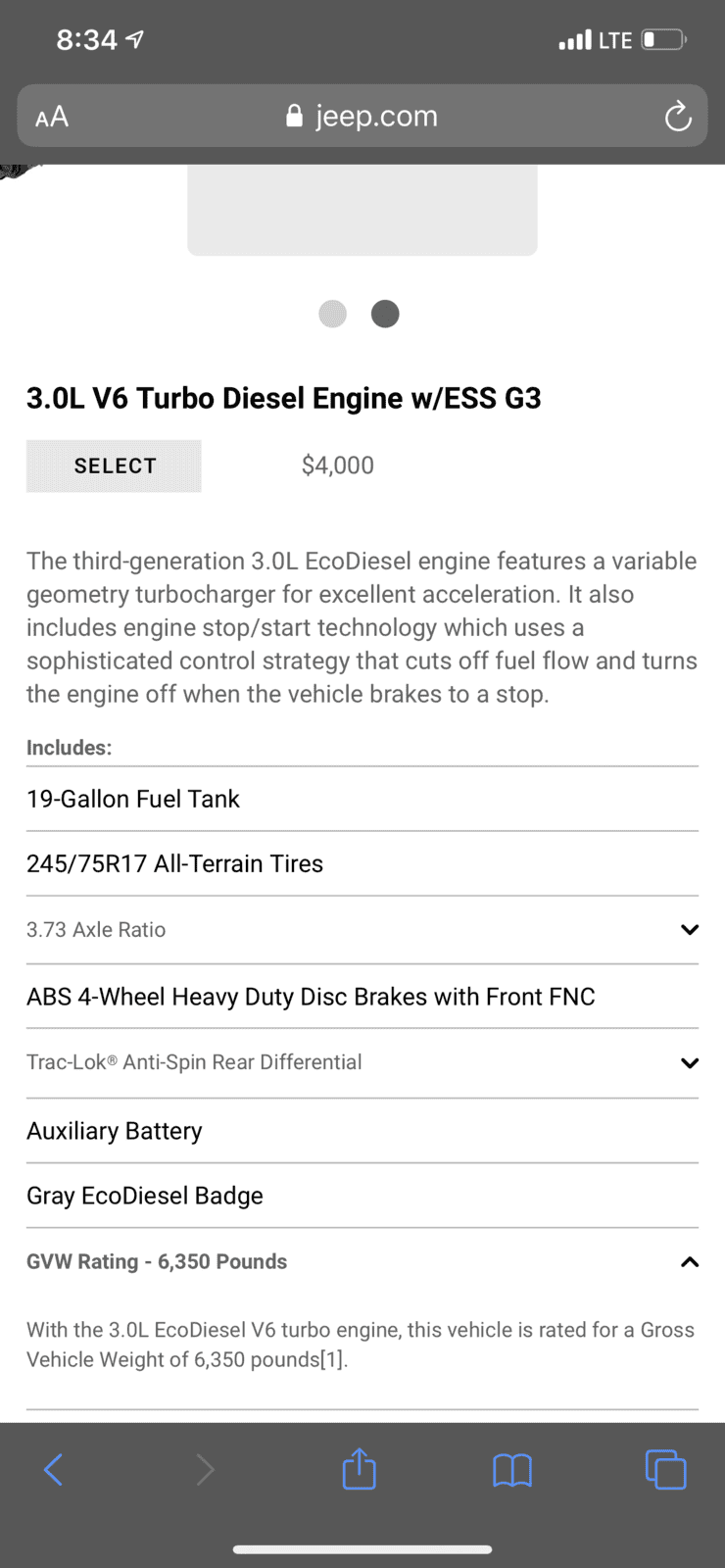

On the Build site, selecting info on the diesel option states "GVW Rating - 6,350 Pounds ", that's 100lbs more than the gas version. How much more does the engine weigh than the gas version? How much weight is different from the 19 vs 22gal fuel tank and DEF tank?
Hi Mr KIA
How did you find that on the Jeep site? I tried to build one and could not find where they stated the 6350? Thanks

Hi Mr KIA
Really had to dig: If you go down to the options in the 2021 order guide, in the "group Detail" section, p23, you see the this-
EXJ 3.0L V6 TURBO DIESEL ENGINE W/ESS G3 E E E
• 19 GALLON FUEL TANK (NF1)
• 245/75R17 BSW A/T DUELER TIRES (TTH) - W/O 2TK OR 2TW
• 3.73 REAR AXLE RATIO (DME)
• ABS 4-WHEEL HD DISC BRAKES W/FRT FNC (BR1)
• ANTI-SPIN DIFFERENTIAL REAR AXLE (DSA)
• 245/75R17 BSW A/T DUELER TIRES (TTH) - W/WAA
• AUX BATTERY (BC1)
• CHROME ECODIESEL BADGE (MW2)
• GRAY ECODIESEL BADGE (MZR)
• GVW RATING - 6350# (Z1C)
• GVW RATING - 6450# (Z1D)
• NON-LOCK FUEL CAP W/ DISCRIMINATOR (XJ4)
• SELECTIVE CATALYTIC REDUCTION (UREA) (XAL)
• STOP-START DUAL BATTERY SYSTEM (XHZ)
• AUX BATTERY (BC1)
• SUPPLEMENTAL HEATER (HDB)
So, looks like JTR D GVW is actually 6450.
