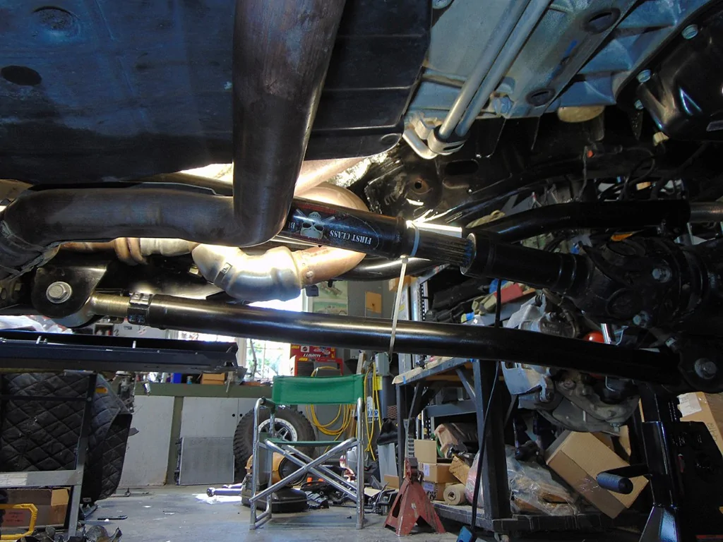

Then the bottom arm...

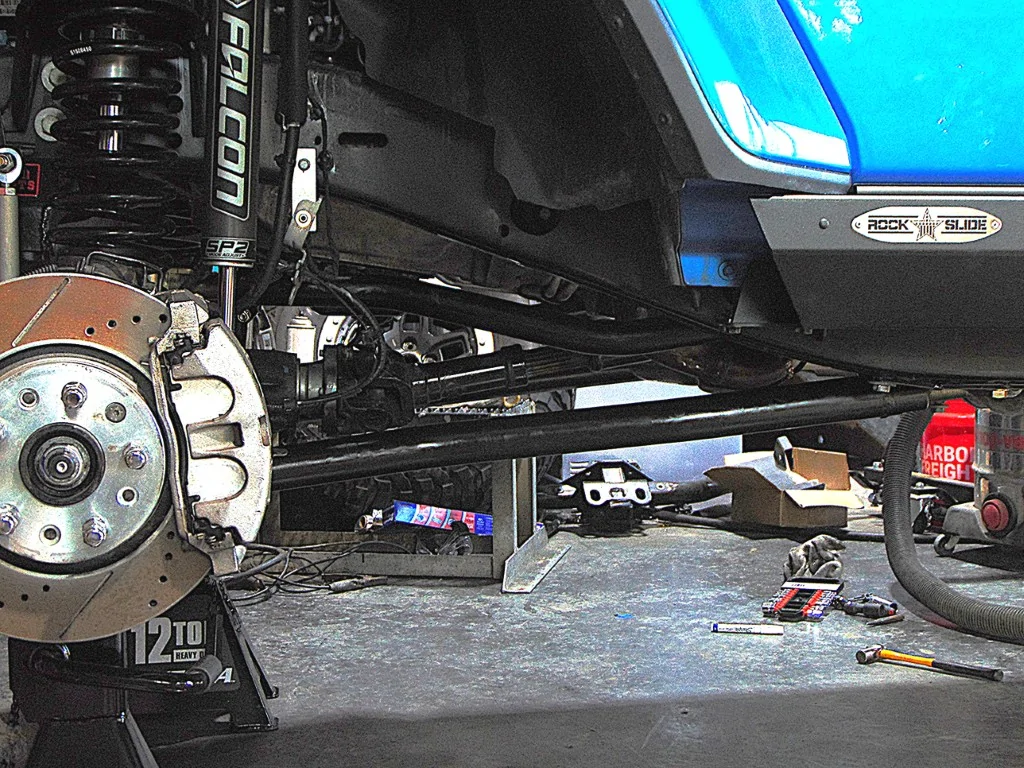

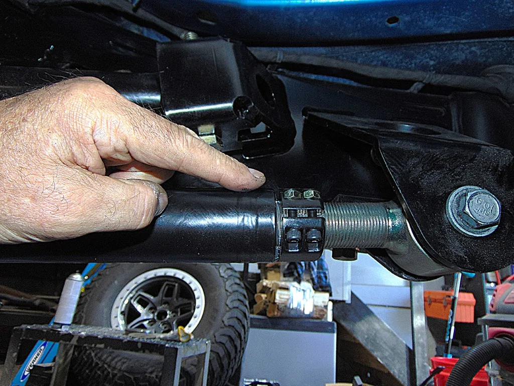

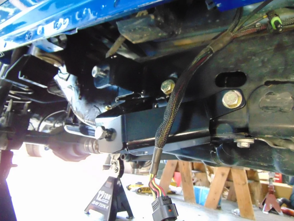

Since the front axle is resting on jack stands simulating the front end resting on the ground, I torqued all the bolts at one time.
With that out of the way, I installed the collar clamp bolts, which secure the threaded ends of the control arms.

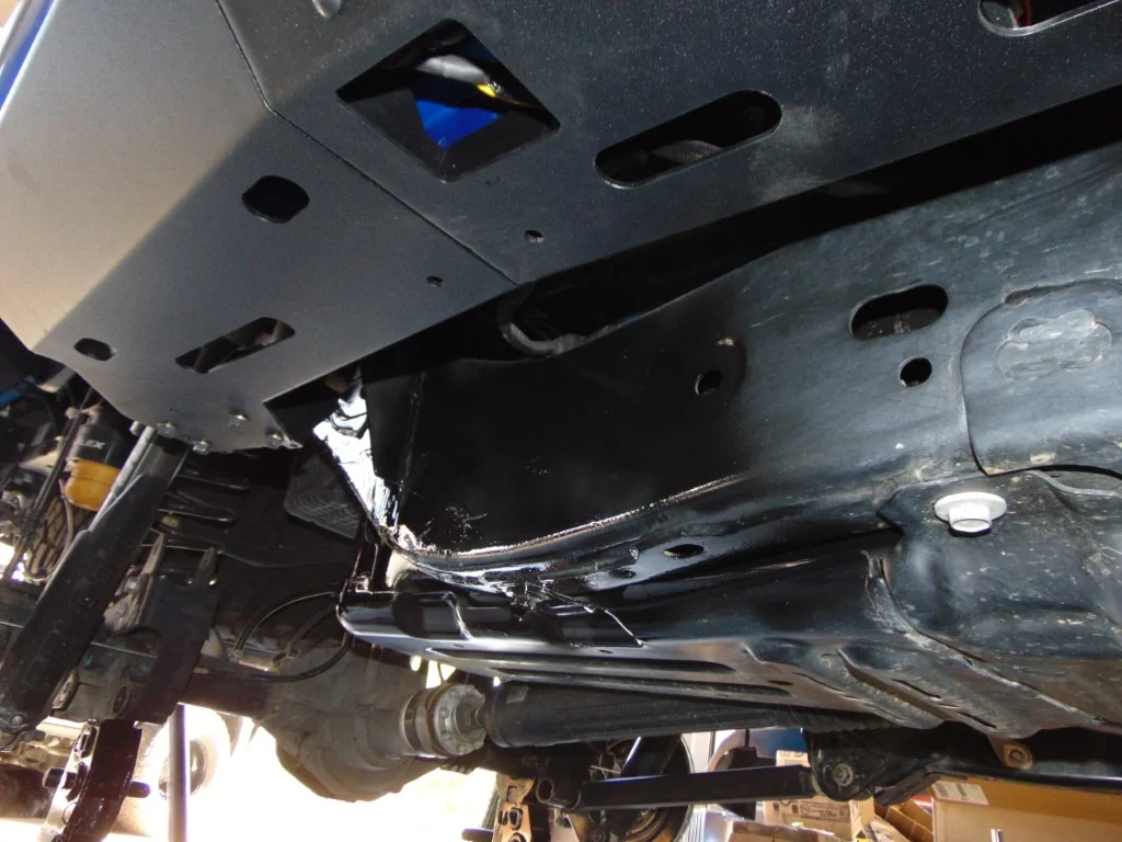

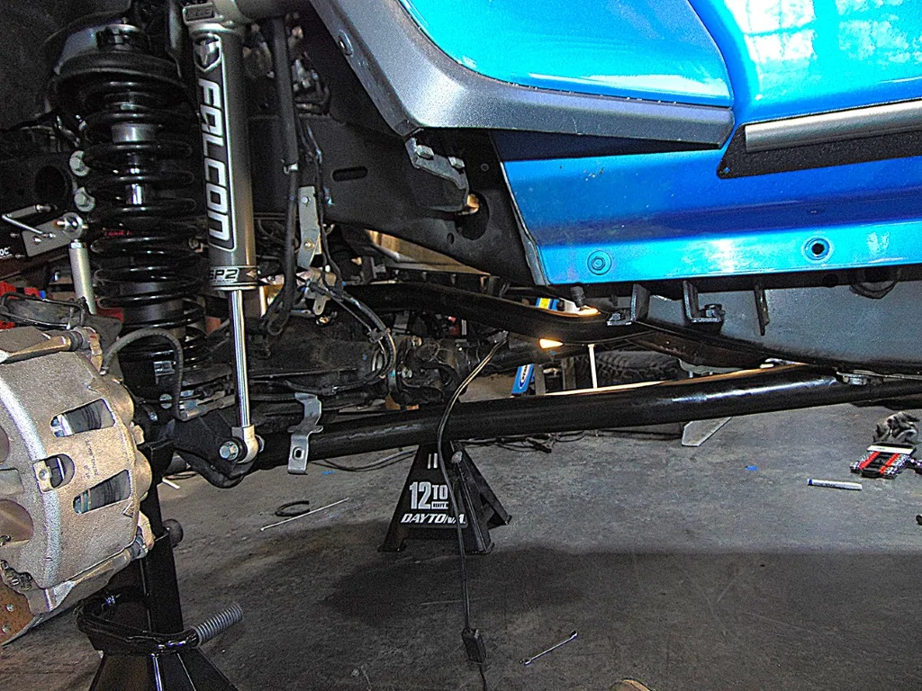

With this long-arm setup, you can no longer use the front skid bar for protection. You can see that it would directly interfere with the movement of the new, longer control arms.

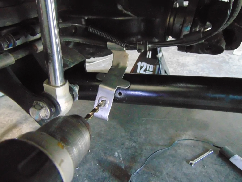

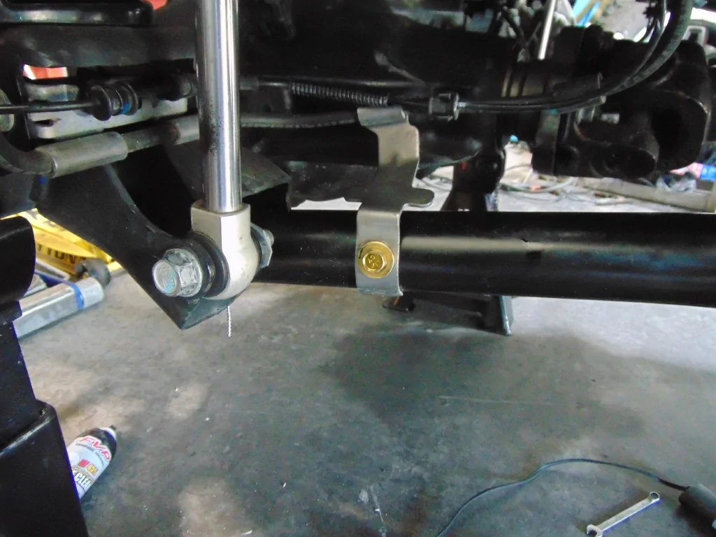

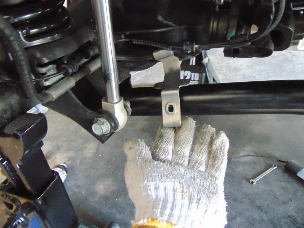

Before leaving the front, during my final inspection, I noticed the brake lines weren't secured.
Clayton and the factory have them bolted to the actual control arm via a bracket.
I decided to drill and tap a hole to restore it to the factory-intended design.
I like how that turned out.

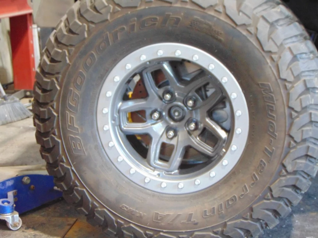

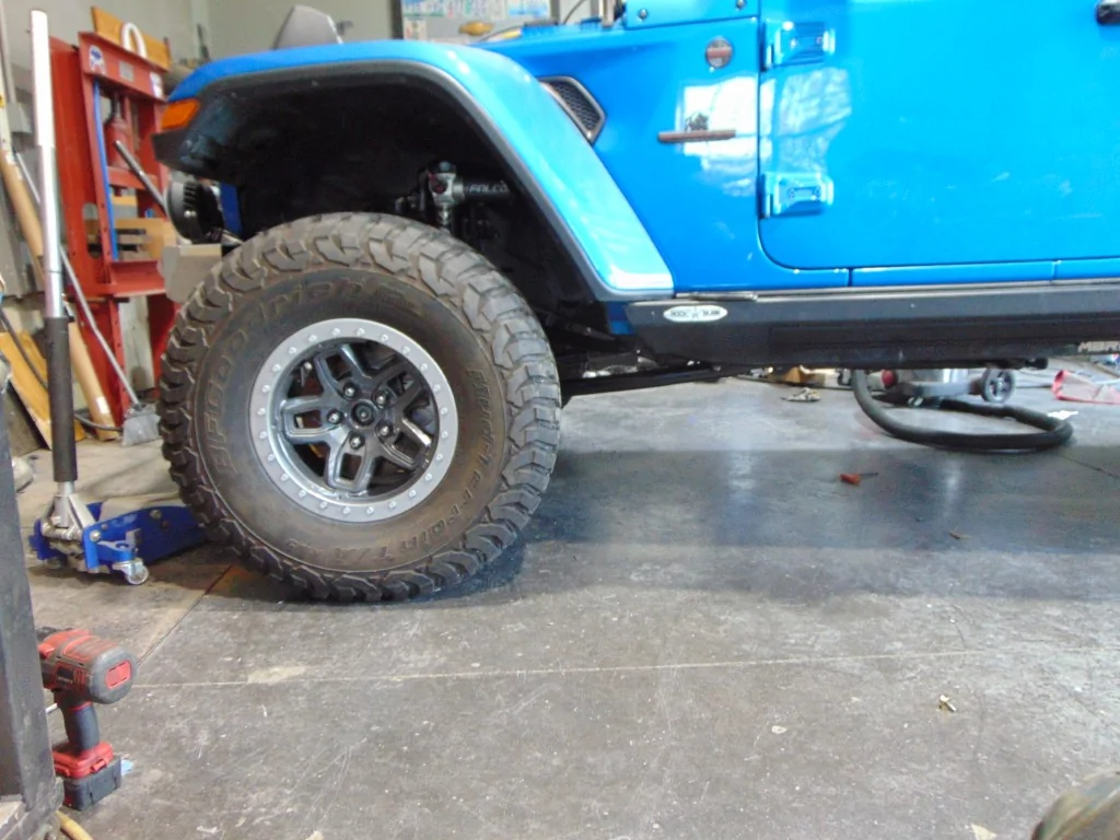

And with that task completed, I tossed the wheels back on and moved operations to the back half.

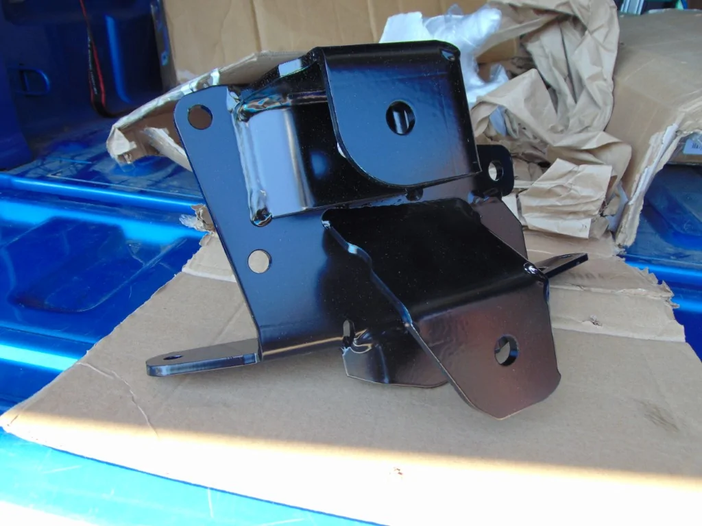

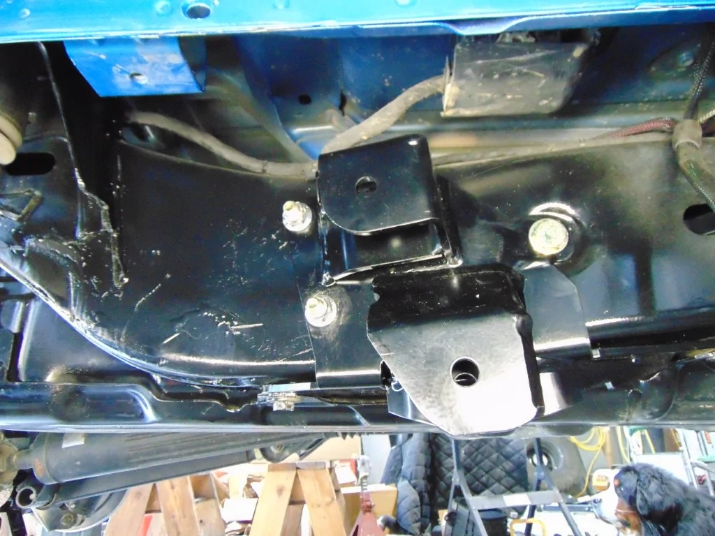

Here we have the outgoing factory bracket and the new replacement
Jeep Gladiator 2022 AEV Gladiator Rubicon build DSC03589 (Medium)
Jeep Gladiator 2022 AEV Gladiator Rubicon build DSC03588 (Medium)

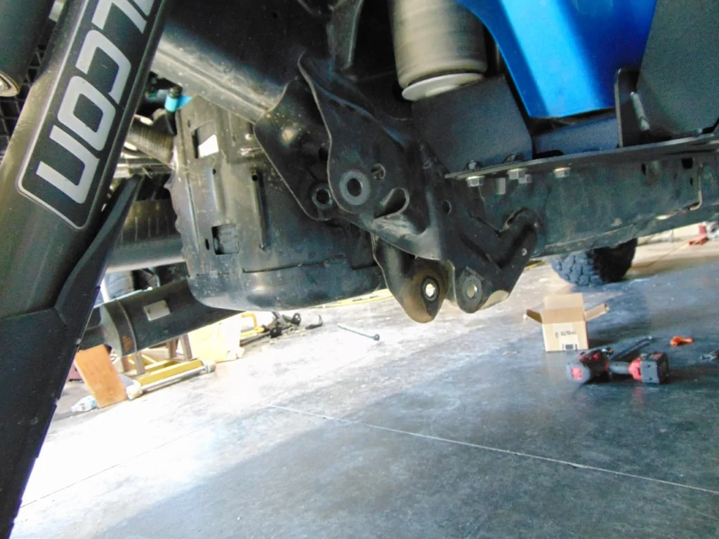

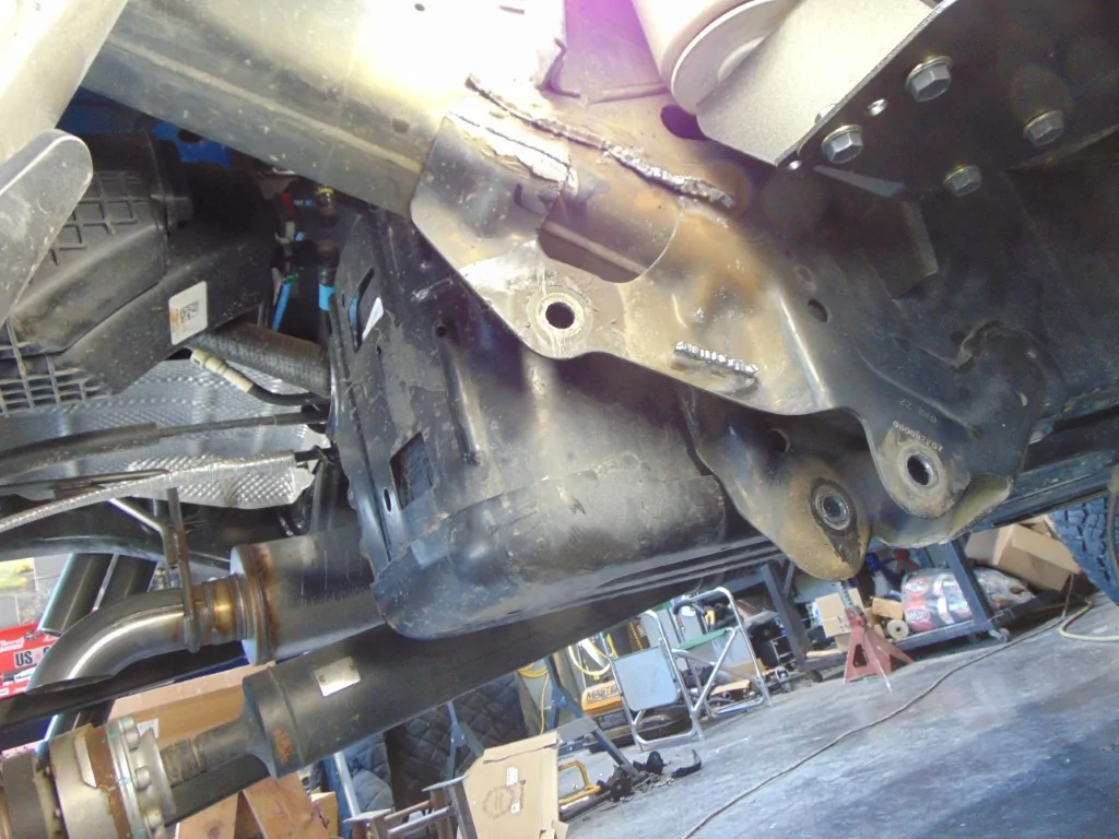

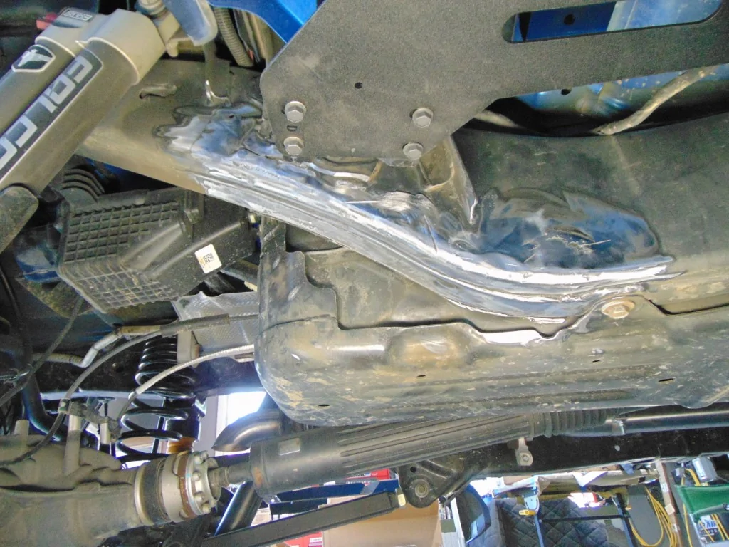

Here is the scary part. While cutting everything apart, it doesn't look or feel good!
Jeep Gladiator 2022 AEV Gladiator Rubicon build DSC03591 (Medium)
Jeep Gladiator 2022 AEV Gladiator Rubicon build DSC03592 (Medium)
Jeep Gladiator 2022 AEV Gladiator Rubicon build DSC03593 (Medium)

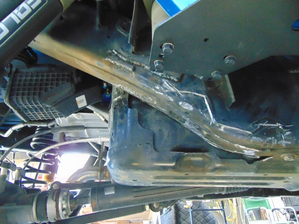

But after spending some quality time with my Dewalt angle grinder, I have this, which is much more pleasing to the eye.

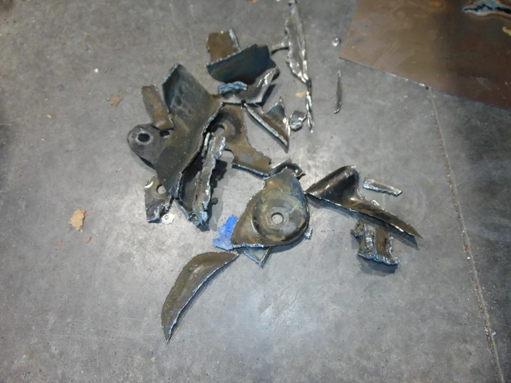

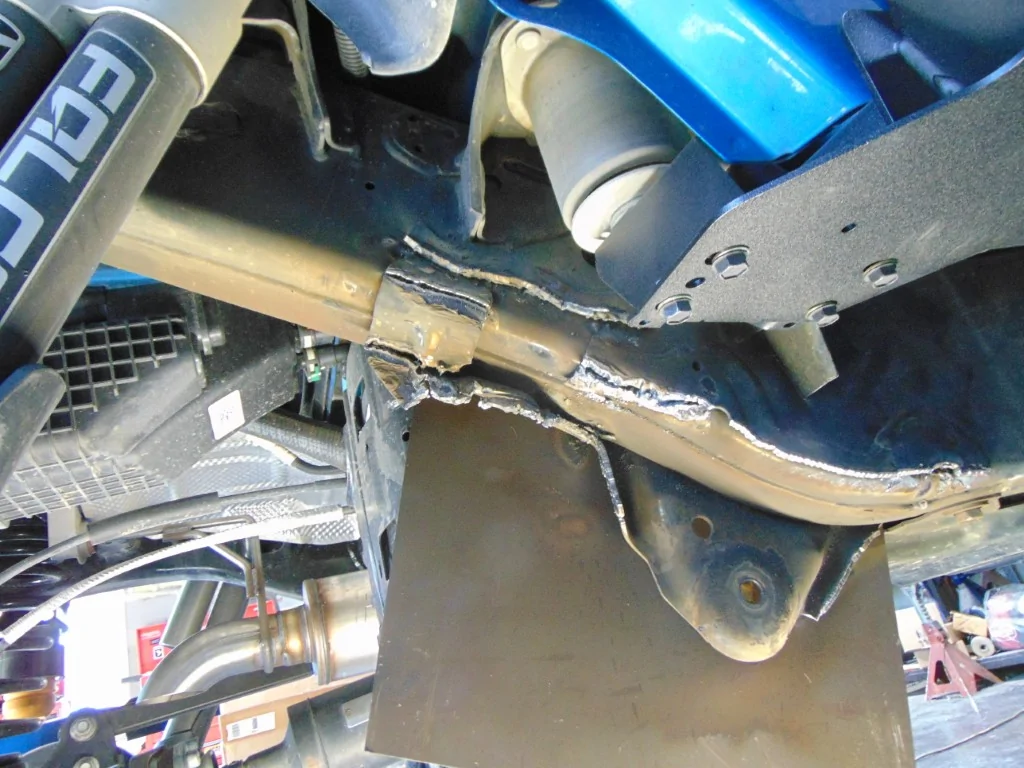

Just look at this pile of scrap metal that used to be a part of my Jeep!
I'd like to make one long cut and remove the bracket. But the better method is to take off a piece at a time, which frees up access to make deeper cuts. With all this being 1/2" from a full gas tank, the pucker factor was quite high.

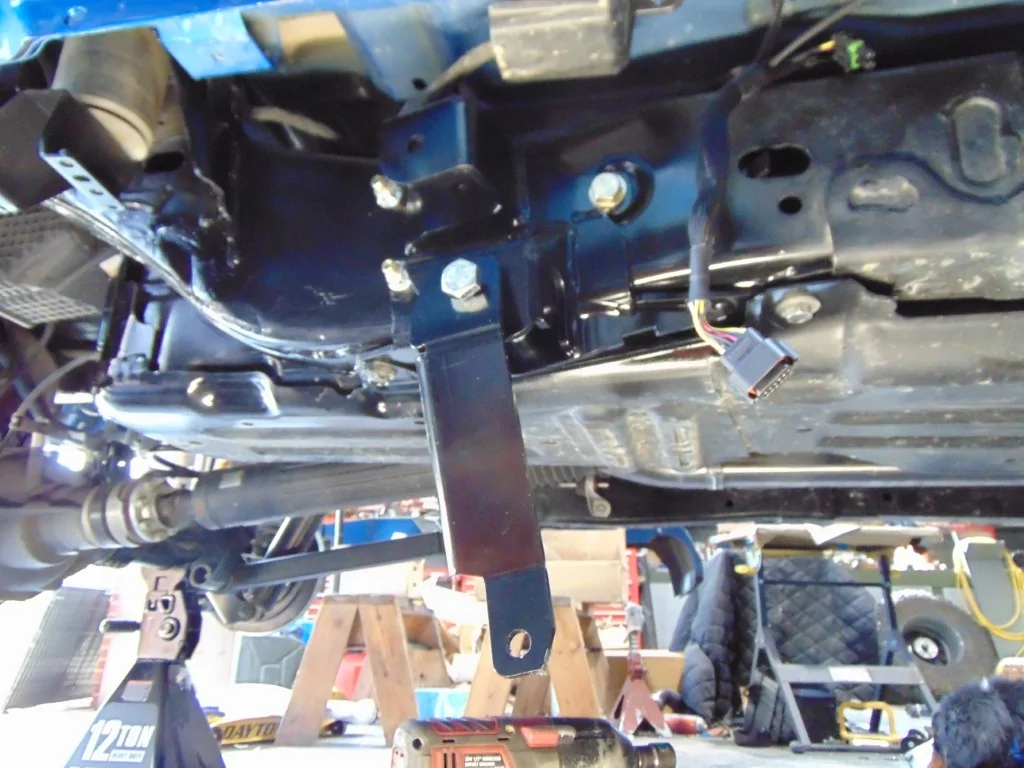

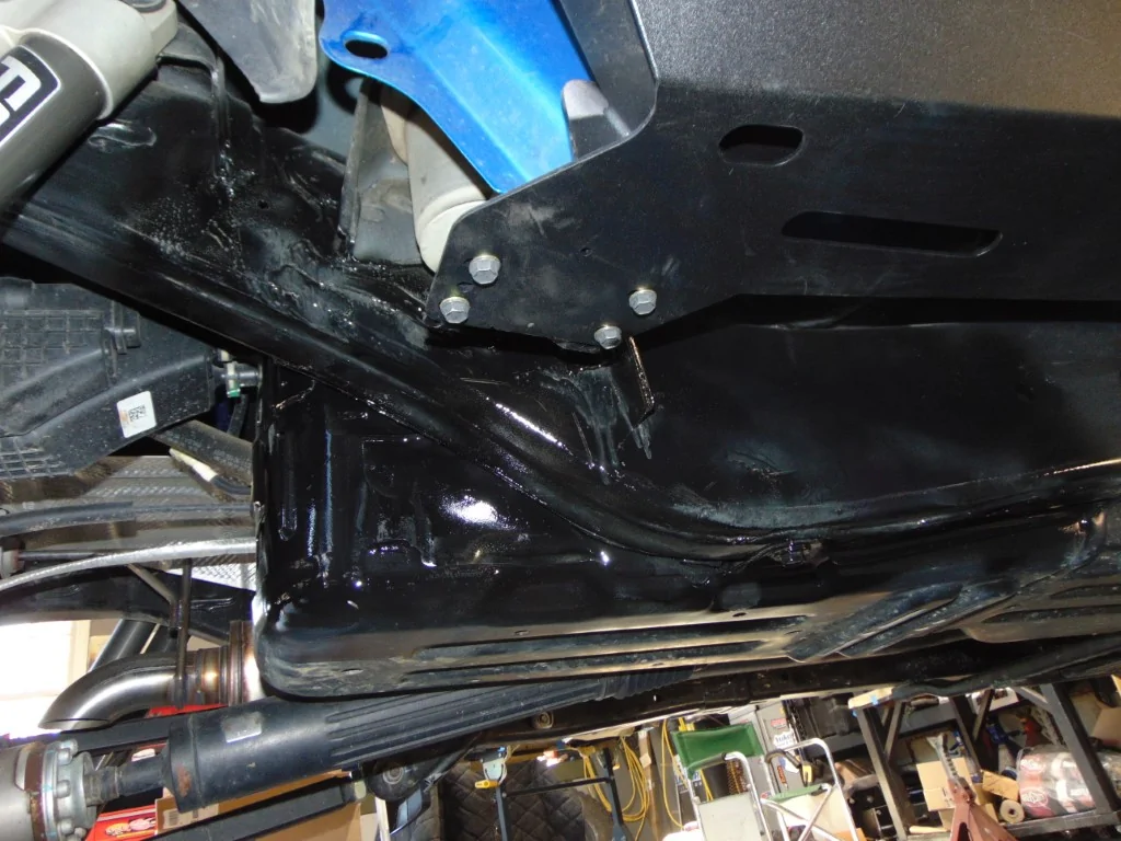

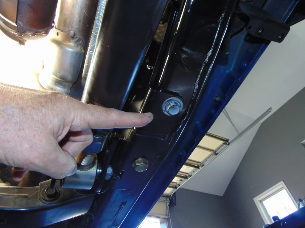

The passenger rear bracket required me to remove the other rock slider to drill one hole...Bummer
But drill that hole I did!
There is a bunch of hardware securing the aft brackets. Most of it needs to be fished from inside the frame from a slot nearly a foot away!

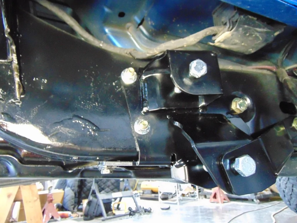

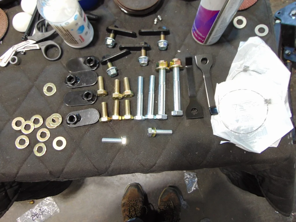

Iron Rock supplied an ingenious "fish wire" which screws onto the threaded end of a stud. You then "fish" the other end from a nearby opening to the hole you need. Then you simply pull the stud through and attach the nut.
Having done that several times, the first rear bracket was securely mounted.
Jeep Gladiator 2022 AEV Gladiator Rubicon build DSC03600 (Medium)

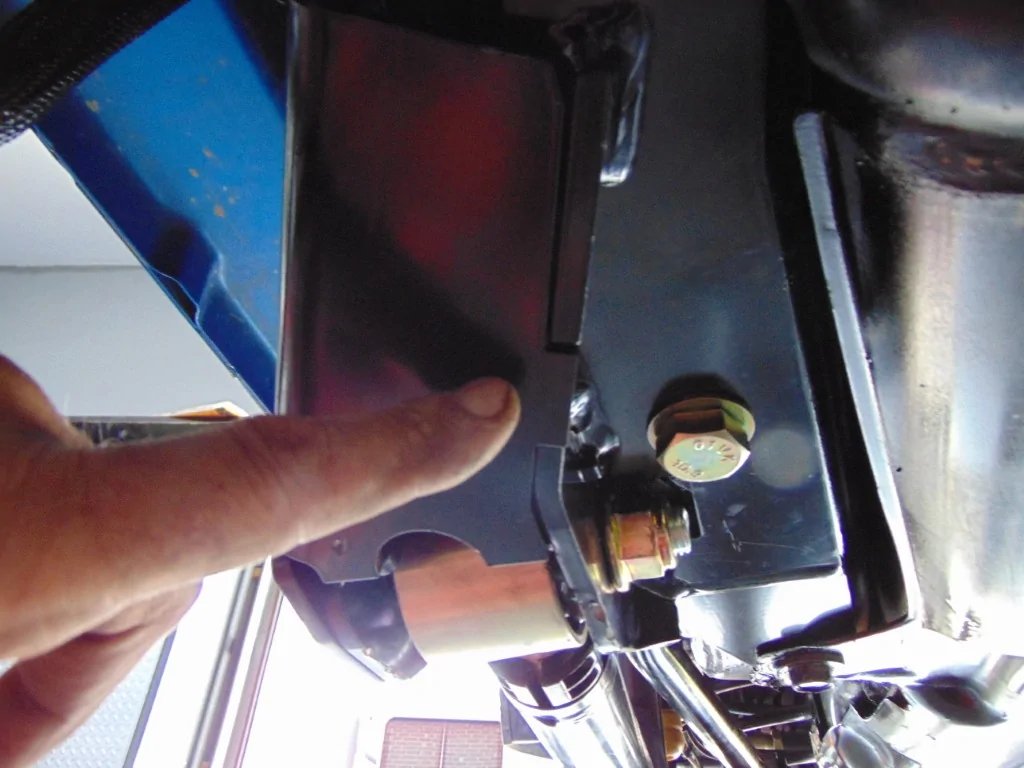

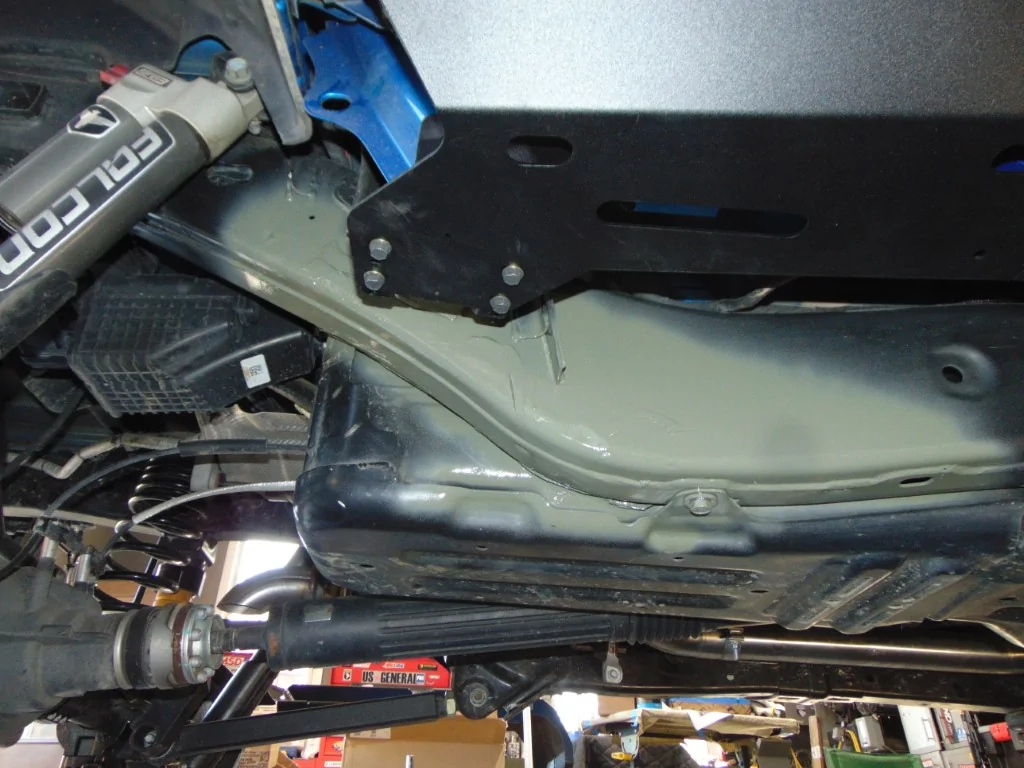

They seem to have thought of everything. The bracket even incorporates a rub rail that keys into the mount itself.
Jeep Gladiator 2022 AEV Gladiator Rubicon build DSC03601 (Medium)
Jeep Gladiator 2022 AEV Gladiator Rubicon build DSC03602 (Medium)
Jeep Gladiator 2022 AEV Gladiator Rubicon build DSC03603 (Medium)
Jeep Gladiator 2022 AEV Gladiator Rubicon build DSC03609 (Medium)

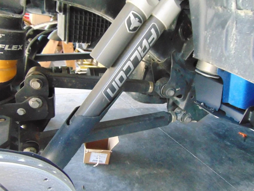

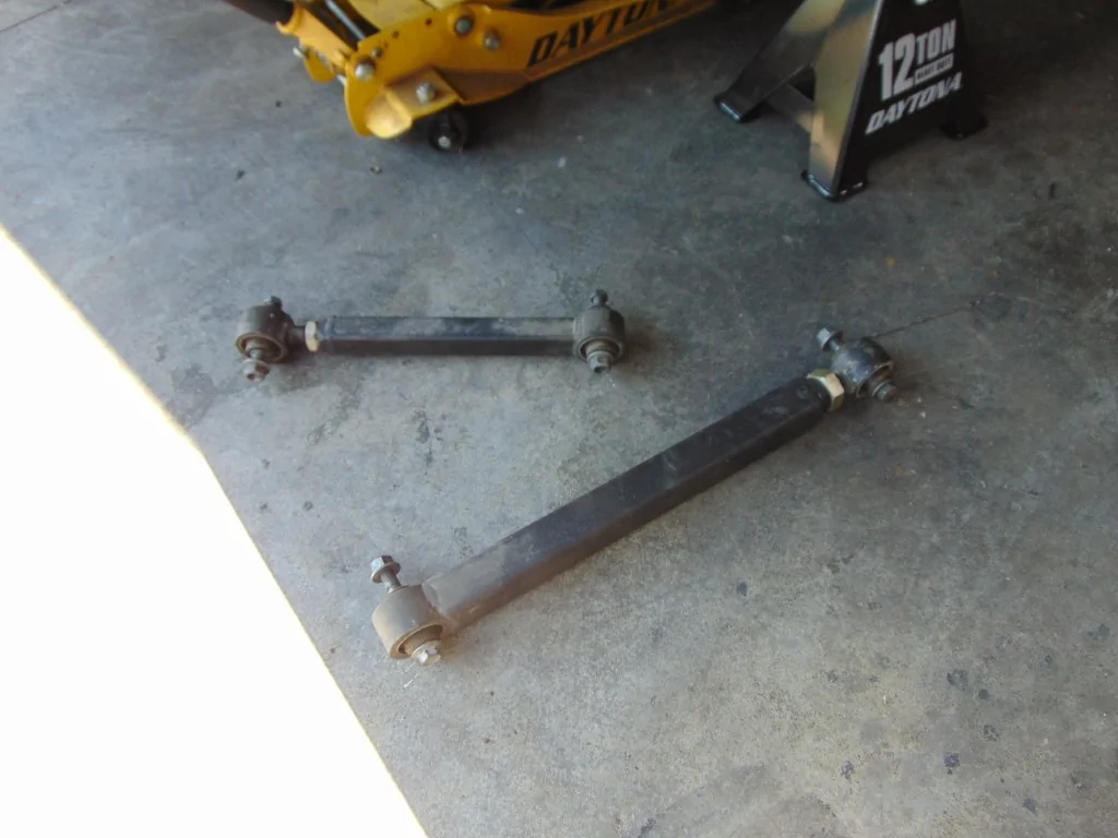

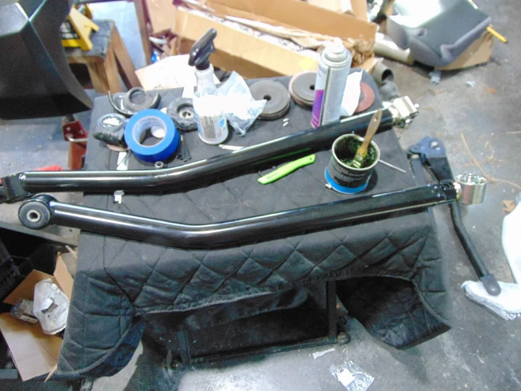

Next, I assembled the four rear control arms. Man they are long!
Jeep Gladiator 2022 AEV Gladiator Rubicon build DSC03604 (Medium)
