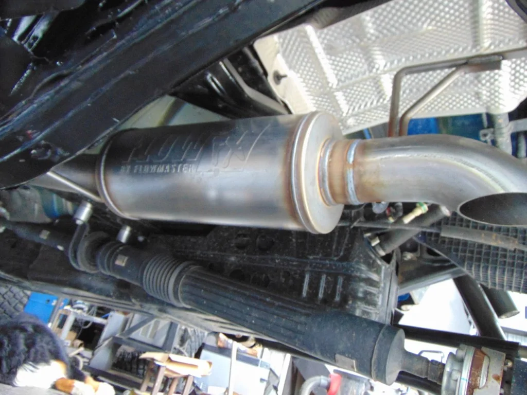

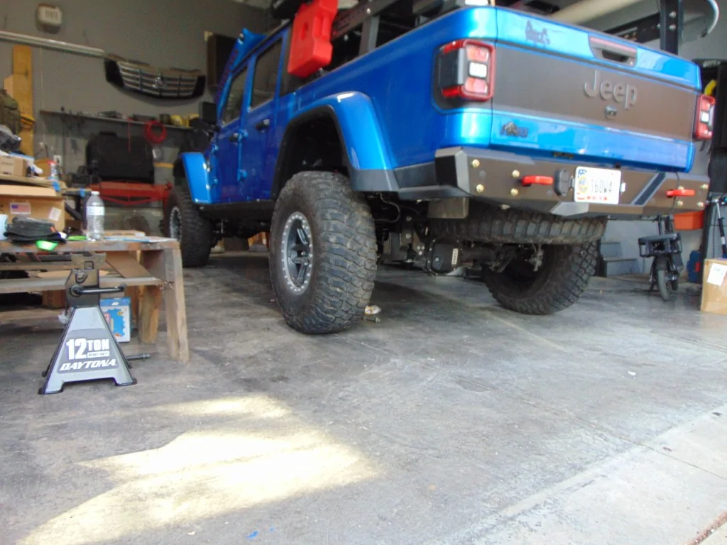

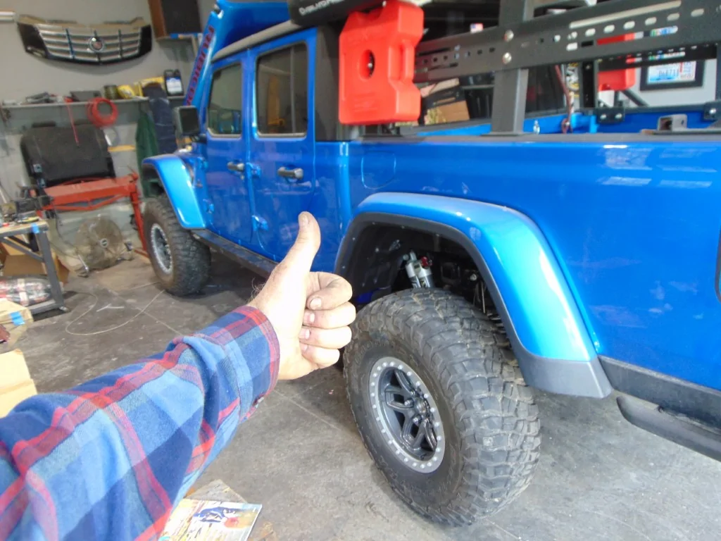

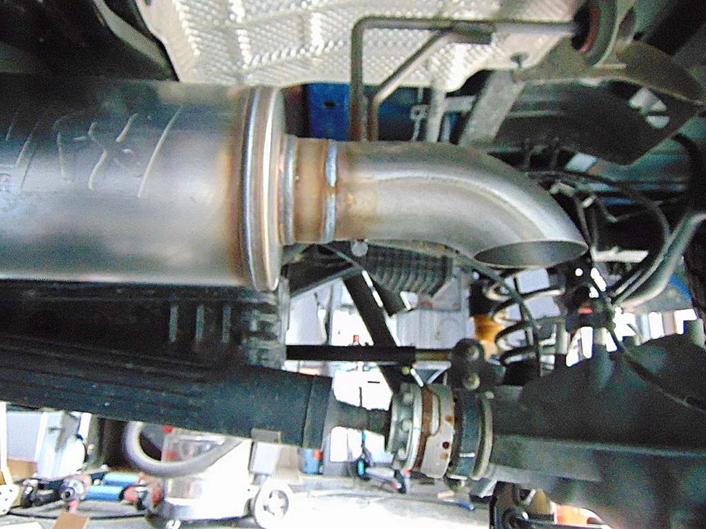

I'm liking this newer FlowMaster exhaust, although it would be going bye-bye if I decide to install a Hemi.
Jeep Gladiator 2022 AEV Gladiator Rubicon build DSC03629 (Medium)
Jeep Gladiator 2022 AEV Gladiator Rubicon build DSC03630 (Medium)

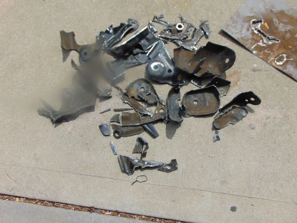

...And finally, no more cutting and grinding. Here are the four corners of the factory bracket parts. Each of those pieces took from a couple of minutes to ten or more, so you can appreciate how much work it really takes to install any long-arm suspension.
But, I'm in the home stretch at the moment, about to finish this conversion to a better suspension.
Jeep Gladiator 2022 AEV Gladiator Rubicon build DSC03621 (Medium)

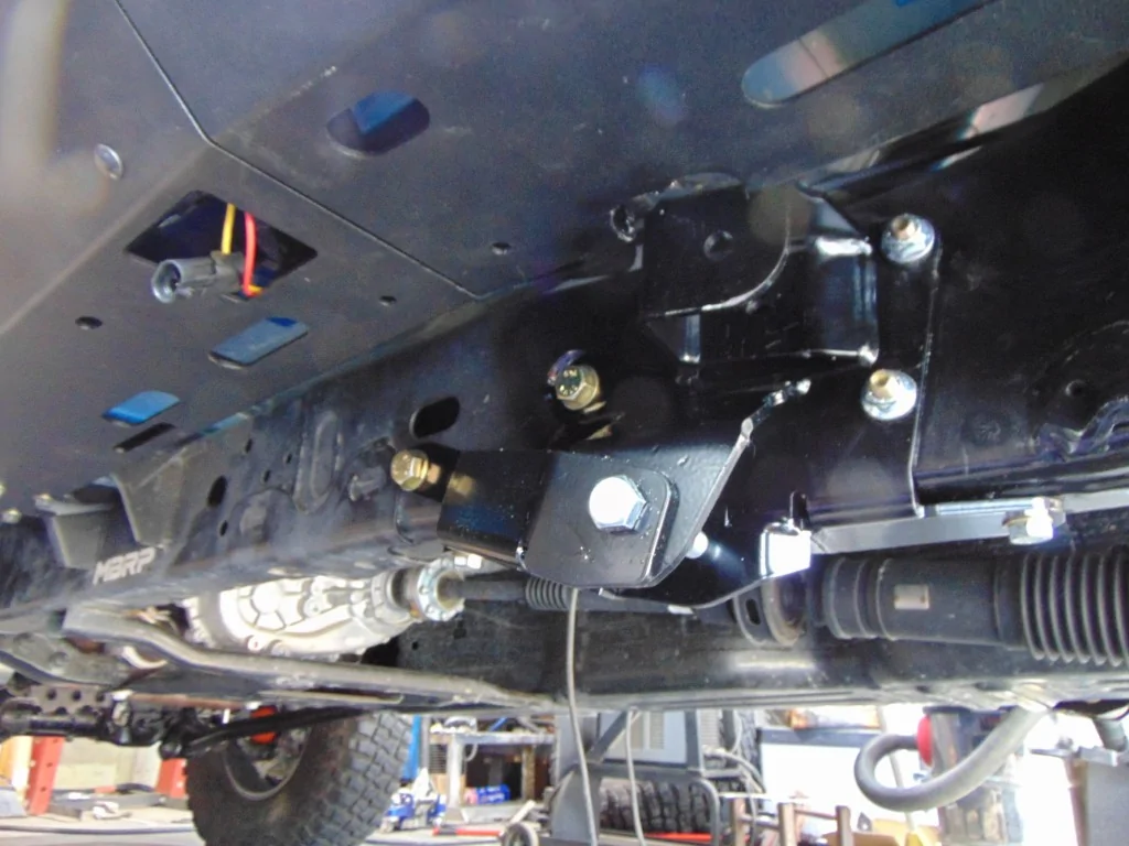

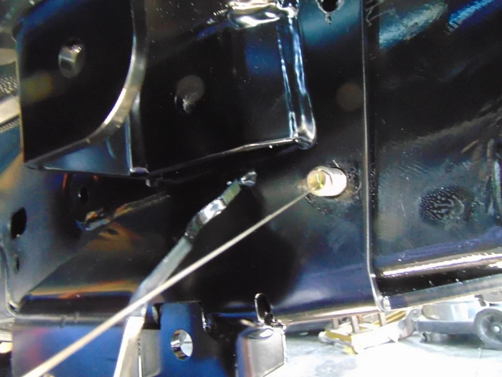

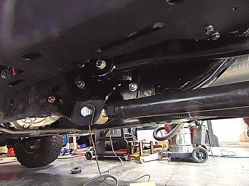

OK time to finish this long arm conversion.
Today, with the driver's rear corner remaining undone and with the paint dry, the final bracket was bolted on.
The fish wire made this part of the task much easier. The wire is prebent to form "threads" that you screw the bolt into. Those windings hold the bolt securely and allow you to pull the nut plate through the frame into the backside of the hole you are addressing.
Jeep Gladiator 2022 AEV Gladiator Rubicon build DSC03631 (Medium)

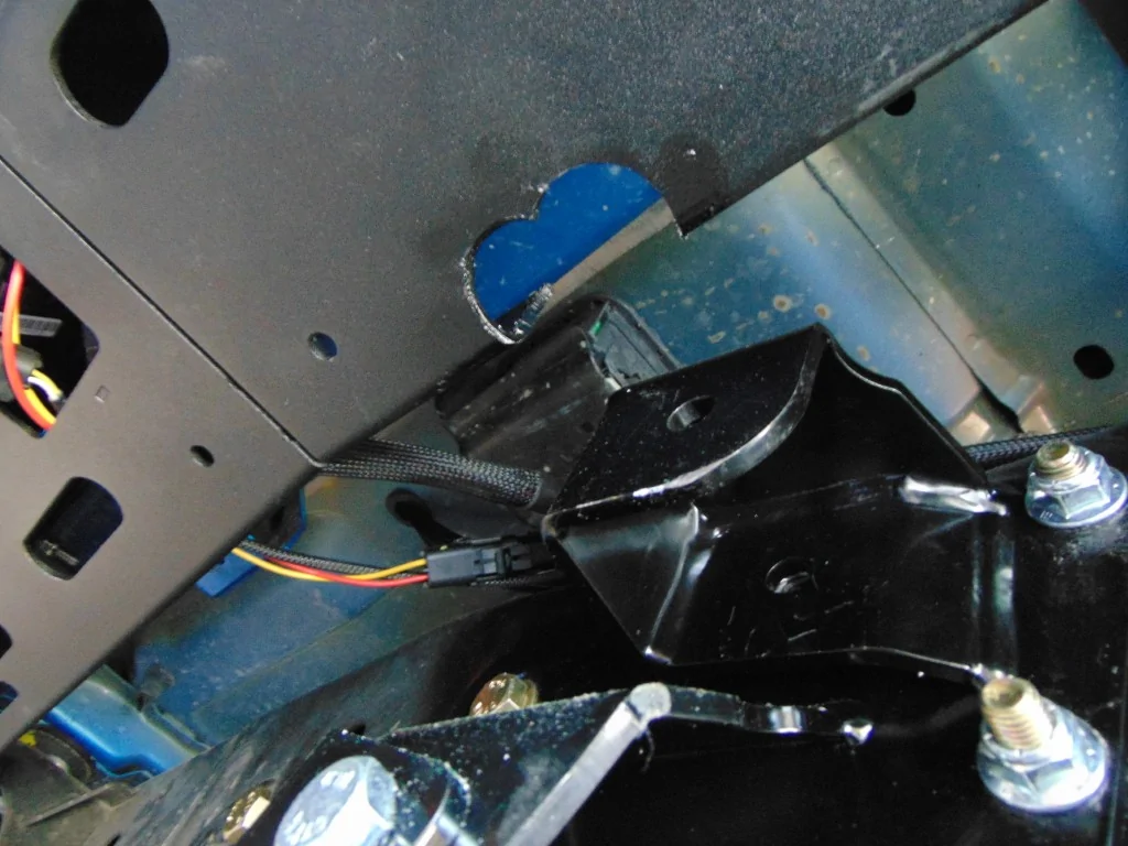

The various bolts, nut plates, and "fished" plates were all bolted in and torqued.
I had to make a clearance cut for the UCA bolt. I'll fashion an angle support to strengthen this area back to where it should be.
Jeep Gladiator 2022 AEV Gladiator Rubicon build DSC03632 (Medium)
Jeep Gladiator 2022 AEV Gladiator Rubicon build DSC03633 (Medium)

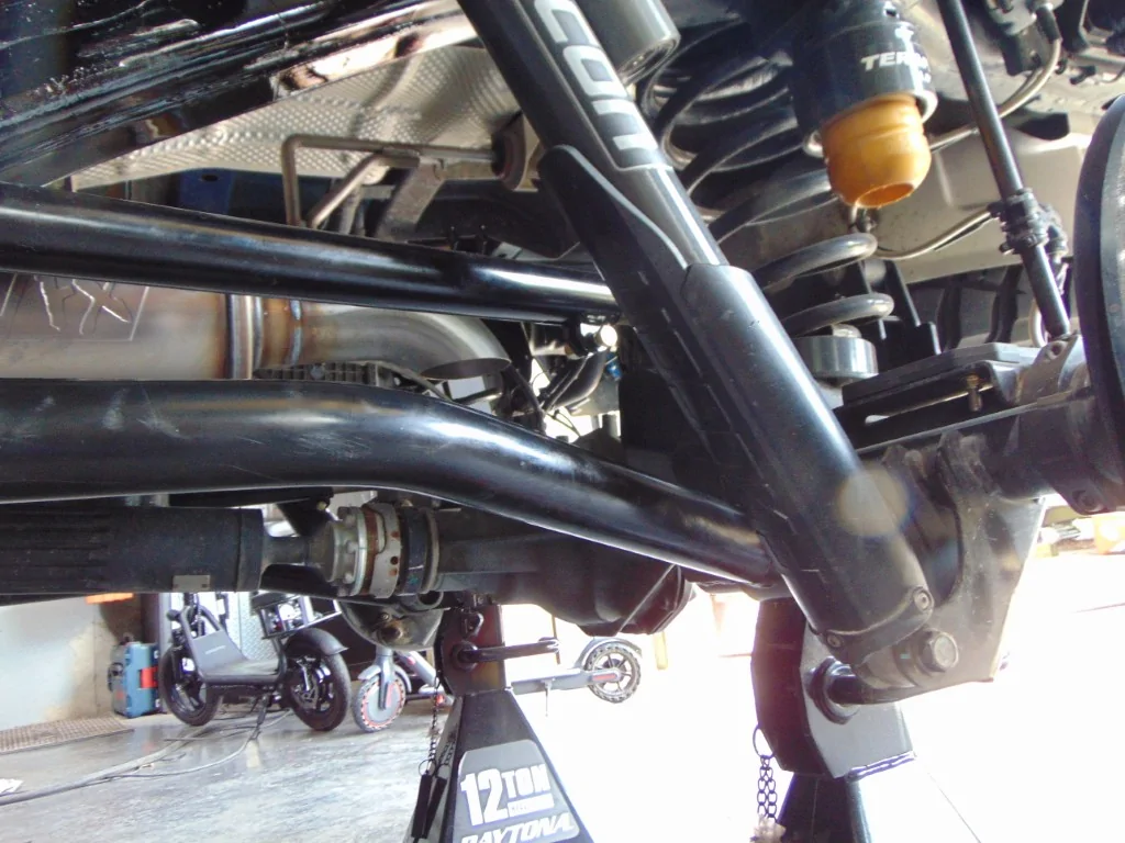

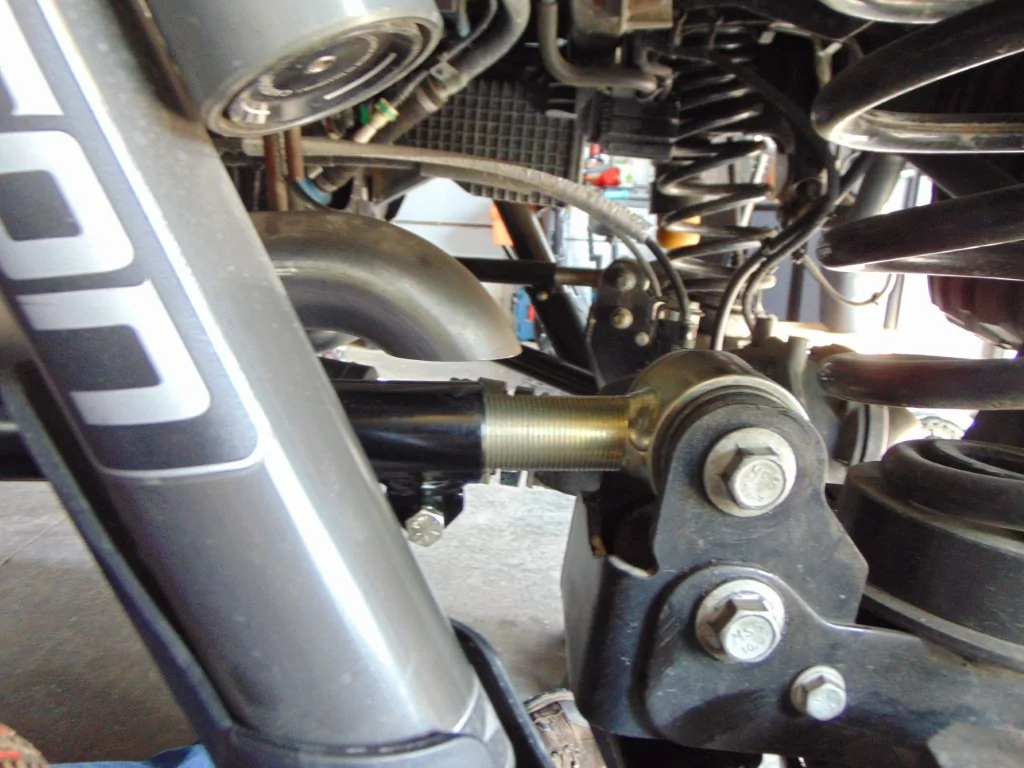

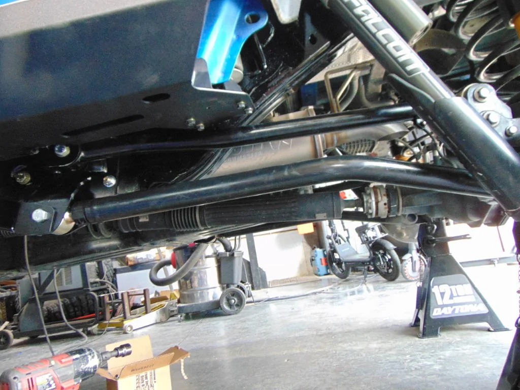

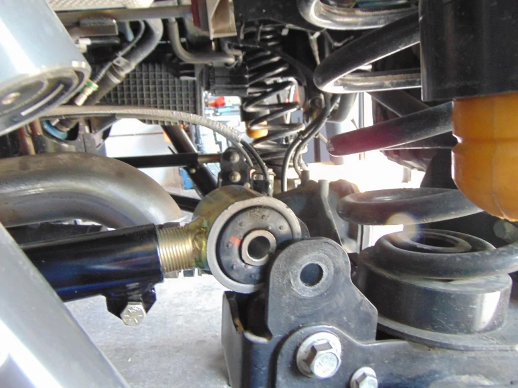

And then the control arms.
Note that I am retaining the excellent Terra Flex rear brackets, which completely fix the rear driveshaft angle, keeping it nearly aligned throughout the axle's up-down travel.
Jeep Gladiator 2022 AEV Gladiator Rubicon build DSC03635 (Medium)
Jeep Gladiator 2022 AEV Gladiator Rubicon build DSC03636 (Medium)
Jeep Gladiator 2022 AEV Gladiator Rubicon build DSC03637 (Medium)
Jeep Gladiator 2022 AEV Gladiator Rubicon build DSC03638 (Medium)
Jeep Gladiator 2022 AEV Gladiator Rubicon build DSC03639 (Medium)

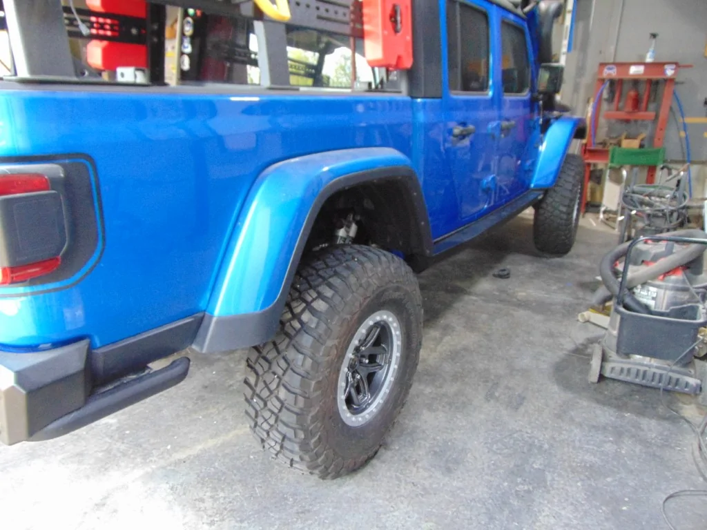

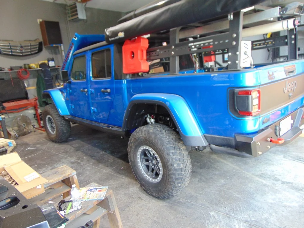

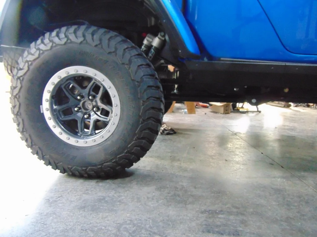

I cleaned everything up, waxed the backside of the wheels, then reinstalled them. Finally, I greased the new joints and called it a day.
Long arm suspension install is in the bag.
Jeep Gladiator 2022 AEV Gladiator Rubicon build DSC03642 (Medium)
Jeep Gladiator 2022 AEV Gladiator Rubicon build DSC03643 (Medium)
Jeep Gladiator 2022 AEV Gladiator Rubicon build DSC03644 (Medium)
Jeep Gladiator 2022 AEV Gladiator Rubicon build DSC03645 (Medium)
Jeep Gladiator 2022 AEV Gladiator Rubicon build DSC03646 (Medium)
