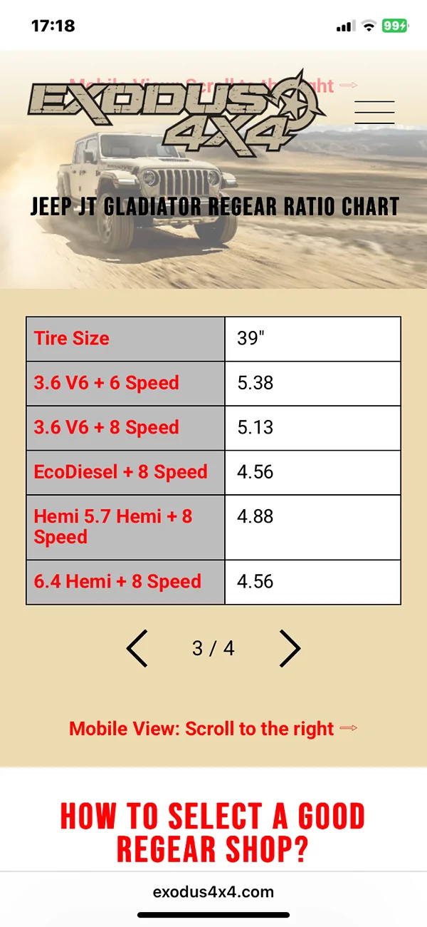

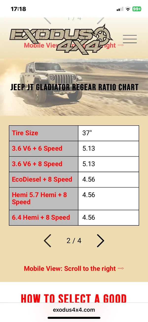

Just remember, these aren't old wide ratio 3-4 speed transmissions. They are much more tolerant of less than perfect gear ratios. If you were ordering tons where the gearing selection is free, by all means go for optimal. If it's swapping good gearing for slightly better gearing at a cost of $2-3k is save that money towards more impactful mods.
Bandit’s Lair
Jason
Jul 9, 2025
36
3,164
5,194
Southern California
2021 Gladiator Sport S
To my understanding, with 38” and the Hemi 4.88 is the preferred gearing. I don’t have real world experience but every video I’ve watched on it or article I’ve read states 4.88 is the more “drivable” option with the power increase. My own inquiries to shops have said the same. I may have looked into this a time or 7,000…… :bandit: When I asked I stated it had to drive from SoCal to Moab, fully loaded for camping, run trails competently, and make the drive back all without compromising on road manners.

If the gearing is too deep you can always go up a tire size.

Good points-all!
I can agree with every point to some degree.
* Keep it the same and drive it to see if it's over-geared: Smart move really
* Drop to 4.88: That is what RubiTrux recommended, but not that much of a difference
* Switch to 4.56: High Lift said that would be OK too if I was thinking of a change, although they recommended 4.88.
* Keep gearing and go bigger on tire size: That's smart too. I could cut the gear ratio by switching if these KM3's ever wear out
And that's what I did with my dually 3500 Ram. It had factory 4.10 but 1075 ft/lb torque that comes on almost right away. The factory installed a 31.5" tire, I think. I went to a 33" tire, then to a 35" tire. It still has enough torque to spin all four rear tires, so I could go bigger yet, but, yes, I have exercised the principle already.
* skip regearing and save $$$$: Are you kidding??? Does it look like I have saved money on anything with this build? And what is there left for me to add anyway? It has everything (Not going to 1-tons, ever) ;-)
I'll chat with the folks at the shop and see if there is any one glaring consideration I may have missed, then decide.

If you keep deepest gearing and go bigger tires your sorta screwed into that always and it will wear other things out. I think I would do the 4.88's it is the middle of the road that gives best of both worlds

With 38s at 80mph the difference between 5.13s and 4.88s is 100rpm. Hardly worth $2k in my opinon. Again, not because you shouldn't spend money on the Jeep, but you can do better things with that money. Hell if you camp $2k could fund a decent moab trip. I'll take 5 days wheeling over 100 rpm every time.
