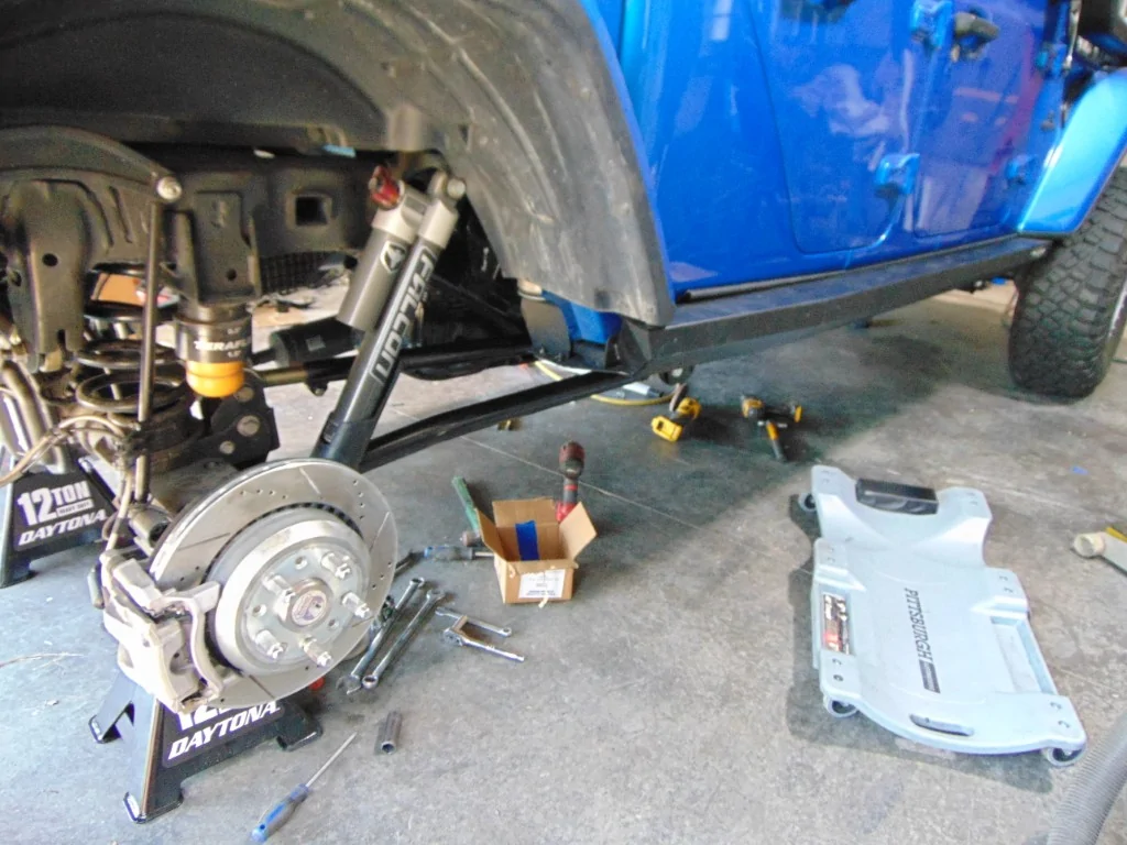

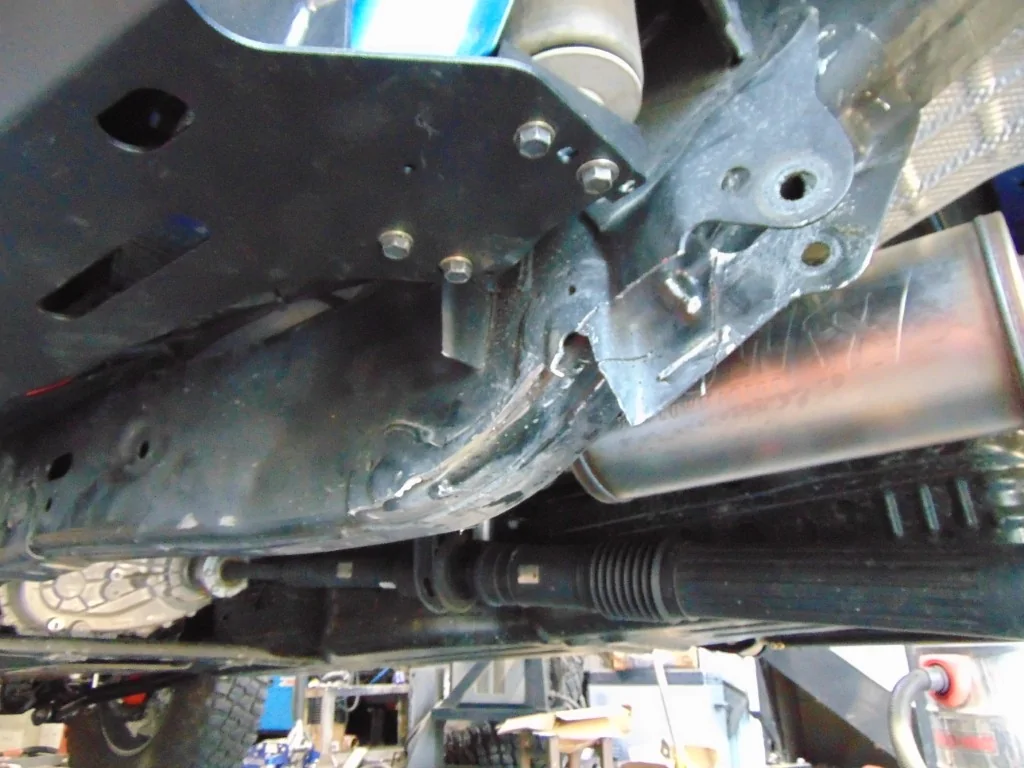

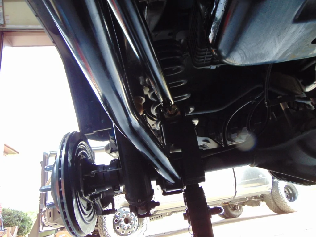

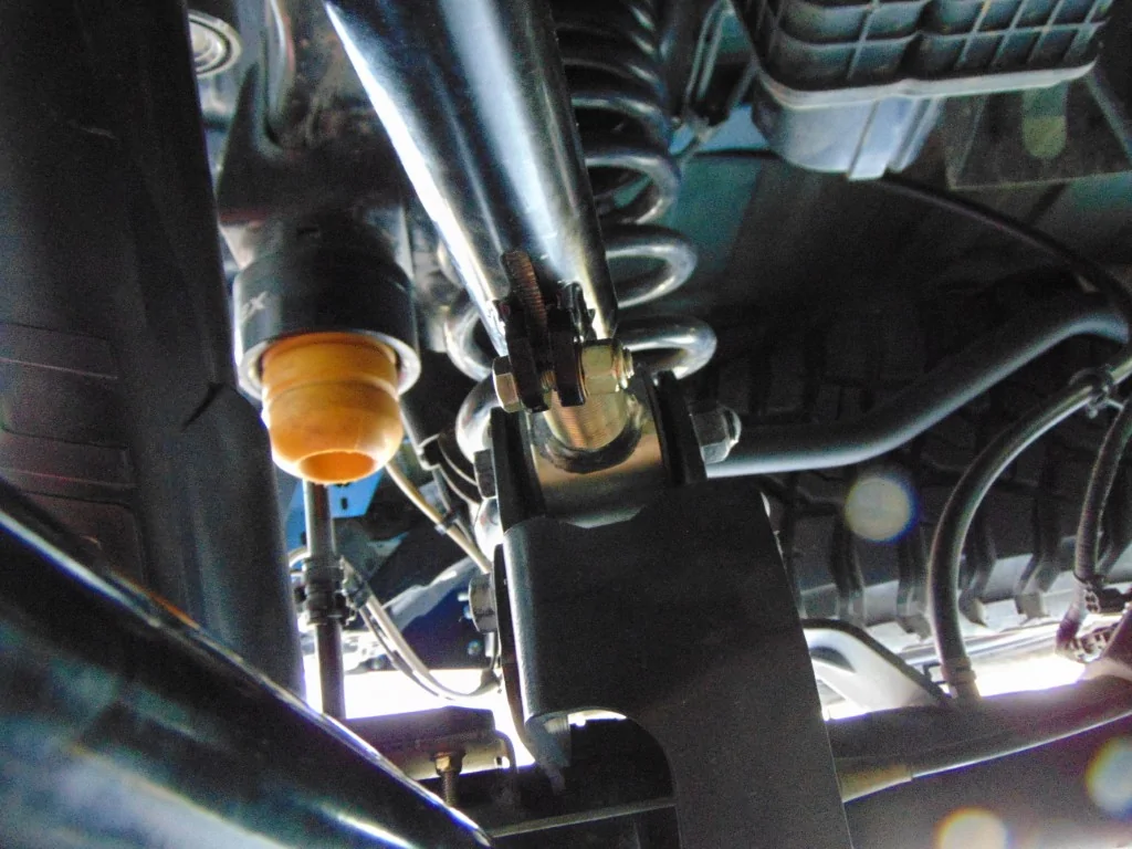

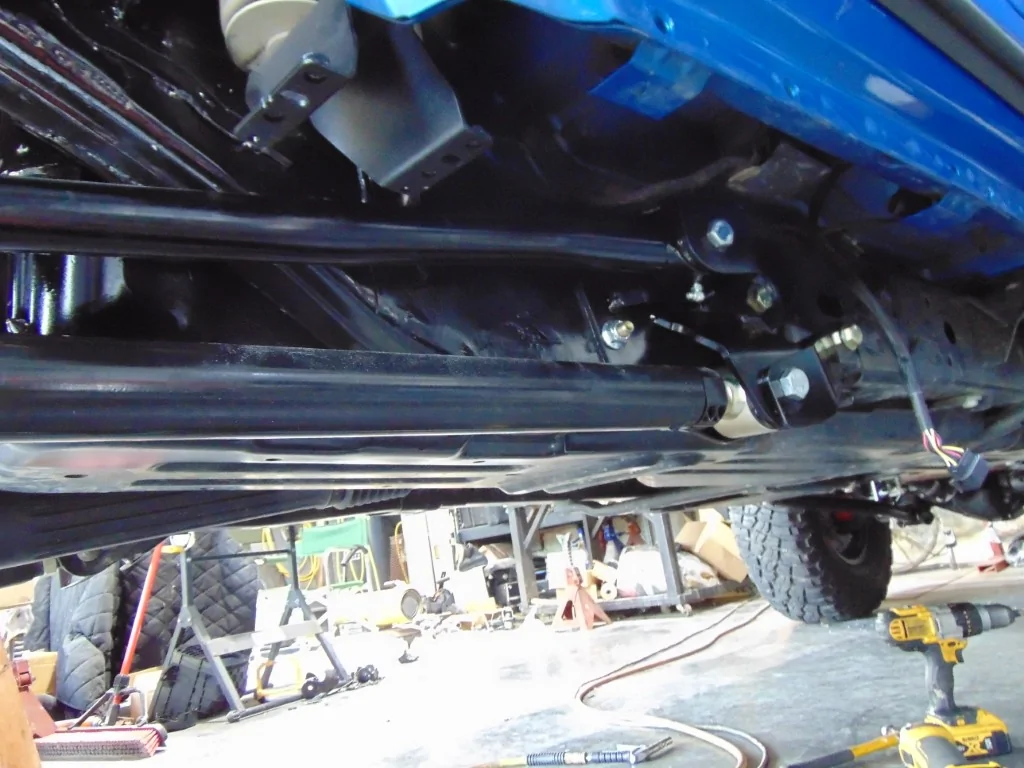

And bolted them in place. Iron Rock supplies some ultra-beefy hardware to lock in the control arms.
Jeep Gladiator 2022 AEV Gladiator Rubicon build DSC03605 (Medium)
Jeep Gladiator 2022 AEV Gladiator Rubicon build DSC03606 (Medium)
Jeep Gladiator 2022 AEV Gladiator Rubicon build DSC03607 (Medium)
Jeep Gladiator 2022 AEV Gladiator Rubicon build DSC03608 (Medium)

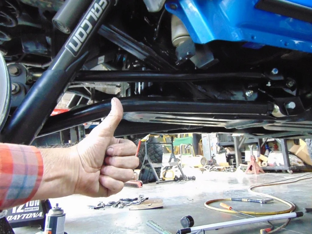

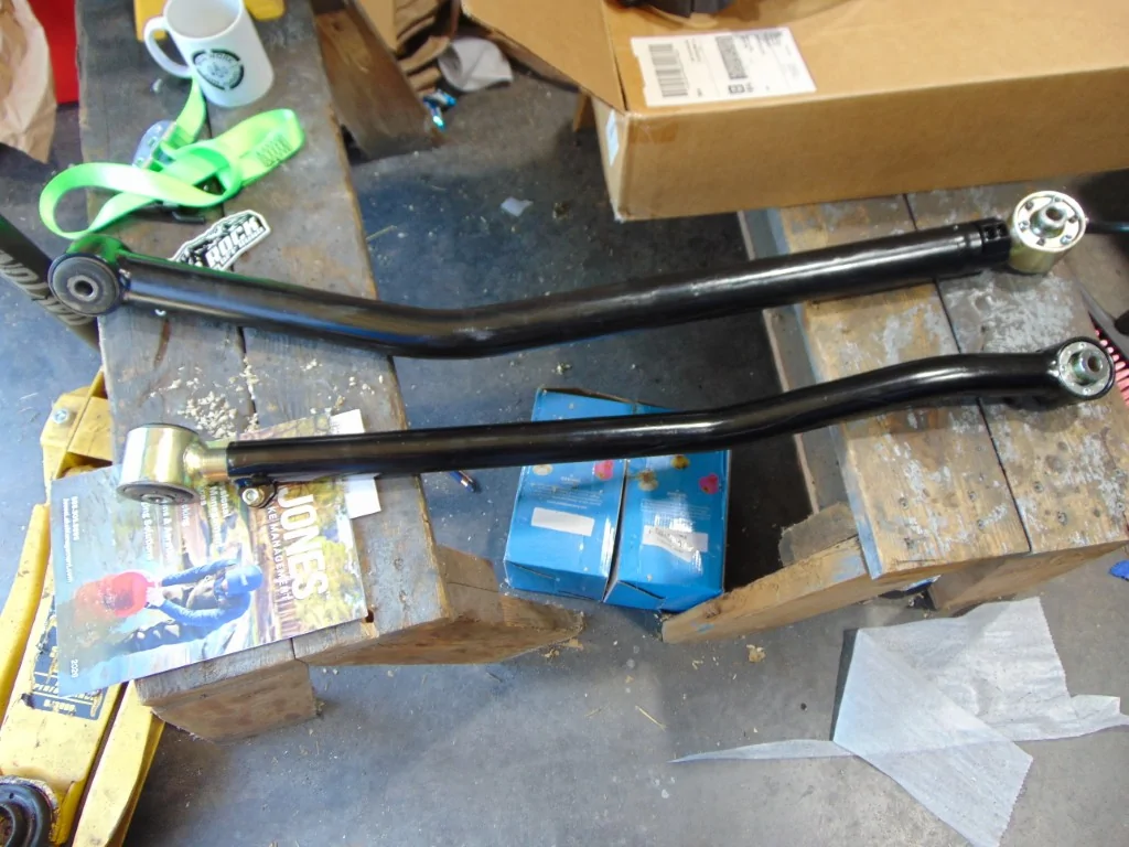

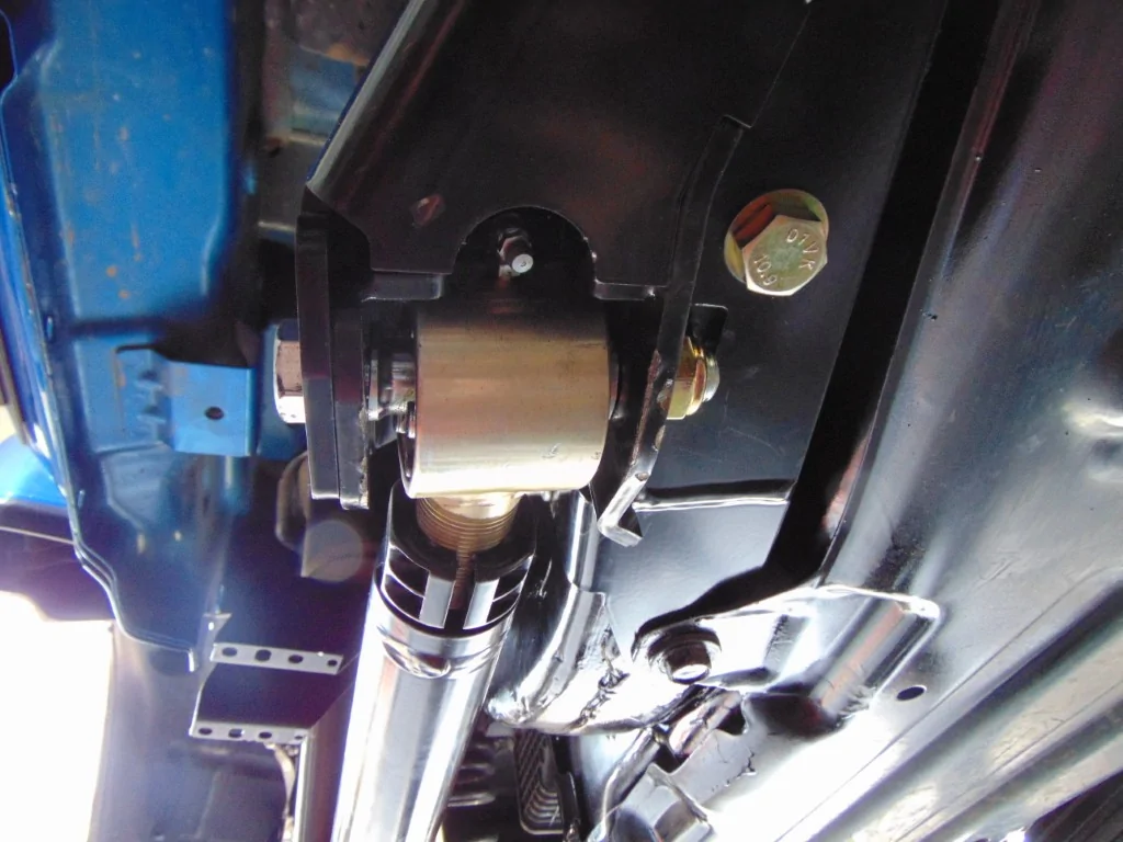

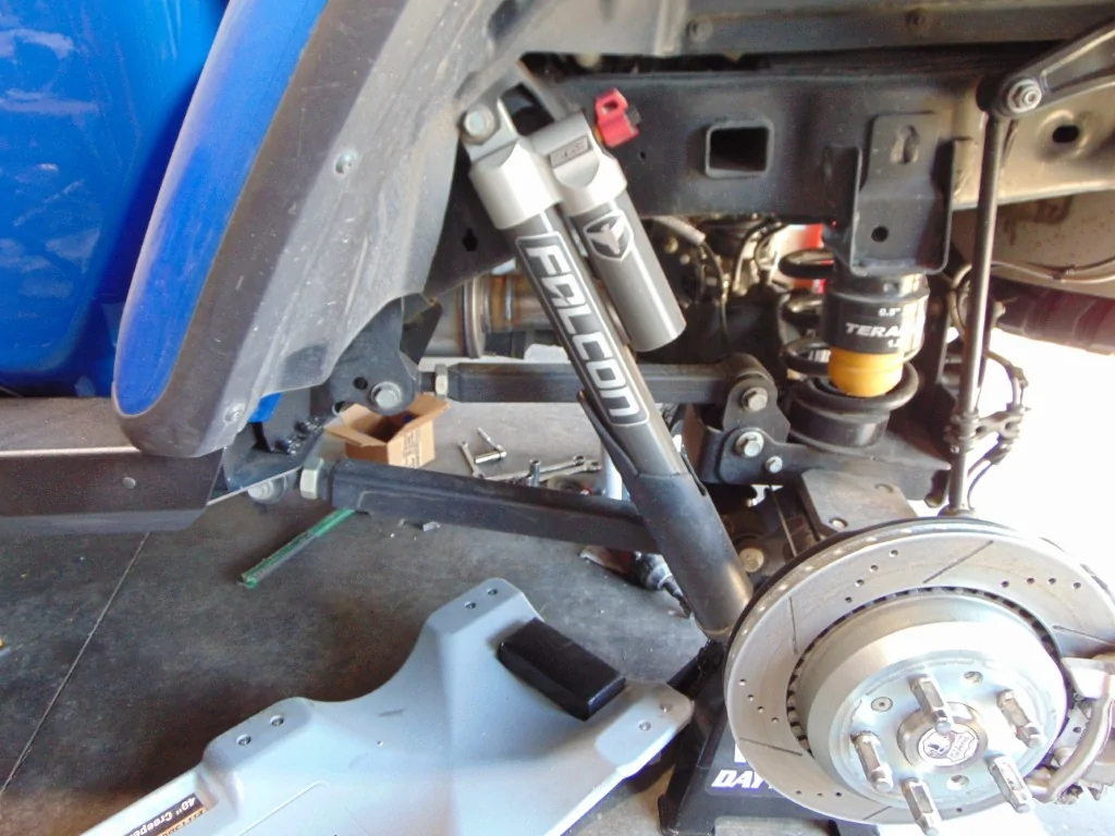

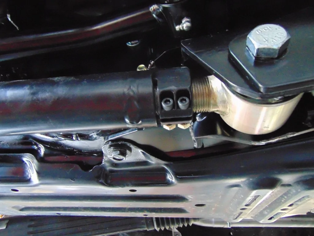

Those control arms, after adjusting for length, just dropped into place. Once they were secured, I tightened the clamping collars to lock them in place.
Jeep Gladiator 2022 AEV Gladiator Rubicon build DSC03610 (Medium)
Jeep Gladiator 2022 AEV Gladiator Rubicon build DSC03611 (Medium)

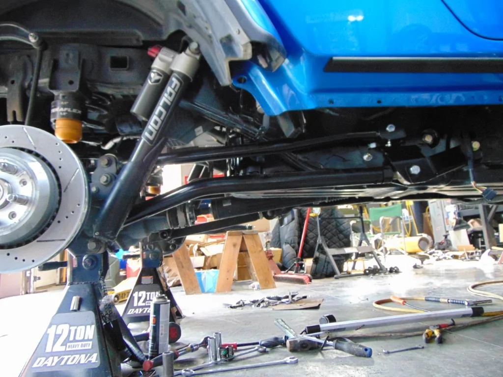

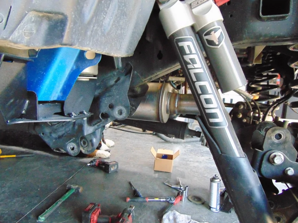

Another successful day, now 3/4 of the way to completion. My helper has been under the Jeep most of the time (except when sparks and molten metal was flying!)
Jeep Gladiator 2022 AEV Gladiator Rubicon build DSC03612 (Medium)
Jeep Gladiator 2022 AEV Gladiator Rubicon build DSC03613 (Medium)

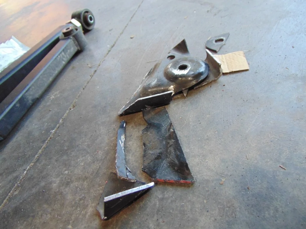

You are making it look easy, but I am betting the grinding was tough. Looks like a nice kit.
It's not!
Cutting and grinding are no fun and take hours. Probably 60%-70% of the time spent!

Are those bolt on brackets wrapping around the whole frame tube and bolting through it? Did IR provide solid bushing to be inserted into the center of the frame to prevent frame crush from torquing the bolts down?

The brackets bolt to one side and the bottom. They supply nut plates that you "Fish" to the inside of the frame. Brackets attach the same as the factory, two sides. IR brackets are 3x the thickness of factory brackets
Note: The metal in our frames is really hard. Drilling it is like drilling stainless. No doubt its strength more than makes up for its relatively thin cross-section.

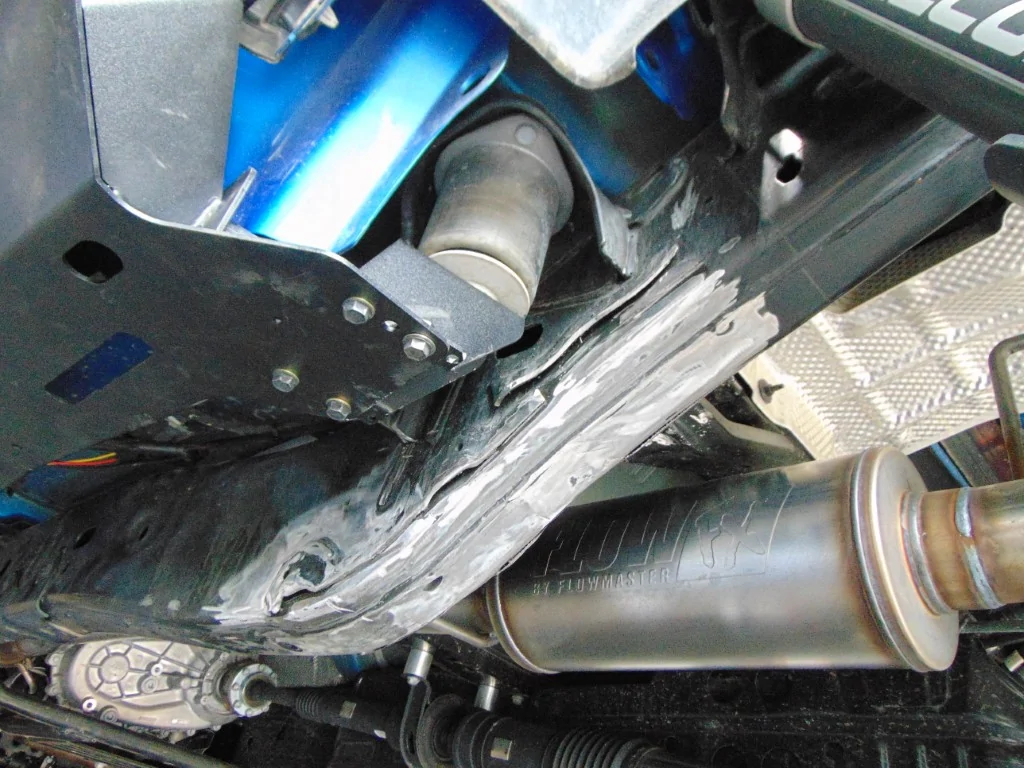

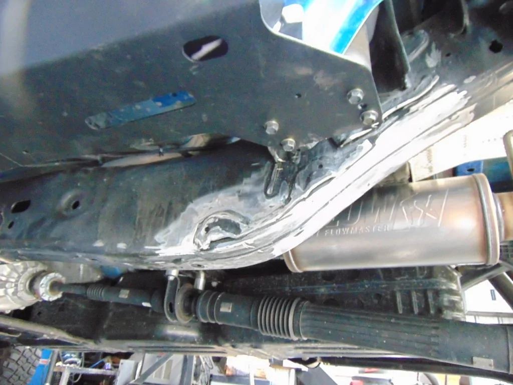

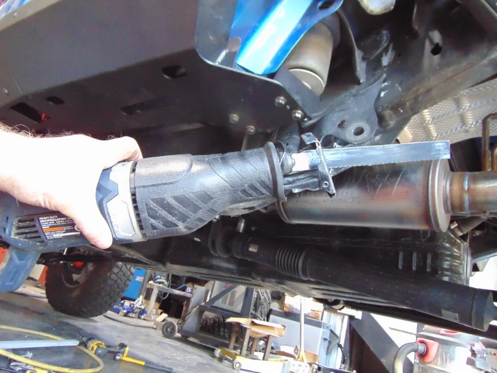

On this back corner, I am using a metal saw to remove the big pieces. There is really nothing in the back, or crowding me, or interfering with a full-on assault with the saw.
This actually went quite well, but with a dinner date, I ran out of time to get it all the way to the painting stage. That will have to happen tomorrow.
Had I worked 12-hour days on this, it certainly would not have taken me over a week to finish the job. I prefer to work on the Jeep for a few hours to maybe 6-7 max, so I don't get sloppy. I have all the time I need to get after it, and that is why this, and really all of my projects, seem to get stretched out.
Jeep Gladiator 2022 AEV Gladiator Rubicon build DSC03618 (Medium)
Jeep Gladiator 2022 AEV Gladiator Rubicon build DSC03619 (Medium)
Jeep Gladiator 2022 AEV Gladiator Rubicon build DSC03620 (Medium)

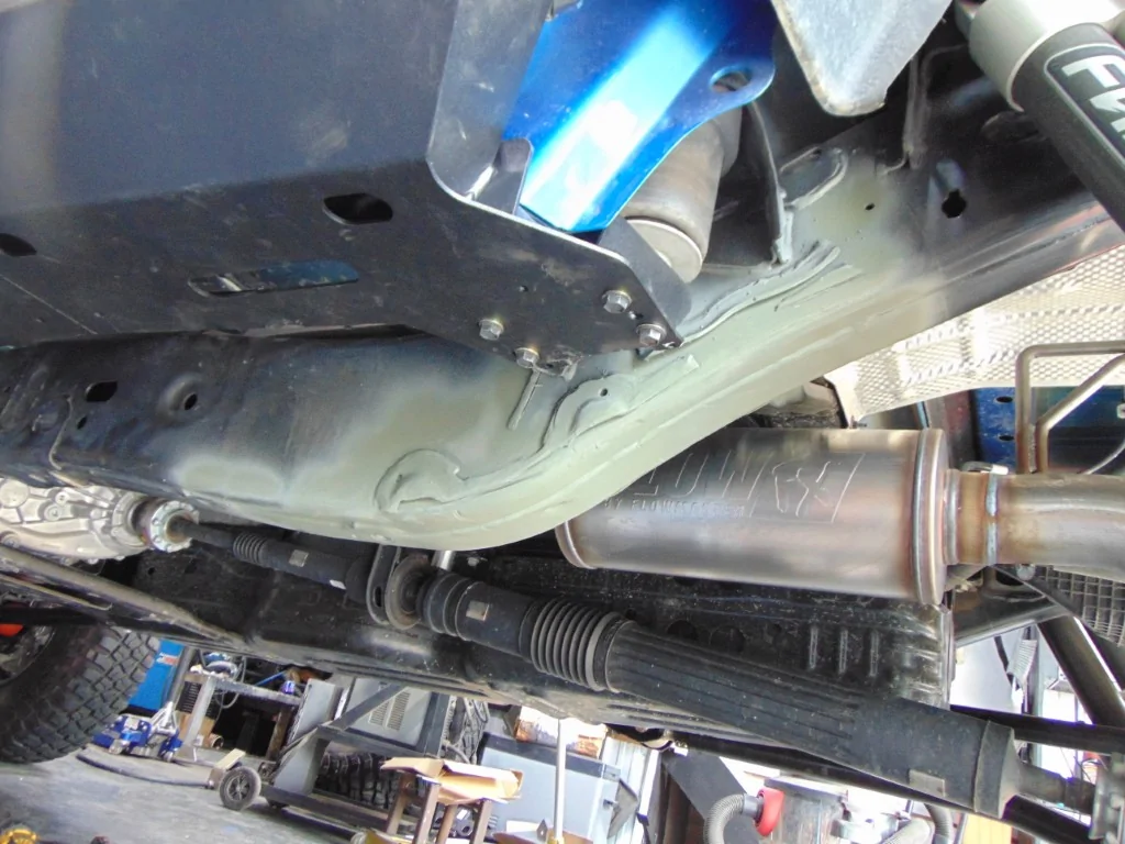

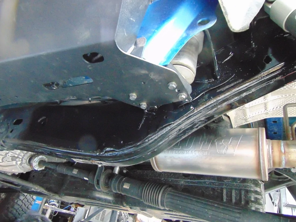

Thanks to springtime and lots of yard work the following few posts are what I got done today.
I continued removing the factory control arm brackets, but left far more on the frame this time as the weldments and material serve to strengthen those areas.
Jeep Gladiator 2022 AEV Gladiator Rubicon build DSC03623 (Medium)
Jeep Gladiator 2022 AEV Gladiator Rubicon build DSC03624 (Medium)

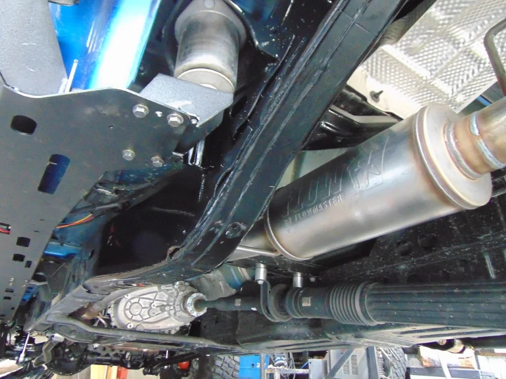

Then came the primer and paint process with an overnight drying period.
