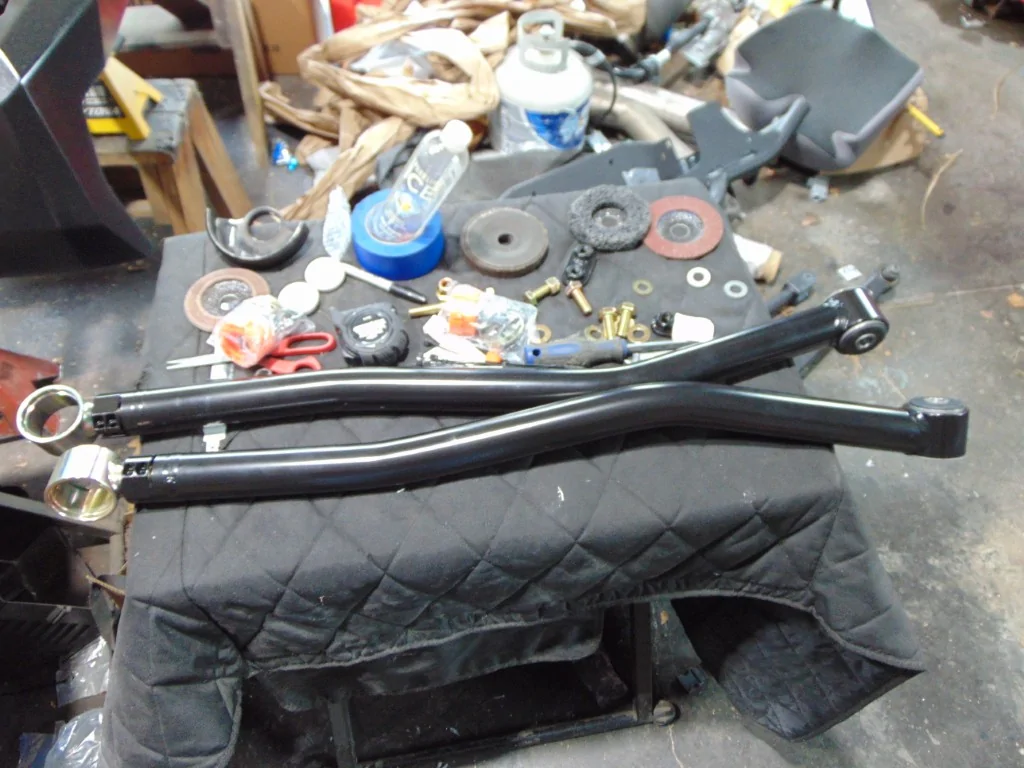

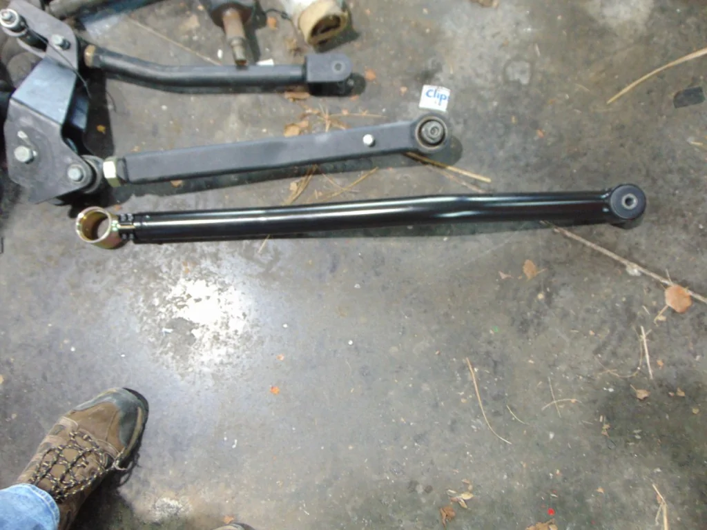

Next up, I assembled both front lower control arms. These, too, are much longer than stock length.

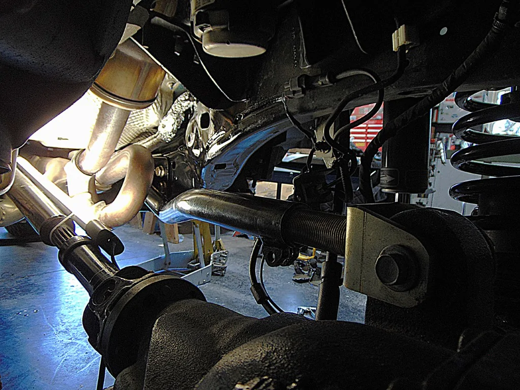

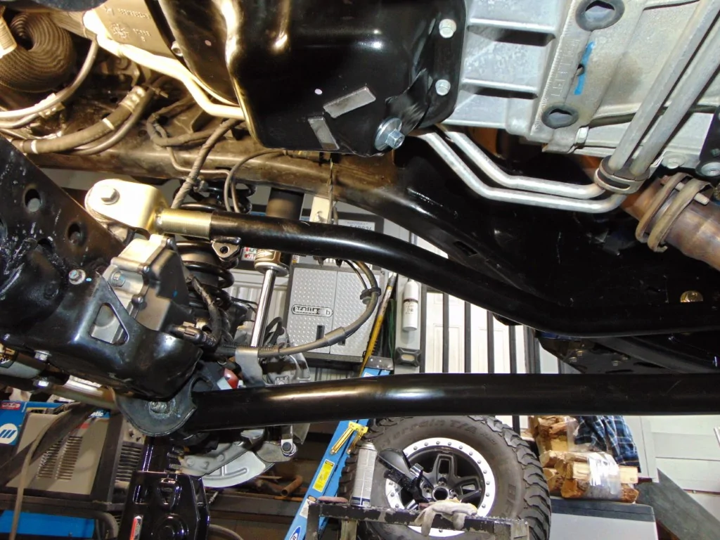

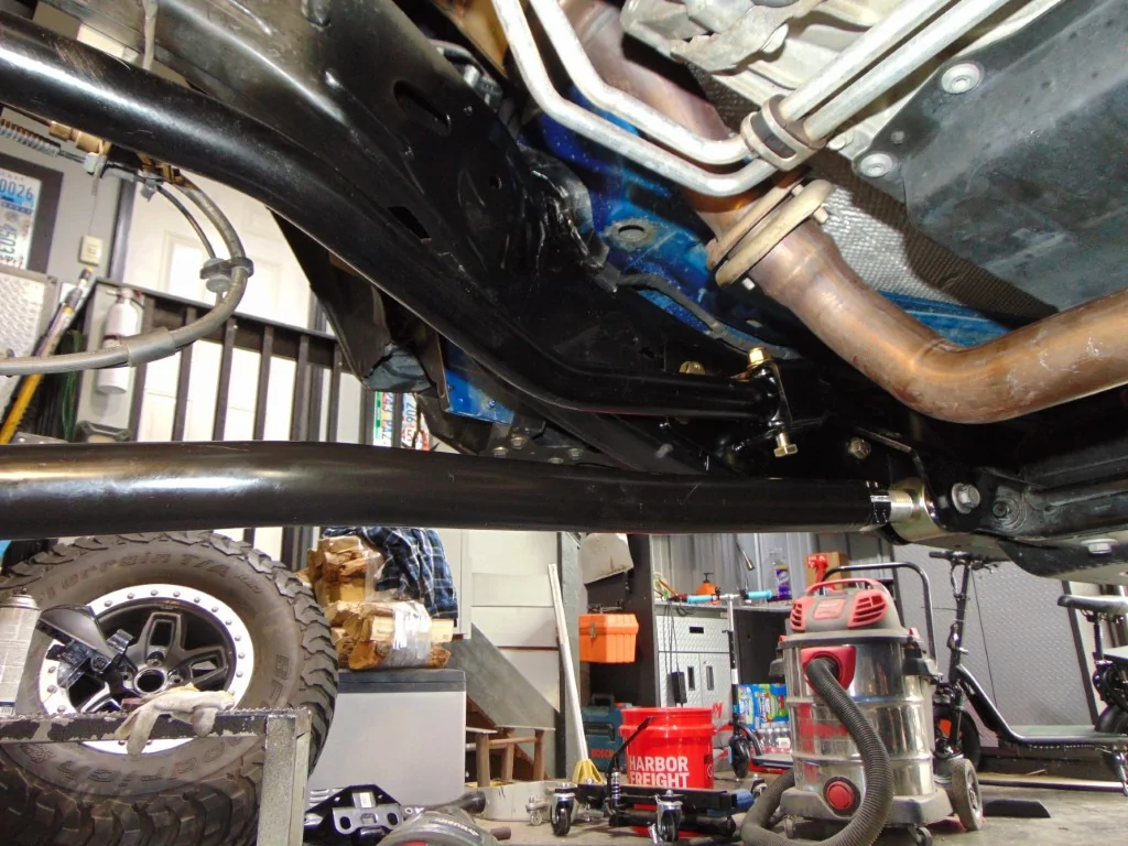

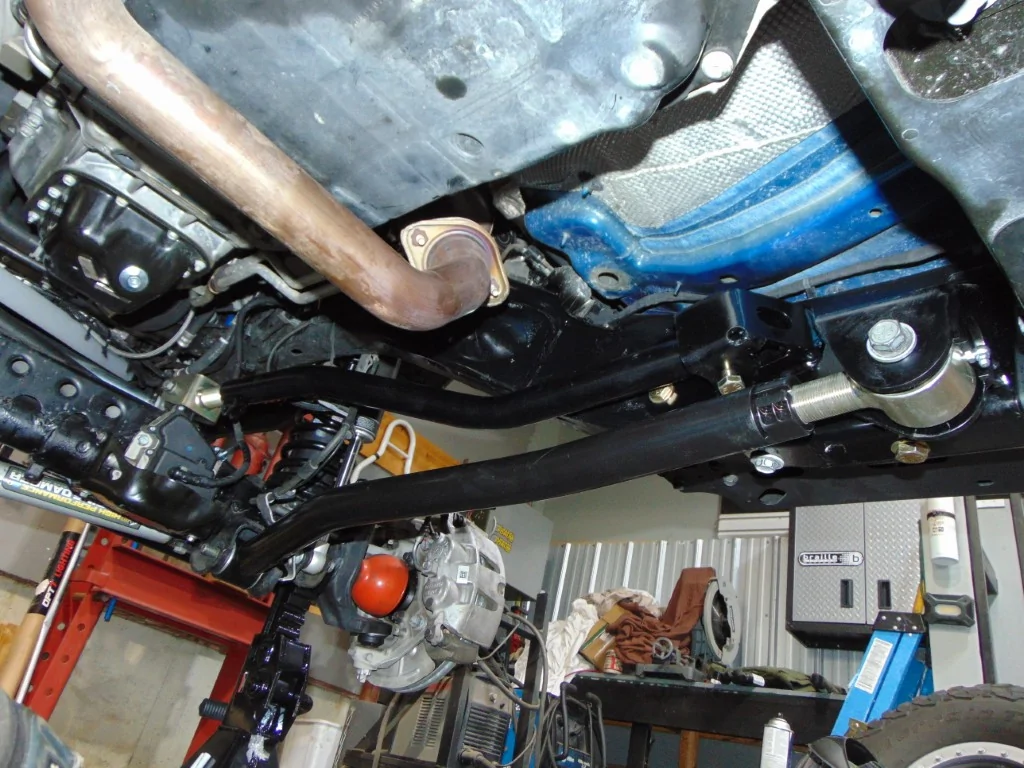

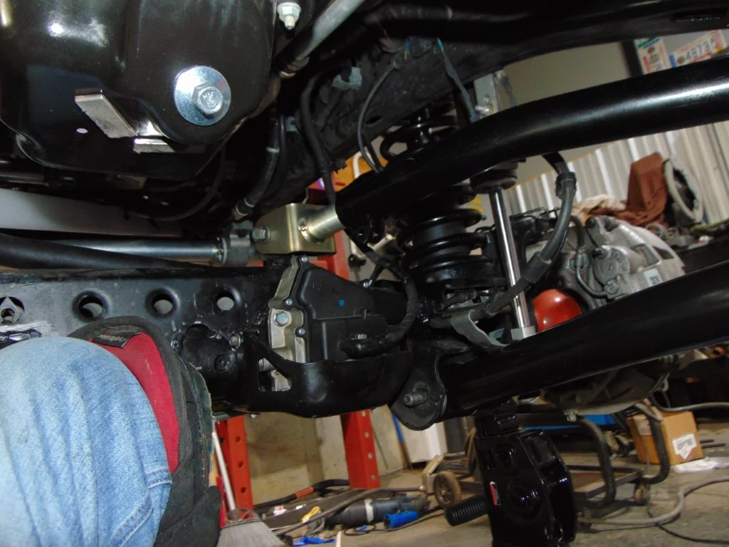

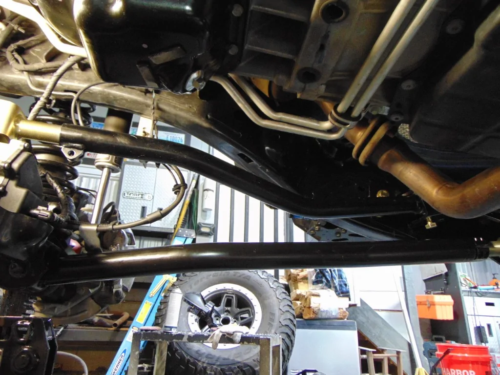

After loosely installing the lower arm, bolts loose for now, it's time to get after the more difficult driver's side.
Here is what the long arms look like installed:
Jeep Gladiator 2022 AEV Gladiator Rubicon build DSC03522 (Medium)
Jeep Gladiator 2022 AEV Gladiator Rubicon build DSC03523 (Medium)
Jeep Gladiator 2022 AEV Gladiator Rubicon build DSC03524 (Medium)
Jeep Gladiator 2022 AEV Gladiator Rubicon build DSC03525 (Medium)
Jeep Gladiator 2022 AEV Gladiator Rubicon build DSC03527 (Medium)

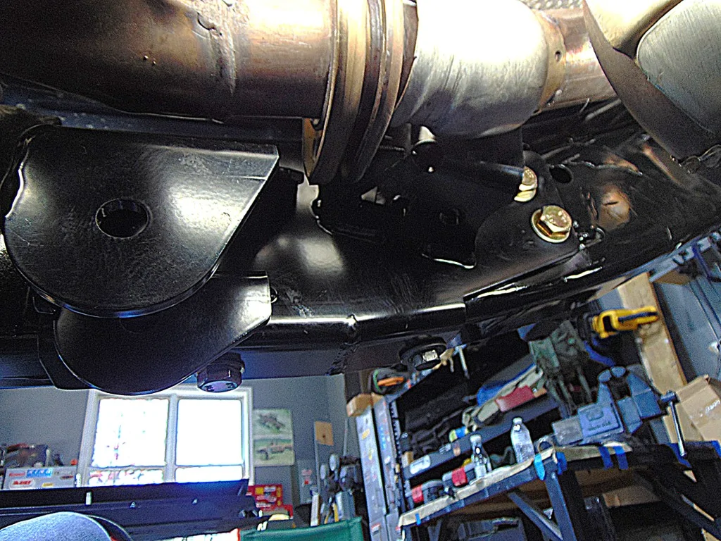

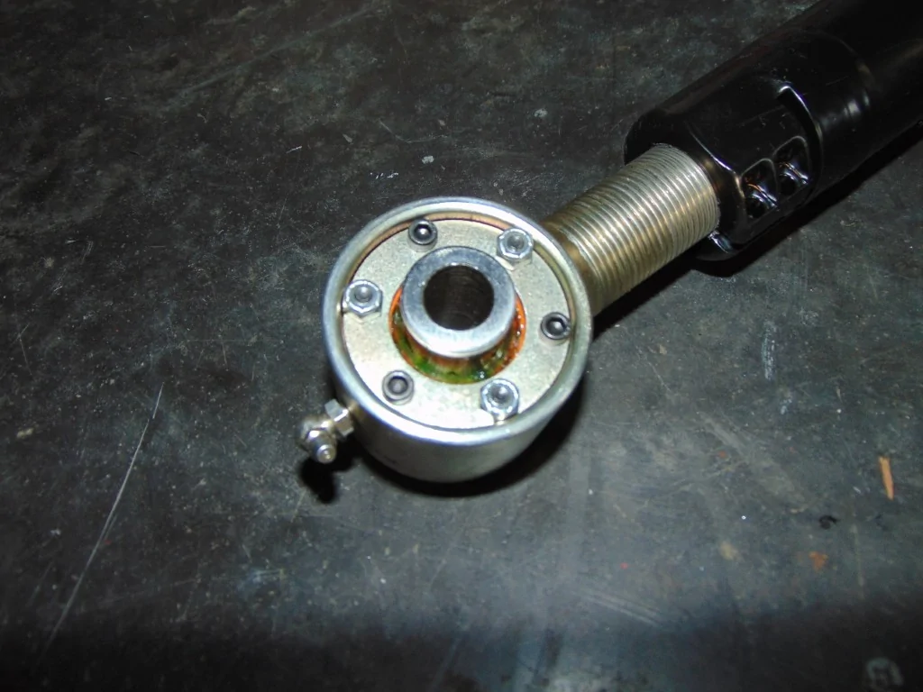

Here's the view from outside and a close-up of that larger, lower bushing assembly

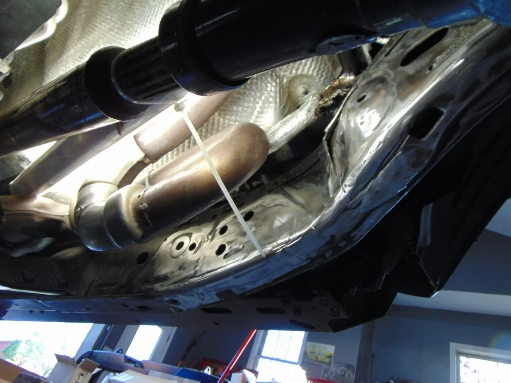

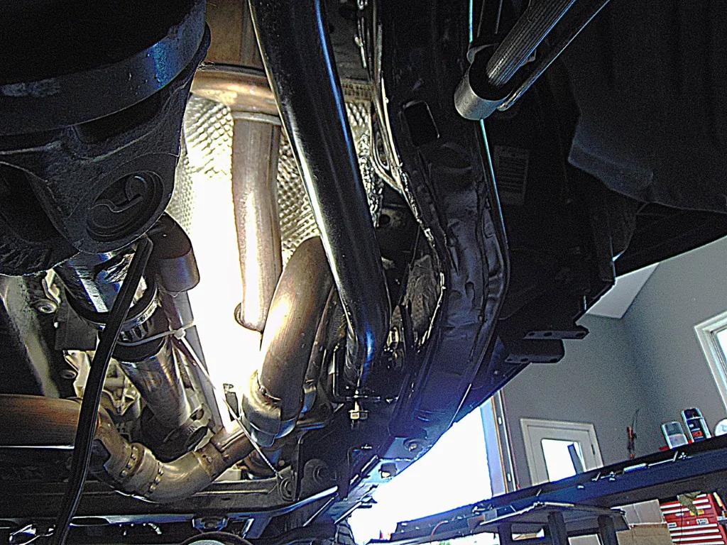

Time now to get after the driver's side, which is supposed to be more difficult because of the exhaust loop.
Well, I suppose it was a bit tougher, but I am on top of the learning curve, so I'd say this corner went smoother than the passenger.

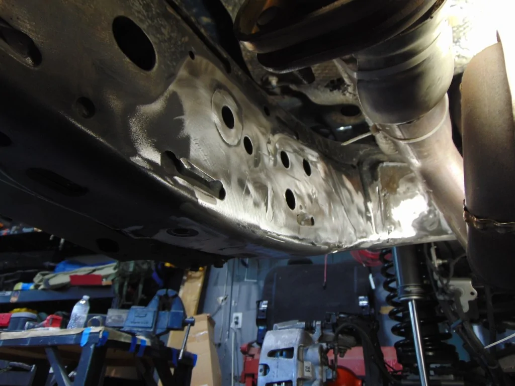

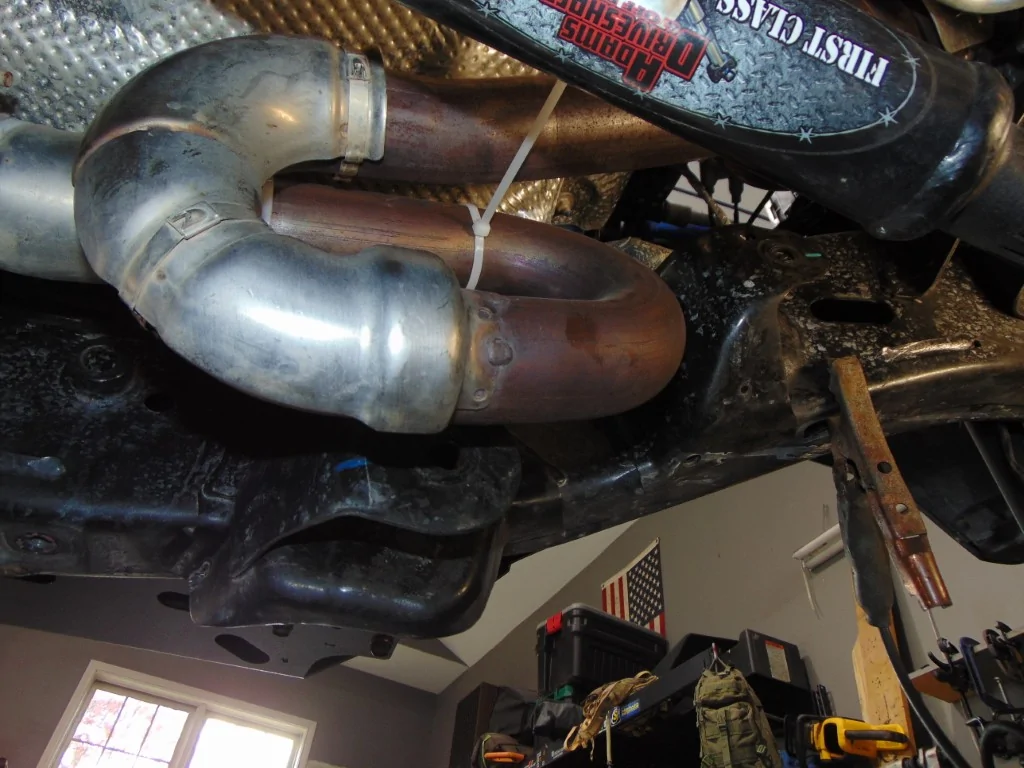

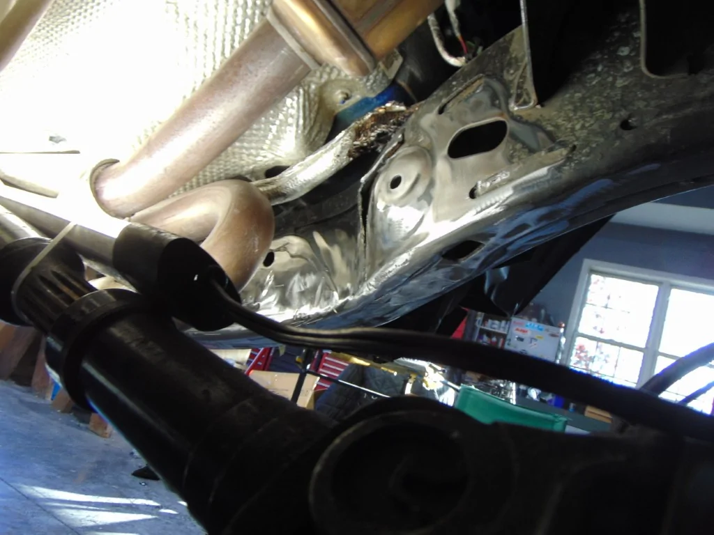

You will see zip-ties wrapped around the exhaust. They are my new exhaust hangers!
Or maybe they are securing the brake line bundle away from the grinding/cutting area...

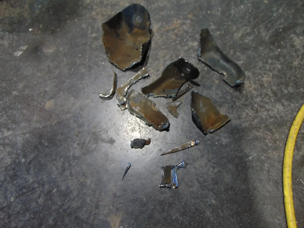

Anyway, there are a bunch more cuts on this side since access is at a premium. I had to cut off bits and pieces to get close to the welds. If I had taken the exhaust loop off, I would not have had to do it this way. Like before, I used the plasma wrench to get the big stuff out of the way, while setting fire to my prized Duluth flannel!

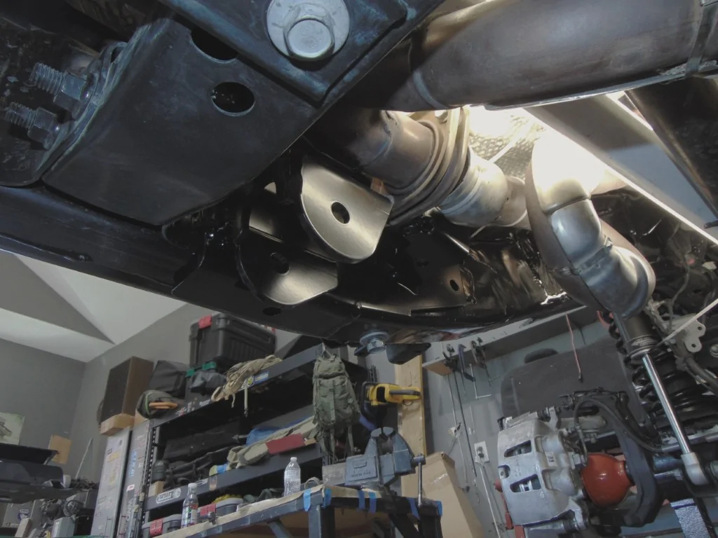

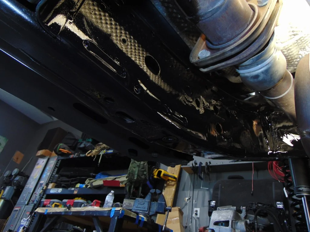

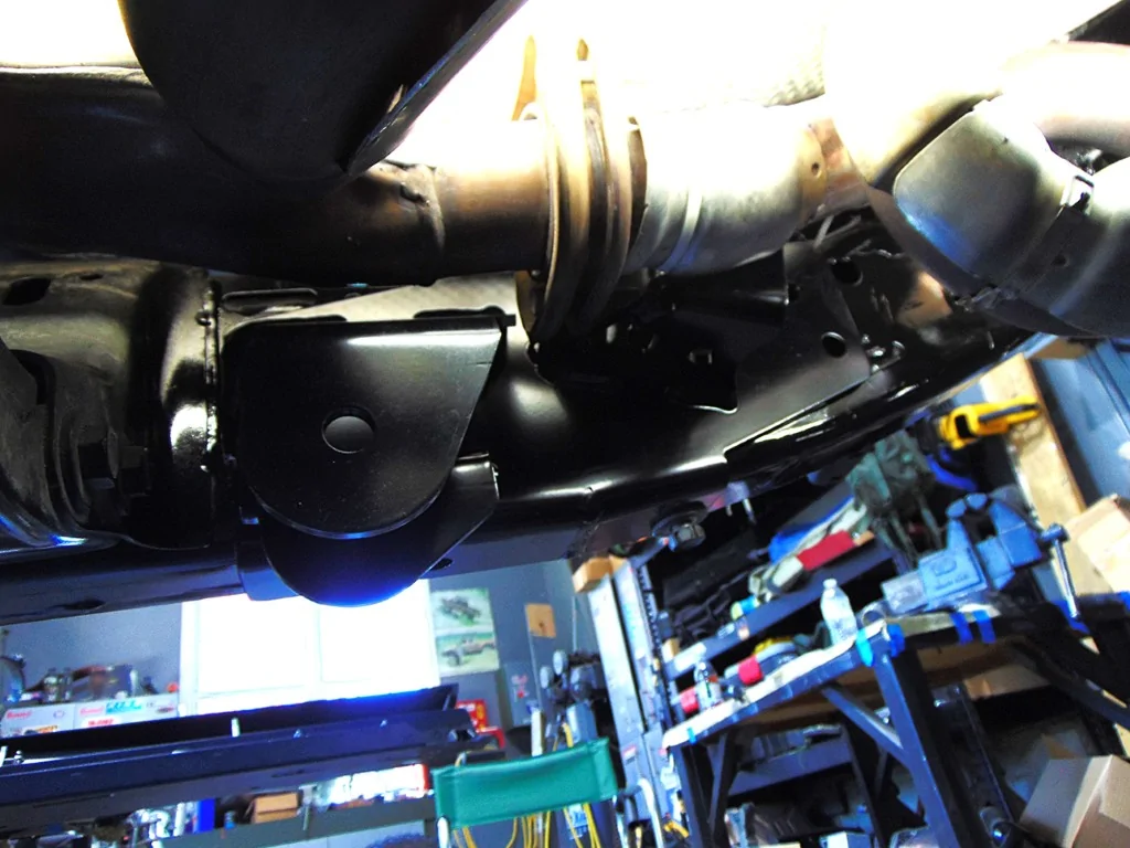

But after a couple of not-too-difficult hours, I had the area cleared of the unnecessary factory mounts.
Jeep Gladiator 2022 AEV Gladiator Rubicon build DSC03539 (Medium)
Jeep Gladiator 2022 AEV Gladiator Rubicon build DSC03540 (Medium)
Jeep Gladiator 2022 AEV Gladiator Rubicon build DSC03541 (Medium)
Flyin6
Flyin6
Jan 2, 2023
1,373
1,883
Kintuckee
22AEV JT370, 24 Ram 3500, 22 Caddy XT6
Aviator, rotary and fixed wing, Writer

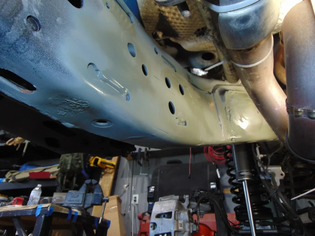

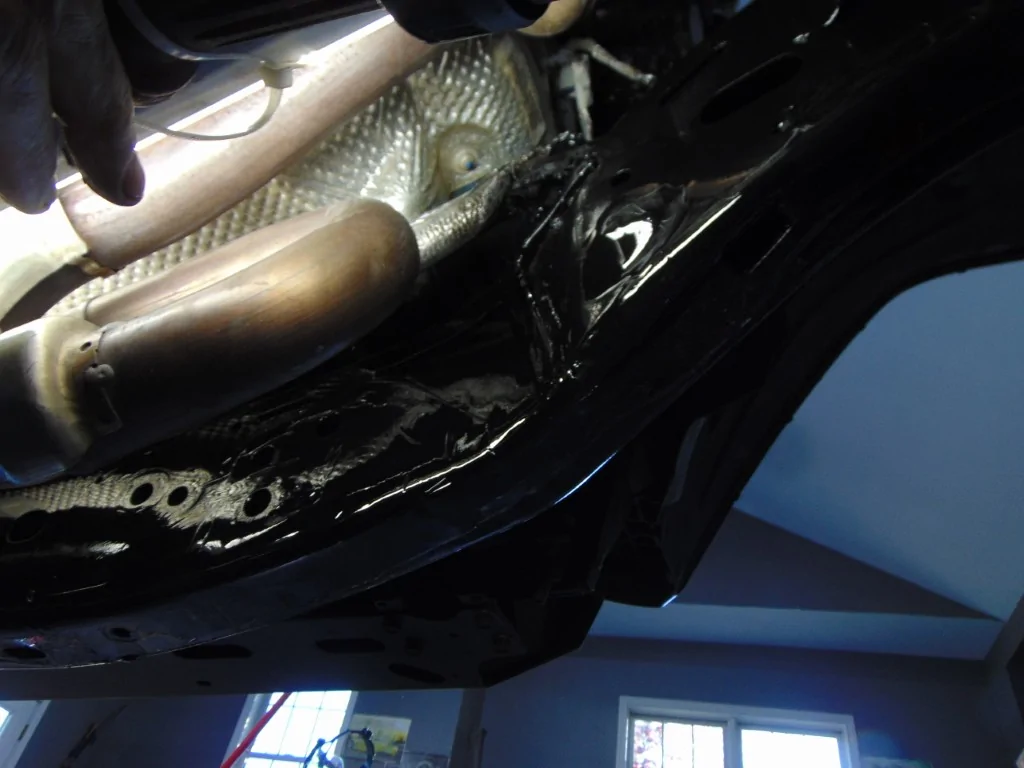

After smoothing it with a coarse scuff pad, I primed the bare metal with self-etching primer...Pretty much the way I do everything.

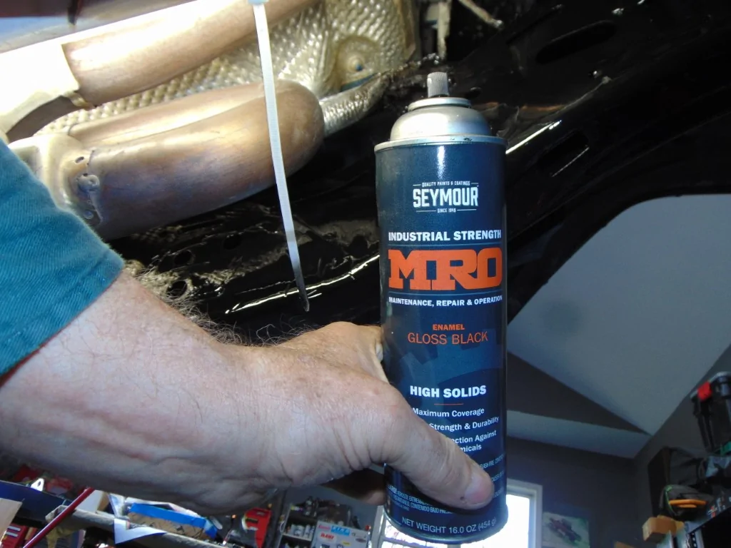

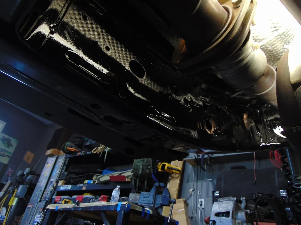

I am using my favorite materials once again. The primer was followed by the high-solids MRO Seymour paint.

That made for an efficient afternoon work session from around 1400 to around 1700. The paint will set up and dry overnight and be ready for the new bracket tomorrow.
I know, crappy pics, but you get the concept...

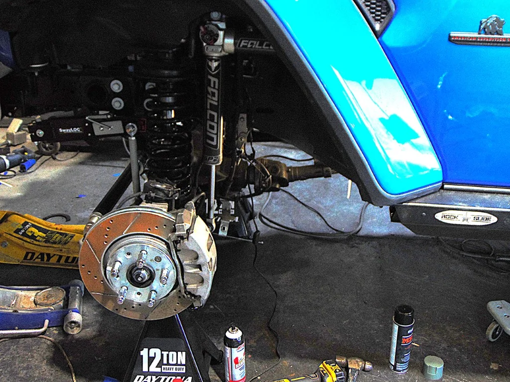

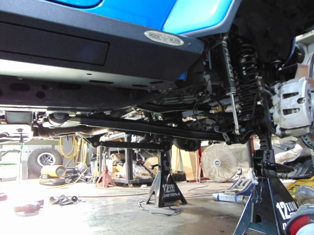

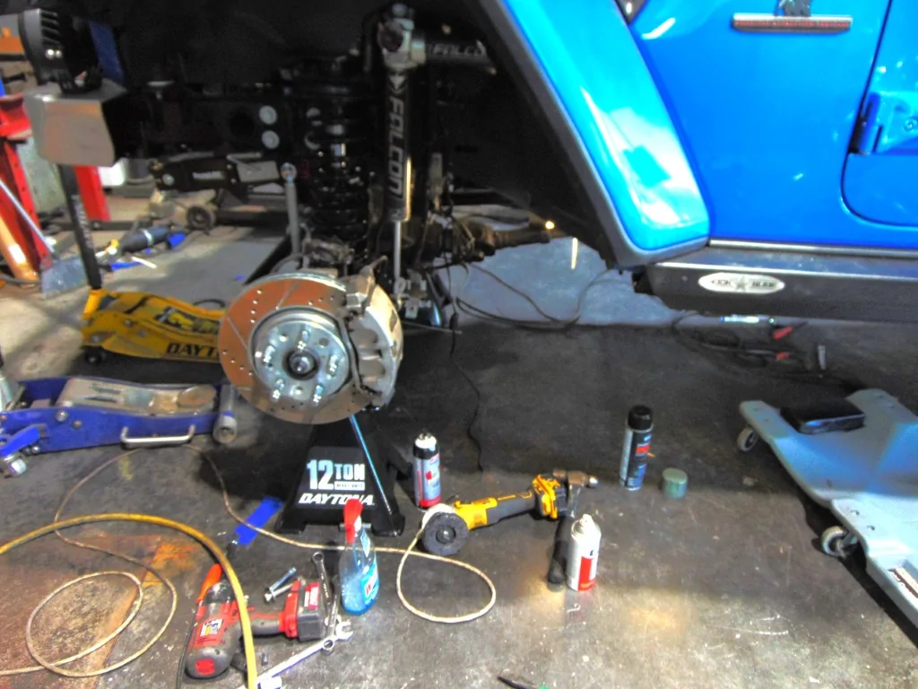

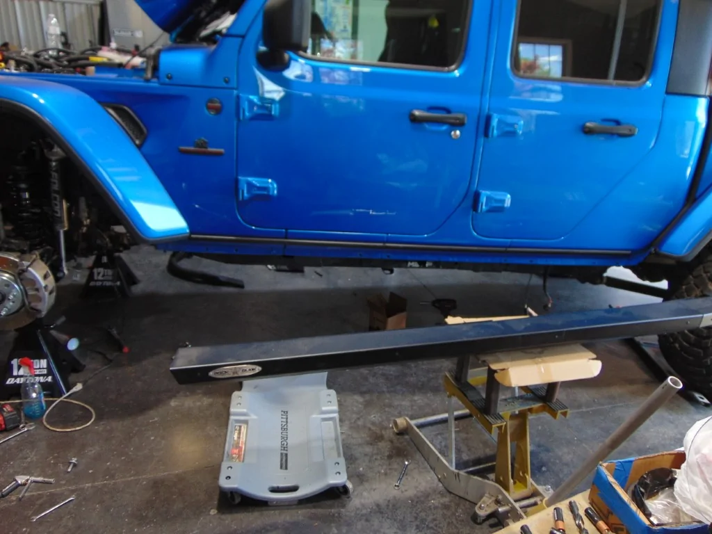

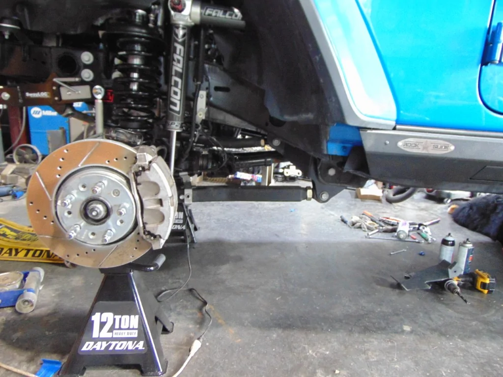

The objective for today's work was to complete the front.
I started by removing the Rock Slide Engineering slider so I could get access to drill a single hole. Man, I hated to pull that slider off again!
