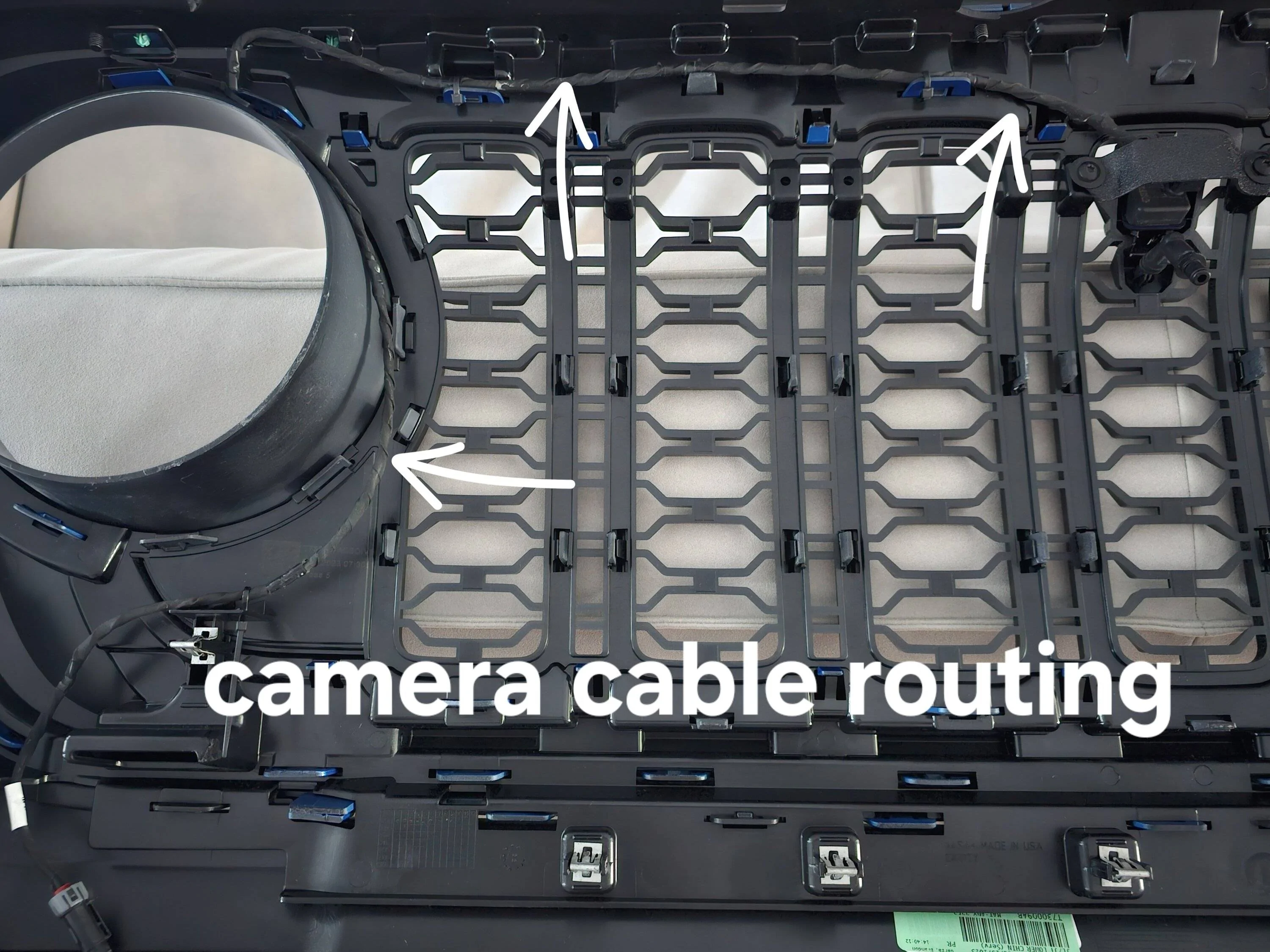

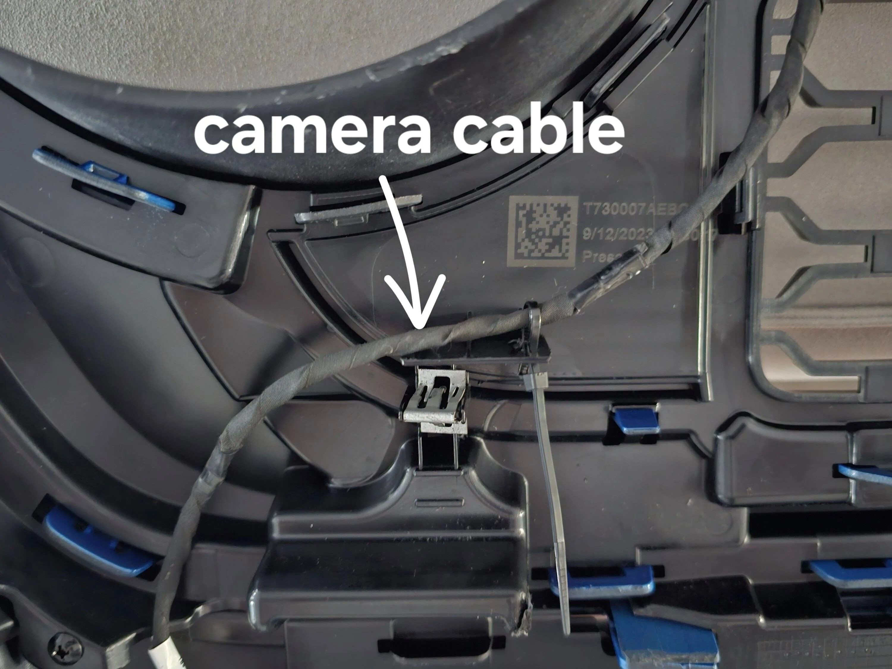

Benny, what is needed to swap the old trail cam wire harness to the 24 grille? Got my 24 grille and the wire routing/clamping is different from the old grille. Thanks
Hi Guy,
It looks like they are running a new front end jumper harness exclusive to 2024's for this, All other components are the same through camera, bracket etc... Best I can tell any harness securing clips are part of the harness itself. Can you send some photos when you get a chance to see if there is a workaround? This is the first we have heard of this.

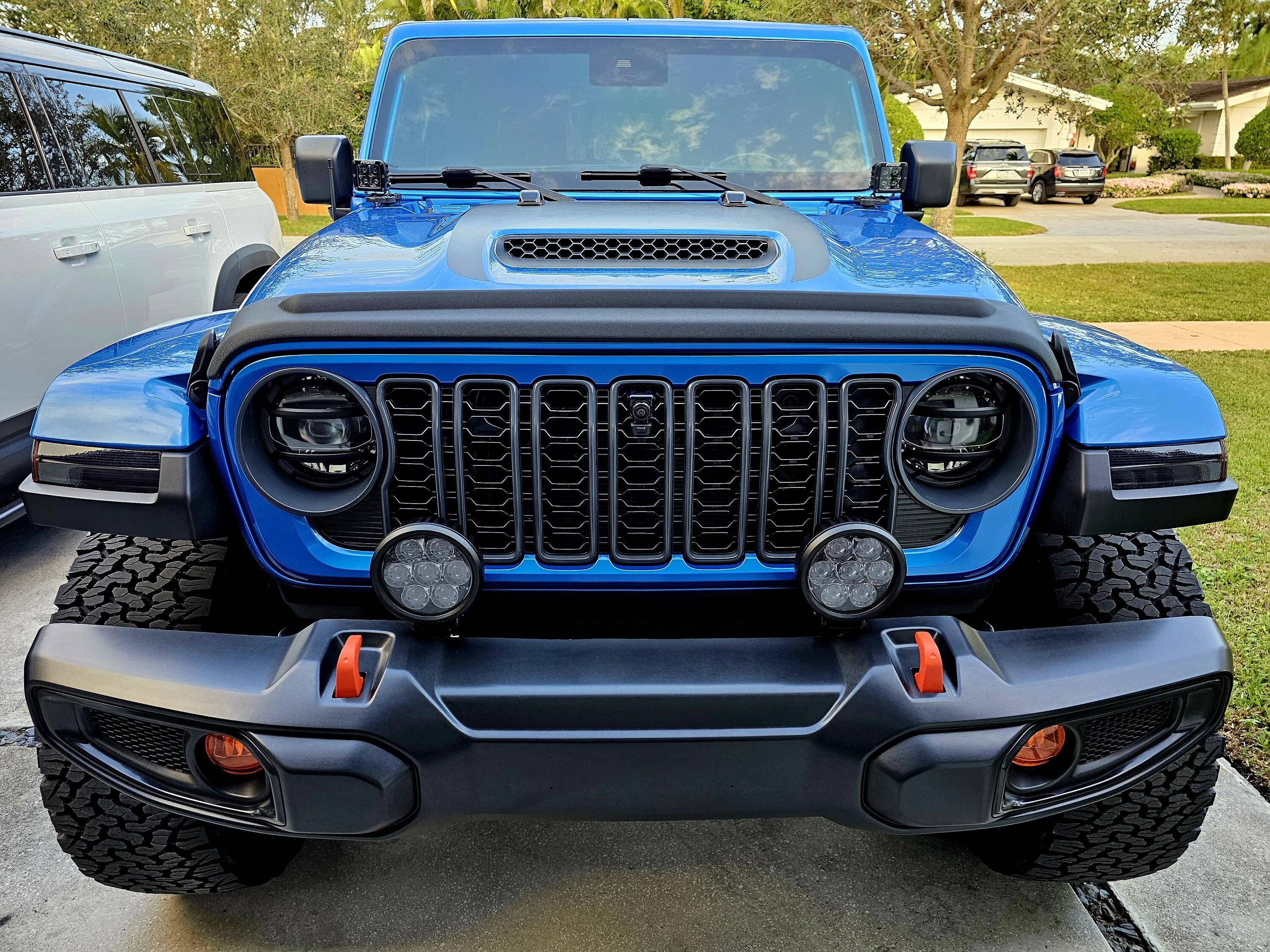

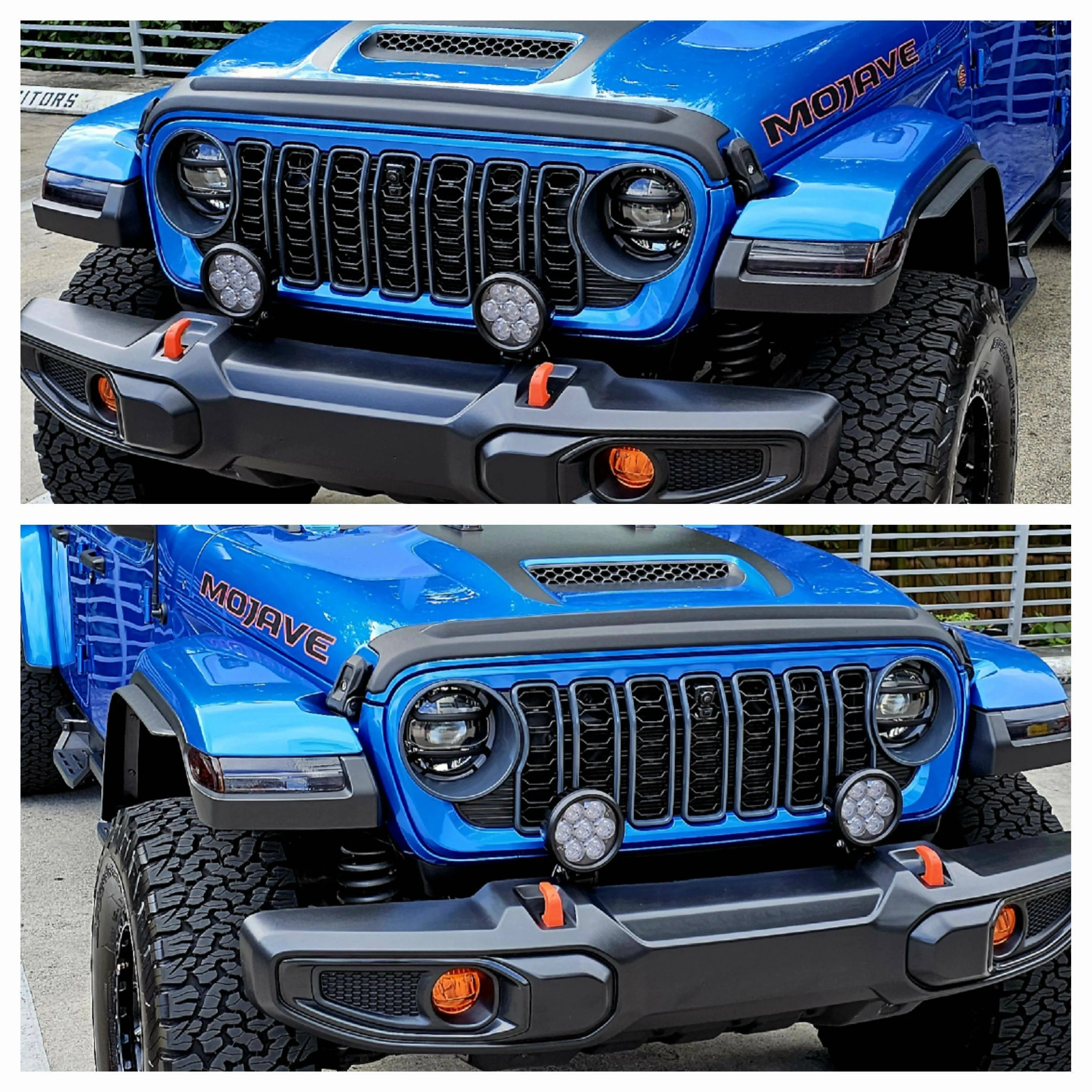

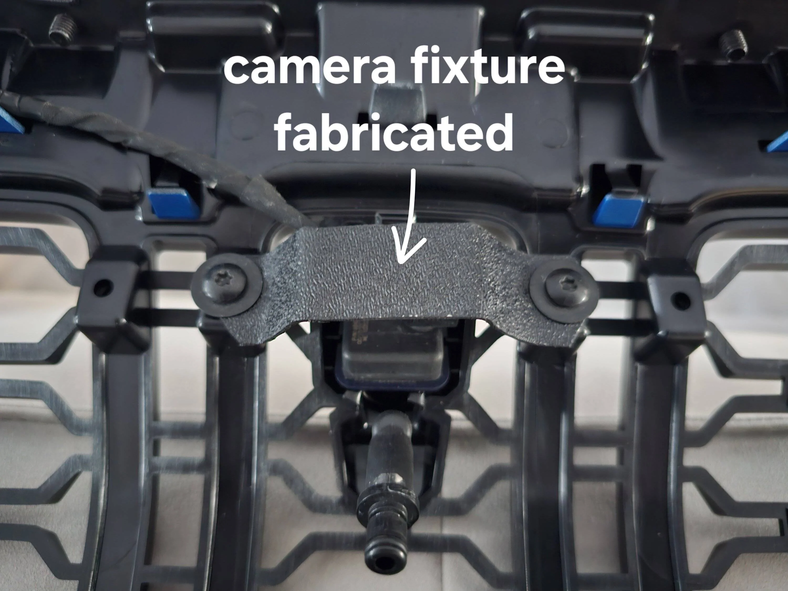

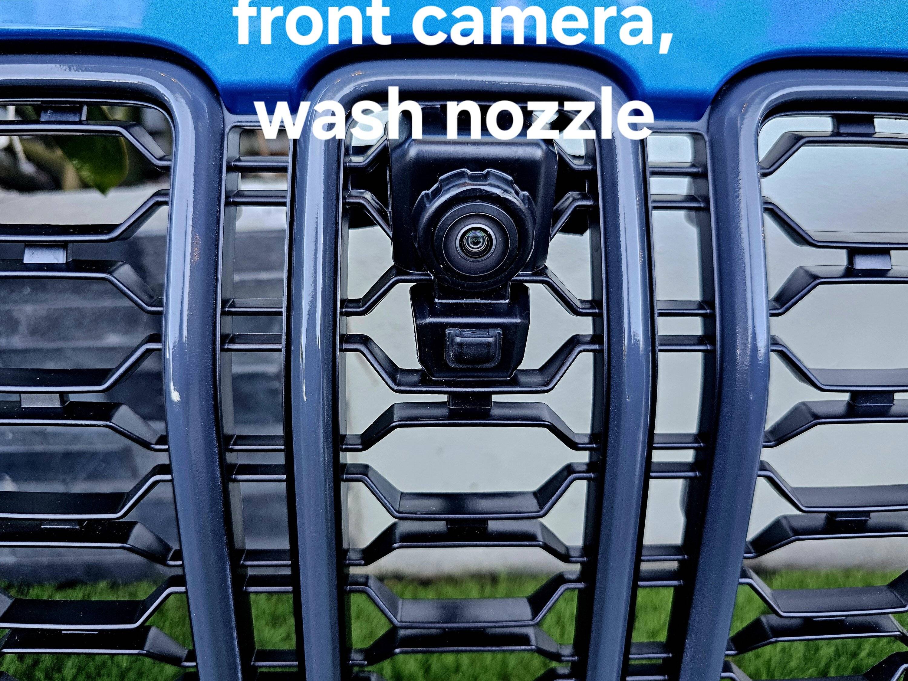

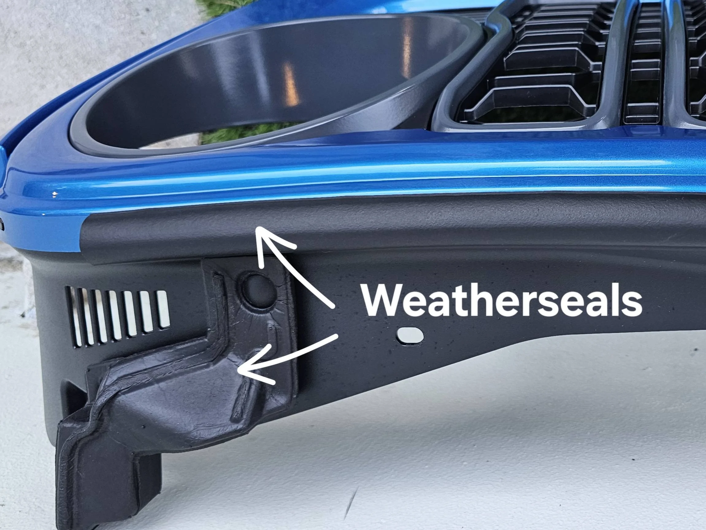

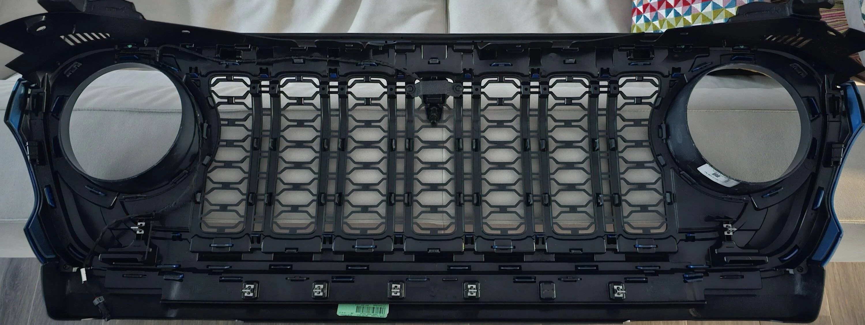

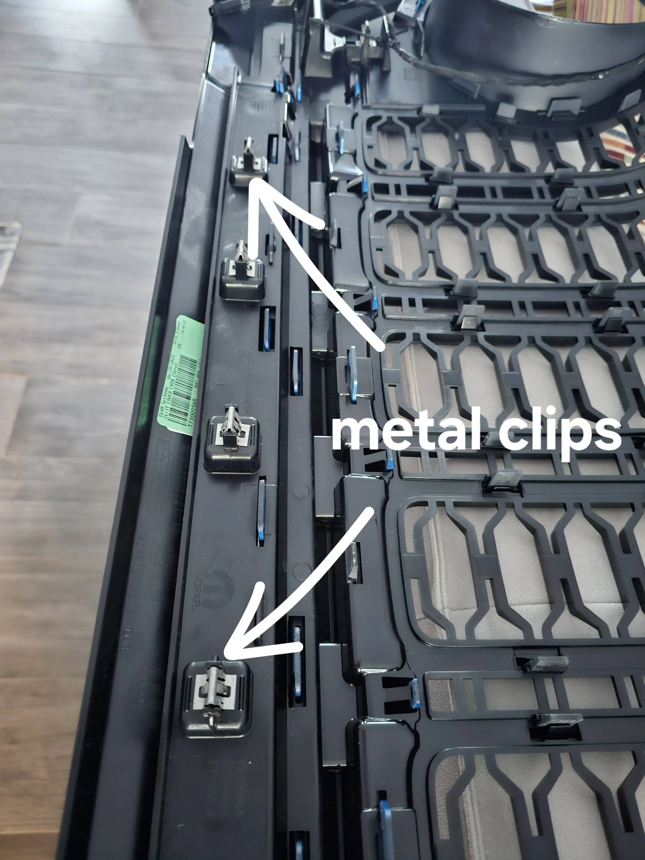

So I finally received my '24 grill from @AllMoparParts.com early this week (3 months wait time). Unfortunately there was a 3" crack on the top, passenger side of the large black base, plus one of the lower mounting tabs into which the metal clips are fitted was also broken off. Because All Mopar Parts could not estimate the time for replacement of the broken part other than "at least 3 weeks or more" I decided to repair it as best as I could with plastic welding techniques (took an extra hour of work but turned out OK).
All Mopar Parts said they would process a partial refund for the broken part but have yet to determine the amount. Let's wait and hope it's considerable.
Now, I've not seen any posts as to the actual grill swap and exactly what's involved, so here's my take on it.
Got the body colored surround pieces (4) painted at a shop, and I painted the slot trim/ headlight bezels in dark gray.
All the parts for the new grill snapped into place quite precisely. To complete the job you will need 8 new plastic rivets (and gun to install them) along the top edge, two self tapping screws on each of the inside lower corners, transfer and re-use 6 metal clips along the bottom, swap over the weatherstripping along the top edge (fitted with Xmas tree plugs) and the foam rubber seals on both top corners (fitted with Xmas tree plugs and contact glue).
Although the camera and its washer nozzle fit precisely into their slots, the camera bracket does not fit the new grill and no replacement was sent. I fabricated a simple bracket out of 3mm thick ABS plastic sheet to resolve this issue. The camera cable clips cannot be swapped over so I re-routed said cable up below the top edge on the driver's side and down along the headlight bezel and fixed it in place with small zip ties.
After all this was done, the whole thing just snapped back into place on the front of the Gladiator and looks fantastic!
It's certainly more involved that I thought it would be and I hope this helps anyone that will be performing the grill change in the future.
See pics below for clarification of certain details.

After an initial off-vehicle assembly of the parts that I received, I took all the perimeter pieces (4) which are intended to be body color, to an excellent paint shop nearby. They simply matched the Hydro Blue color for those parts, which turned out perfectly.
The front center portion of the grill (which accounts for the edges of the openings and headlight bezels), I simply clear-coated satin myself for protection from the elements since it was already dark gray. The rearmost portion of the grill (black plastic "mesh"), I clear coated satin as well.
That scheme replicates the factory paint job.
