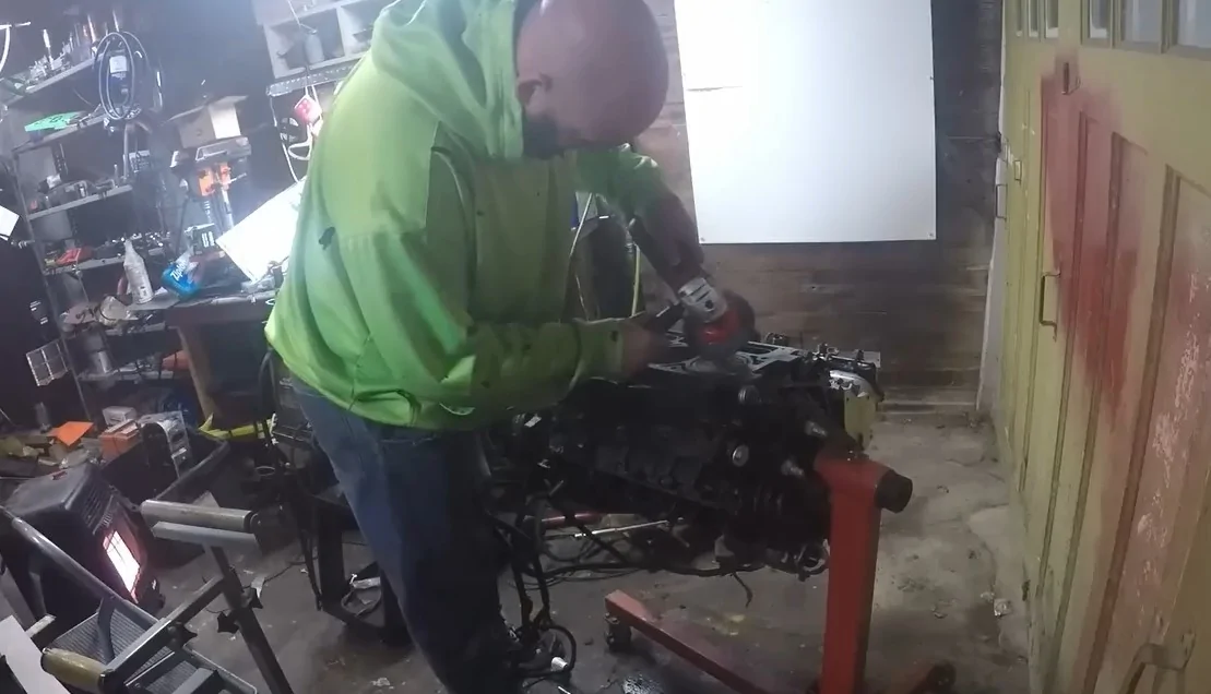

Here's a lovely photo of younger me using an angle grinder to prep the deck surface of that very same engine 8 years ago
Jeep Gladiator 20ft lbs? Screenshot 2025-10-22 165912
