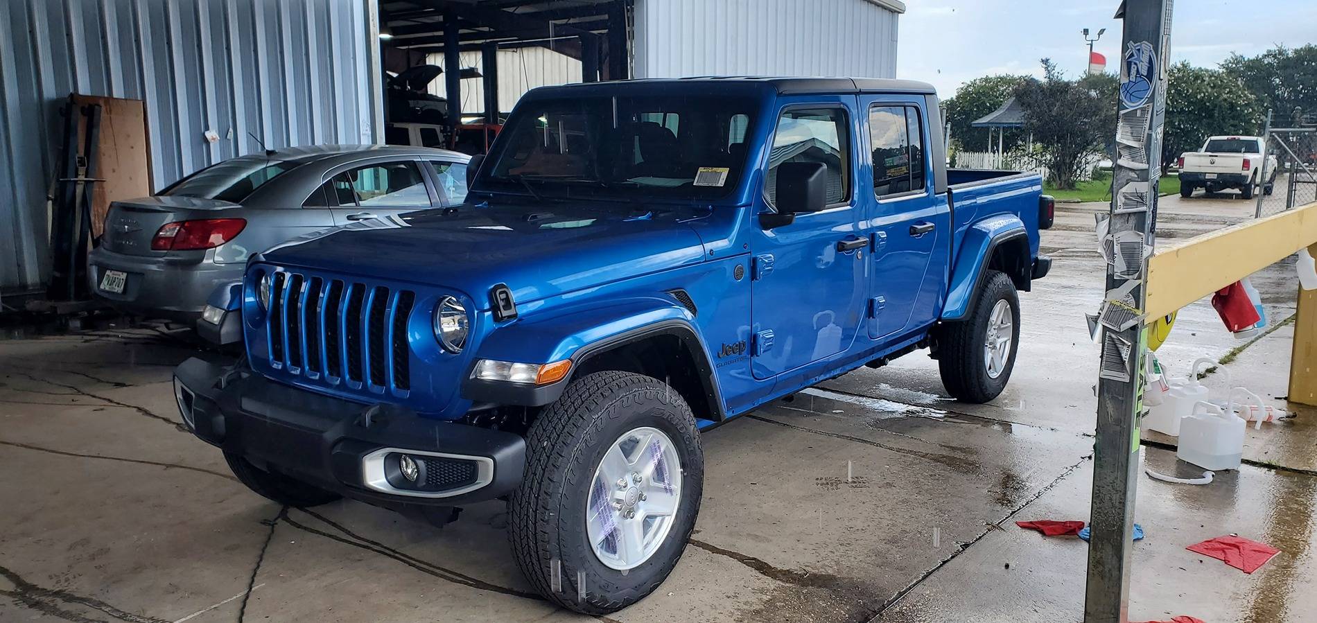

Day 1.
Jeep Gladiator '22 Sport S Max Tow, Three Years / 30K in Review 20220805_124110

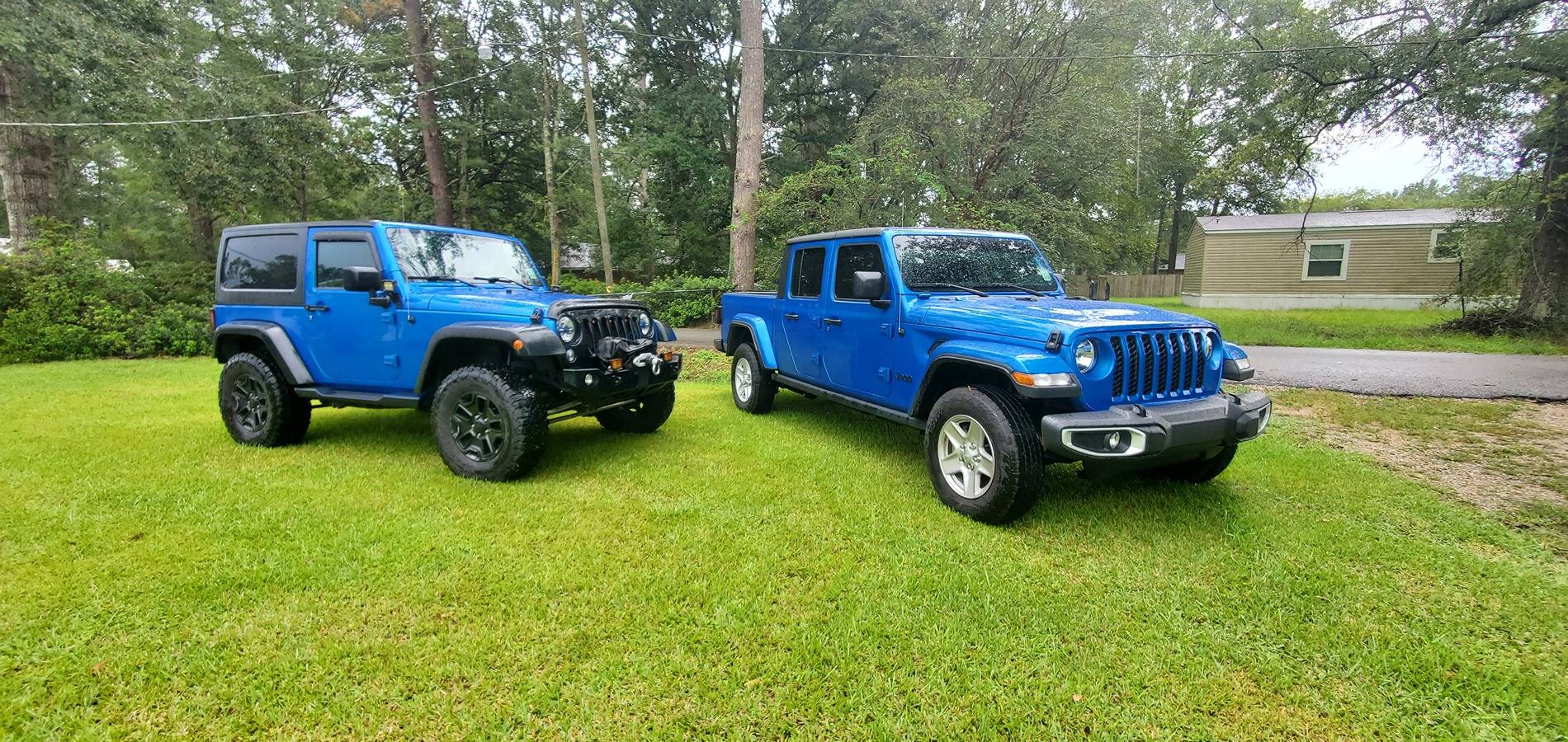

Day 1, with my previous Jeep.
Jeep Gladiator '22 Sport S Max Tow, Three Years / 30K in Review 20220903_125833

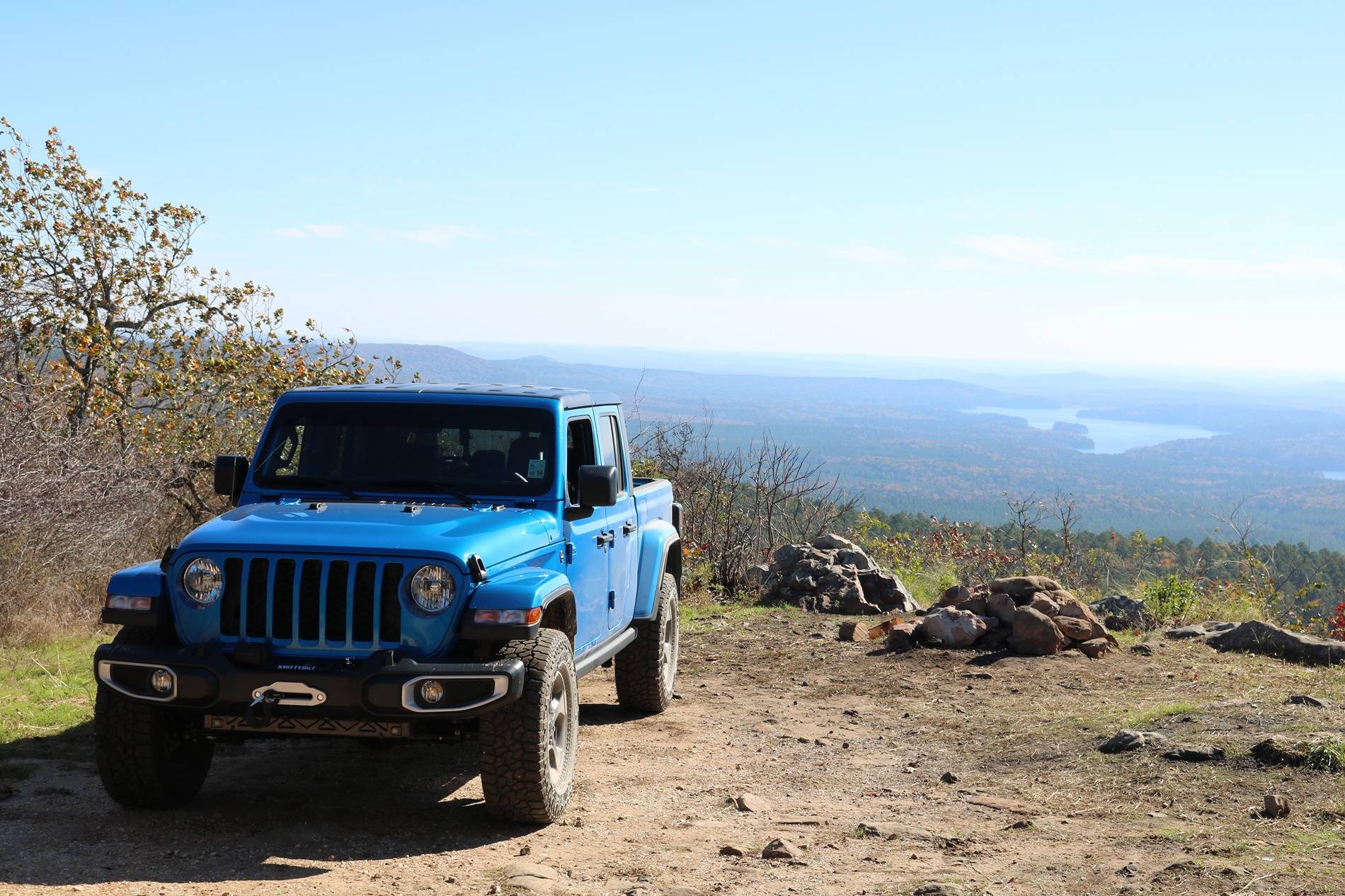

Hot Springs, AR. Exploring the national forest.
Jeep Gladiator '22 Sport S Max Tow, Three Years / 30K in Review IMG_1751.JPG

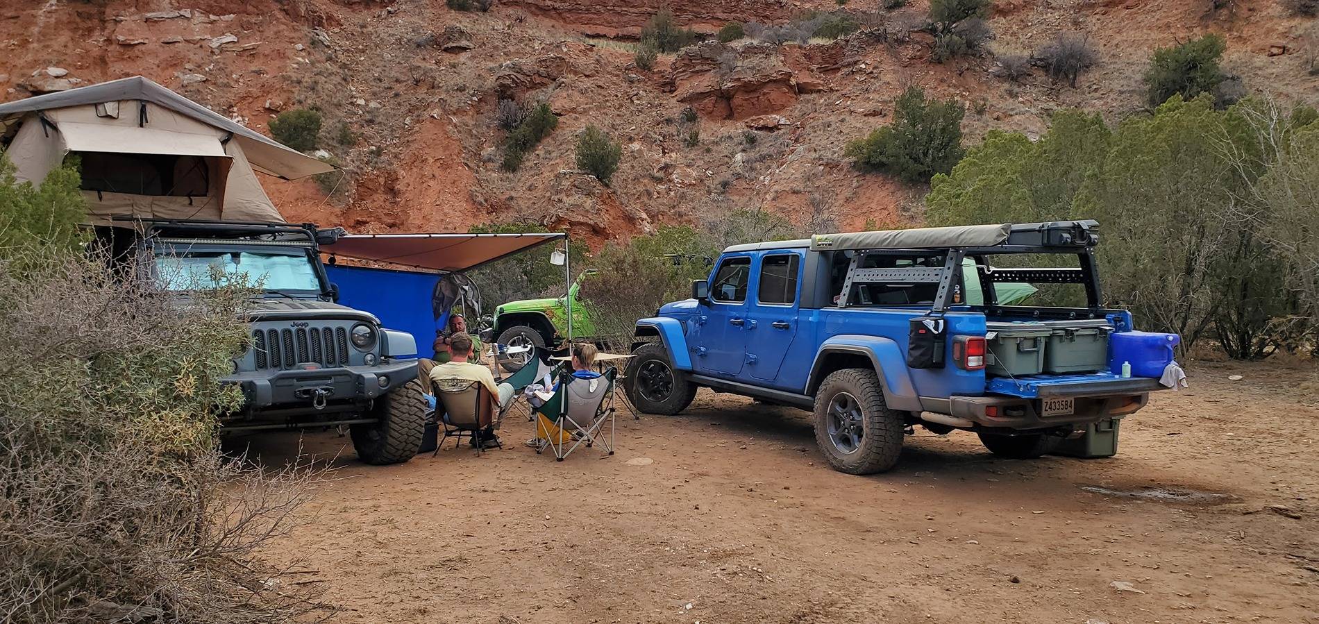

Merus Adventure Park - Claude, TX. Off roading the blue trails and camping deep inside Palo Duro Canyon.
By the way, the truck will do 107 MPH in this configuration. I don't advise repeating.
Jeep Gladiator '22 Sport S Max Tow, Three Years / 30K in Review 20230408_190846

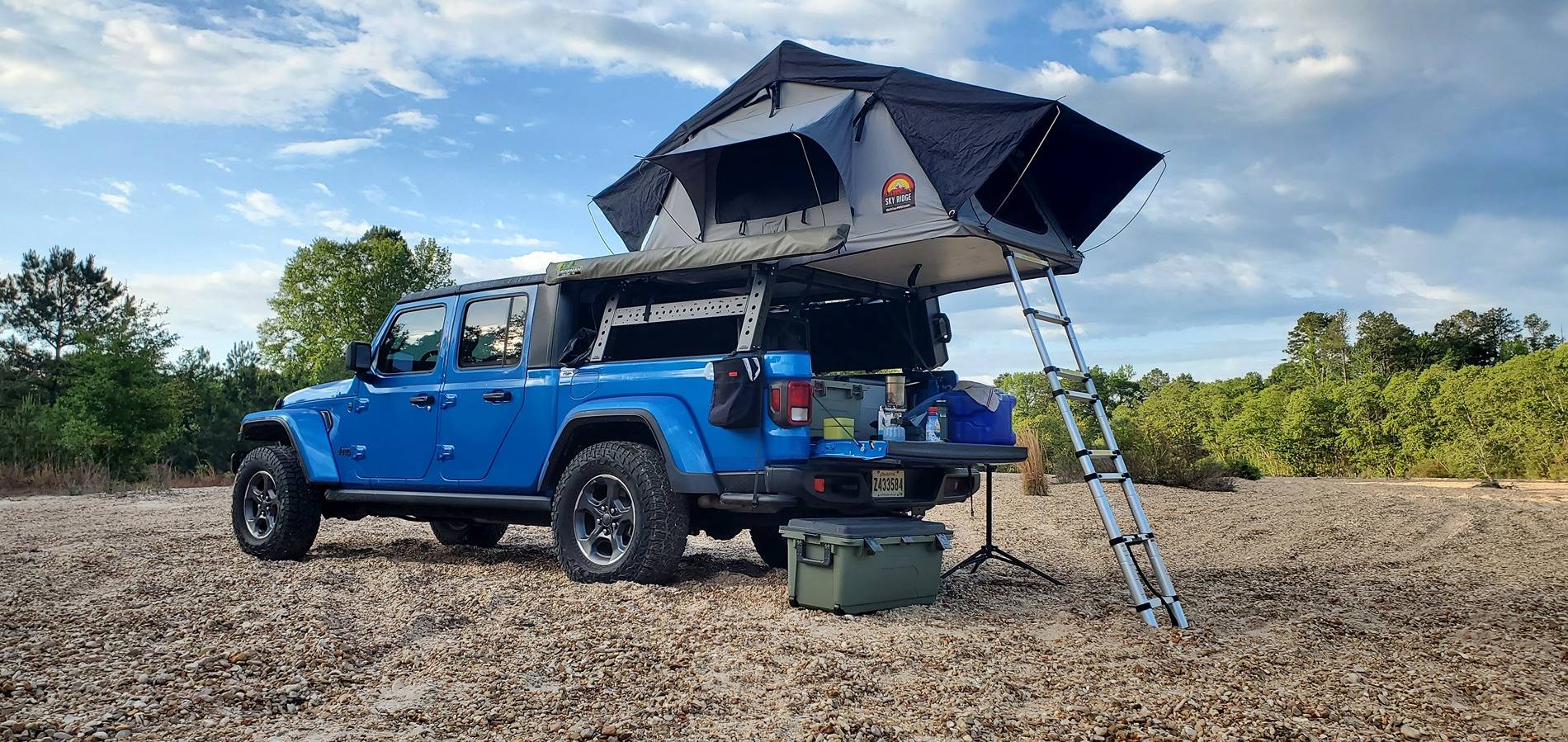

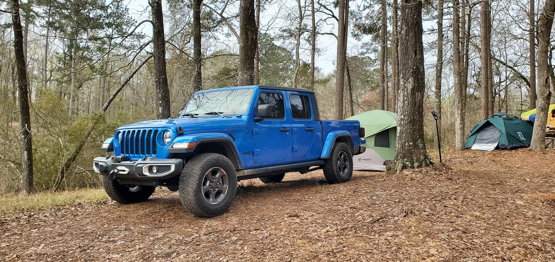

Camping nearby, southeast Louisiana.
Jeep Gladiator '22 Sport S Max Tow, Three Years / 30K in Review 20230423_072602
Camping nearby, central Louisiana.
Jeep Gladiator '22 Sport S Max Tow, Three Years / 30K in Review 20230225_085748

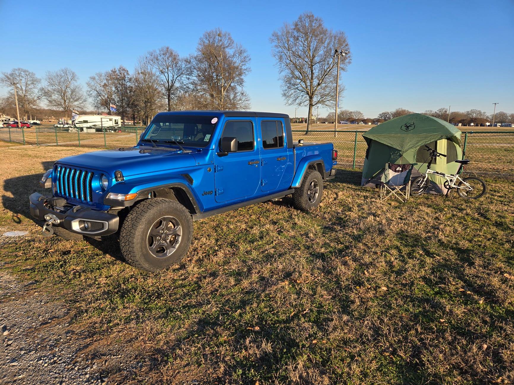

Camping not nearby, Atlanta Motor Speedway for my first NASCAR Cup Series race.
Jeep Gladiator '22 Sport S Max Tow, Three Years / 30K in Review 20250220_173346

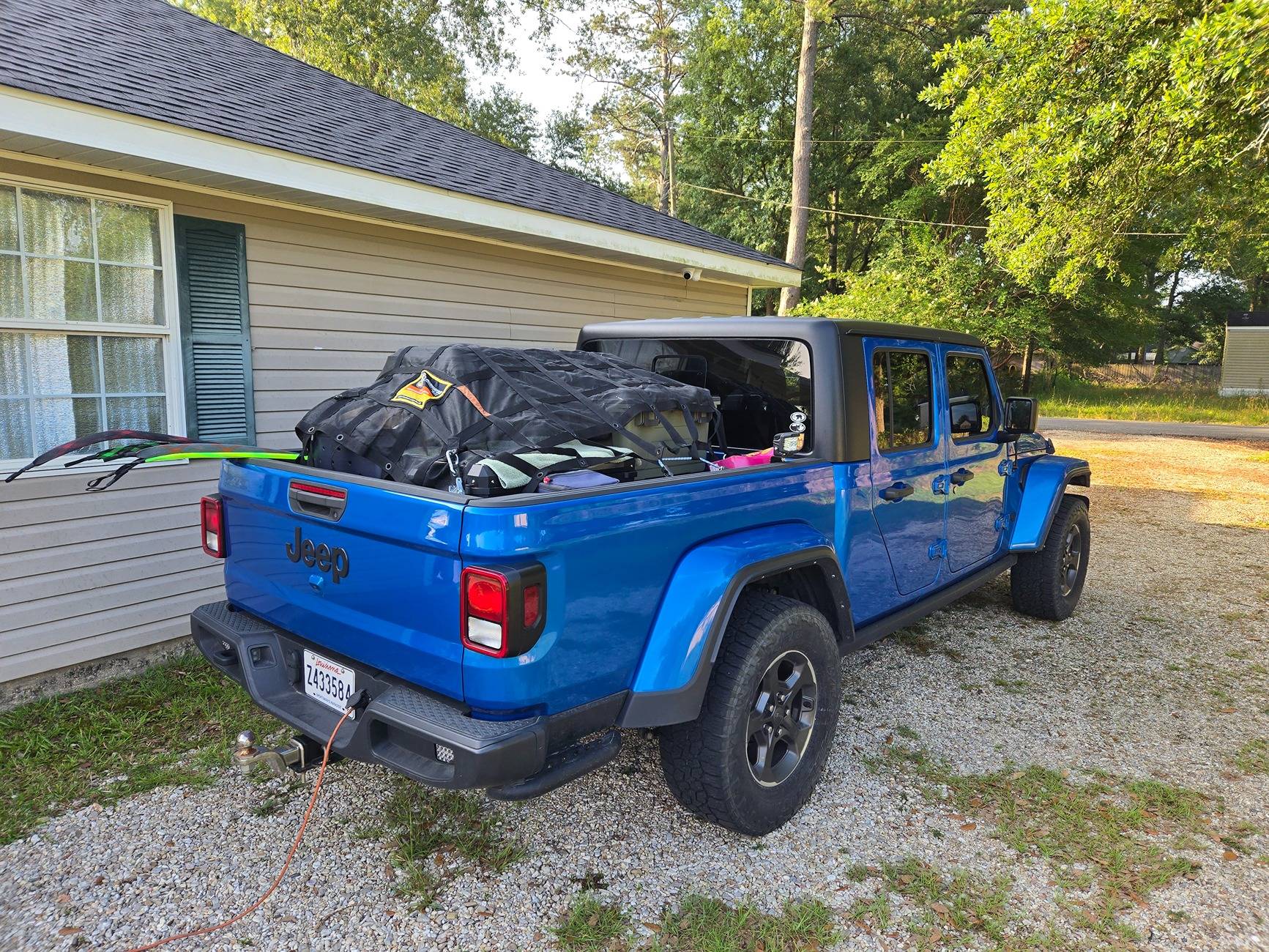

Loaded up for two adults and three kids to spend the weekend fishing at a state park cabin.
Jeep Gladiator '22 Sport S Max Tow, Three Years / 30K in Review 20250604_073544

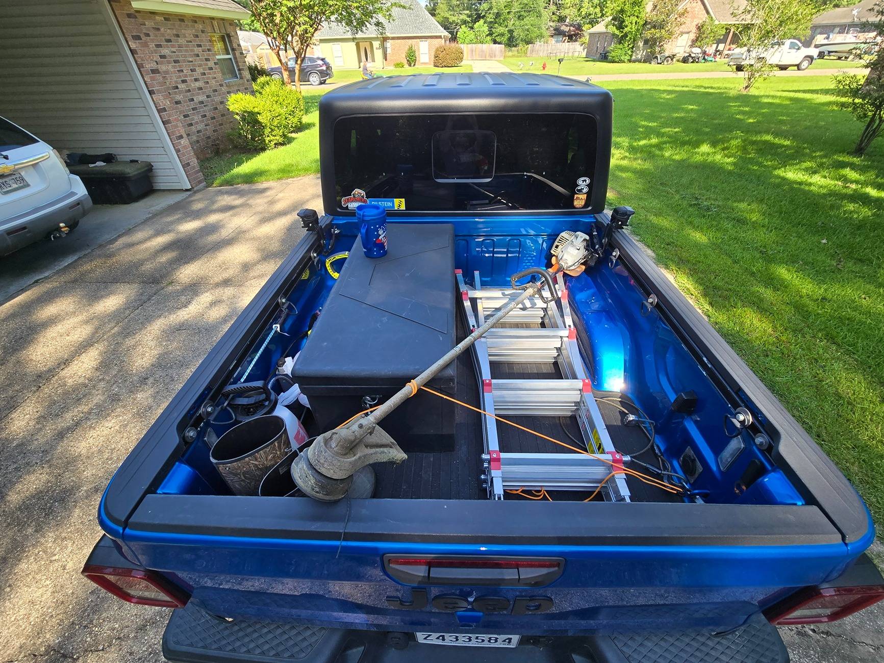

Practically every weekend maintaining three houses at the moment.
Jeep Gladiator '22 Sport S Max Tow, Three Years / 30K in Review 20250622_092055

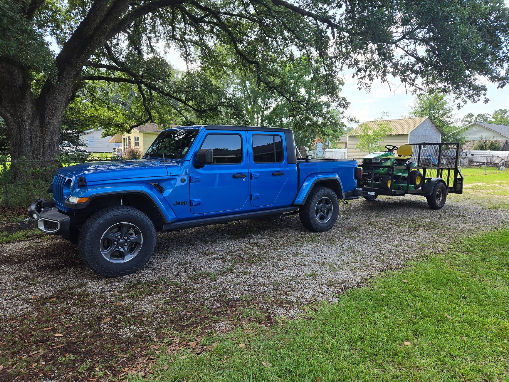

2-3 times a month, dragging the trailer loaded with all manner of junk.
Jeep Gladiator '22 Sport S Max Tow, Three Years / 30K in Review 20250628_160429
