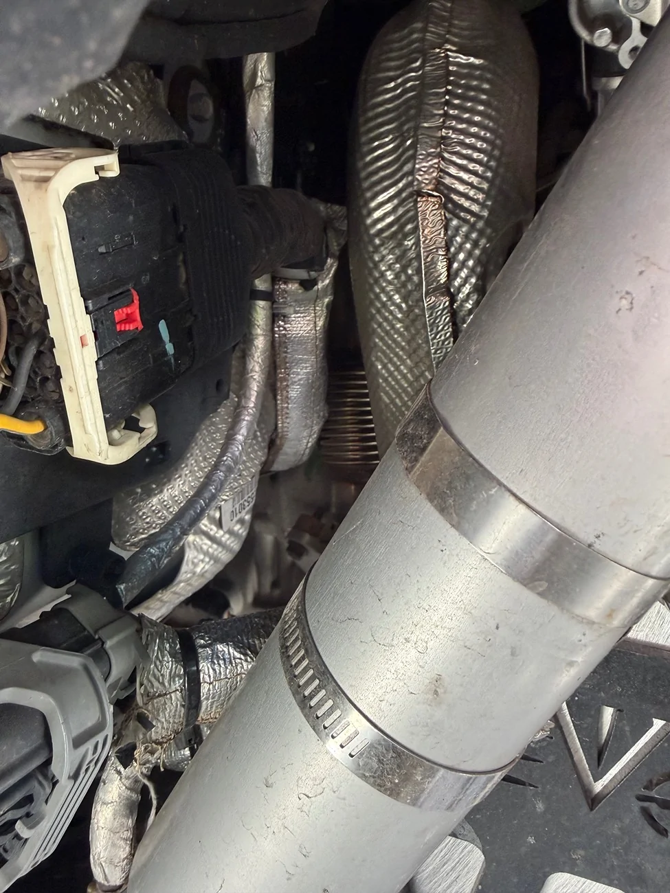

What you described sounds very similar to my experience with my ‘21 JTRD. Long drive under load, Christmas Dash lights, derate, cool down, all good except a CEL.
The first thing I would do. Get some DEI heat wrap for the wire harness that goes down front passenger cowl towards the DPF. This was a great improvement for me.
Jeep Gladiator 3.0 limping...no obvious reason. Random CEL IMG_0050
