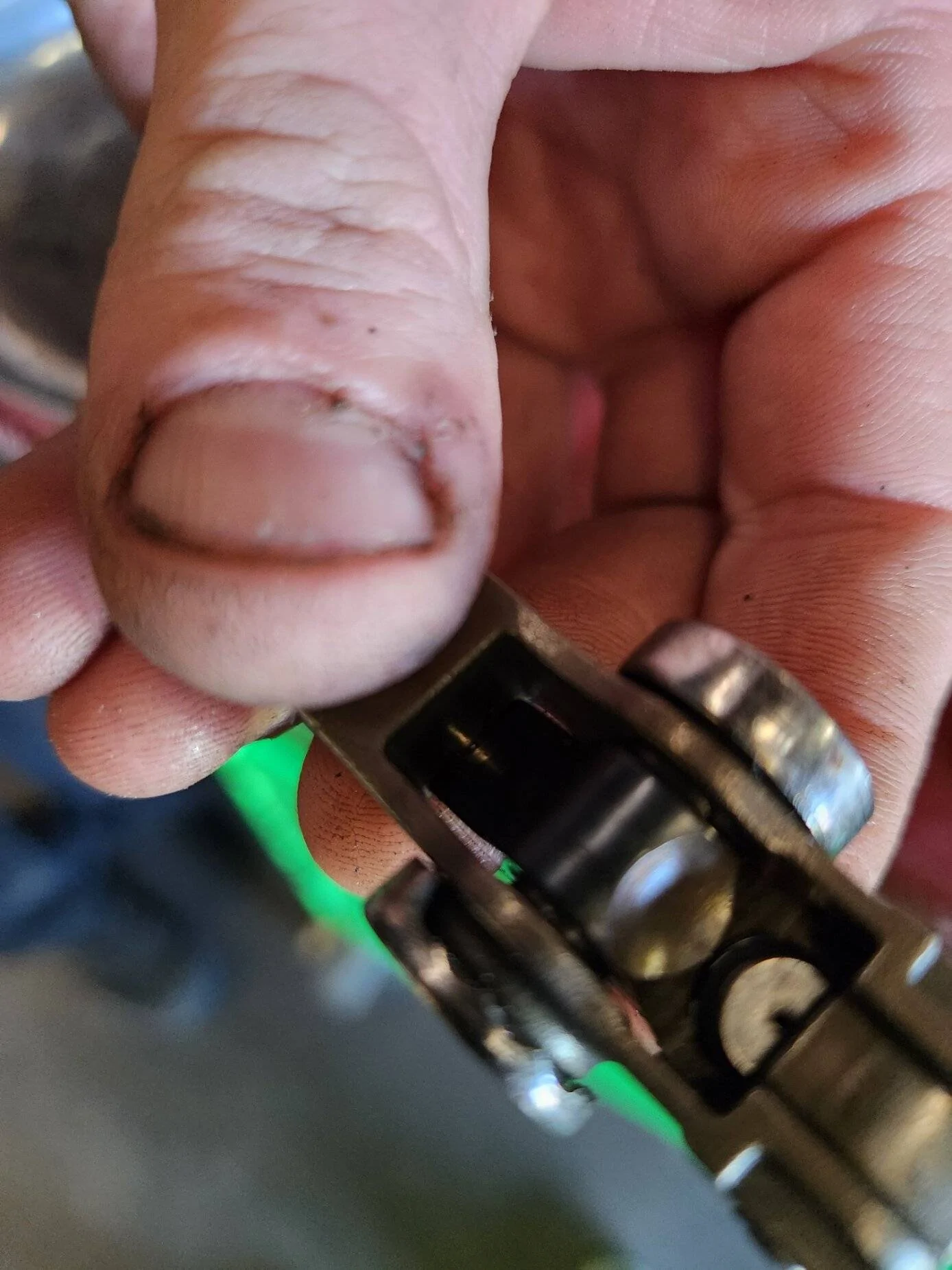

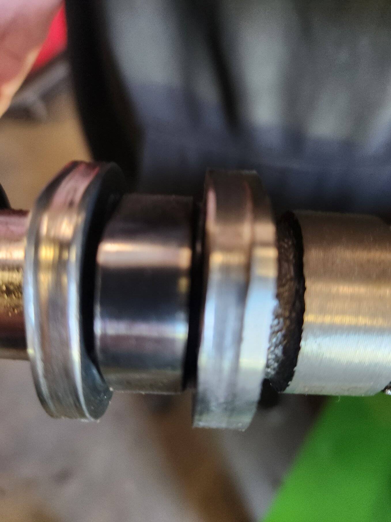

I have a Magnuson Supercharger on my 2020 JTR 3.6. A few weeks ago I was heading out to go wheeling and as my rpms hit 4000, I got a Cylinder 6 misfire and an awful shake in the engine. I stopped and turned off the Jeep. After letting it sit for a bit, I cranked it up and it drove fine until rpms hit 4000 again and then it went into limp mode. I disconnected the battery to get it out of limp mode and then took it to the dealership nearby. The construction of the cam/lifters is such that above 3500 rpms, the outside lobes of the cams ride on the rollers on either side of the lifters. One of the rollers on the Number 6 lifter (Driver Side) broke and carved out a big chunk of the cam lobe. Photos attached. While working on it, they also found out about the TSB to correct coding for the passenger side Cam(odd # Cylinders). I got the passenger side replaced for free, but was out of warranty for the driver side and it was not included in the TSB for one of the reasons described above.
I had to off load the new dealer code and email it to Magnuson along with the information from the dongle and VIN, etc. Within 4 hours, they sent back a new tune file. I loaded it onto my Jeep and it drove great leaving the dealership. Halfway home it went into partial limp, which I think limits rpms to 3000. Took it back to dealer and it showed a PCM Communication error. Dealer cleared it and again it drove great halfway home and went back into the partial limp mode. No engine lights either time. Remembering how @DAVECS2 suggested disconnecting the battery overnight when we had a similar issue on initial install, I just unhooked the battery. Hopefully when I reconnect in the morning it runs fine. I just hate they had to reflash it and cause me to have to redo the tune. Otherwise, the supercharger was running great.
Jeep Gladiator 3.6 Cam Self destruction Cylinder 6 Lifter
Jeep Gladiator 3.6 Cam Self destruction Driver Cam Cylinder 6 lobes 1
Actually, the outside rollers are the low lift mode and under 2800 RPM.
High lift mode is above 2800 RPM and on the center of the rocker/follower.
So going over 2800 rpm you are not on the rollers, you are on the center section.

I am just repeating what the mechanic told me, which makes sense given the issues only presented at around 4000 rpms and the damage to the lifter is a broken roller and the corresponding gouge in the cam lobe. I am no engine expert, just trying to make sense of the problem based on info the mechanic who fixed it showed me. You may be right. he may be right. Either way, my junk was broken.

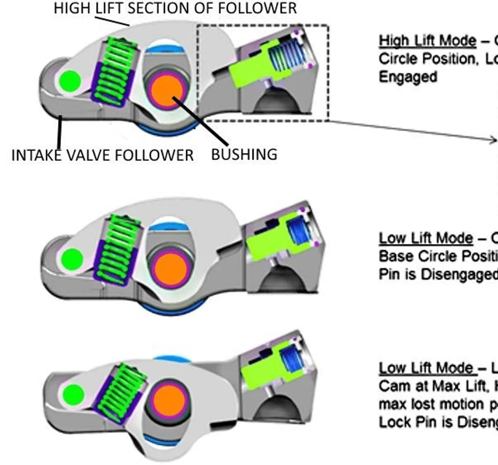

No, what he told you makes no sense and he doesn't know what he's talking about.
At over 2800 rpm, the follower (rocker) is on the center section. Not sure where he got the 3500 RPM or whatever. That's way off.
Granted, the low lift outer lobes are worn, but that's the low lift, and what it's using at lower RPM.
I'm showing you a picture from MOPAR STAR tech training documents. I have a feeling I know more than that tech does, but then, that's no surprise, either.
Jeep Gladiator 3.6 Cam Self destruction 1678248963597
Low lift used at lower RPMs is the purple colored outer lobes.
The inner lobes are the high lift - over about 2800 RPM.
Jeep Gladiator 3.6 Cam Self destruction 1678249133482
Outer lobes are low lift, low speed operation.
Inner lobe = high lift for higher engine speeds.

Why you saw the misfires and errors at high RPM - especially above 3500-4000 rpm, is interesting.
I wonder why it took out the low lift portion of things - that's been pretty solid on these for the most part.

My concern would be in this case - what caused the low RPM, low lift rollers to fail like that.......... that's not the weak spot in these. Oil issues?

It is very unusual for the low lift rollers and cams to wear. I have repaired hundreds of Pentastar and upgraded Pentastar engines, and have seen this kind of damage only a couple of times. The high lift rocker and cam, on the other hand, is more prone to failure. Even then, the actual percentage of failures is very, very low. If only people could realize how good the Pentastar engines really are.
