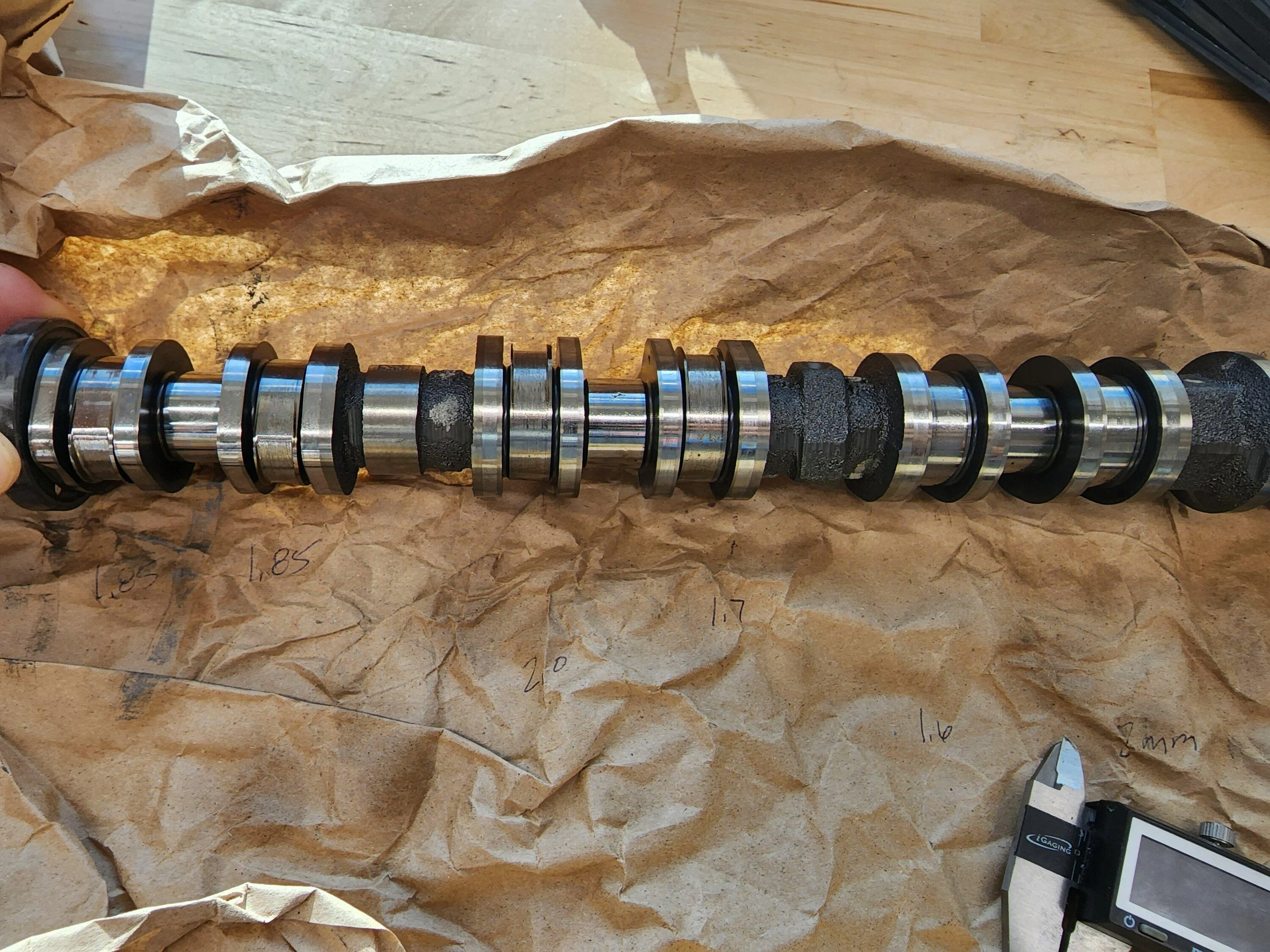

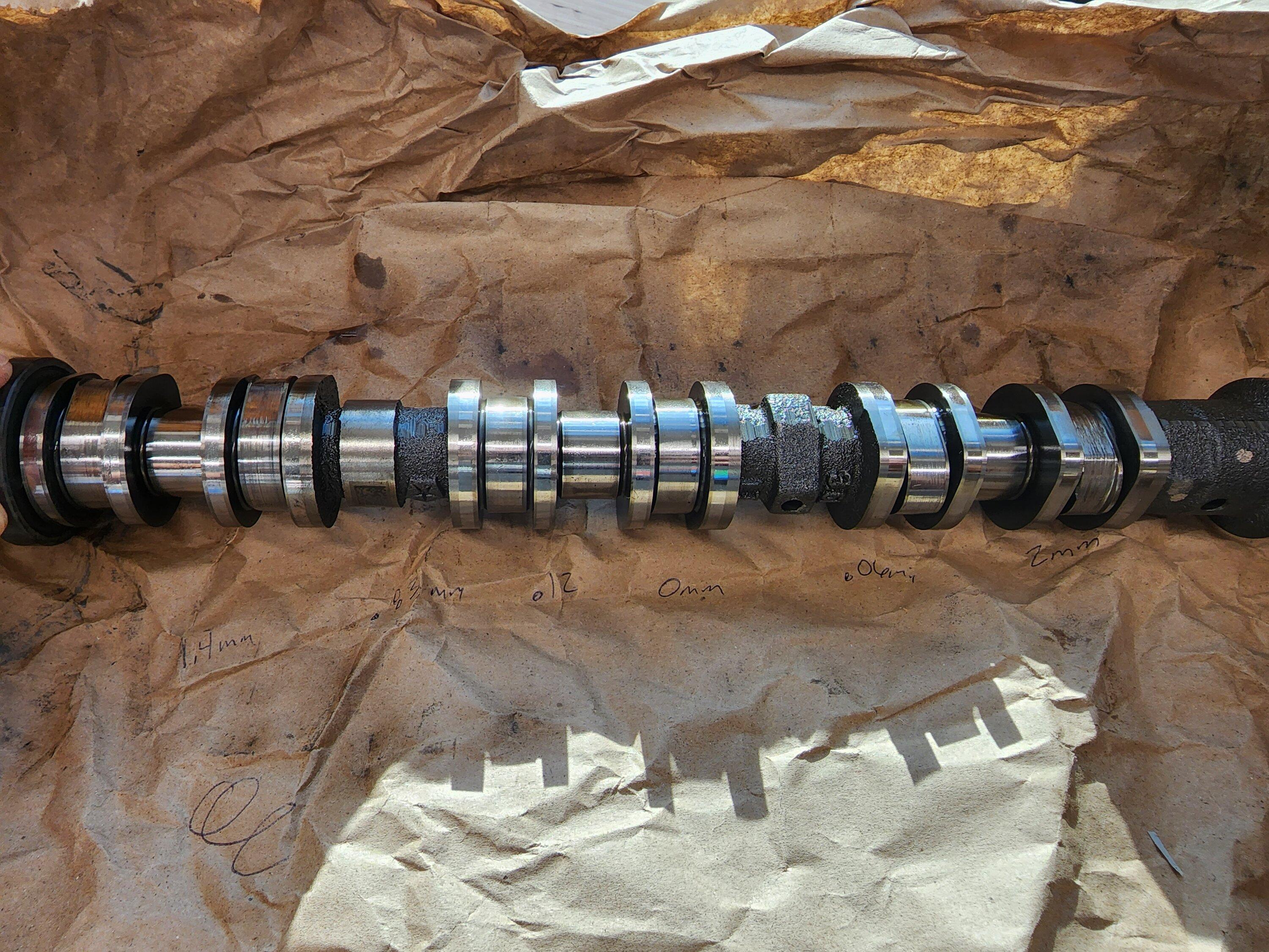

I swapped the cams and found the bank 1 lobes to be consistently ground whereas bank 2 was more erratic.

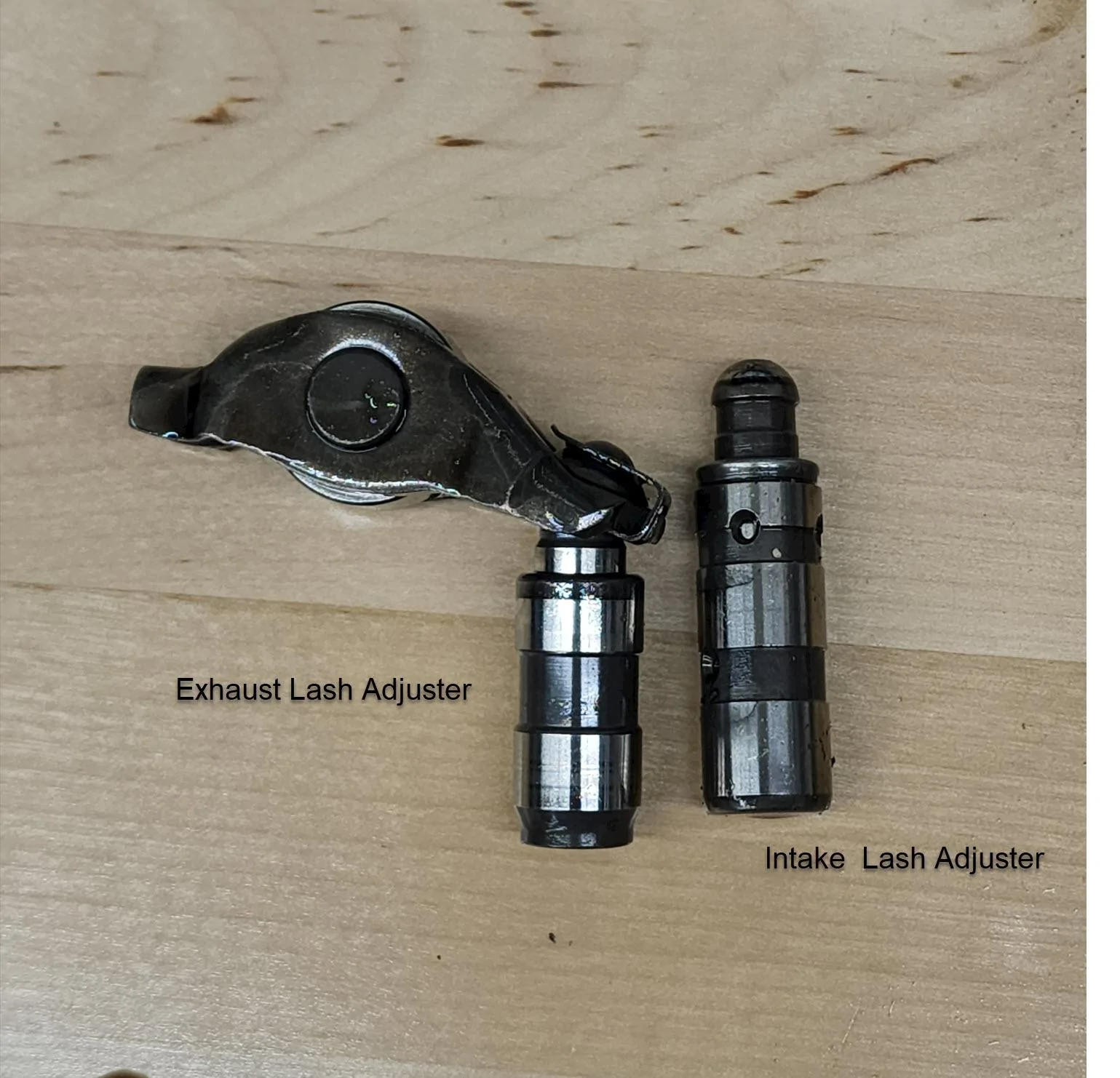

There has been some assessments that Jeep installed the exhaust lash adjusters on the intake cams. Based on my tear down, this is not the case. The lash adjuster part numbers have been updated to a new rev and look different than the old adjusters. But there is no way the exhaust lash adjusters would work on the intake side. The height is just too different. The exhaust adjusters also have no oil paths whereas the intake does.
Lash adjuster photo:
The following is an approximation of the wear by lobe:
Bank 1:
Controlled by front solenoid
Cylinder 1 V1: 2.0 mm​
Cylinder 1 V2: 1.6 mm​
Controlled by rear solenoid
Cylinder 3 V1: 1.7 mm​
Cylinder 3 V2: 2.0 mm​
Cylinder 5 V1: 1.9 mm​
Cylinder 5 V2: 1.9 mm​
Bank 2:
Cylinder 2 V1: 2.0 mm​
Cylinder 2 V2: 0.06 mm​
Cylinder 4 V1: 0 mm​
Cylinder 4 V2: 0.12 mm​
Cylinder 6 V1: 1.4 mm​
Cylinder 6 V2: 1.6 mm​
Bank 1 Intake Cam
Bank 2 Intake Cam
