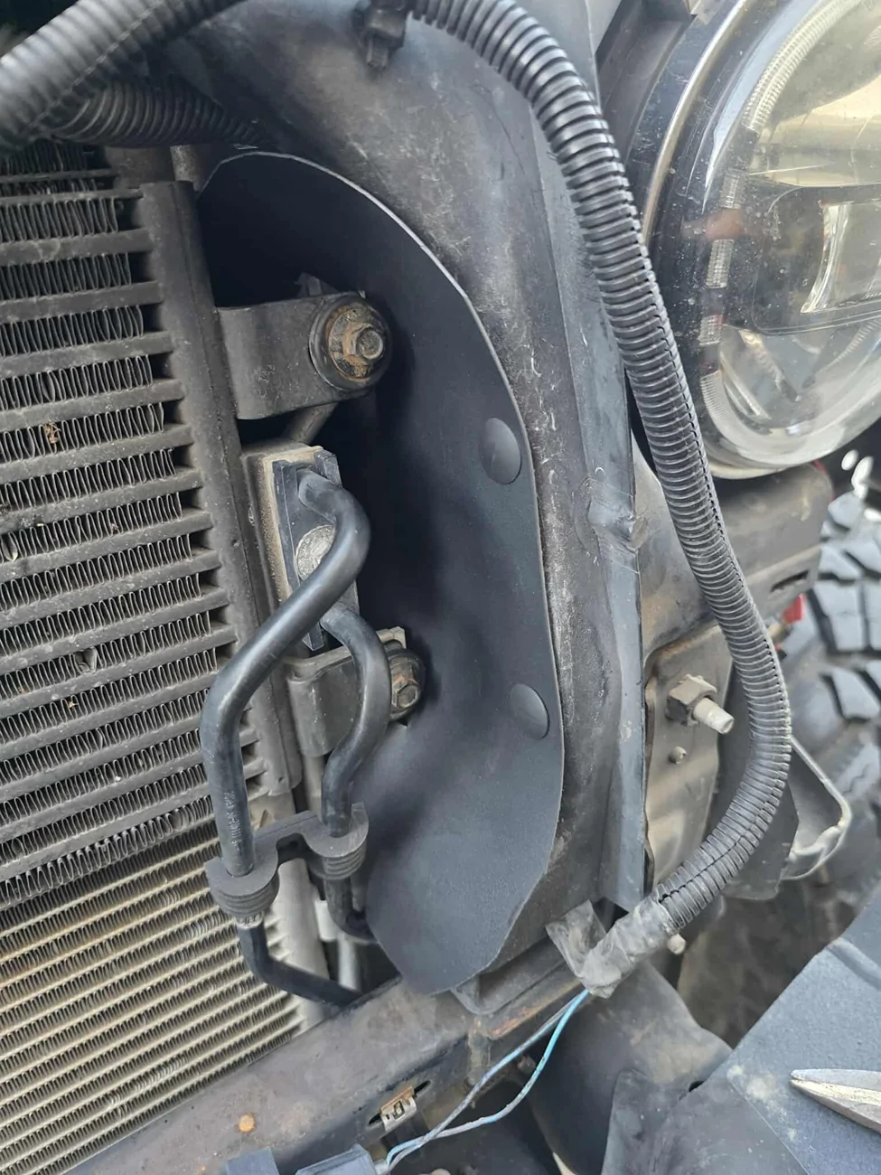

I have no issues with trans temp. It's rock solid. Seems unreasonable to demand manual shifting in any modern automatic vehicle, but admittedly I have not read the owners manual and can't confirm or deny.
My trailer is a measly 2360lbs on the scale when loaded for 3 weeks.. and more often it's not loaded for 3 weeks. Even without the trailer, the same symptoms persist.
The engine is completely stock. I've tried a number of things with the 3.6 and using JScan to manually turn the rad fan on high during hill climbs helped slightly. Otherwise, everything else I've tried made no noticeable difference.
Replaced thermostat 3 times.
Replaced water pump
Oil cooler
Radiator twice, including testing the Mishimoto radiator.
Removed my winch to see if air blockage could be the problem
I even created stiffer radiator shrouds to force wind through the radiator, making sure it's not escaping around the radiator.
