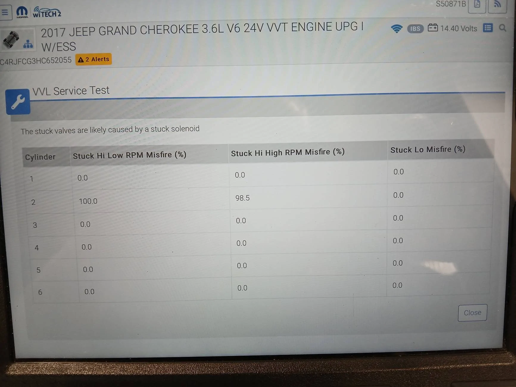

Well the PCM flash didn’t work. Tested it out on a 2nd gear WOT and let out at 5.5k rpms and the CEL started blinking again. They obviously didn’t bother to pull the valve cover and inspect the cam or valvetrain. They said I had to pay the diagnostic fee but if it came back they would waive it. So I am going to take it back in and have them actually look into it. It’s only misfiring at higher rpm’s at the moment.
The tech should run a VVL service test. It is in WiTech, under PCM tests. It will operate the VVL at high and low lift settings, allowing the tech to see if a misfire is caused by a failure of the VVL rocker arms or possibly the VVL solenoid. It is a first step for me when diagnosing a misfire that could be caused by possible VVL issues. I say this because there are other possibilities for your misfire, but this test is a good starting point for high RPM misfire diagnosis. This is a picture of the results of a VVL test I ran.
Jeep Gladiator 3.6 Engine Tick 20241202_104048
Thank you! I will definitely run that by them tomorrow when I drop it off.

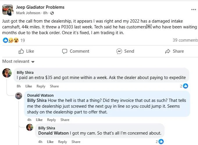

Just read on one of the Gladiator problem Facebook groups that it seems some dealers are charging a fee and giving customers front of the line privileges on getting their cams replaced.
Jeep Gladiator 3.6 Engine Tick CAM GLADIATOR
$35, really? That service department doesn’t understand supply and demand economics then.
Ethical issues aside, I thought the same thing.
