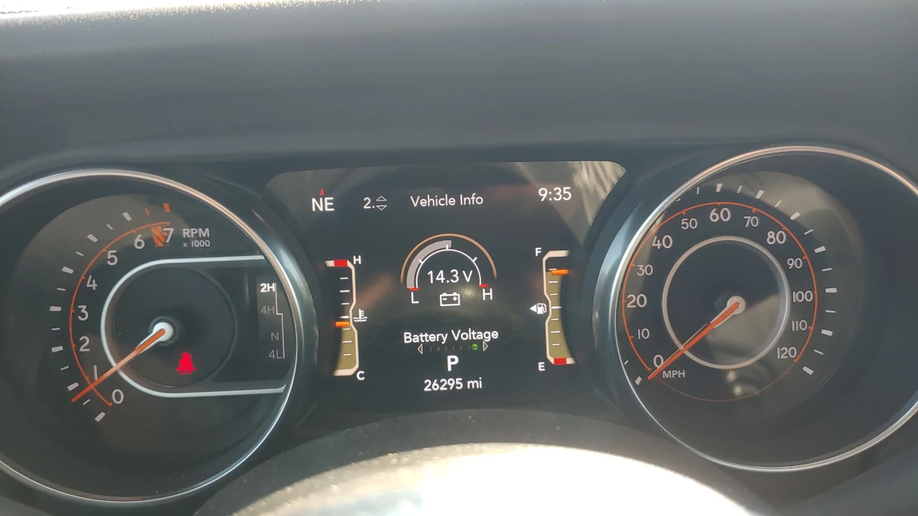

You can change what displays in the cluster in front of you - and scroll through them all, including transmission temp, oil temp, tire pressure, voltage and more.
These have more than two idle speeds, too - own in long enough and you'll find the speed can slowly drop when it's very cold - starting at about 1400 and then dropping from there. Mine has been as several different idle speeds.
Example of what you can display in the cluster -
