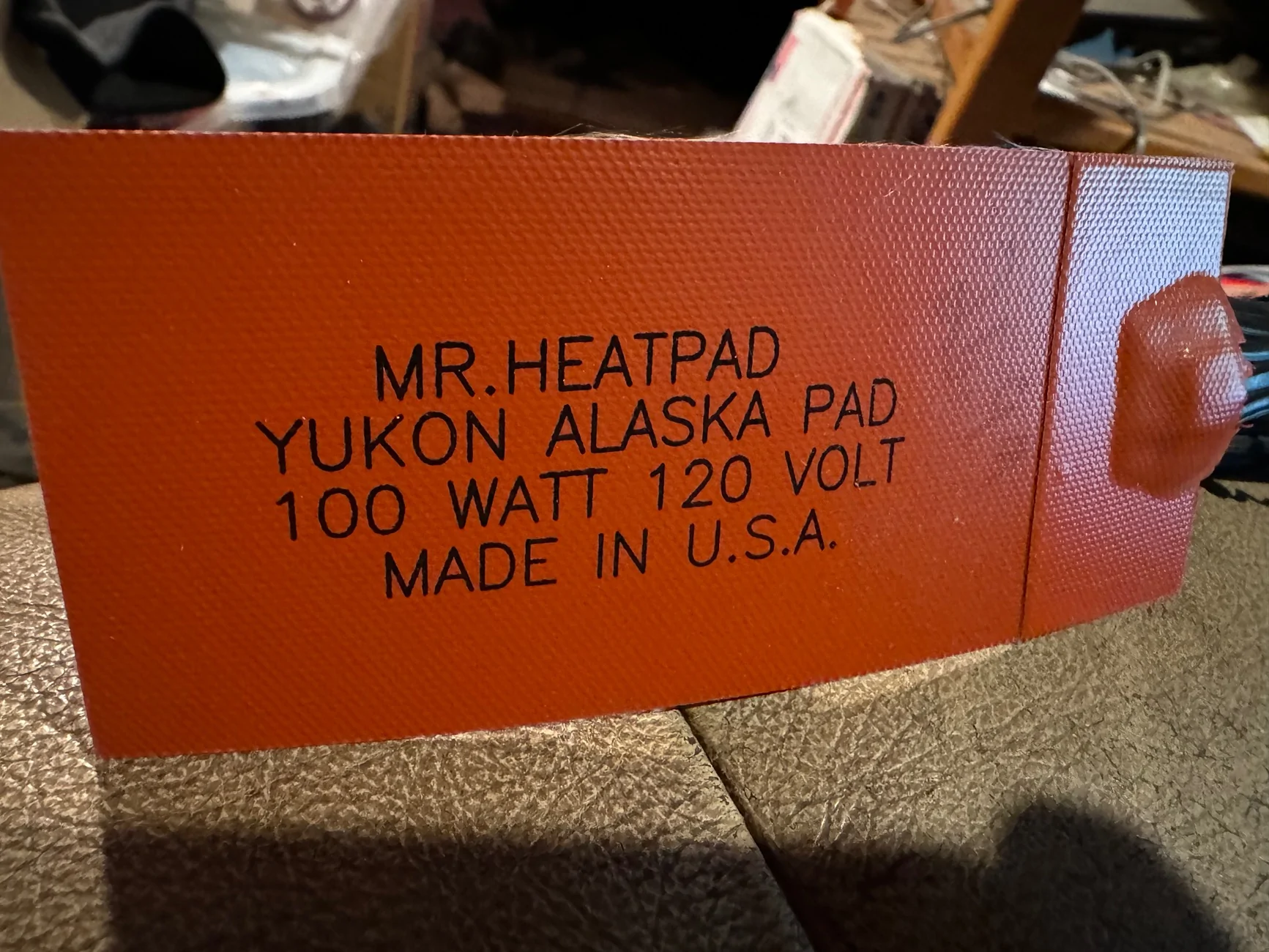

I mount heat pads on all my vehicles. You plug the truck or car in long enough to get warm enough to avoid damaging it. The block heater is for coolant, the heat pads are for oil pans and batteries.
