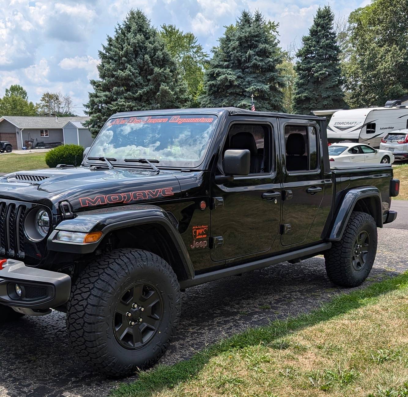

Thinking about going from my stock Falken MT’s to 315/70’s to Bfgoodrich Ko 2 or Ko 3 on the stock Mojave rims. Anyone that has done this what are your likes & dislikes about the change?

Save yourself some time and money and go straight to 37
I get what you are saying. 37’s look great. Don’t want to do a gear change plus I only do light trails. Will be adding a 2” AEV lift also.

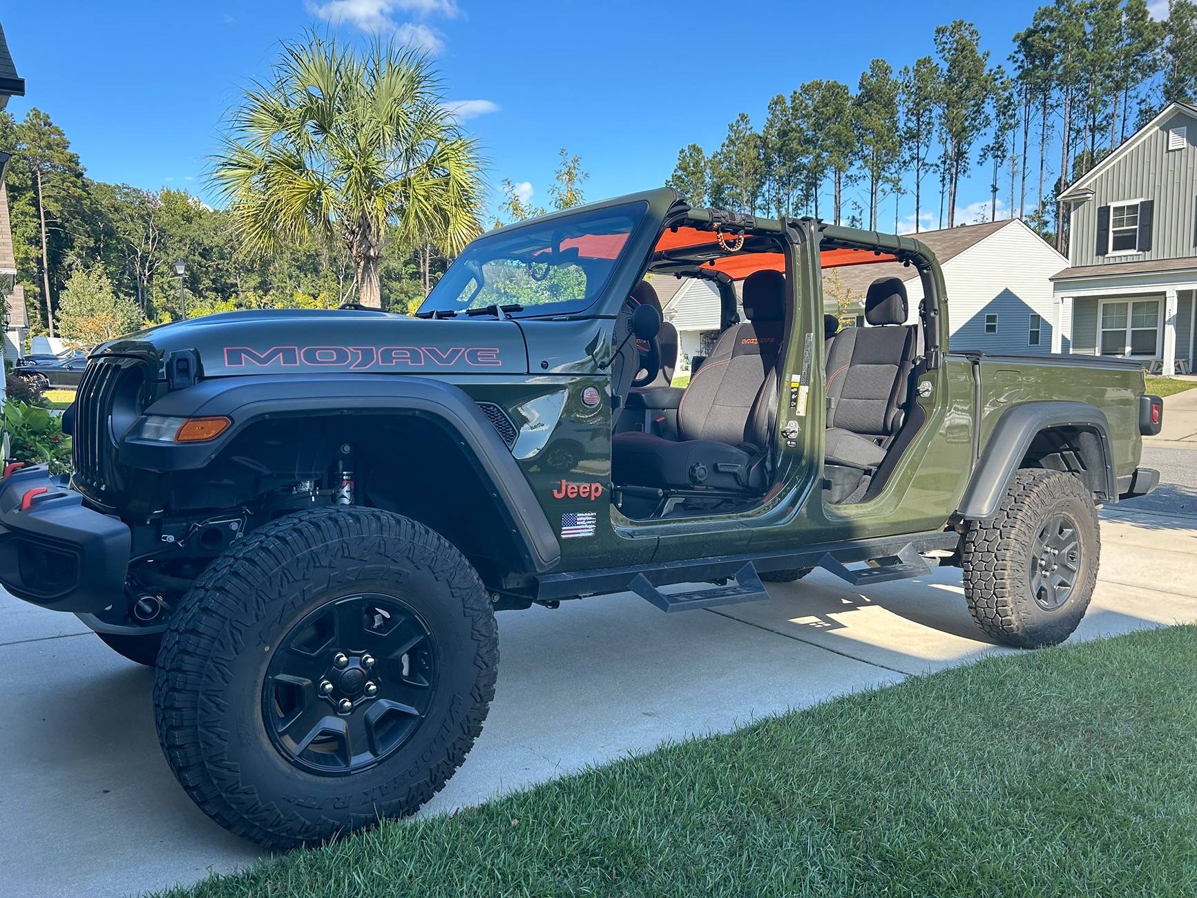

I have 35” ish BFG K02s on AEV Salta IIs calibrated for size increase and calculated gearing from 4.10 to 3.92 No substantial changes to performance Or towing a 20’ boat to the keys. I still get 8th gear on the highway.
