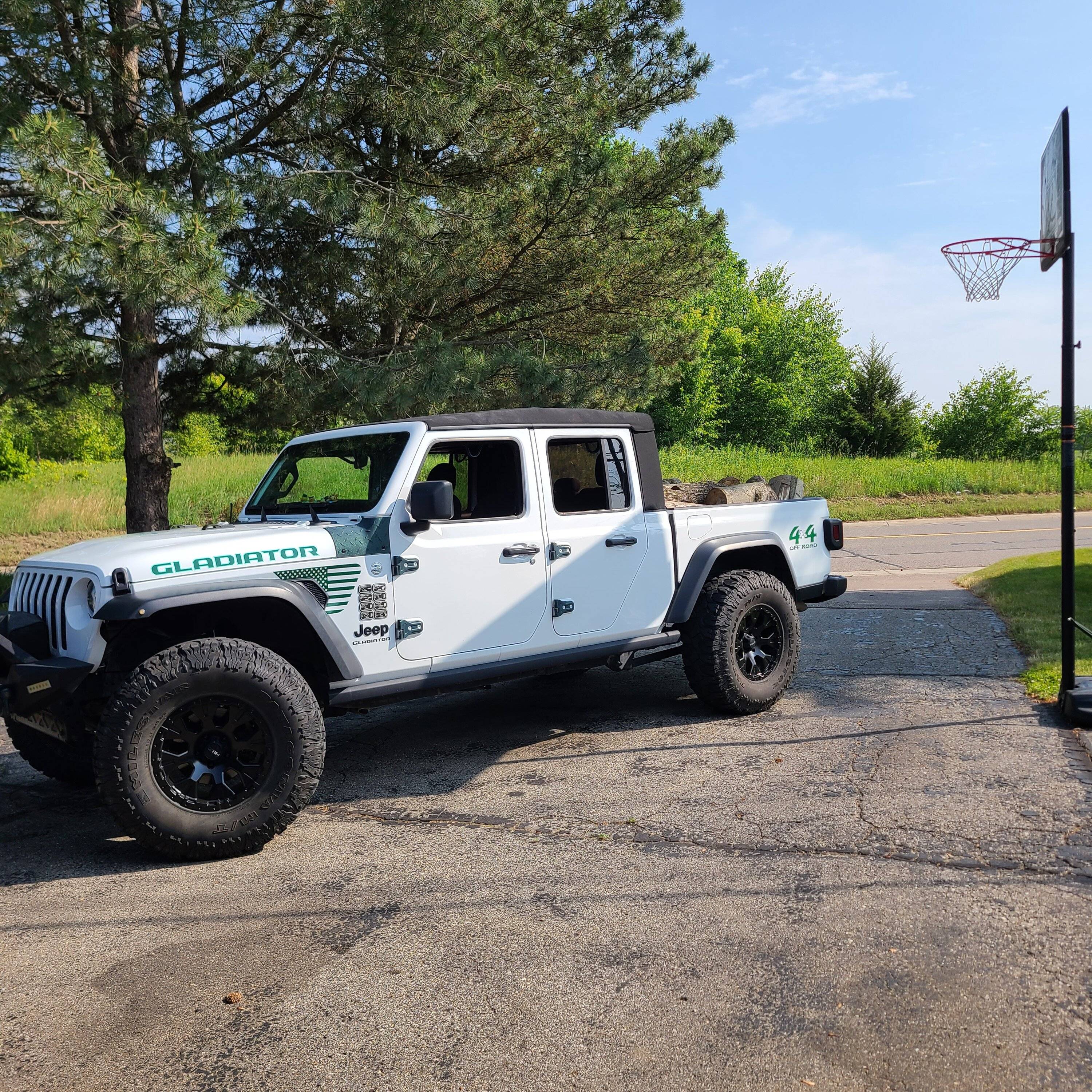

Even after changing the tire settings in the computer?
Yes, tire size is dialed in within 1mph gps speed. If there's no wind or a tailwind I can hit 8th sometimes, otherwise I end up in 7th. Towing my boat is usually 4th or 5th.

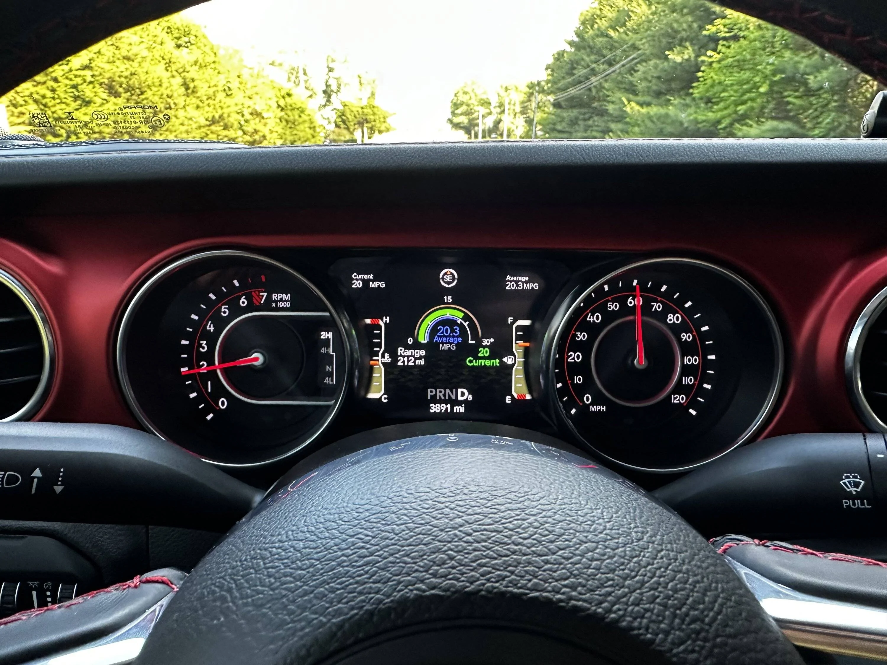

I went from factory 4.10’s on Toyo RT 315/70R17 (rough equivalent of a 35x12.50) to 37x12.50 BFG KO2’s and Dana/Spicer 4.88 gears this past week. The computer has been updated to reflect current parts. It drives similar to stock (4.10 on 33”)… probably a little more pep down low. I got my around town fuel economy back.
I’m seeing just under 1,900RPM @ 60MPH in 8th gear. IMO it was money well spent.
