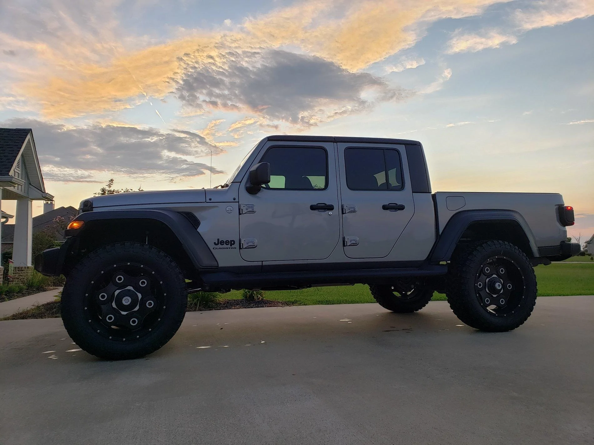

I'm running 3.5" lift with 37's on my Sport S with the Max Tow pkg. The 410 gears do fine with the tires but the 8 speed tranny is struggling. I've only put a couple hundred miles on it since the lift/tires but so far the thing wont shift into 8th gear at all. It averages ~2500 rpms at ~70mph. Gas mileage is ~14mpg.

From what I understand, 7th and 8th fear are both overdrive gears. I’m ok with the transmission not using 8th. A 7-speed transmission is still far better than prior options.

This is true! I also have not used a tuner to change the tire size yet...I downloaded a GPS speedometer app on my phone and am between 6-10 mph off. So my RPMs are actually a little closer to what I expected them to be. I was really doing ~80 when my rpms were at 2500.
