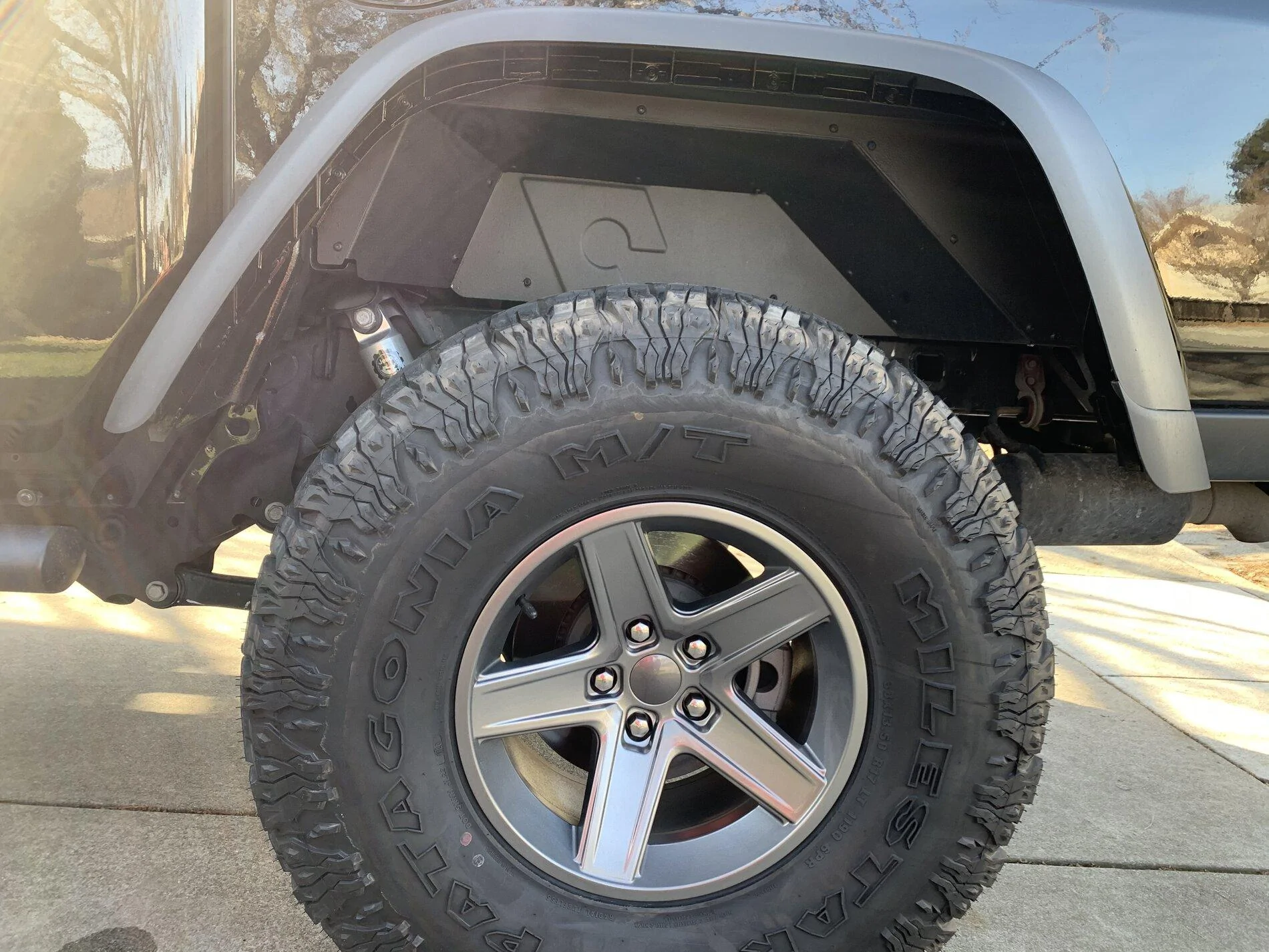

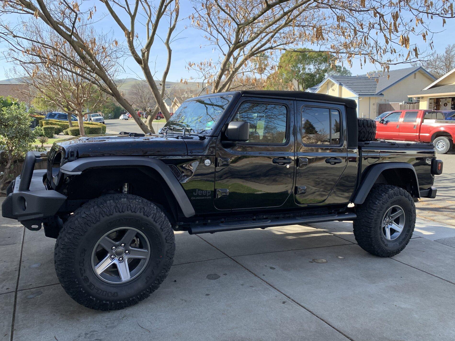

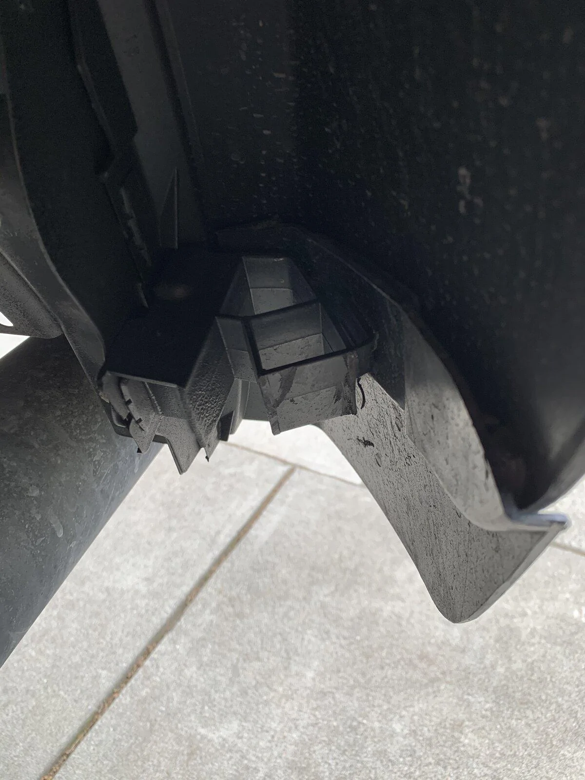

Sorry I don’t. I kept a small piece of the brace that connects the two and used existing connectors, new plastic rivets and some 3M double sided tape to secure parts. Want to avoid trying to fuse them or put a couple screws in. So far they are holding together great.
Here is a pic of trimmed inner brace

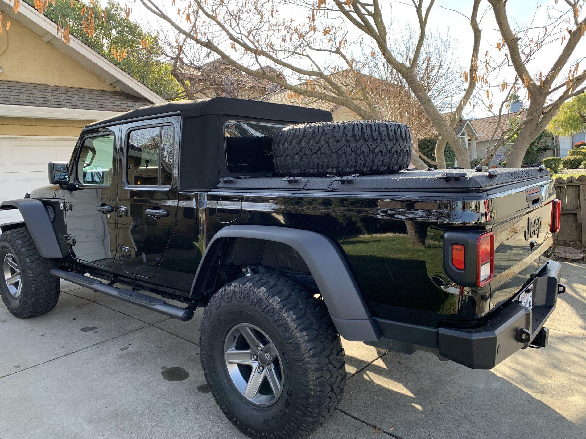

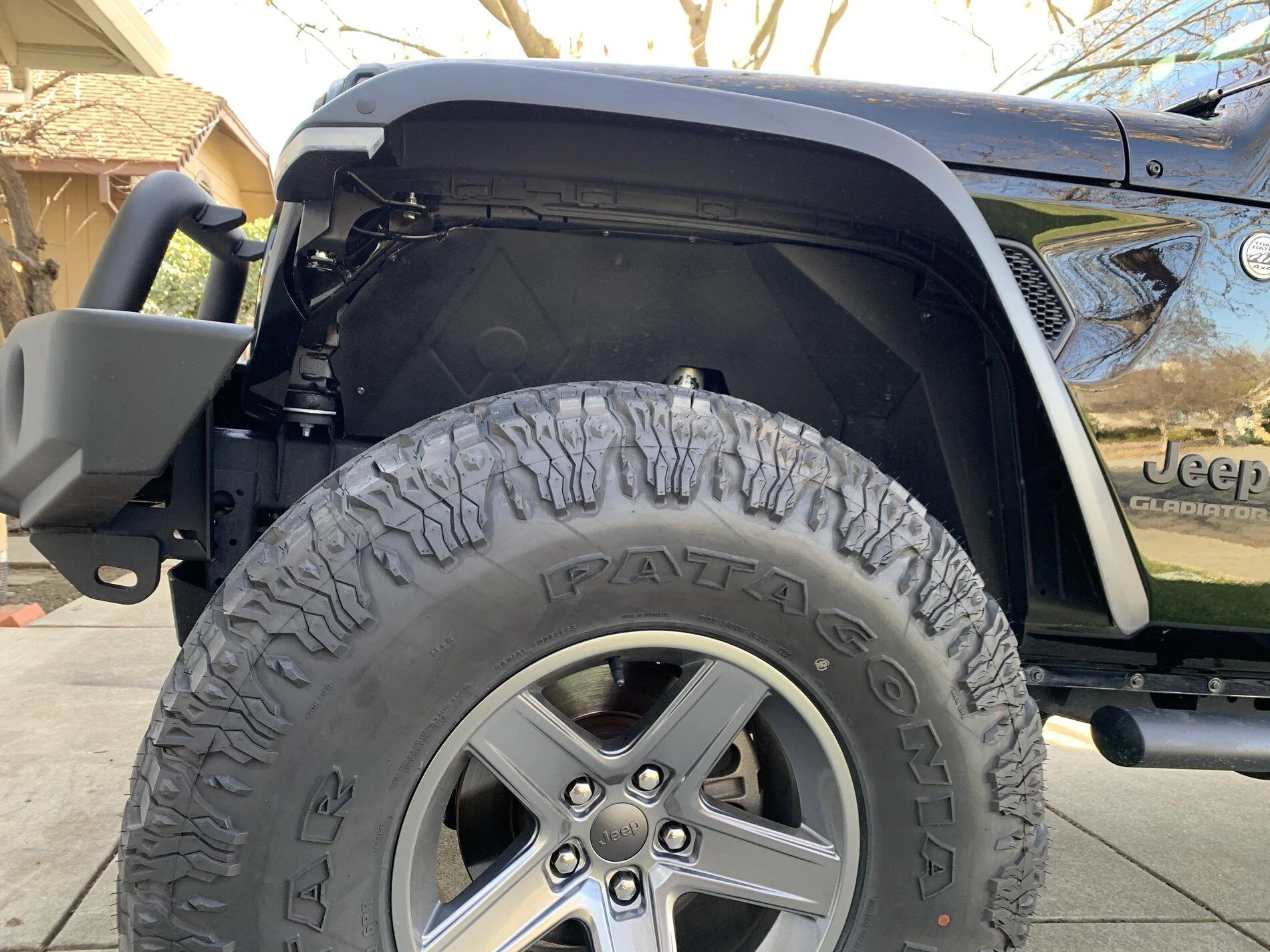

I was running 37’s on my Sport S 6 speed manual with the original 3.73 gears. And no lift. It wasn’t too bad but could never use 6th gear. Finally got around to putting in 4.56 gears and that made a huge difference in starting off in first. After that I decided to get 38” tires and the factory 2” lift installed. I actually put on the 38” tire about 2 weeks before lift and there was no rubbing with street driving. Before I lifted it I upgraded to the 2 piece rubicon fenders so I could do the fender chop. I also installed the Quake LED fender lights and Artec aluminum inner fender liners. Between the lift and new fender set up I went from 4” fender clearance to almost 10” of course after installing 38” tires I had to come up with a new mounting solution for my full sized spare tire

Did you mount the extra wheel/tire on the Diamondback? If so, how did you do so?

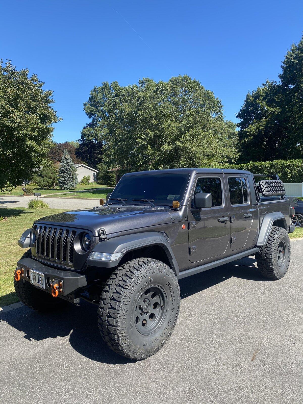

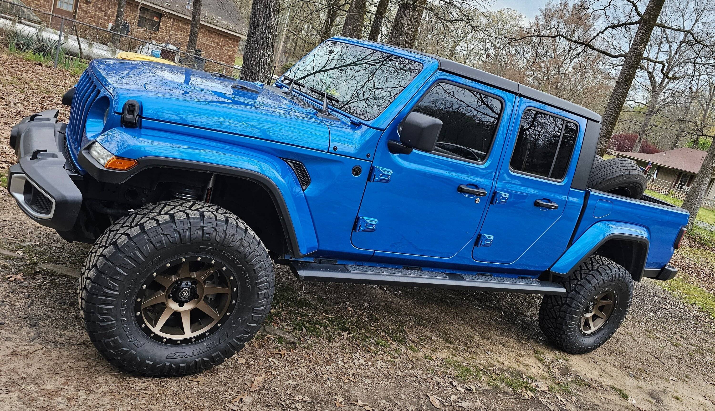

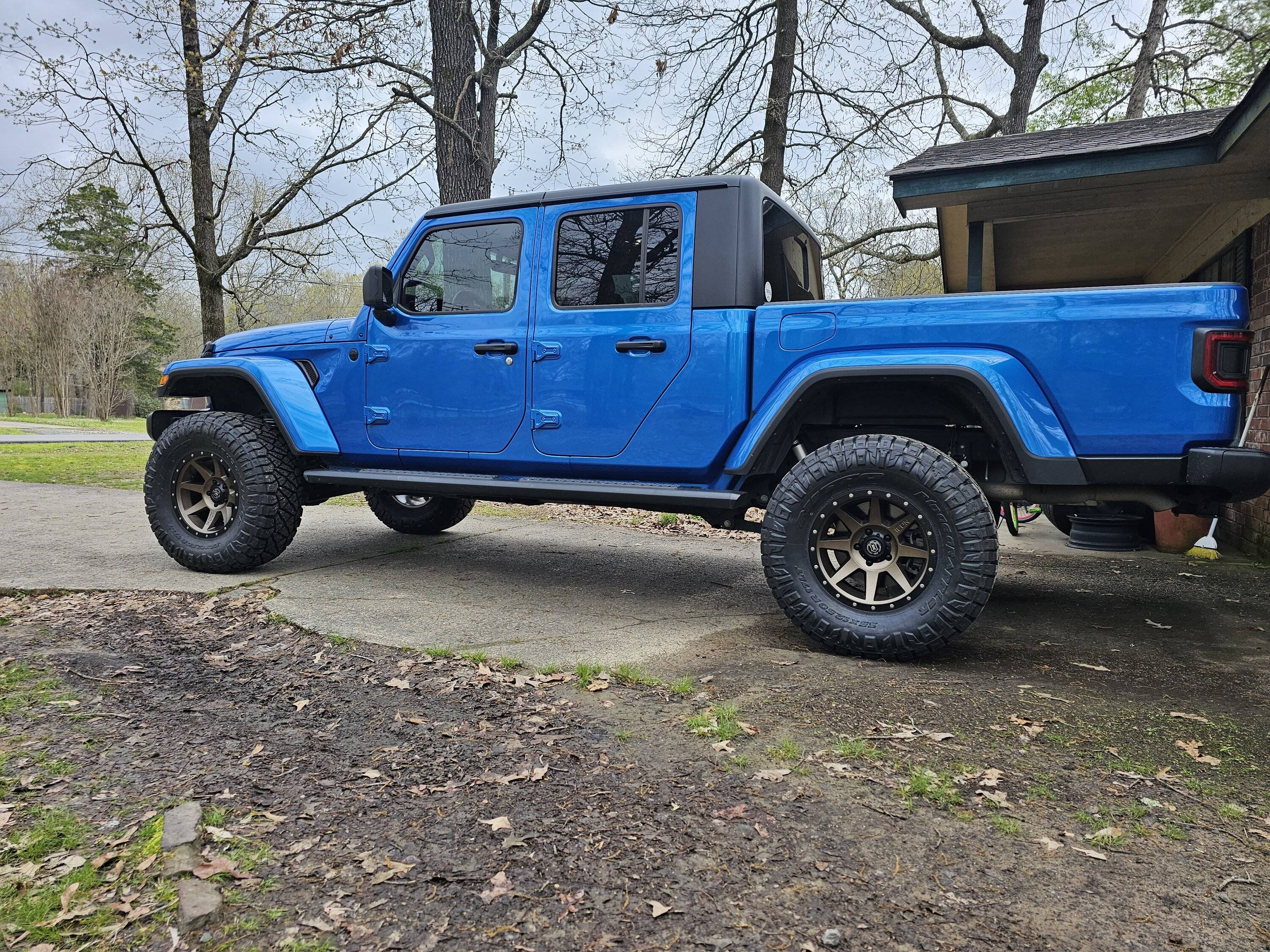

I recently installed my 38x13.50 Patagonia’s on my sport s. 3” lift, no rubbing at all!
Jeep Gladiator 38" tires fit!! 31A5E2DF-EA6D-43E4-B32D-D96888163248

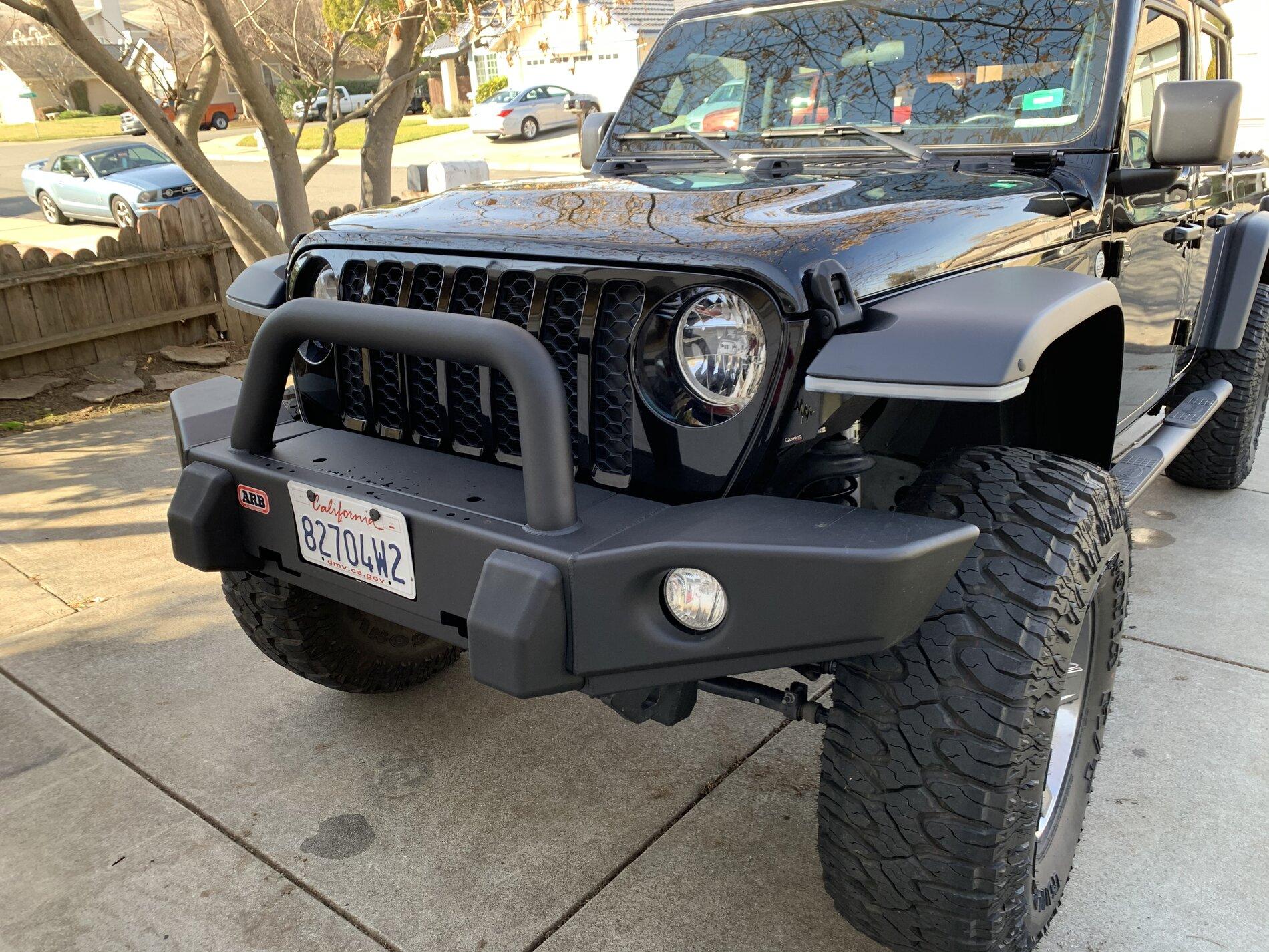

What front bumper is this? Your trucks nice!
GRAN1TE JT
Alex
Mar 1, 2021
123
262
NY
2020 Sport S
Thank you! The bumper is made by Cavfab. I think it’s the vantage series? Very nice and simple bumper, that’s why I wanted it. Definitely recommend it!

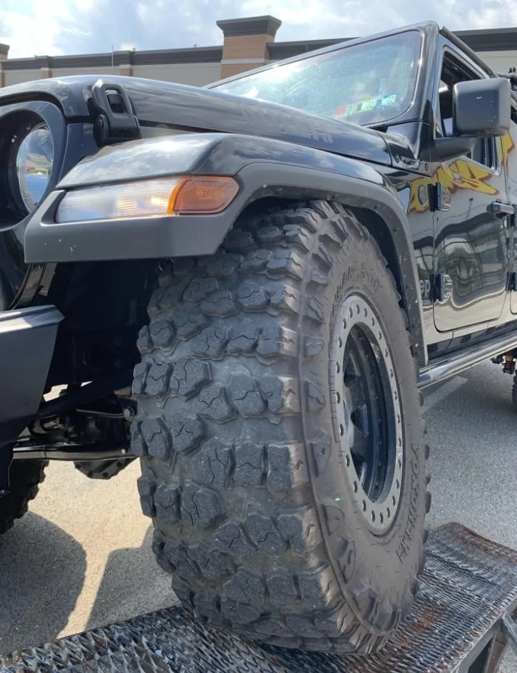

I just can’t see how that’s possible but more power to ya. My 35s rub the sport flares with a 3” lift.
Jeep Gladiator 38" tires fit!! 19E1A09B-CA64-4060-920F-0BAA4B261E1A
6,389
14,569
What tire is that?

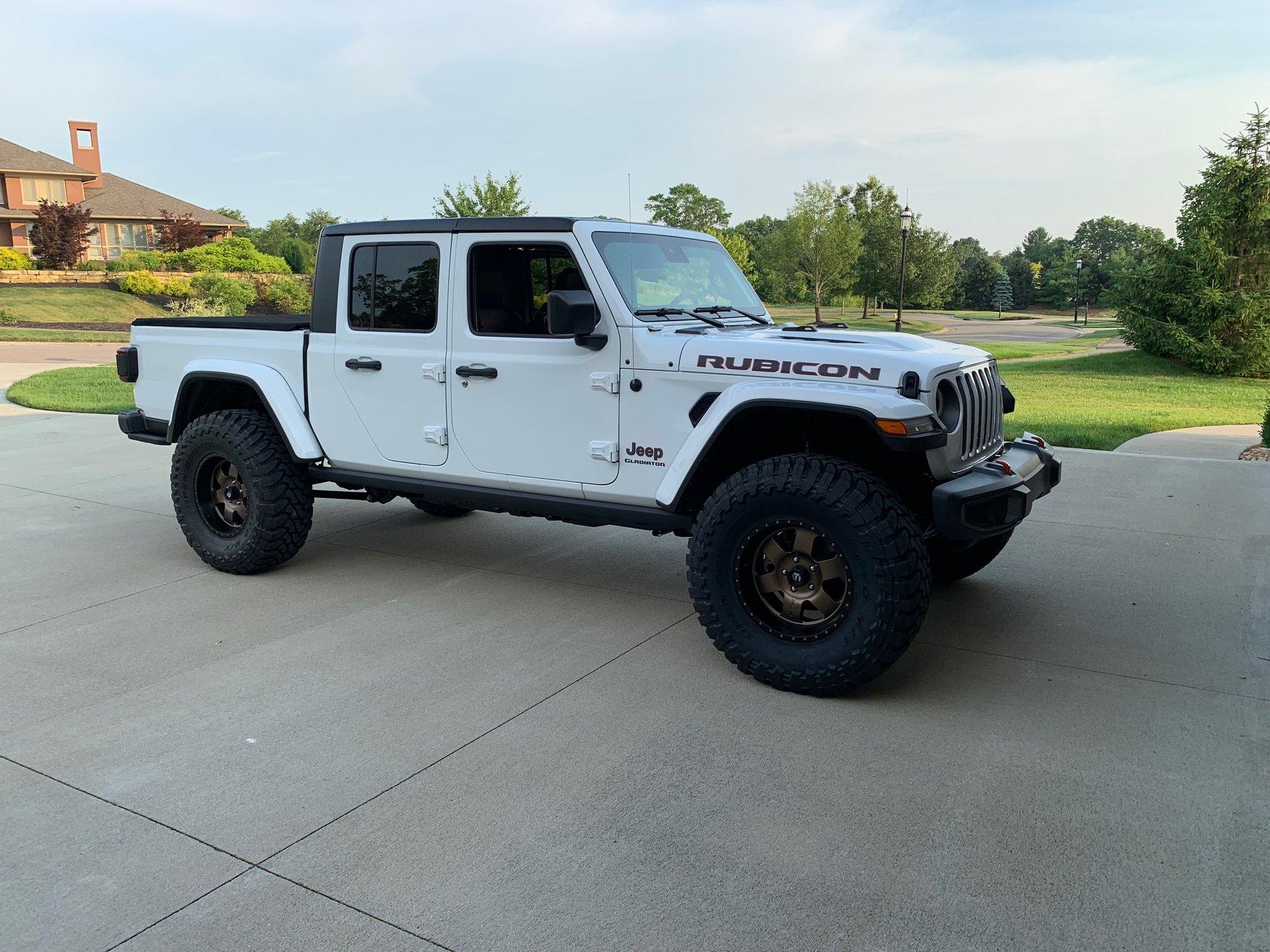

I picked up my truck yesterday and the dealer had already installed the 2" lift earlier that day. Drove strait to the tire shop to swap on what i had ordered a few weeks ago. Toyo MT 38x13.5x18 tires. Wheels are 9" with -12mm offset. Tires fit perfect in my opinion. Working on removing the stock bumper for an ADD RockFighter right now. These trucks ROCK!!!
