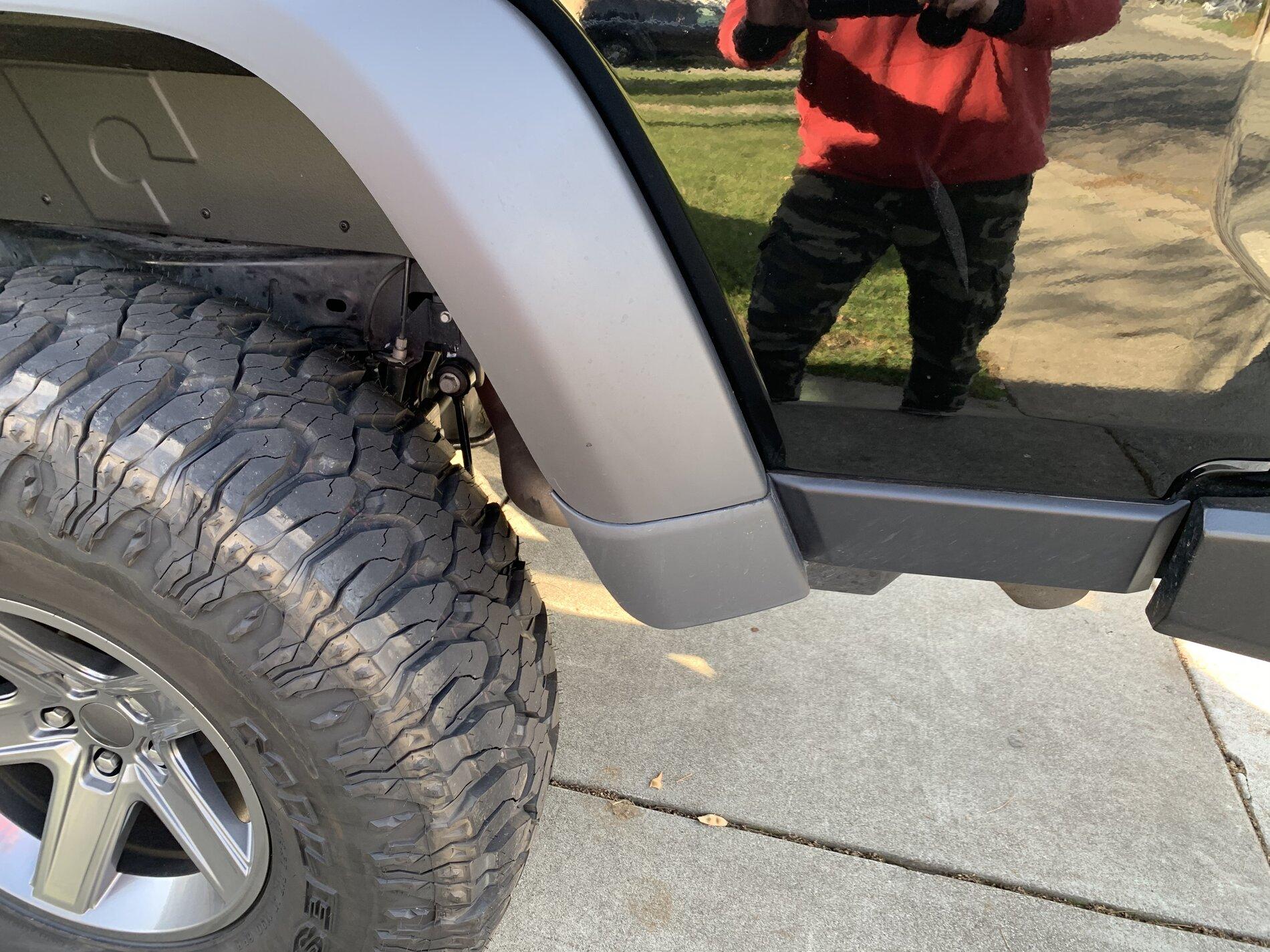

Looks great! Did you inatall the rear high top fenders as well?

I trimmed part of the removed lower rear section of rear flares and reinstalled to cover the gap. Much more finished appearance
Jeep Gladiator 38" tires fit!! 2D2865D3-A06B-48F4-982C-47E5F2DB8B92
That's what was confusing me. That look awesome!! So you removed the bottom part of the fender but were able to reconnect the lower portion? I haven't seen that yet...do you have any pics of the process?

Sorry I don’t. I kept a small piece of the brace that connects the two and used existing connectors, new plastic rivets and some 3M double sided tape to secure parts. Want to avoid trying to fuse them or put a couple screws in. So far they are holding together great.
