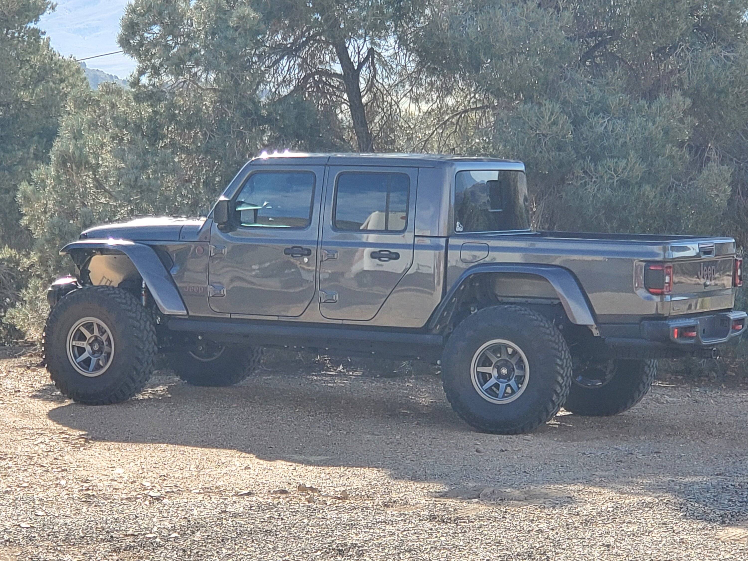

Just some info..3" Clayton front, 3.5" Synergy rears, 38" Trail Grapplers and Icon beadlocks. No rubbing so far and no issue steering...its not ready yet to play in the rocks. Stock 3.73's Diesel Rubicon. "Might" regear a little once I get it finished TBD. I Have RCV's for the front and TBD on the rear. It had 39" KM3's..just crappy tires so sold them.
How did you fit the 38 spare?

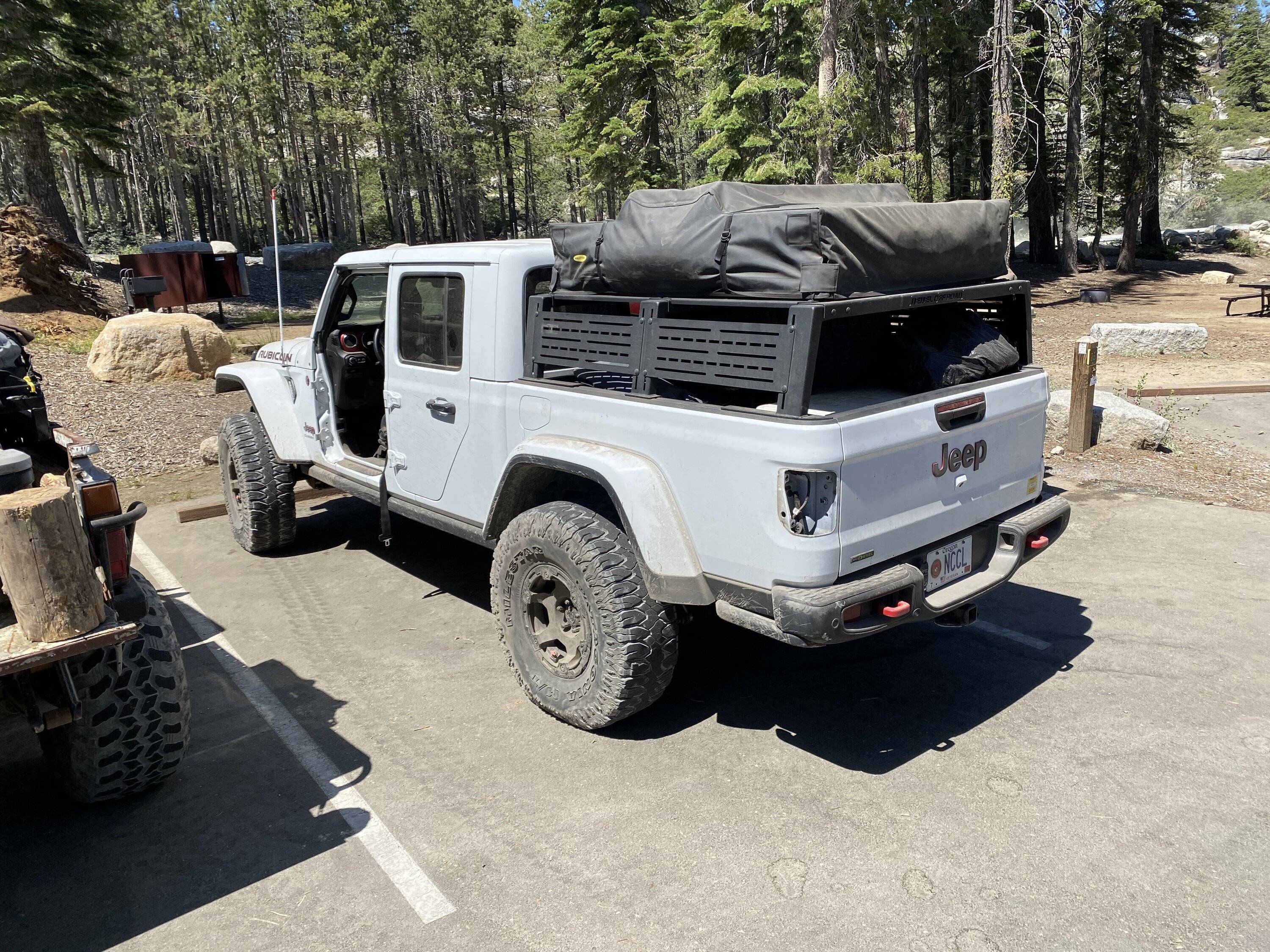

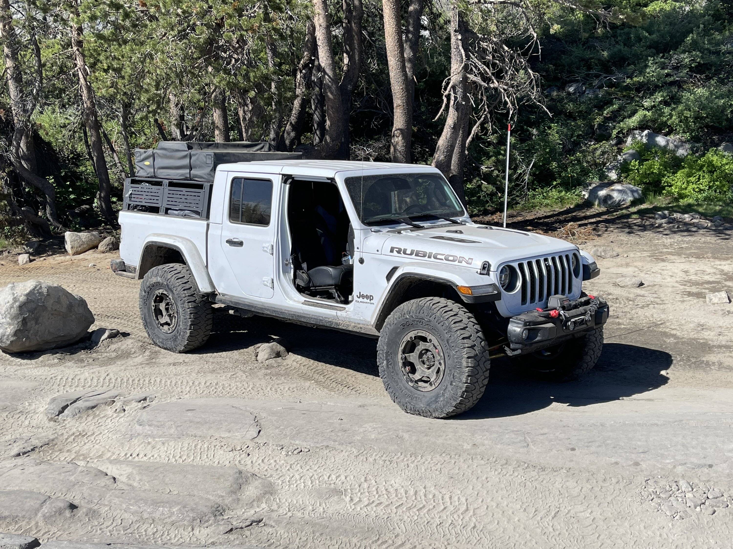

Haven't ran a spare in years..Never had any issues with Trail Grapplers.
I do carry a patch kit and in 50+ years I've never needed it. Was in construction for 30 years on all kinds of job sites and 30 years going off road. Lucky I guess.
I may get a Tire carrier bumper one day.

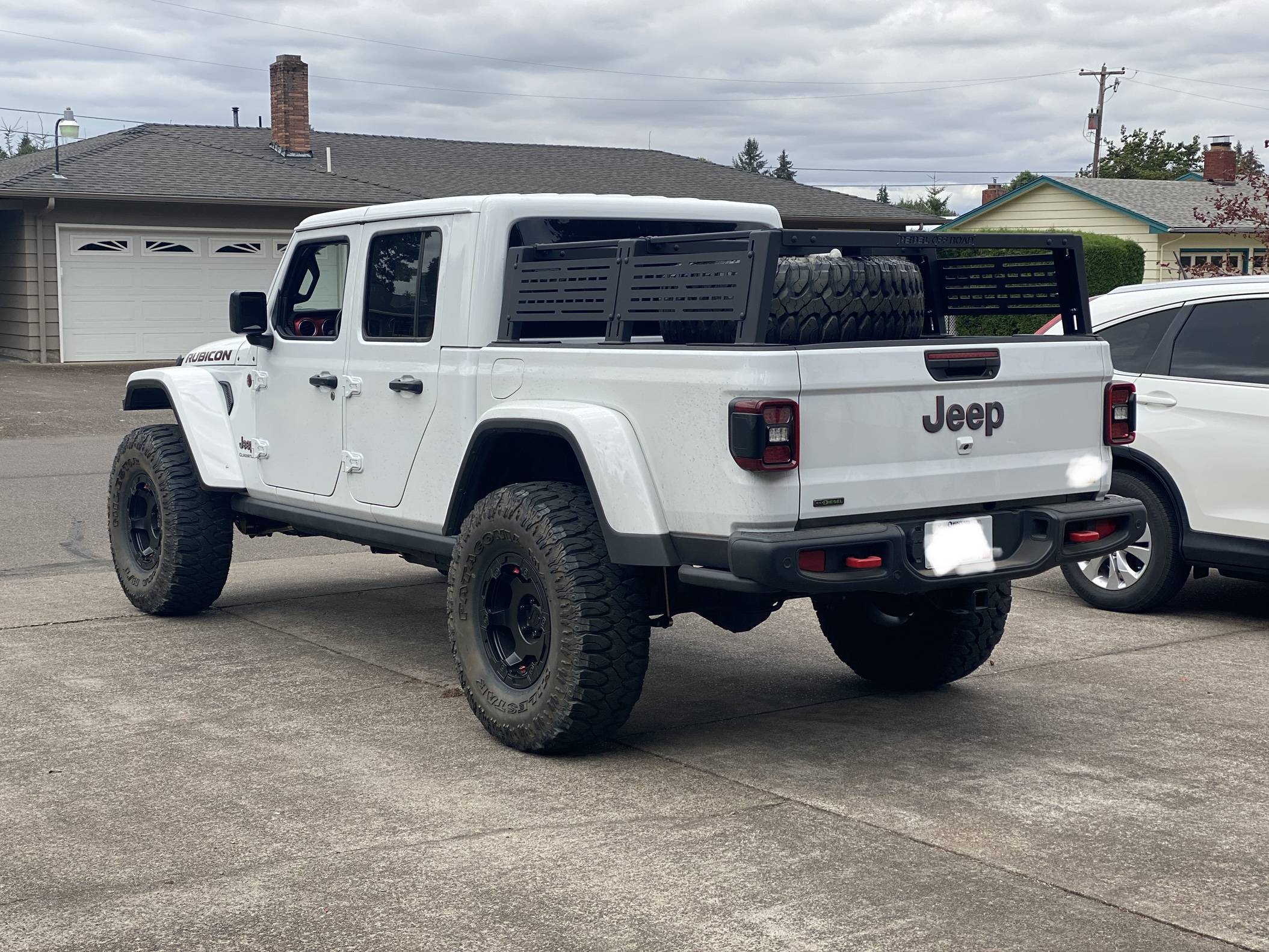

Good to know. I've been impressed with mine so far, $385.00 well spent.

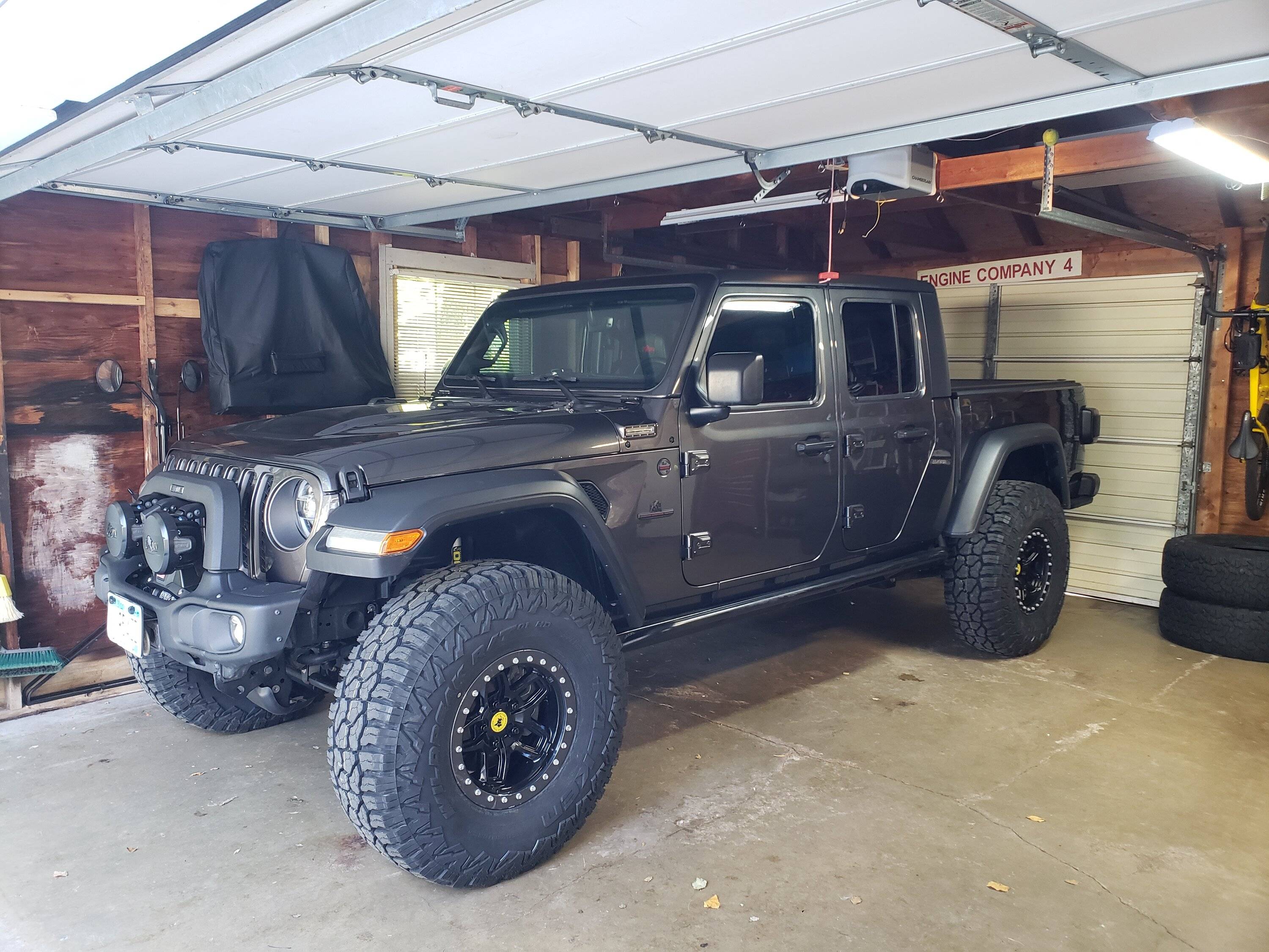

I just mounted up a set of 38/13.5r17 Falken Wildpeak RT01 on my AEV Borah beadlocks and am very happy with the new tires so far. I had a JK on a few different lifts and tires and now two JT's with multiple sets of tires and lift heights. On the JT's I've run 285/75r17 KO2s, 35/11.5r17 Toyo ATIII, 37/12.5r17 KM3s, 37/12.5r17 KO2s, and now the 38" Falken RTs.
The Falken RT mounted on the truck comes in at 37.1 inches. My notoriously small 37 KO2s measured at 35.7 inches. It's a noticeable difference and one I think will make a difference on the trail. Additionally, my perspective on width has changed the more I hit the rocks. At 11.5" wide I was rubbing my wheels on every rock I tried going around. Even a 12.5 mounted on a beadlock would rub the hell out of the ring. The extra width is going to come in handy while crawling over obstacles.
I've always been a fan of AT tires since I spend most of my time on the road, but after a but of research I'm giving these RT's a try. I'll report back after I spend a Minnesota winter on them. So far the road manners are great, slightly louder than the KO2s (which were very quiet).
The other thing I kept hearing when considering jumping to a 38 was to just go 40's. This is a no go for me for a few reasons.
1. I'm already regeared to 4.56 and that will work for 38s but not 40s. If I could do it again I'd choose 4.88 or maybe 5.13 but I can get by at 4.56. I think 40s would force a regear.
2. When I decided on 38s I knew I would want to beef up my brakes (powerstop rotors and pads) and axles shafts (RVC up front, dana chromoly rear). This is a considerable expesne at $3k but I would be looking at 6X the cost for new axles if I went 40s.
3. I'd need a taller lift to fit 40s. At 38" I can keep my current lift (AEV 2.5") and retain a ride I really like. I did gut the fender liners and still need to check clearance at full lock/full stuff but I had quite a bit of room when I was running the 37s with the full fender liner. 40s and a 4.5" lift would mean I would no longer fit in my garage, another demerit.
Overall, it's just my opinion, but 38's are the Goldilocks of tires for these trucks. Not too small, but not too big.
Here are the quick specs on my JT for those curious:
2021 JTR AEV JT370 (4.56 gear package) auto transmission
AEV 2.5 lift
Metalcloak CAs (all 8)
Currylink steering (tie rod/draglink)
Teraflex rear upper control arm extended travel kit
Rancho adj trackbar
38/13.5r17 Falken Wildpeak RT01 on Borah Beadlock wheels (+25mm offset)

That's stunning, I'm new here to the state and the JT arena, I have been a Ram guy for years, until a problematic 2019 told me otherwise. I traded for a 20 Rubi with 37s at a local dealer in the MSP metro area. Love how these look! Where in Minny are ya? I'd enjoy meeting more like minded Jeepers here. I'm also new here from SD. Stunning JT,
Thanks!
RodRecket
RodRecket
Sep 13, 2019
1,151
1,487
Minnesota
2021 AEV JT370
Thanks!
Thanks! I'm in Rochester. There's some great wheeling up in Gilbert and a decent trail in Appleton MN from what I remember. Always up for some wheeling or Jeep nerding/wrenching.
