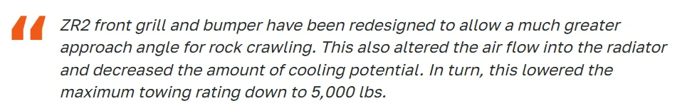

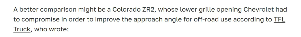

They poo-poo'd bringing cooling air up from the bottom for these because of the desire to maintain approach and departure angles.
So if you don't give a rip about towing and cooling -
all things can be done. Jeep can do it, with the warning about towing capacity going down, and likely even payload going down. If that doesn't matter, you'll see the V8
Does Jeep desire to keep best in class towing and avoid the on-the-edge heating issues, and do customers care about these running too hot, or towing capacity?
If not, Jeep will give you a V8 Gladiator.
If their market research says - there aren't enough buyers and people want cooler running with better towing, then they won't.
Nothing here is going to change that bit.
Can Jeep do it? The answer is yes.

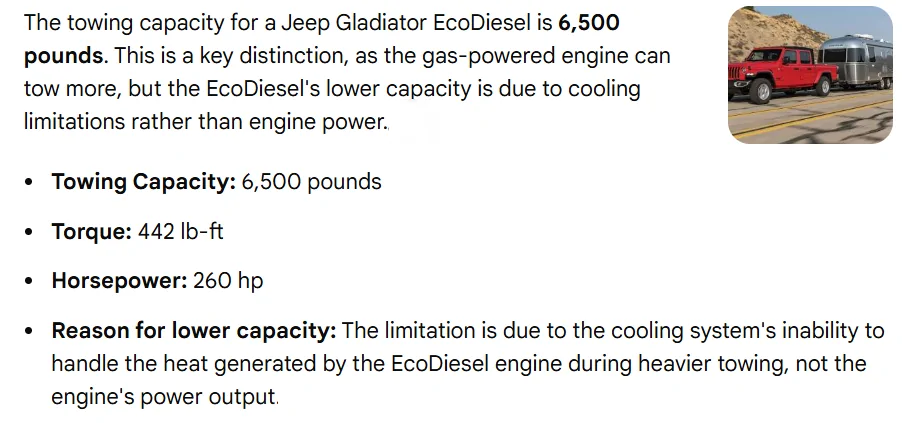

Can they do it and keep the current tow ratings? No. (I forgot - what is the towing number for a JT with diesel????)
So, what's important to Jeep and the majority of their JT buyers.............
Well that's basically what I am getting at. Go up and down and out with the front end and you can have more horsepower......at the sacrifice of the iconic Jeep front end. If you do not care at all about the offroad prowess, or it looking like a typical Jeep, then that's part of the solution.
It's one of the reasons why modern diesel trucks look like 18 wheelers these days. The front ends have to be two stories tall to shove enough cooling stack into them for these high horsepower diesels that everyone needs to pull the 33,000 pounds everyone is towing daily.

My JTRD has a tow rating of 6000 and payload of just shy of 1000 pounds.
I knew I was getting a lower rating than the Max Tow and was fine with it.
My trailer loaded is around 4k or so. I doubt I could load it to 4500 pounds. So, a low tow rating would be fine by me.
Honestly though, I doubt I'd buy a Gladiator with any hemi in it. Why would I when I have my ecodiesel???
