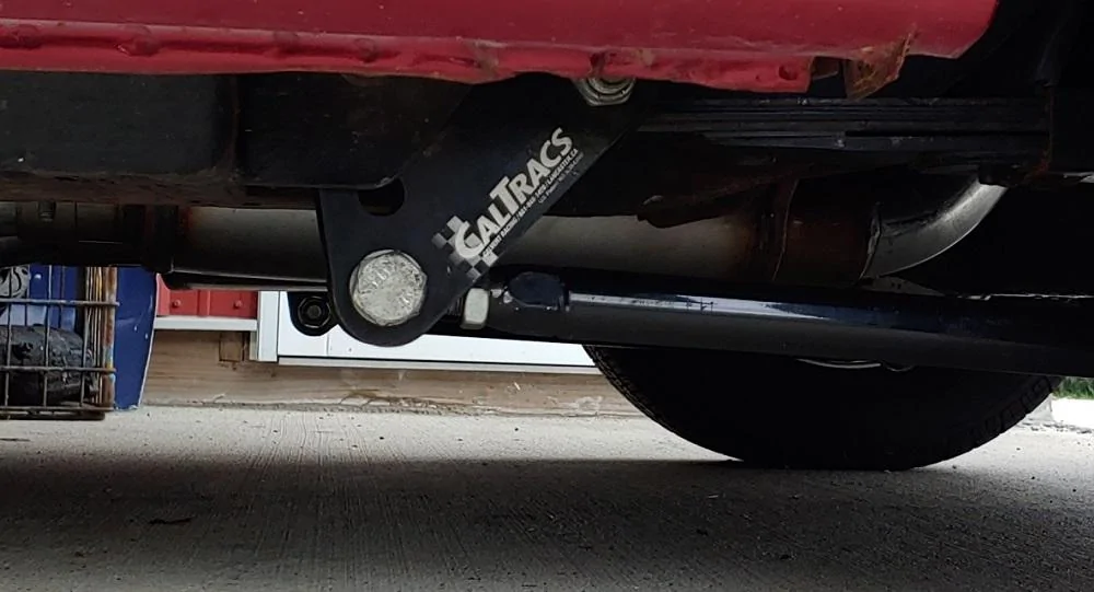

4 link systems won't suffer "axle wrap" like leaf spring systems.
Here's one solution for leaf spring axle wrap ->
