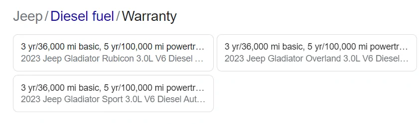

It's absolutely 5 years, 60,000 miles for the powertrain warranty.
The DIESEL is 5/100,000 but not the gas and it's interesting that both are still 5 years, only the mileage is higher in the diesel.

You've not bought or looked into diesel, then - DIESEL only - (below from Google)

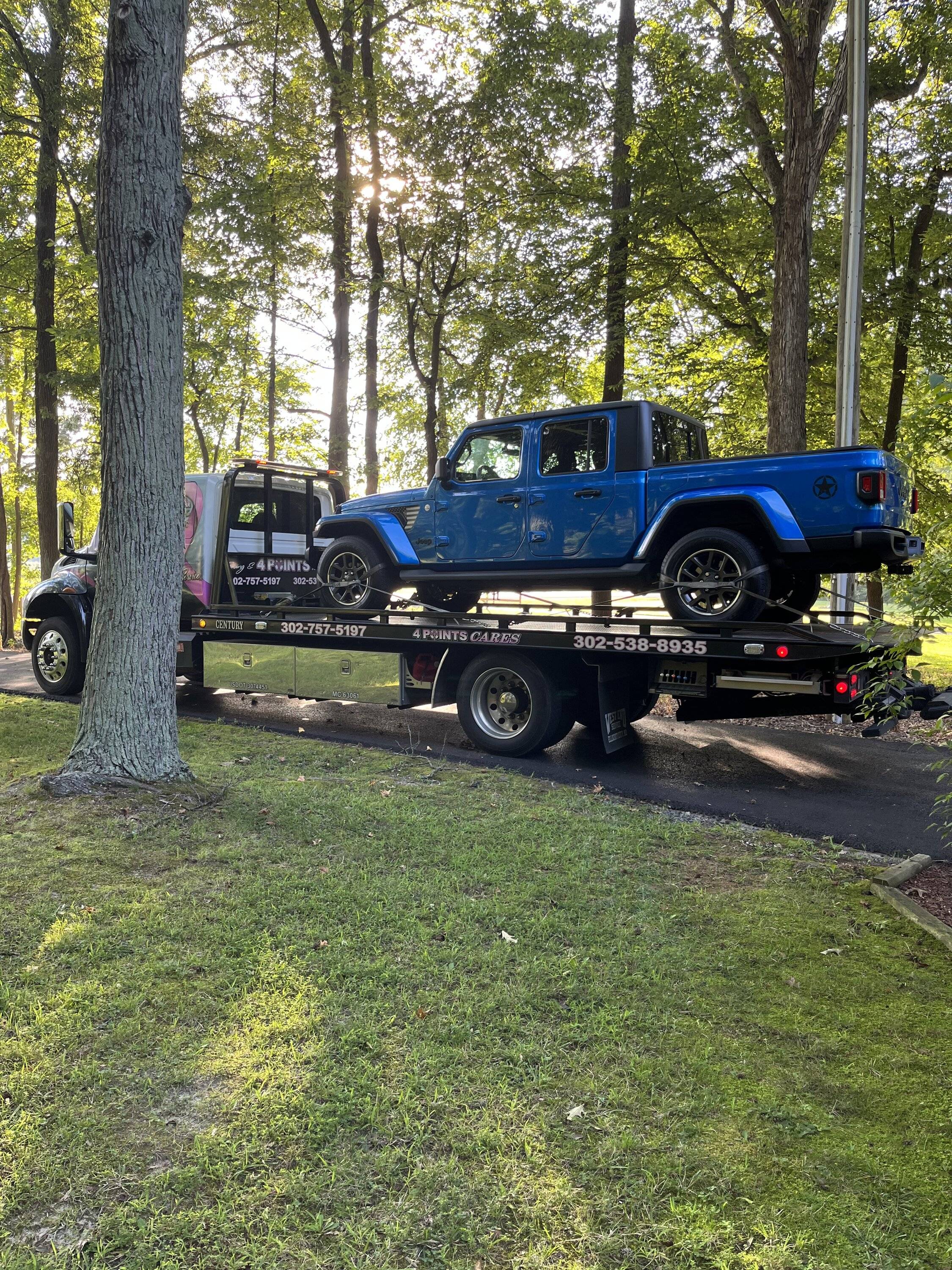

Just sent my Gladiator (18881 miles) to service with misfire cylinder 5. Hope it isn’t too serious, especially given they are two techs short and parts hard to get. Just left here this morning, not something I had expected to see with so few miles

What did you use to read the code to determine cylinder 5?
Wondering as often, with the correct software, you can also determine if it's ignition or otherwise. we had a 2021 with a weird misfire - just one cylinder, and I was fortunate enough to catch it in the act, grab specifics, and a freeze frame. It was an ignition misfire. It was running smooth as silk by the time I got it to the dealership but I had captured enough info they at least had leads and knew it was ignition.
They found a TSB for ignition misfires with the 2021 3.6 - spark plugs.
I believe it started acting up around 800 miles or so if I recall - talk about a low miles thing.

I used an iCar ProOBDII interface module that my son uses on his Jeep as I do not have any modern test equipment in my garage (I have ‘50 Chevy pickup w/283 and 350 powered roadster, they are pretty basic). Not used to this new space shuttle technology they cram under our hoods these days. Have to leave it in the hands of the younger, more tech savvy guys. Fingers crossed that simple, quick fix takes care of it. Ocean City Jeep Week coming up soon, would like to take it
