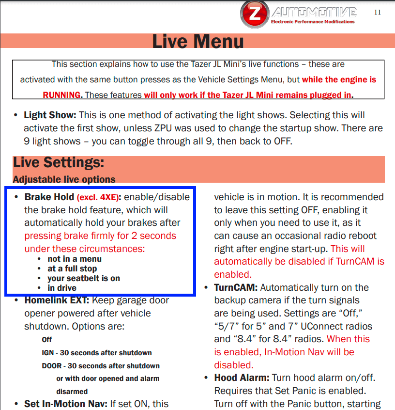

Oh ya. I had a Sport S with the Tazer and no issues. Upgraded to a Rubicon in May and upgraded the Tazer. Ever since I've been getting the abs lights. I thought I did something to the rig when I was in Moab cause it seemed to start more since then. I even had the dealer take a look when I got my oil change and he said he didn't find anything. I actually forgot to take my tazer off when they took a look but he's cool and didn't say anything ha ha. But this answers everything!

Mine acted up after Ouray. Thought I broke something. Was getting pissed. Started mentally thinking through diagnosing it. Was going to remover Tazer first, but Google saved the day.

So, coming home from Ouray I had my brake and ABS light up like Cheech and Chong in a Vw Bus. Only happens when you mash down on the pedal hard at light a stoplight. Did some digging online and found this thread: Flashing ABS Warning
Needless to say...heart attack averted. My ABS does not need service. New Tazer Feature. Could probably be used to scare spouse into thinking money needs to be spent on JT.
If you have a Tazer, you may encounter this. If you knew about it. Sweet. If not, hope I can save you the stress.
WOW, what timing!! I was just going to do a search about this very thing and your thread popped up. Thanks for the great info Mike. I found if I just let off the brake and use the parking brake it goes off also.

Make sure Auto Start Stop is OFF if you activate Brake Hold.

After installing the Tazer I had this several times. It scared the s...t out of me. I removed the Tazer and everything was OK.
Now I have to check my trash can to recover the Tazer.:angel:
Can this feature be switched off?
