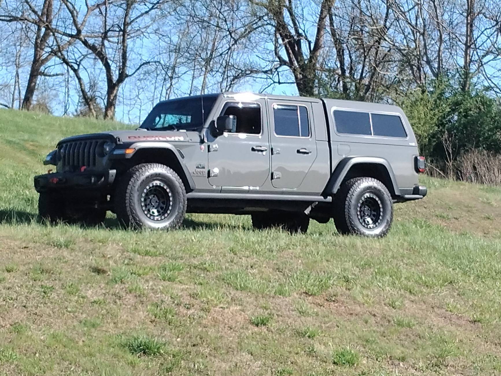

I had the AEV 2" kit on this 2021 Rubicon that had 37's on it. I also had the Rubicon Fox shocks. The ride was excellent. It rode better than my 2023 Sport S with Max Tow. My only complaint was the side to side rocking motion noticed most of road. On the 2023 I only have 315's so I am going with 1.5 spacers on front and .75 in rear. I like the handling of my current suspension and no side motion which I am sure was the Rubicon shocks.
I love that look..... what topper is that and did it cause a noticeable drop in the rear-end?
