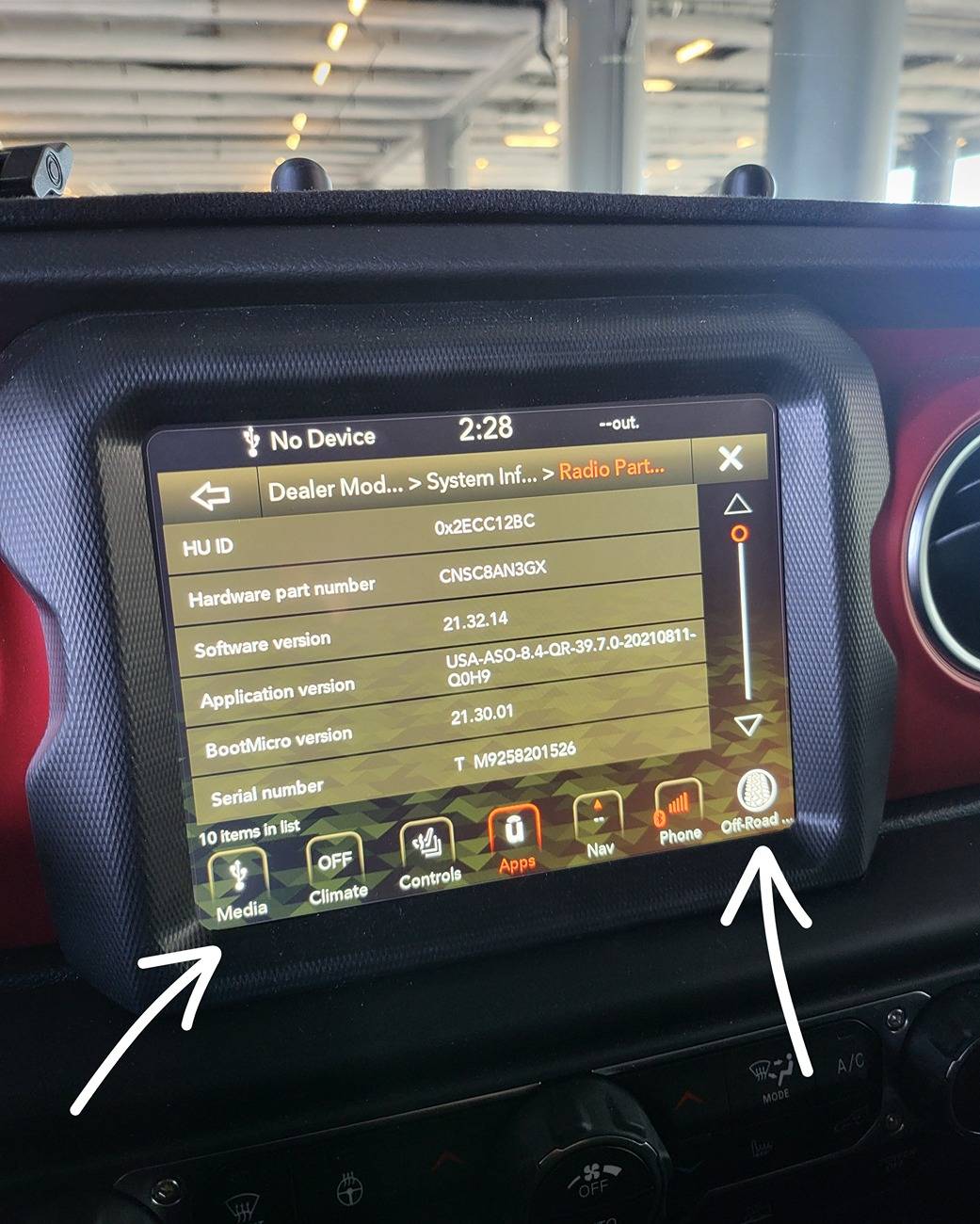

Hold the short cuts on the bottom left and right. As seen below until screen changes and you will get into "Dealer Mode".
In this mode, you want to get into the Radio Information.
You will see a very similar screen below.
In the "Application Version", you see USA-.......39.7.0-......
That "39.7" is the Application version.
Mine is relatively new, but not the latest.

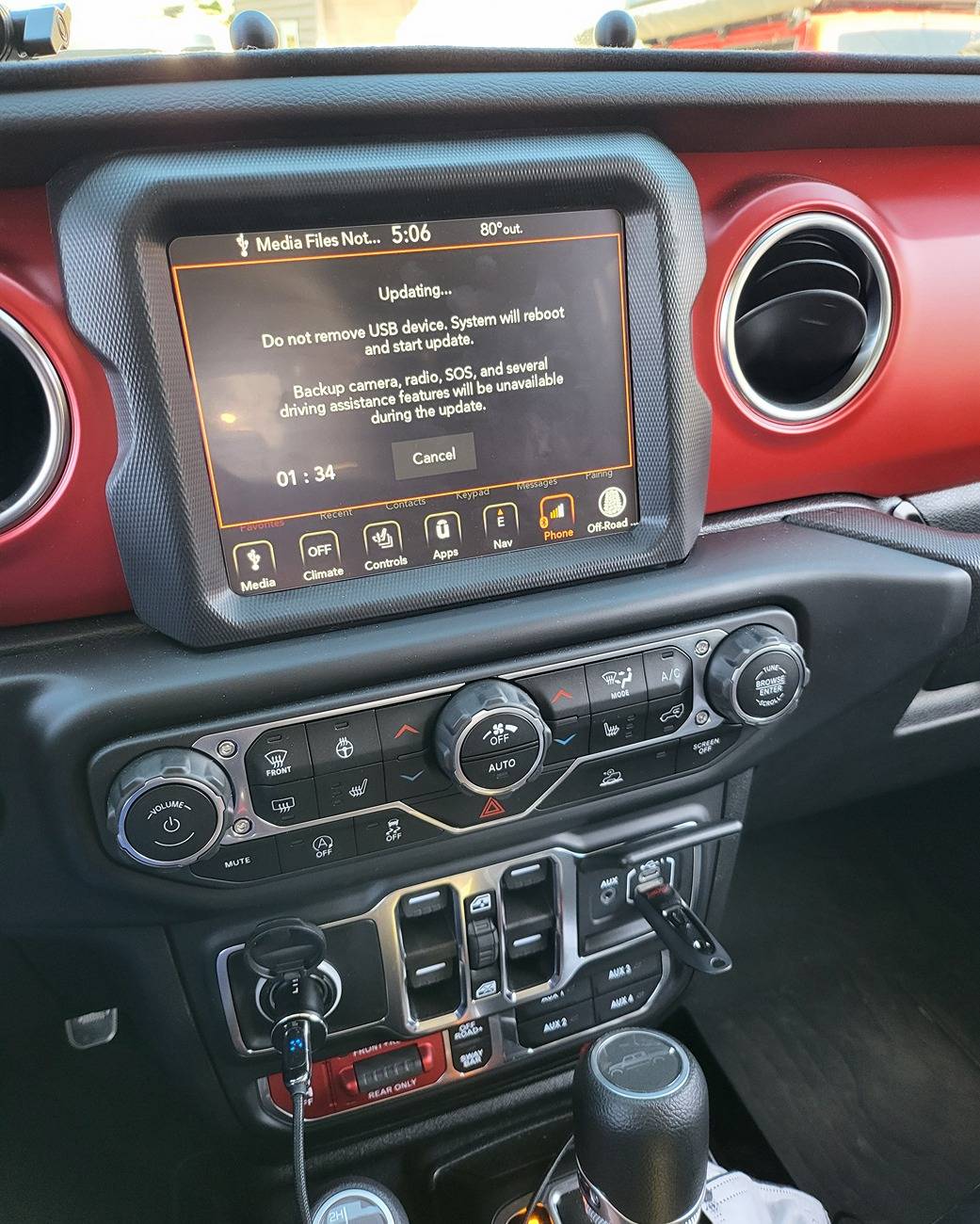

Move "\VP4R_Update\" and all of its contents into root of the USB drive.
Plug the USB drive into the dash USB A port.
I started my vehicle and kept it running as I wanted to have stable battery voltage during the entire update process.
And you will get a prompt asking if you want to upgrade. Proceed through that prompt and you will get the following timer. Let the timer expire. You can see where I plugged in the USB drive.
Jeep Gladiator How to: Update UConnect 8.4" via USB drive. 1000011421

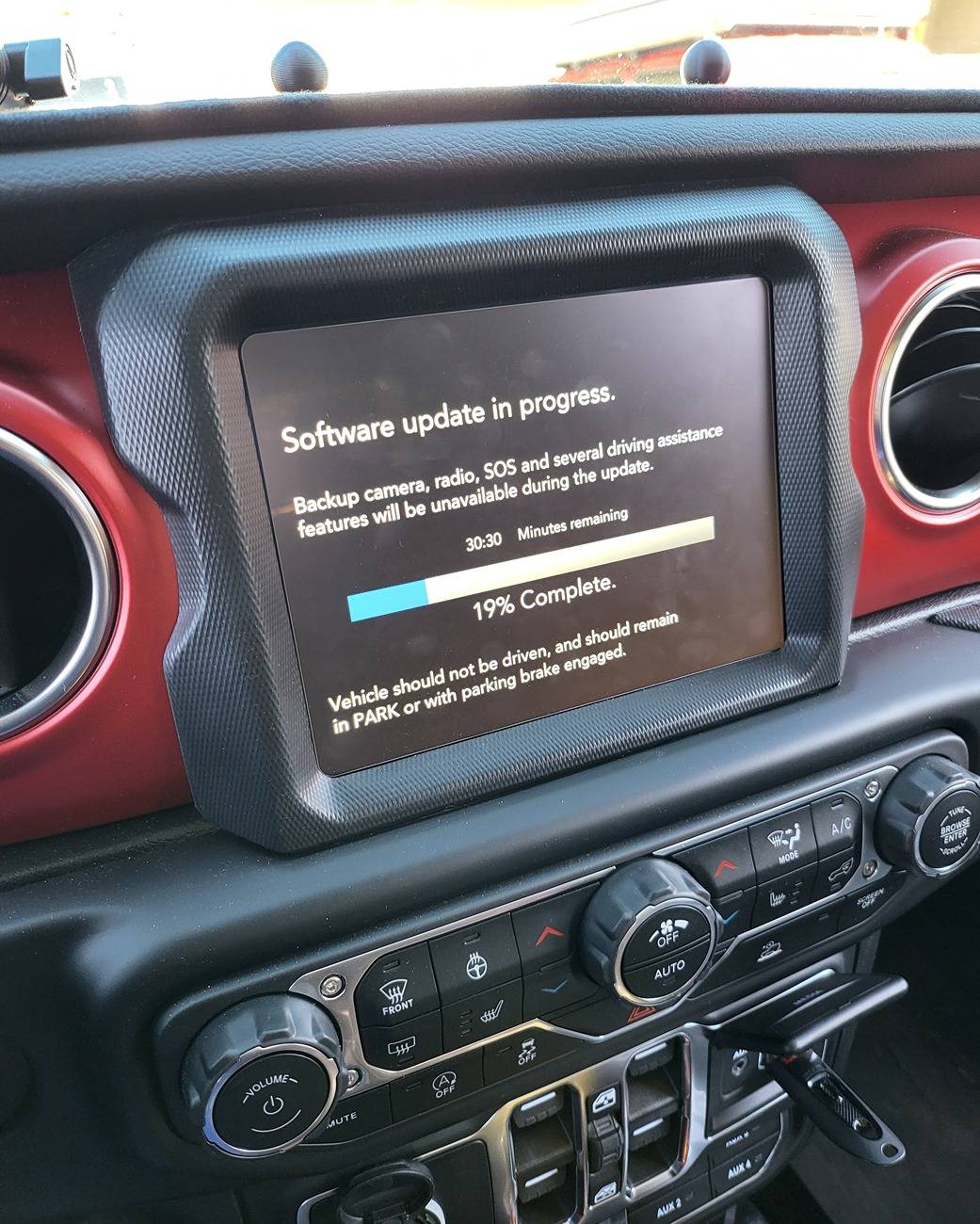

Once timer runs out, you will get the following screen.
Jeep Gladiator How to: Update UConnect 8.4" via USB drive. 1000011430
While the count down stated 30 plus minutes, mine took about 25min.

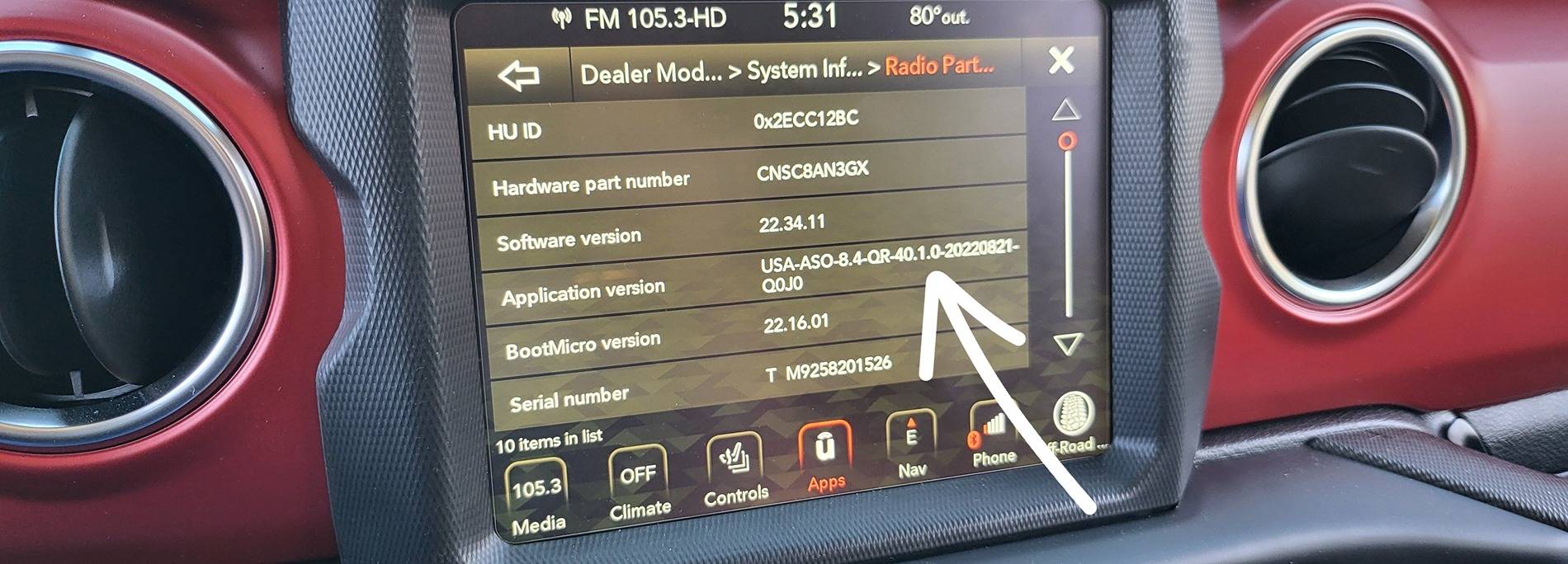

You can reaccess the dealer mode and check "Radio" information and you shall see the following screen. You can see the Application Version is now 40.1.
*IT IS POSSIBLE THAT YOU MAY NOT SEE ALL YOUR APPS RIGHT WAY. I READ PEOPLE REPORTING THEIR APPS BACK ALMOST 24 HOURS LATER and also having to reset all their settings again. Having said that, all the apps were present immediately for me.
Jeep Gladiator How to: Update UConnect 8.4" via USB drive. 1000011481
