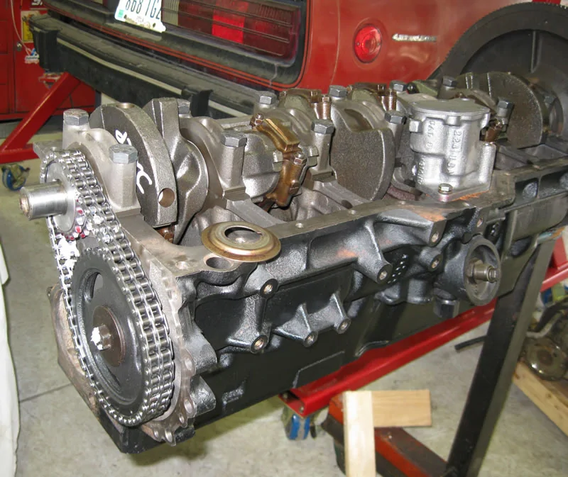

Here is an example from my shop of a V8 crankshaft with the "slinger" for the rear main made as part of the crankshaft. Also note the machine marks - designed to "auger" oil back into the engine as the crankshaft spins. The pressure from the mains never gets close to the seal, no oil is "shot at it", it is slung away after leaving the main bearing area.

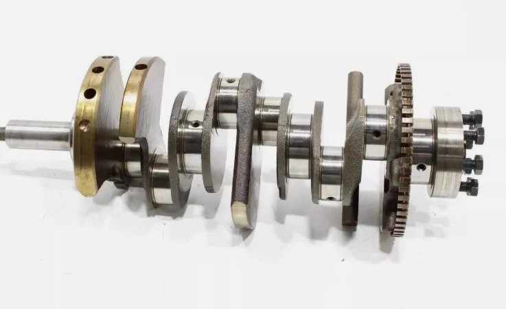

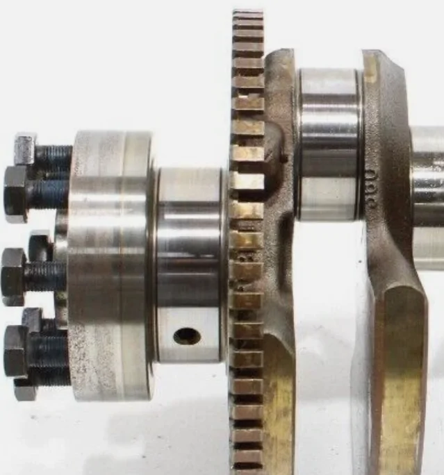

Below is a 3.6 crankshaft. Note the large step between the rear main (where the hole is) and the seal surface. That flat face acts as a slinger. The oil exiting the rear main is "slung away" by crankshaft rotation.
The rear main seal rides on the larger machined surface on the far left.
The seal is not exposed to oil pressure from the pressurized oiling system, and, oil is slung away from the seal as it leaves the rear main bearing area.

Here I show how the oil seal is never under oil, never submerged.

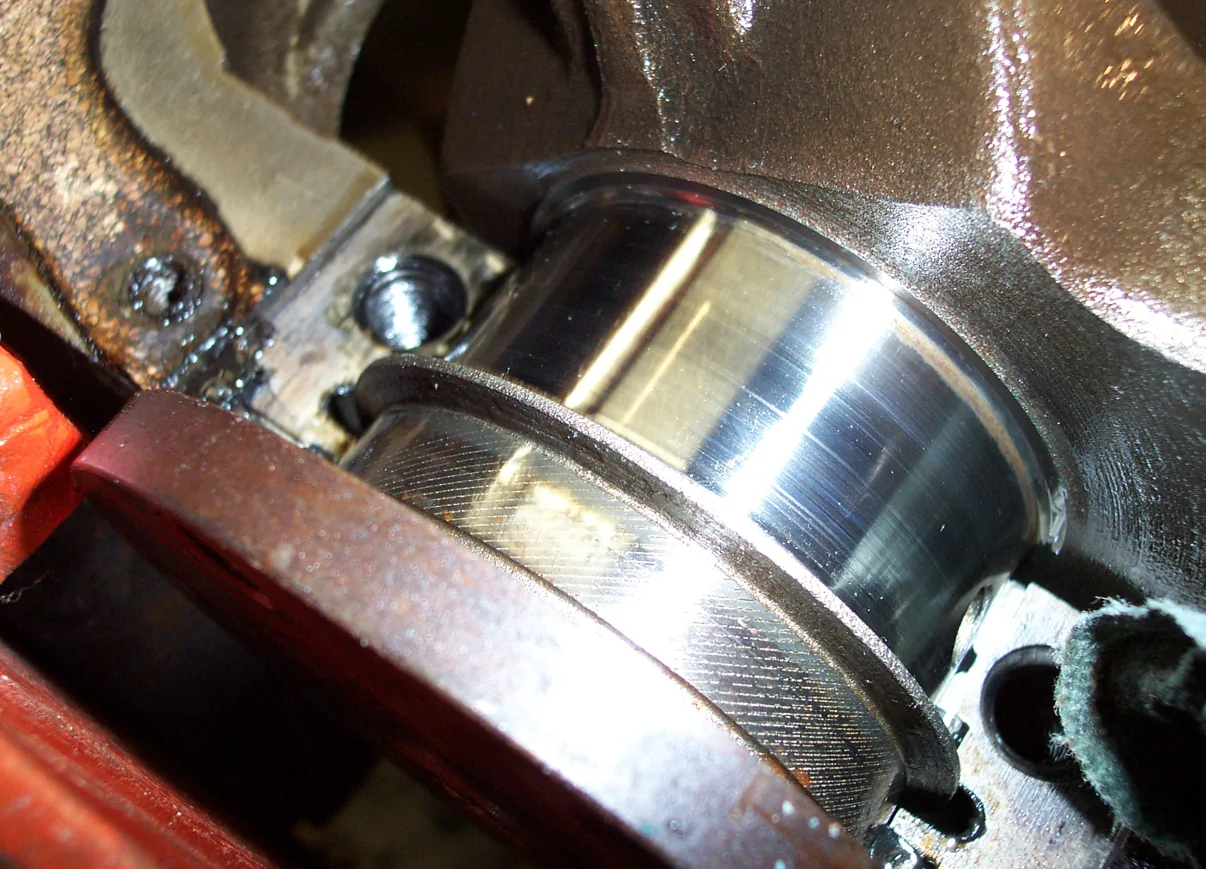

The image below is a 3.6 crankshaft.
Note the machined seal surface (where the bolts are on the right). That is where the seal "rides",
Jeep Gladiator Can an extra oil quart cause a seal leak? Here's some facts - Screenshot 2025-08-06 130534
If you filled the crankcase to the point that the seal was operating in the oil instead of above it, look at what else would be in the oil.

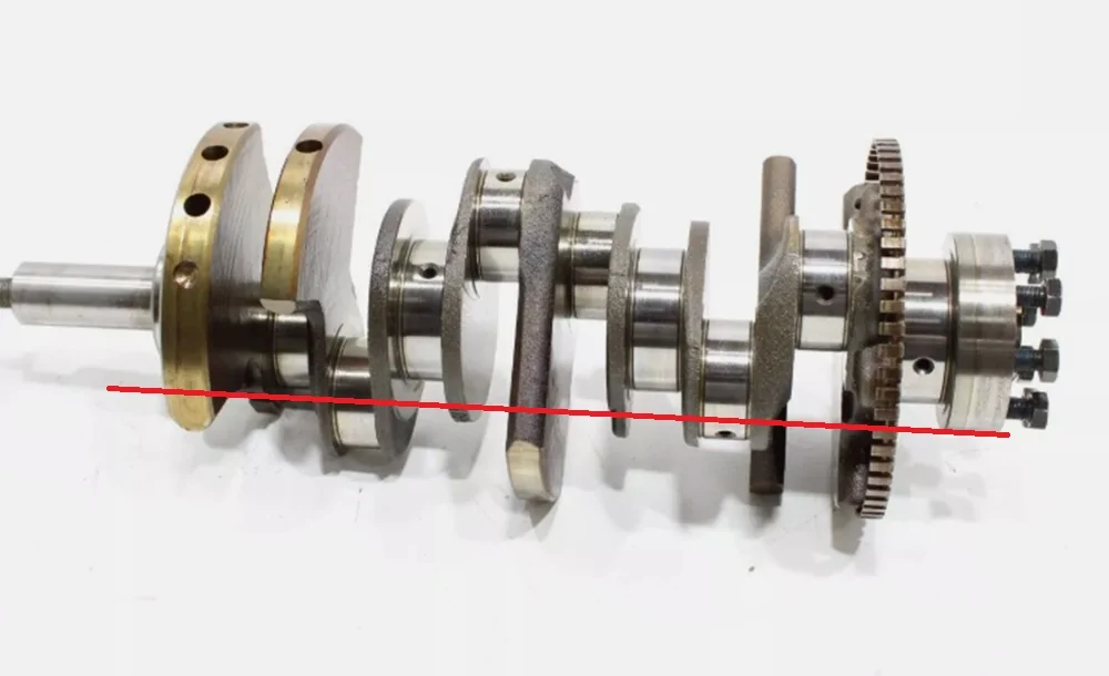

Jeep Gladiator Can an extra oil quart cause a seal leak? Here's some facts - crankshaft 2025-08-06
Picture below -
The 3.6 has aluminum windage tray at the bottom to prevent the oil from being whipped into a frenzy by the spinning crankshaft throws and connecting rod ends dipping down and up like the wind on the ocean whips it in to a foam. Wind from the spinning parts can cause the surface of the oil to be 'foamed', aerated. Thus the windage tray.
(There are actually multiple purposed for the windage tray. It also reduces drag on the crankshaft as it spins, lowering "internal friction" or drag on the crankshaft. It increases the chances of oil releasing trapped air before being pulled back into the pump. )
If you added so much oil as to get above this tray, you are running the crankshaft in oil, foaming it up, losing oil pressure and losing protection of the engine parts. The drag on the crankshaft smacking the surface of the oil would be intense. You would reach destructive levels before the seal would be operating in oil.

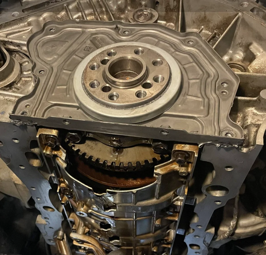

This picture also shows an area that's a common problem area when people replace the rear main, and do certain other maintenance - the intersection of sealing surfaces.
I don't know what MOPAR recommends for sealer here - but no way I'd use RTV off the shelf, the generic stuff, and the amount 'gooping' out in this picture really concerns me........... I don't know who's engine I grabbed a picture of, but I'm glad it isn't mine they are working on.

Below is a 3.6 crankshaft. Note the large step between the rear main (where that hole is) and the seal surface. That flat face acts as a slinger. The oil exiting the rear main is "slung away" by crankshaft rotation.
The seal is not exposed to oil pressure, oil is slung away from the seal.
If you filled the crankcase to the point that the seal was operating in the oil instead of above it, look at what else would be in the oil. That would be a huge drag on the engine, and would whip the oil into a froth. It would aerate the oil so bad, you'd lose oil pressure, the engine would be more noisy. The rods and crankshaft throws, counterbalances, would be operating like a giant bakery mixer in the oil.
And it would take a lot more than 1 extra quart to get that far. The sump "size" increases as you move up. A quart of oil at the bottom will raise it x amount. Because the "diameter" of the sump increases moving upward, a quart of oil at the top will only raise it a small part of x.
Picture below -
The 3.6 has aluminum windage tray at the bottom to prevent the oil from being whipped into a frenzy by the spinning crankshaft throws and connecting rod ends dipping down and up like the wind on the ocean whips it in to a foam. Wind from the spinning parts can cause the surface of the oil to be foamed. Thus the windage tray.
I don't know what MOPAR recommends for sealer here - but no way I'd use RTV off the shelf, the generic stuff, and the amount gooping out in this picture really concerns me........... I don't know who's engine I grabbed a picture of, but glad it isn't mine they are working on.

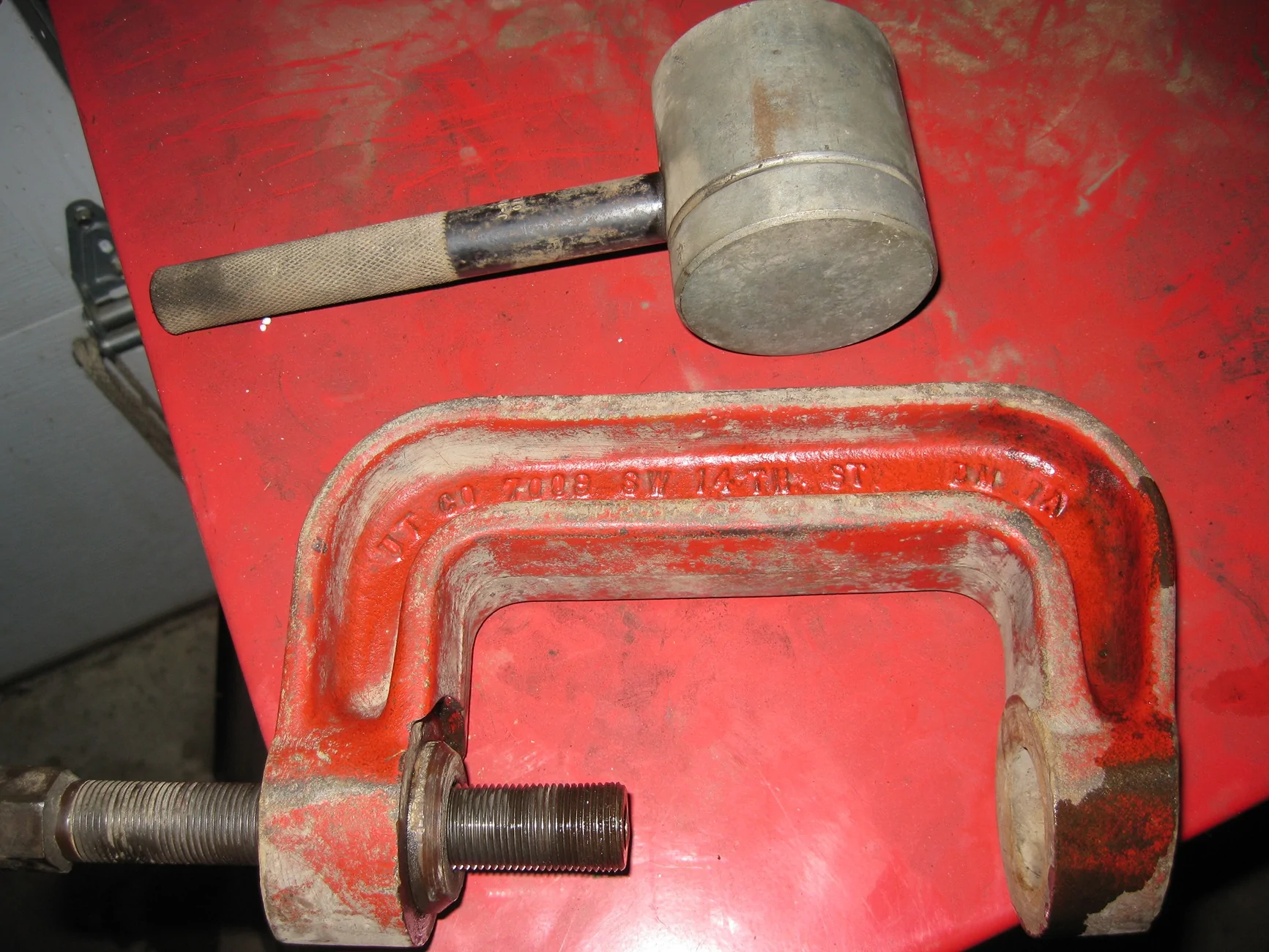

I have the tools for the rope seals.
The tool in the top of this picture is one used to shape the rope seal in a late 50s/early 60s AMC I6. It's roughly the size of the crankshaft seal surface.
I also have the Chinese finger puzzle type of devices used to pull seals through the seal channel when doing it with engine in the car. And the tools to rotate the upper bearing halves out of the place and the new ones in place when doing a bearing change - engine in car.

Nice write up on sealing. The cast aluminum windage tray in the 3.6 also serves as a block stiffener, for the same reasons that the old 4.0 liter had the stamped stiffener on the main caps.
I remember road draft tubes. Probably the best that could be hoped for is to prevent pressure build up in the crankcase. This required that the crankcase breather allow air into the crankcase. The engine crankcase is not pressurized unless there is a problem with ring sealing or a major overfilling of oil (enough to cause the crank throws to whip up the oil.
As for sealer on the Pentastar, I always use Mopar Threebond RTV. That looks like a mess on the one in the picture, but after the bolts are torqued on the seal plate, the excess should be cut off with a razor blade. If the Threebond is used as instructed, it will seal for the life of the engine.
40,504
54,030
My fear is more "what's inside, under the plate" to break off and get into the engine. Even years ago you needed to seal around the rear main cap and so on, and trimmed excesses, but I've seen it to the point where the RTV squeezed out away from the sealing surfaces and literally broke off - into the engine.
For me - a thin layer that can't ooze out, and enough at the intersection you can razor blade a nice flat seal area.
For me - a thin layer that can't ooze out, and enough at the intersection you can razor blade a nice flat seal.
Exactly. Back when RTV first showed up around here, it wasn't uncommon to pull an oil pan and find the oil strainer full of what we called "blue goo". I pulled intake manifold off off big block Chryslers that the shade tree mechanic had "sealed" the gasket on by coating it with RTV, resulting in a sticky mess. At least with Threebond RTV, I have never seen it break loose and get into the strainer, but it is much stronger than parts store RTV. Incidentally, the RTV in the picture of the rear seal above is not Threebond, which is a light gray when set up. It appears to be Mopar Engine Sealer RTV, which appears dark gray to almost black when set up, but this is based on the colors I'm seeing.
