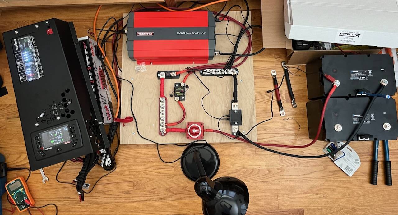

Validation that wiring works so far:
Jeep Gladiator A new hope ... (build journal and component reviews) IMG_5583
Bummer that the Redarc Inverter does not show any power or voltage information throught the display, but at least I can easily turn it on and off. Nice also to be able to program the outputs so that when I double click on the power button on the display, everything turns off except the fridge. Same as we had in our trailer.
So far, so good. Getting closer to installing this. Have charged one battery so far, right now charging the other one. I'll likely skip a full power test until I have it installed in the truck, since I want to cut the thick cables only one time to the correct length and with the current cabling I can't pull enough power for cooking.

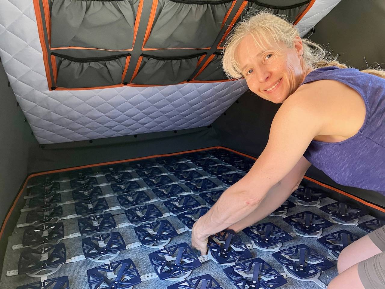

Froli Bed System install:
Jeep Gladiator A new hope ... (build journal and component reviews) IMG_5640
Will test in the driveway for the next night or two.
This is the Froli Travel system, so the low provile one, which should allow us to leave most of the bedding on top. A kit for "Double" works out near perfect when installed with appropriate spacing (the spacing is also used to make sections softer or firmer, we made the foot and head area slightly firmer, the shoulders, which already have softer springs in the kit, a bit softer and created a slightly firmer "ridge" between the two of us, we have not used the additional parts to make sections even firmer).
So far so good. Testing TBD.

Yeah, I wasn't sure which one to actually go with, but opted for the low profile one. Reason being is that it might allow us to close the roof with at least some of the bedding. It's a bit tight in our Land Cruiser rig where we also have the Travel version, but seems to be fine in the ACCC.
It's still not super great in the shoulder area, but there is no mattress or other system that could provide that for me in the given space. So, I'll have to be content for the time being and as long as I can still camp this way. And my take is that the mattress will also get a little softer over time, so it should be fine.

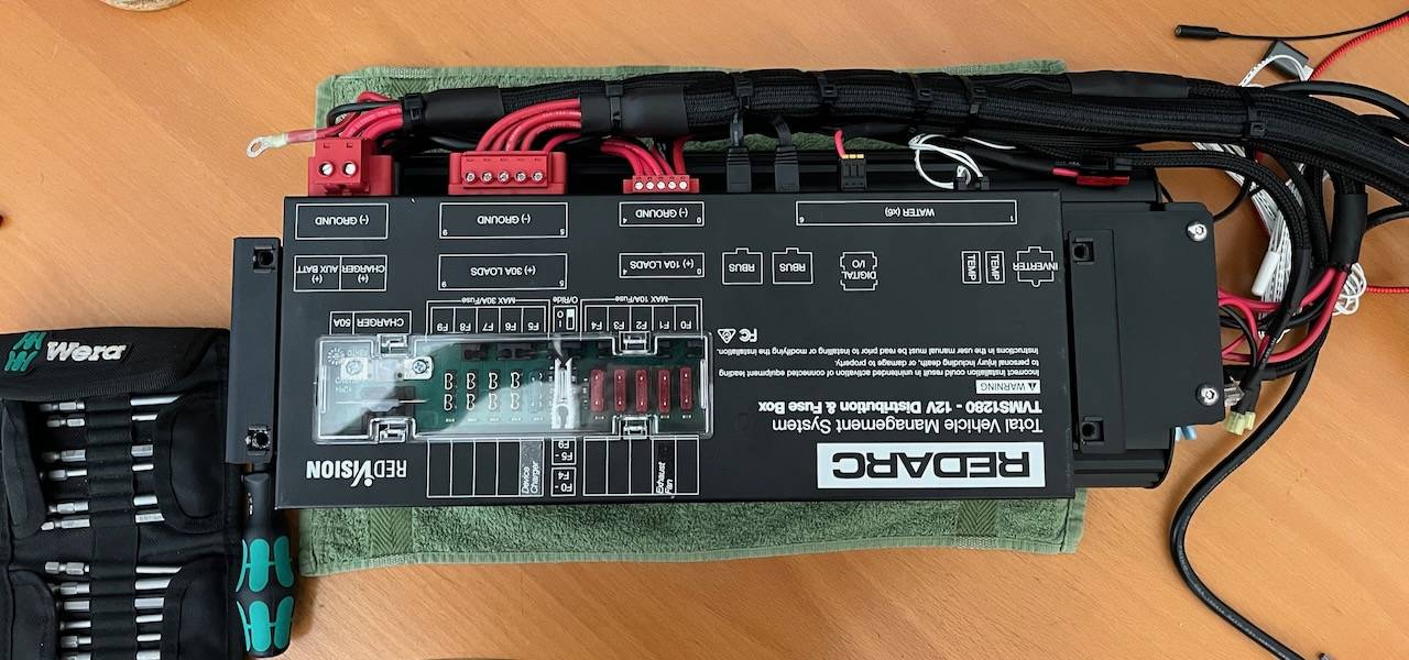

And a picture how the unit is wired:
Jeep Gladiator A new hope ... (build journal and component reviews) IMG_5592
It's very clean and nicely done, a few cables have just a bit too much tension for my taste, so I'll see whether I can use my own zipties to rectify this. If it goes tight into the wiring protector, I'm not going to touch it for now.

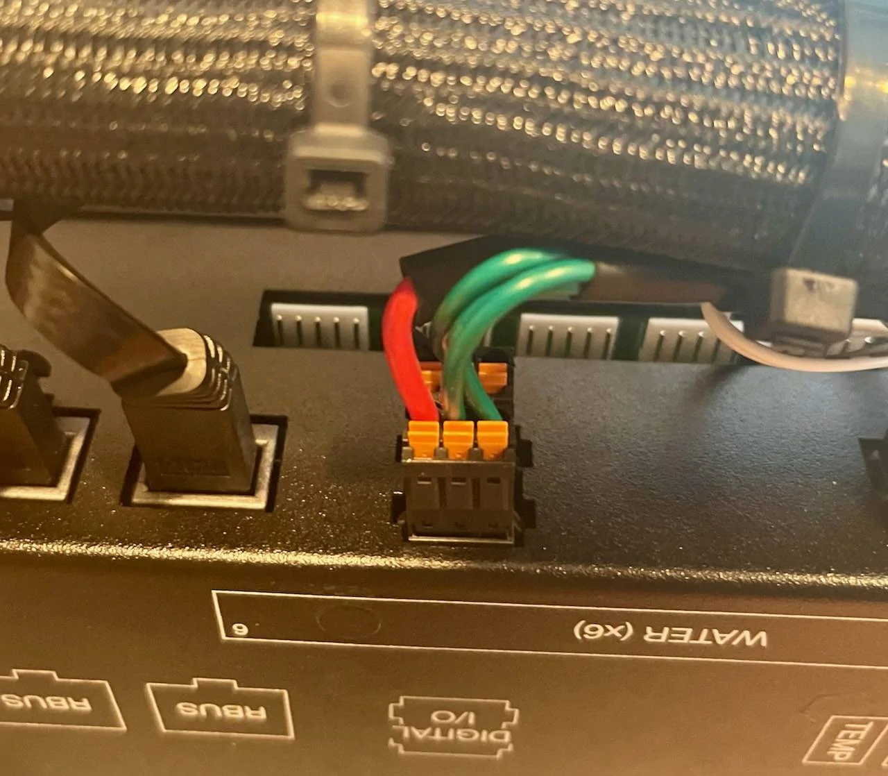

While in there, I also added three trigger wires (the green wires in the photo below) so I can trigger the digital input as a condition for other things to happen (e.g. turning off all lights and the water system when the truck is started or lights coming on when a door is opened, or turning on additional lights when the truck reverse lights comes on).
Jeep Gladiator A new hope ... (build journal and component reviews) IMG_5597
What I'm planning with these is mainly to use the same ignition trigger I will use for running the DC to DC charging as a trigger to turn of lights and water system if it isn't turned off already.
This came out of a thought "if I have these features, might as well use them for something that at least sounds cool if it ever makes it to a Youtube video".

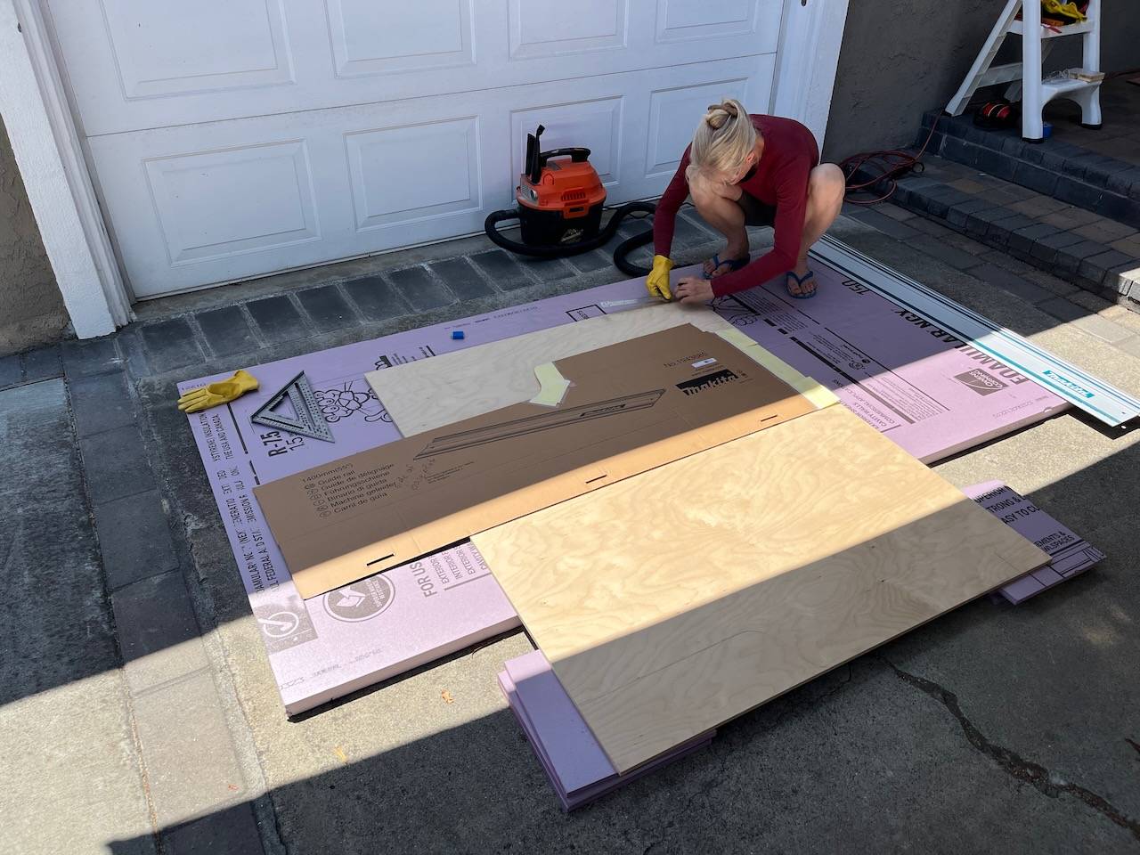

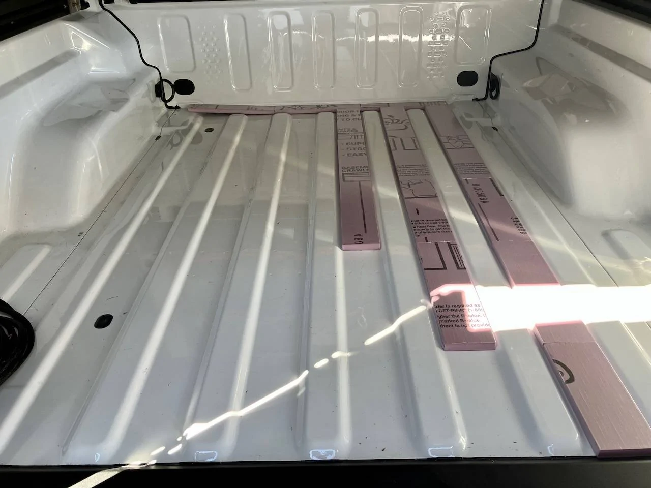

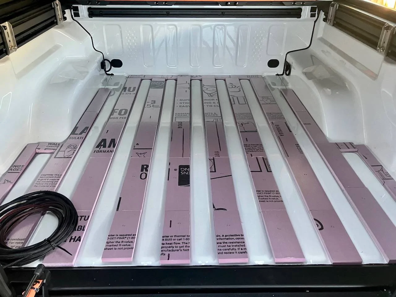

And while I was playing with the electrical system, my wife was playing XPS foam tetris because for some reason, the only available size for 1/2" foamular is 12" x 12". Must be all these van conversions using the 1/2" material. Whatever, she made it fit:
Jeep Gladiator A new hope ... (build journal and component reviews) IMG_5595
Jeep Gladiator A new hope ... (build journal and component reviews) IMG_5644
Jeep Gladiator A new hope ... (build journal and component reviews) IMG_5650
Jeep Gladiator A new hope ... (build journal and component reviews) IMG_5652
Jeep Gladiator A new hope ... (build journal and component reviews) IMG_5654
We are going to put a 1/2" Baltic Birch base plate with a backing made from 2mm EVA foam on top of this, should give us some reasonable insulation.
We also aren't going too crazy on the insulation since the tent and the aluminum shell will be difficult to insulate completely, so for really cold areas we're going to need a diesel heater anyways.
We have decided against a Dickinson fireplace since it a) wouldn't work with the furniture layout we are planning and b) would add another fuel type to our setup (currently diesel for the truck and electric for cooking). I might build a portable diesel heater inside a Pelican case or so to try it out. Only if it works well AND we decide we actually need/want it, I'll cut holes in the bed to run the exhaust and fuel lines. I'll leave some space in the furniture where a small Webasto or Eberspächer will fit if it comes to it.

Alaska (and some high elevation areas) is why we are doing this. I haven't used this stuff before, but having an insulating barrier, be that closed cell foam or air or so between the wood flooring and the metal truckbed can only help. We are loosing a few mm, but I take that over a thermal bridge between cold metal and the floor.
We'll put some rubber backed marine carpet in the area where we'll sit/stand as well, but overall, I think this is all we can do for insulation without it getting too high. The doors, wall cavities, etc. will mostly get a thinsulate treatment behind plywood panels which we'll mostly cover in automotive carpet. It should give us a tiny, but livable space when it's too cold or when there are too many mosquitos around.
In general heating and warm water are still a big open questions for me, I'd love to include a diesel heater, but really need to see how it all comes together before I open this can of worms ... it's low on the list since Alaska is "only" planned for next year. This year will be trips to either hot or moderate climates, which gives me time to experiment with heaters over the winter.
For quick bursts of heat, e.g. so that dressing/undressing isn't too unpleasant, we can use a small electric space heater for maybe two or three minutes in the morning and evening. We have the battery capacity and inverter, so might as well use it. It's just not a solution to keep the camper warm over night or so.

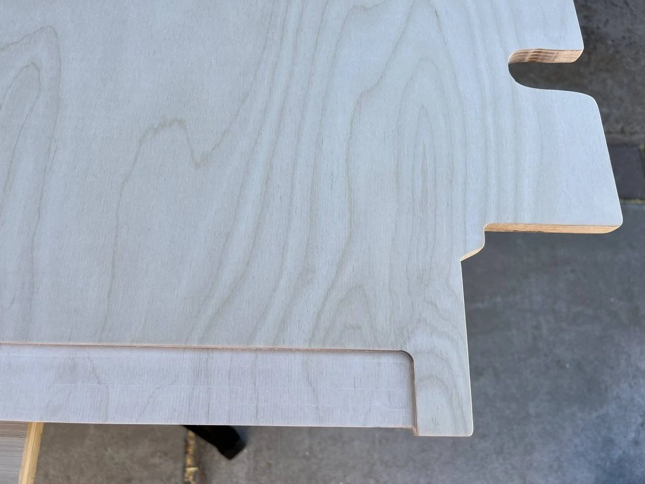

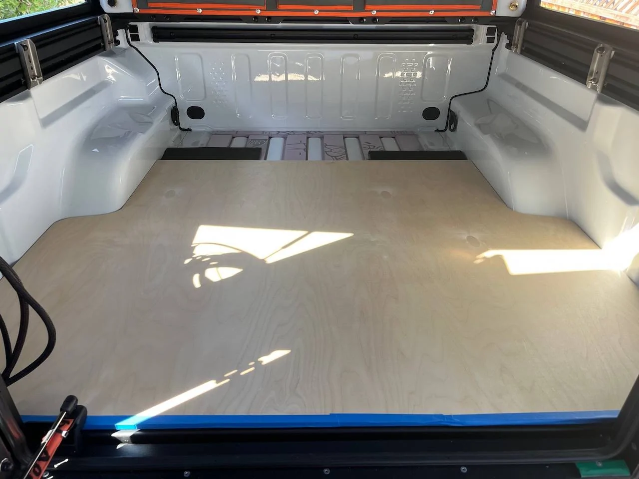

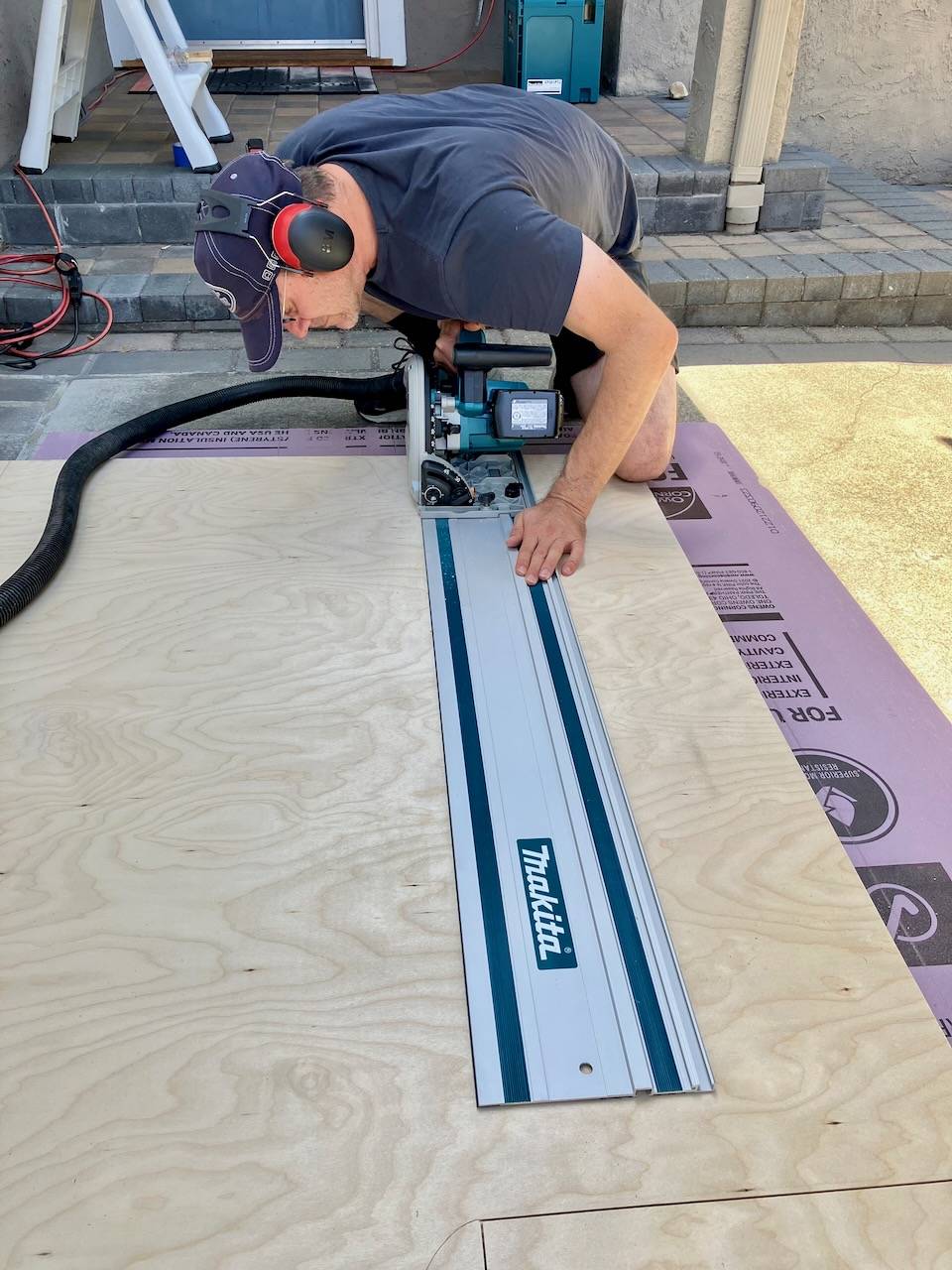

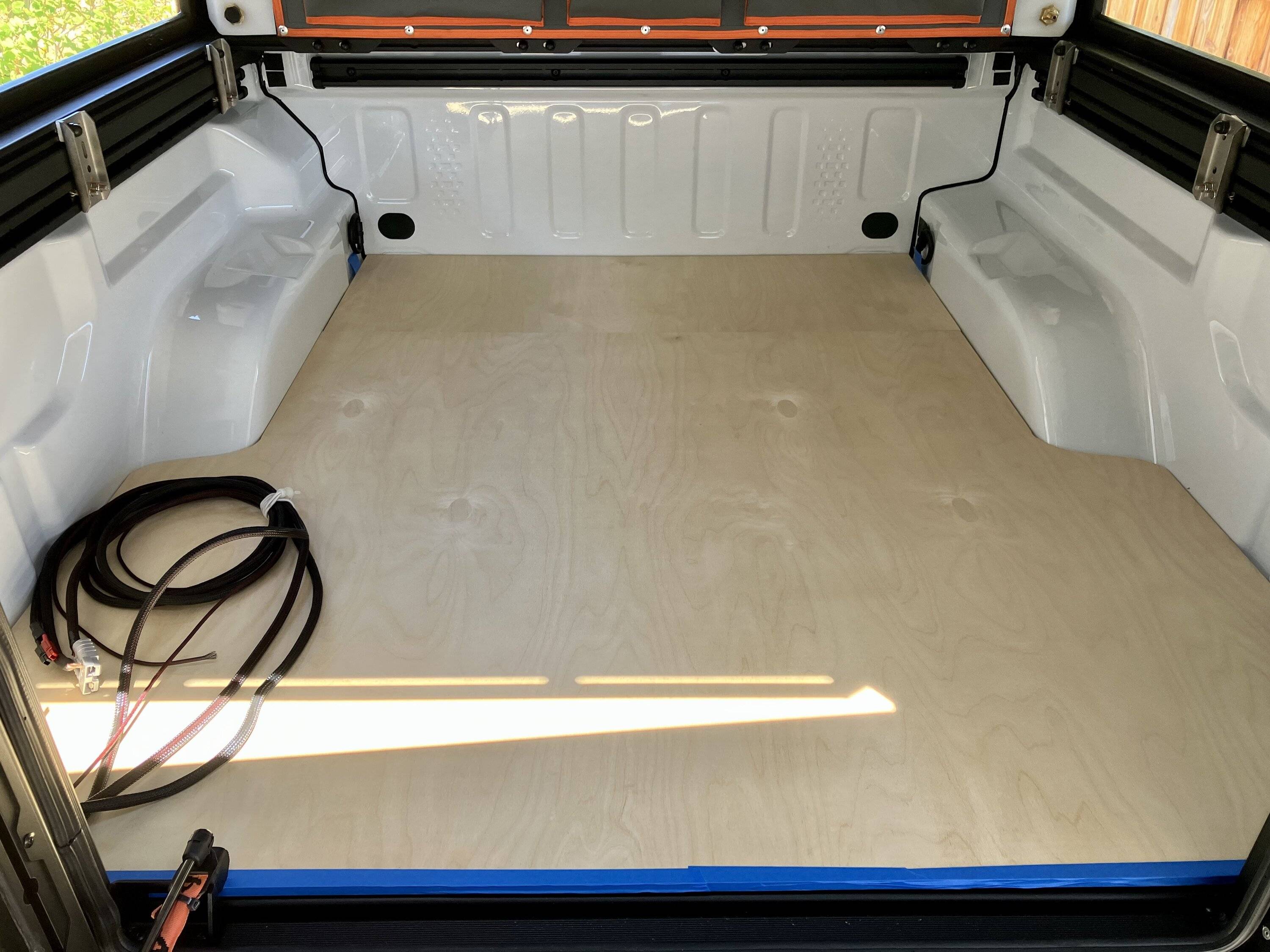

Progress, slow, but steady. Rented a U-Haul today to buy some lumber and foam board (as a "saw station), and started the bed plate build.
Transferring template to plywood (Baltic Birch, 12mm):
Jeep Gladiator A new hope ... (build journal and component reviews) IMG_5608
Cutting:
Jeep Gladiator A new hope ... (build journal and component reviews) IMG_5665
Adding a groove for a rabbit joint:
Jeep Gladiator A new hope ... (build journal and component reviews) IMG_5669
Finishing touches:
Jeep Gladiator A new hope ... (build journal and component reviews) IMG_5609
Fits well:
Jeep Gladiator A new hope ... (build journal and component reviews) IMG_5613

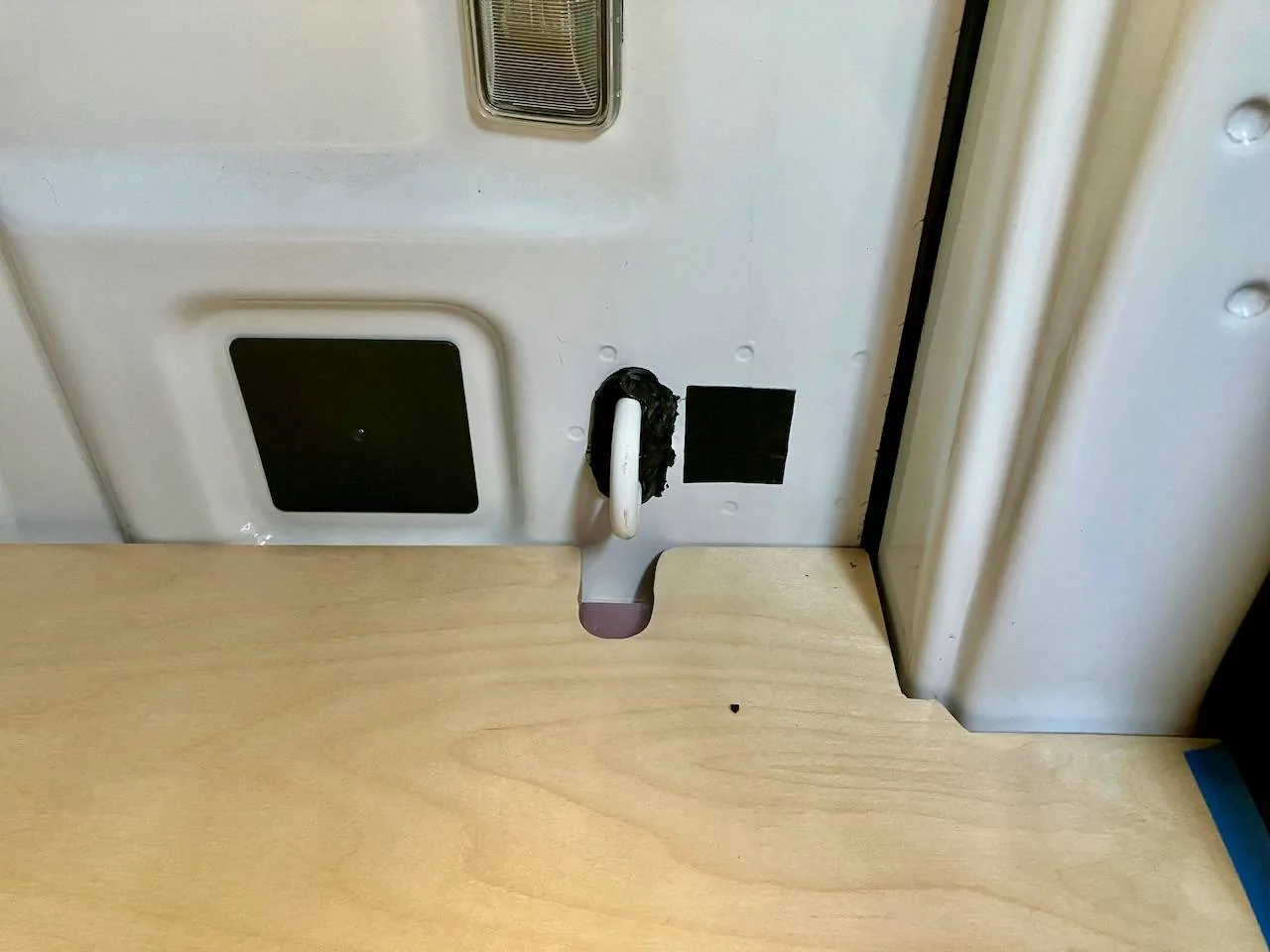

Had to make a cutout for the cargo mount point:
Jeep Gladiator A new hope ... (build journal and component reviews) IMG_5672
Overall, super happy how it turned out so far. Tomorrow, we are adding the board for the small space in the front (couldn't fit a full base through the side hatches). The rabbit joint (overlapping edges) will be hidden under furniture, I'm not even going to bother to connect the two boards, the pressure fit and the furniture will take care of that.
Next steps:
  • Cut the small board for the gap at the front, add an appropriate edge to fit the big one, cut some material away on the underside for the slightly elevated areas in the front corners of the bed.
  • Build a countersunk "step guard" towards the door. I have some aluminum here I'm planning to use there, so that we don't damage the edge of the plywood at the door.
  • Cut away a small groove where the door catch is. The board fits, but just so. I might cut away about 2mm in the shape of the metal part there and smooth out the edges. Makes for a nicer look and better fit. The step guard will go from about there to the other side. Don't yet know whether to make asymetrical to cover as much plate as possible or to make it symetrical for a nicer look. Will decide tomorrow or Thursday.
  • Round out some of the corners for a nicer fit.
  • Once it all fits nicely, get some teenuts into the bottom of the board to attach furniture to it. That'll also help to get the boards out, since once the gap is filled, this will be difficult.
All this should be finished tomorrow, depending on whether I receive the screws to mount the step guard. If not, not a big deal, it'll definitely be done this week. We will finish the surfaces once we have the holes drilled for the teenuts and are reasonably certain we don't have to keep taking the floor out over and over ...
So far, we only had to take it out two times: didn't quite fit on the first attempt, fit, but could be better on the second, and cutting a chamfered edge towards the rear of the wheel wells and sanding away a bit of material around the cut out shapes in the rears, it fit on the third attempt. Not too shabby.
It all takes so much longer in the driveway than it would in a nice shop, but I just don't have the space for one, so have to make do.
Overall a good day.

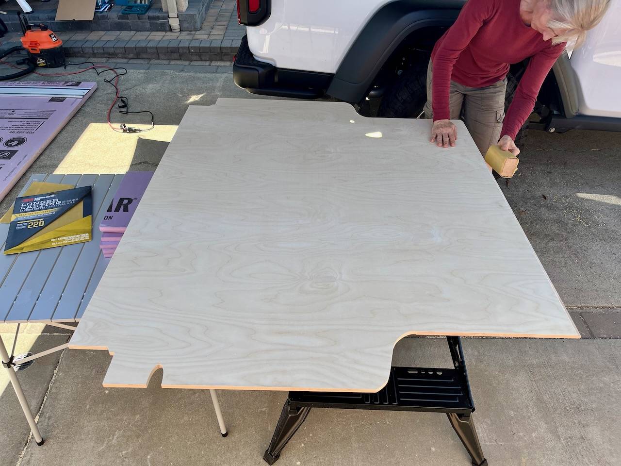

Bed plate cut and fitted:
Jeep Gladiator A new hope ... (build journal and component reviews) IMG_5683
With the plate as a template it would be much easier and faster now, but this one took quite a bit.
