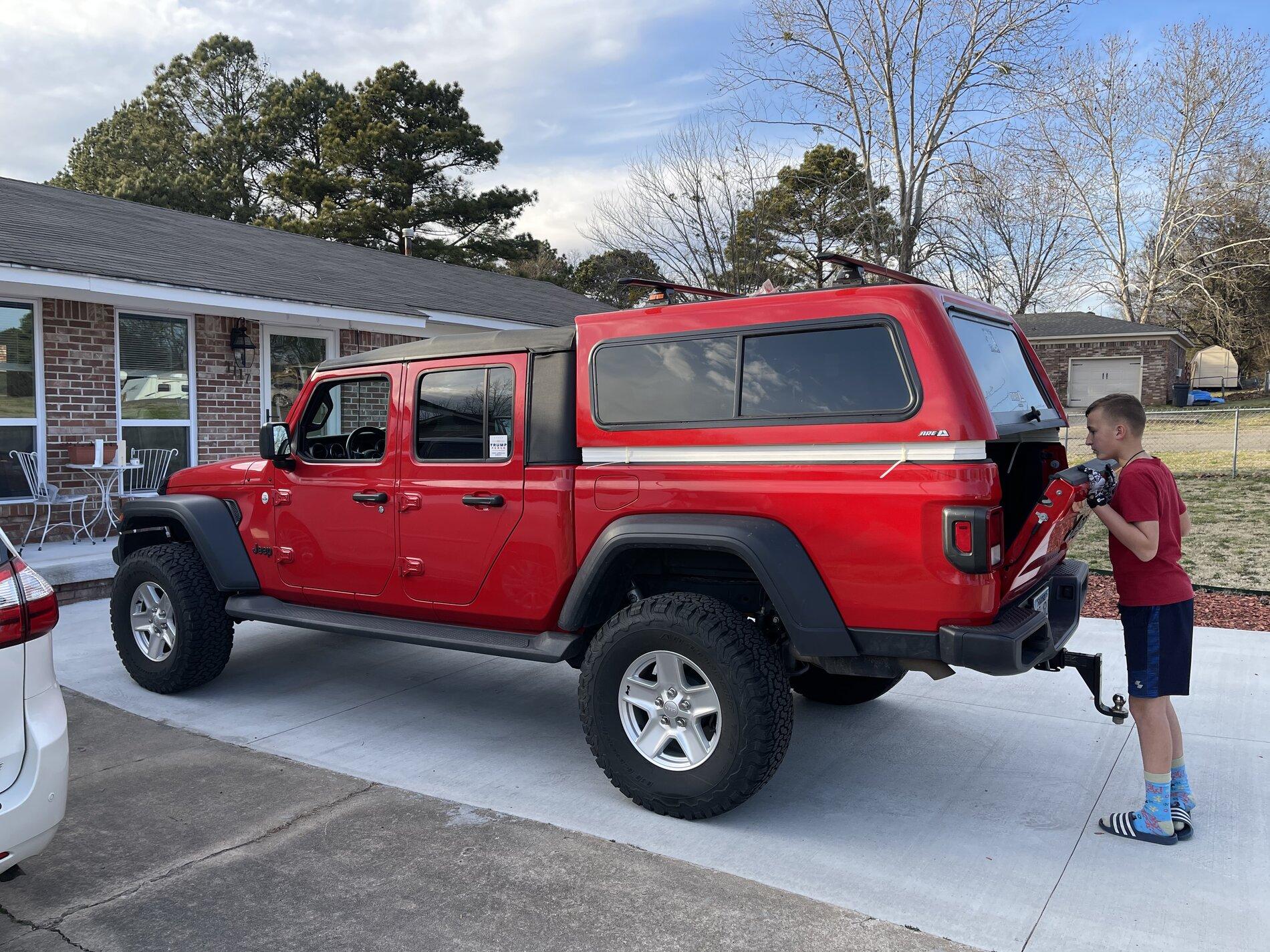

I propped it up with PVC boards. I cut them to match the shape of the bed rails. I used three and a half of them (I used a planer on one board to get the height of the lift right) on each side.
Jeep Gladiator A.R.E. Camper Shell With Soft Top Gladiator 24593FC0-0D2C-463E-B9EA-2B2C0F3732B1
I put a 4 bolts down through the shell, boards, and truck to fasten it down.
Then I covered the boards with red plastic.
Although, I may replace the plastic with something else. It’ll depend on how it holds up to the Arkansas Summer Heat this year.
I still need to attach a small strip of plastic to the back window so that it overhangs the top of the tailgate.

So I take it that the soft top doesn’t work at all without your modifications? I would like to run the ARE topper but using the soft top is a must.
Correct. The only fiberglass toppers available right now (that I know of) were designed for hardtop Gladiators. The soft top sits 2-3 inches higher than the hard top.
Your two choices with the A.R.E. topper are either raise it up or modify the front of it to match the contours of the soft top.
I chose the easy route and just lifted the topper.

If the soft top sets higher why didn't it work?
JaxMax is right. The front of the topper has a contour that leans forward. You have to either slide the topper back or lift it up if you want it to match up to the soft top. The problem with sliding it back is that it'll overhang the tailgate by a few inches.
Lifting it up isn't so bad because I benefit from a few extra inches of top end room in the bed.
