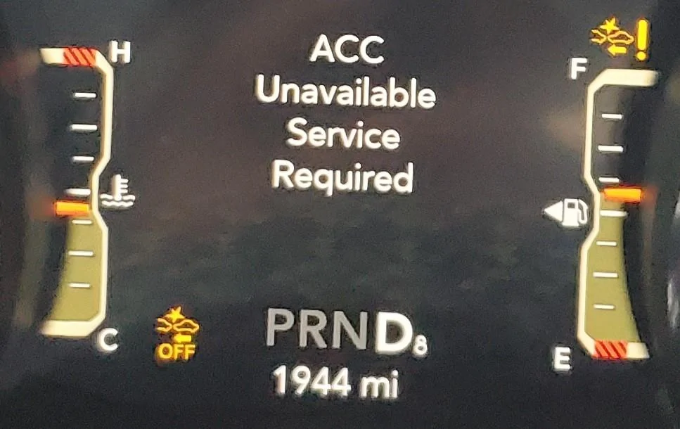

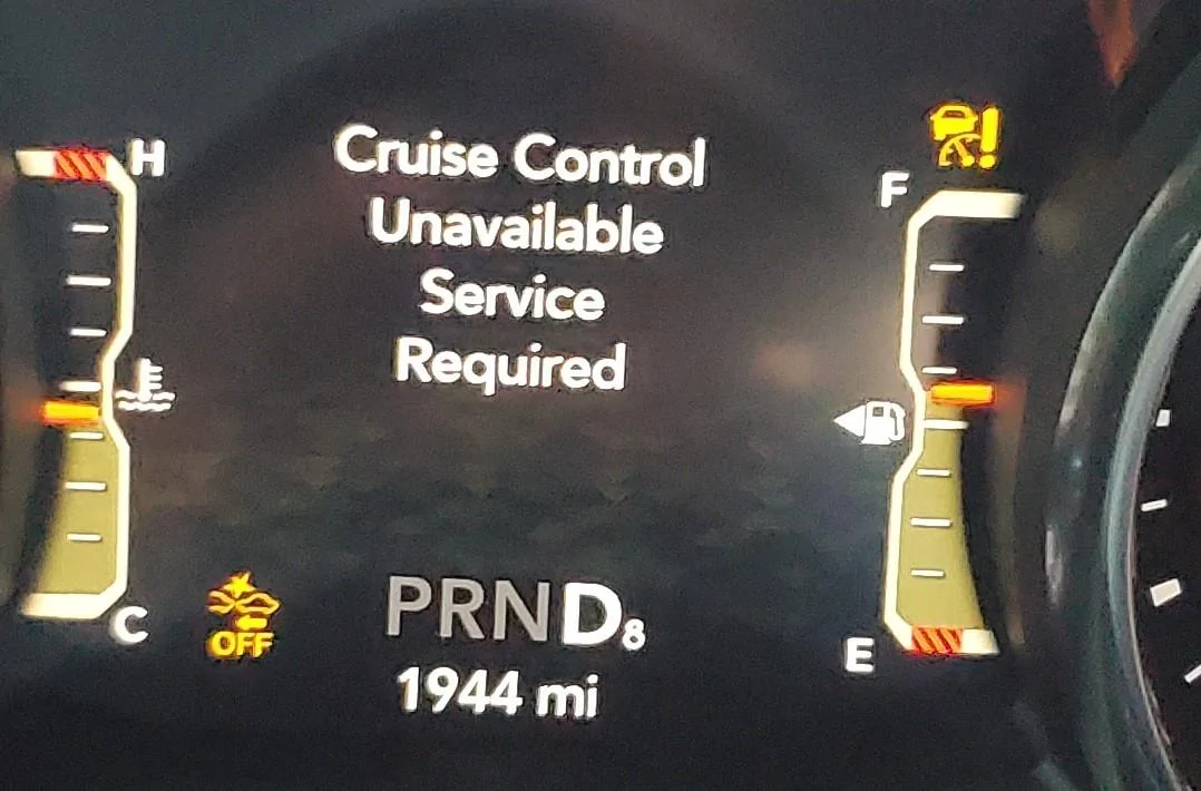

About 3 hours into a 4.5 hour drive I noticed the icons indicating that both ACC and Cruise was unavailable. I tried to use both and received the messages (below) on the screen. There seemed to be no other engine/electronic issues with the ride. I had not used cruise through this trip, although have used both the ACC and cruise without issue so far.
When I got home, it seemed to clear after starting the car back up, although I only backed up in the driveway.
Anyone have any feedback or experience on what this might be? (electronic gremlin, sensor issue etc.?) I searched this forum and the JL forum, but didn't seem to find anything relevant.
Thanks in advance!

I had that happen while driving down the highway. Someone cut in front of me and set off the FCW while the ACC was active. It disabled ACC and standard Cruise Control, but cleared when the truck was turned off and restarted.

I had that happen when my windshield was super dirty over the sensor. Cleaned it and have not seen it sense

I would think that if the FCW kicks it still should return to normal operation maybe after a timer or some other event happens like cycling between brakes and throttle. Seems like a software bug to me but may just be a safety feature. I would suggest asking the dealer about it at least and let FCA provide a reason why it behaved this way. I can also see something on the windshield causing the issue as well.

I didn't have the FCW kick in prior, but I agree with Shootist in feeling that even if it did happen it shouldn't render the system limp until restart.
I am definitely going to clean the windshield because perhaps all the bug splatter messed with it.
Even without cleaning it has resumed normal operation after restart and I have since been able to use the ACC/Cruise without issue.

Doesn’t sound like dirty windshield to me then. That light never went away until I cleaned it. But it was solid covered also with dirt.
