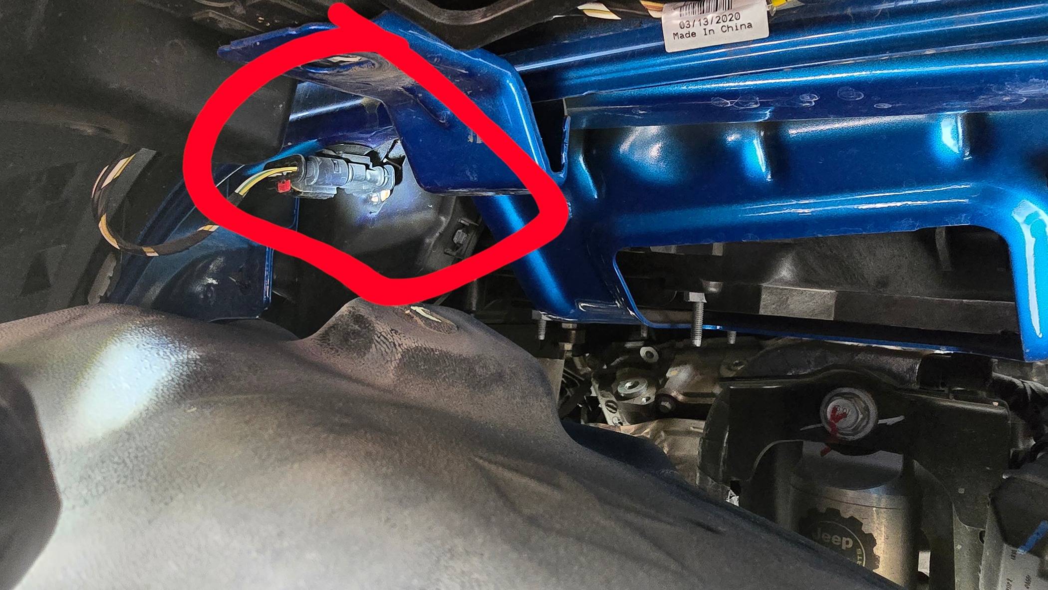

What style? Wire taps in general are a potential future point of failure in automotive wiring, especially for exterior wiring.Just going to use a tap.
T taps. I've had them running in various vehicles (external use) for years. I might paint them with some liquid tape since it is a jeep. all taps are above the air filter, so if that gets submerged, I have bigger problems.What style? Wire taps in general are a potential future point of failure in automotive wiring, especially for exterior wiring.
It is. When I need to access that one, I remove the fender flare and liner as an assembly. I just buy white fender clips in advance as I usually break half a dozen of them.This connector was a PITA...
I popped it off the holder and one wire clip in the fender and pulled it into the engine bay. Never again (until I get rubicon fenders - some day)It is. When I need to access that one, I remove the fender flare and liner as an assembly. I just buy white fender clips in advance as I usually break half a dozen of them.
