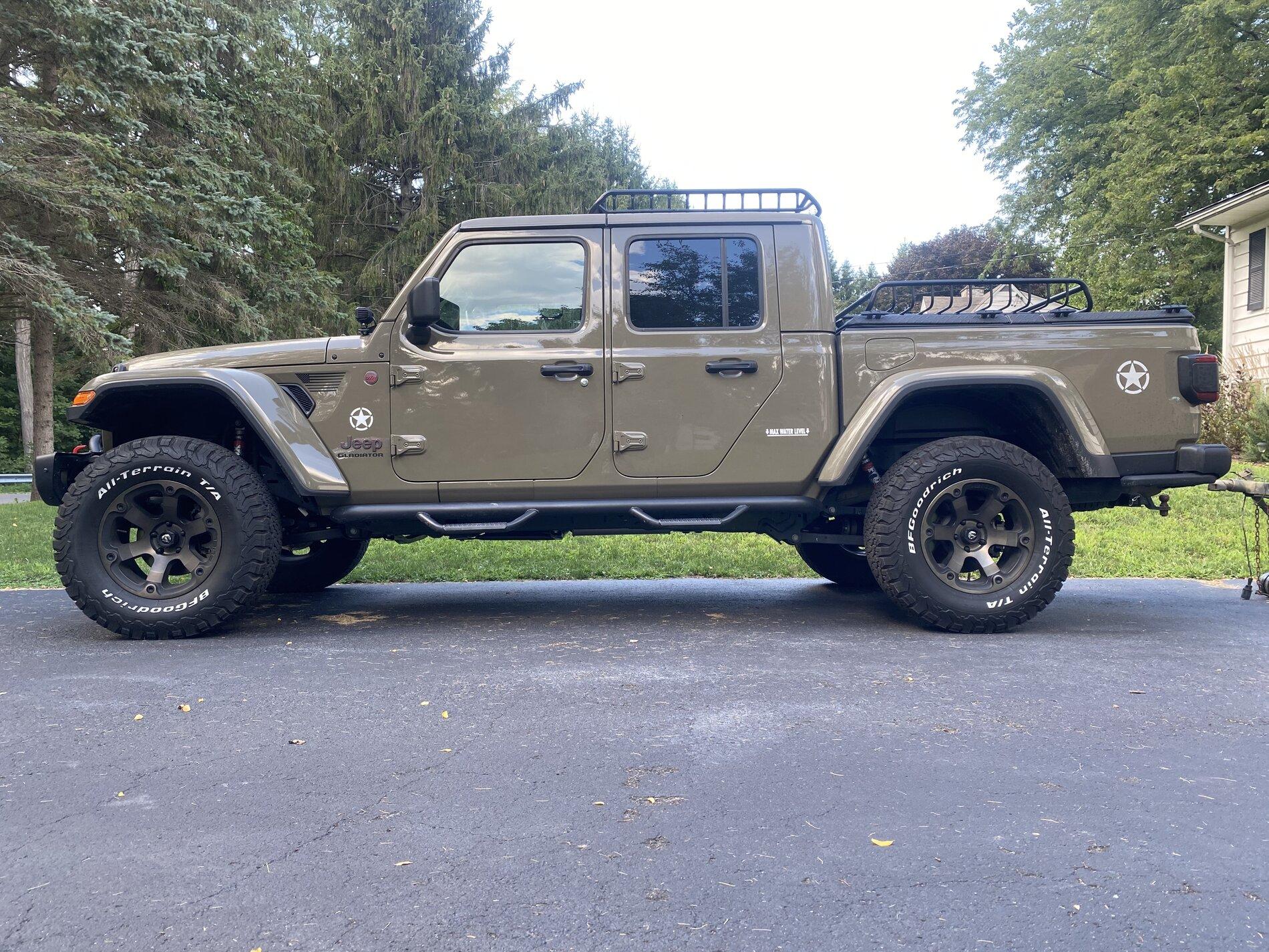

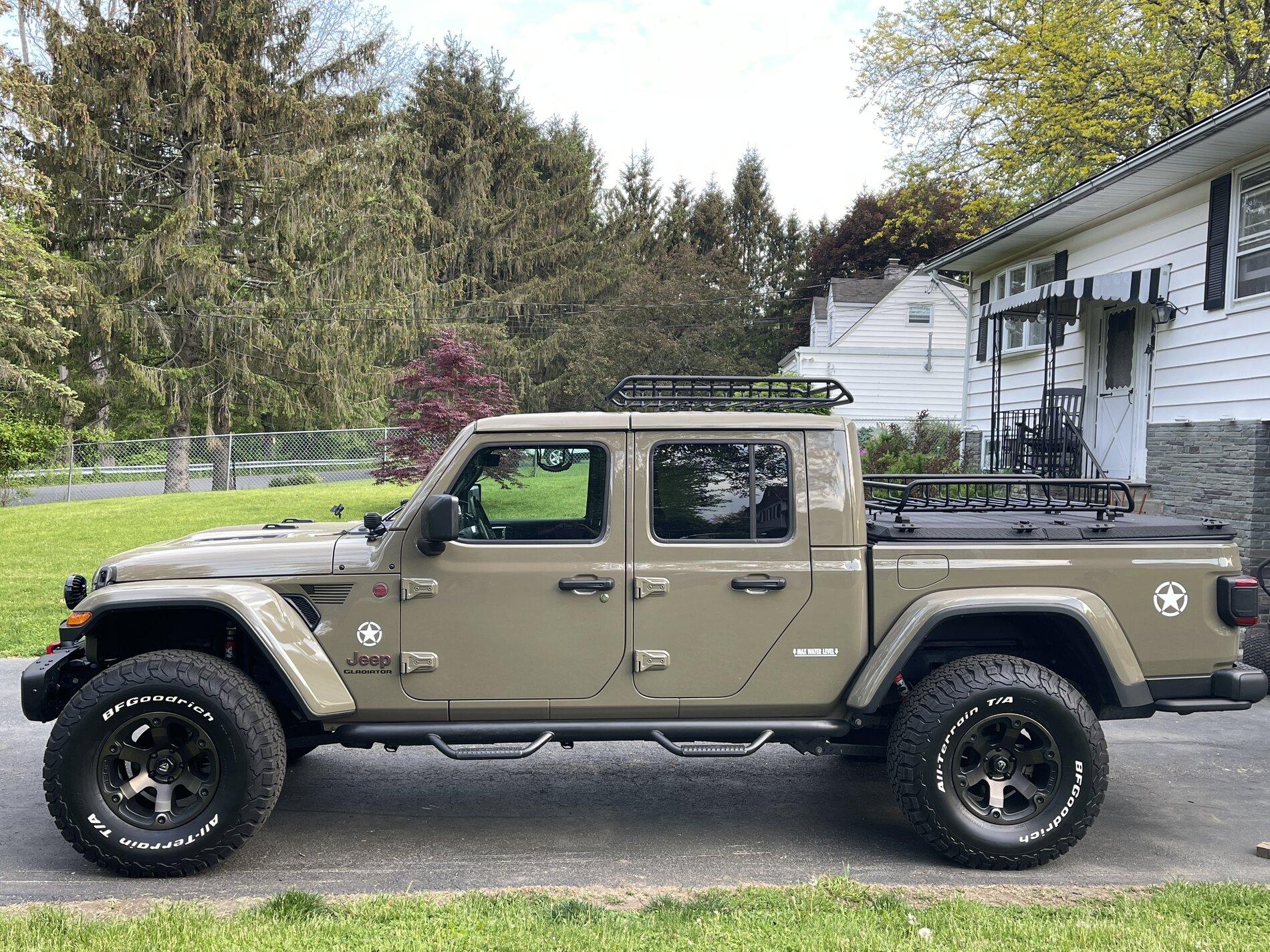

Mine has a 2" iron rock lift. 4:10 gears and I pull a 20' bass boat with a dual axle trailer. Total weight is probably 3K lbs. Tomorrow is the first tow with the 37's so I'll find out how it reacts compared to the 35's. I'll admit there are a couple good hills that my truck has downshifted way down on and I can really feel it back there. Open rolling on flat and small rollers hasn't been a problem at all. I'll update tomorrow. I also turned the gear indicator in the dash on so I'll see how low it shifts down to on the big hill.

I just sold my like new 35" BFG all terrains and rolled one alongside my 37" BFG currently on my truck. Side by side damn near identical I mean you had to get at eye level and look across the tops to see the difference. Amazing how much they drop when the trucks weight is on them. My conclusion that the level off the top of the tire method reveling 35" was off and reflected in my Taser setting speedo not matching hand held GPS on highway. I had to go to 36.25 in order to match the GPS, not 35 which the level method told me.
