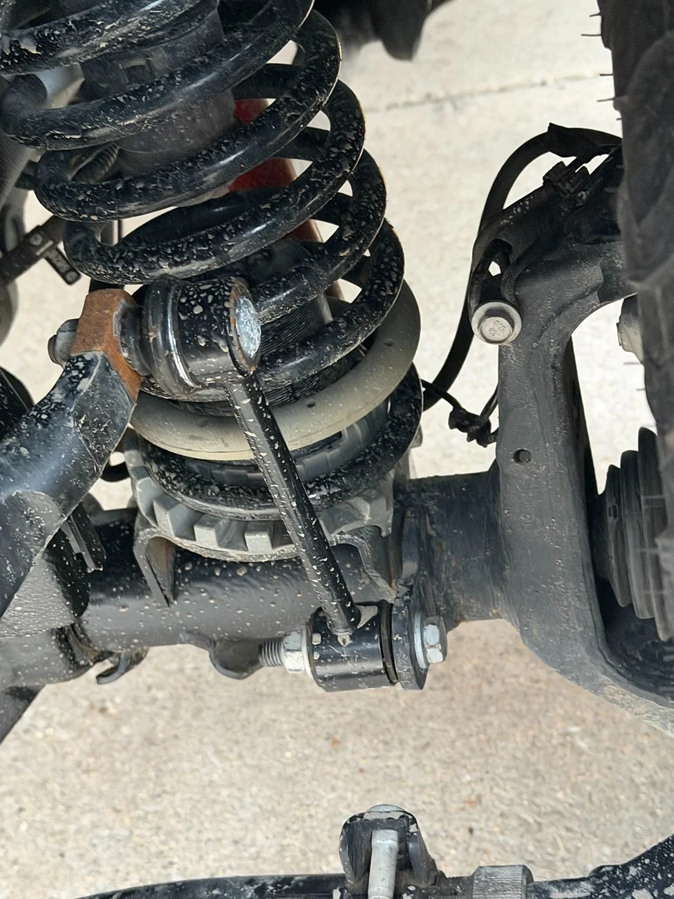

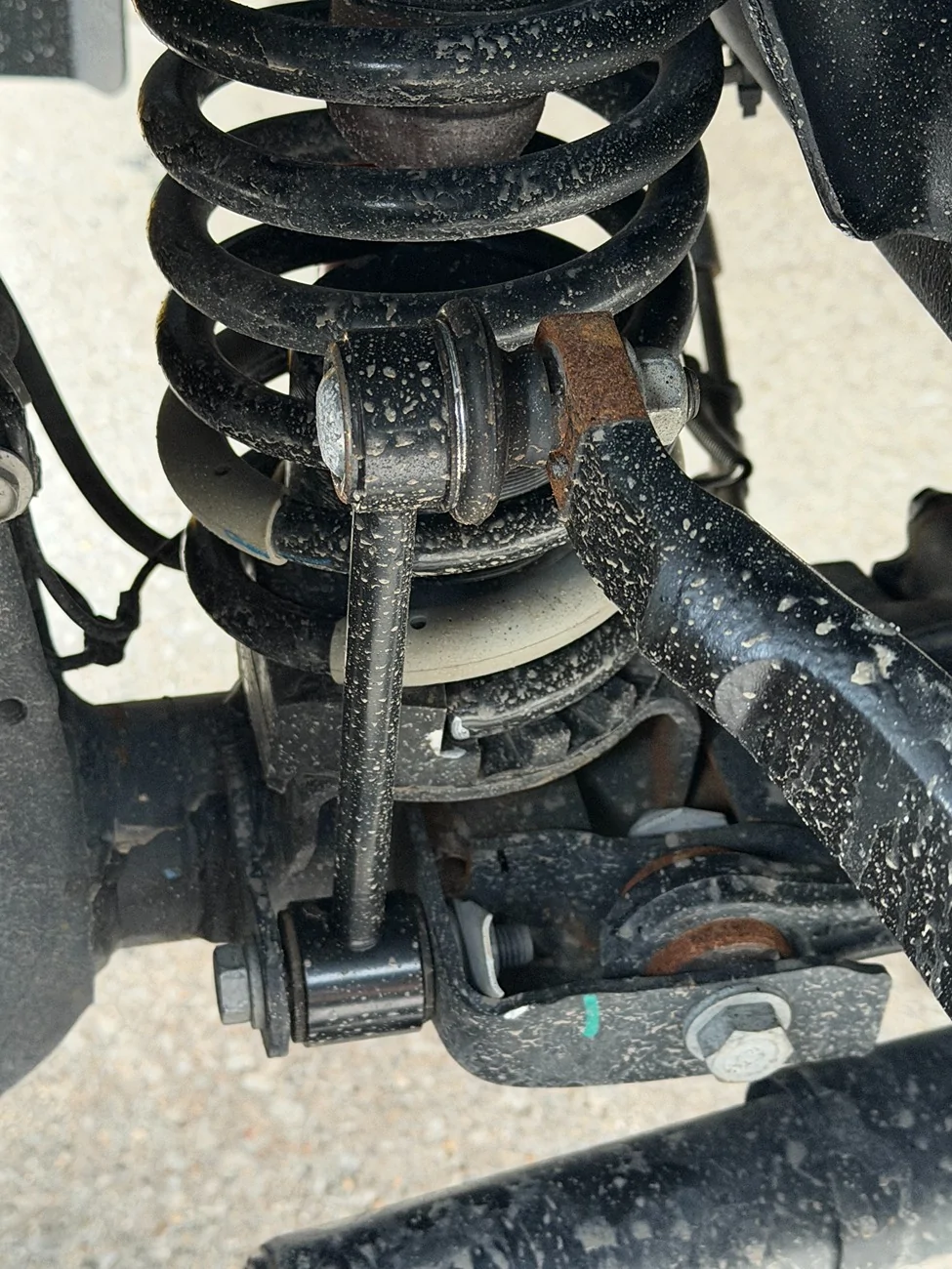

Hi, Good day to Gladiator Team,
Quick question for the suspensions guys who know what is going on....
Can you look at the pics and... tell me if am i seeing something wrong after shop gave it to me back..... Left coil looks bit not even on the bottom toothy holder...
Jeep Gladiator AEV 2" after install.... LEFT COIL
Jeep Gladiator AEV 2" after install.... RIGT COIL

have you thought of bringing it back to the shop and asking them?

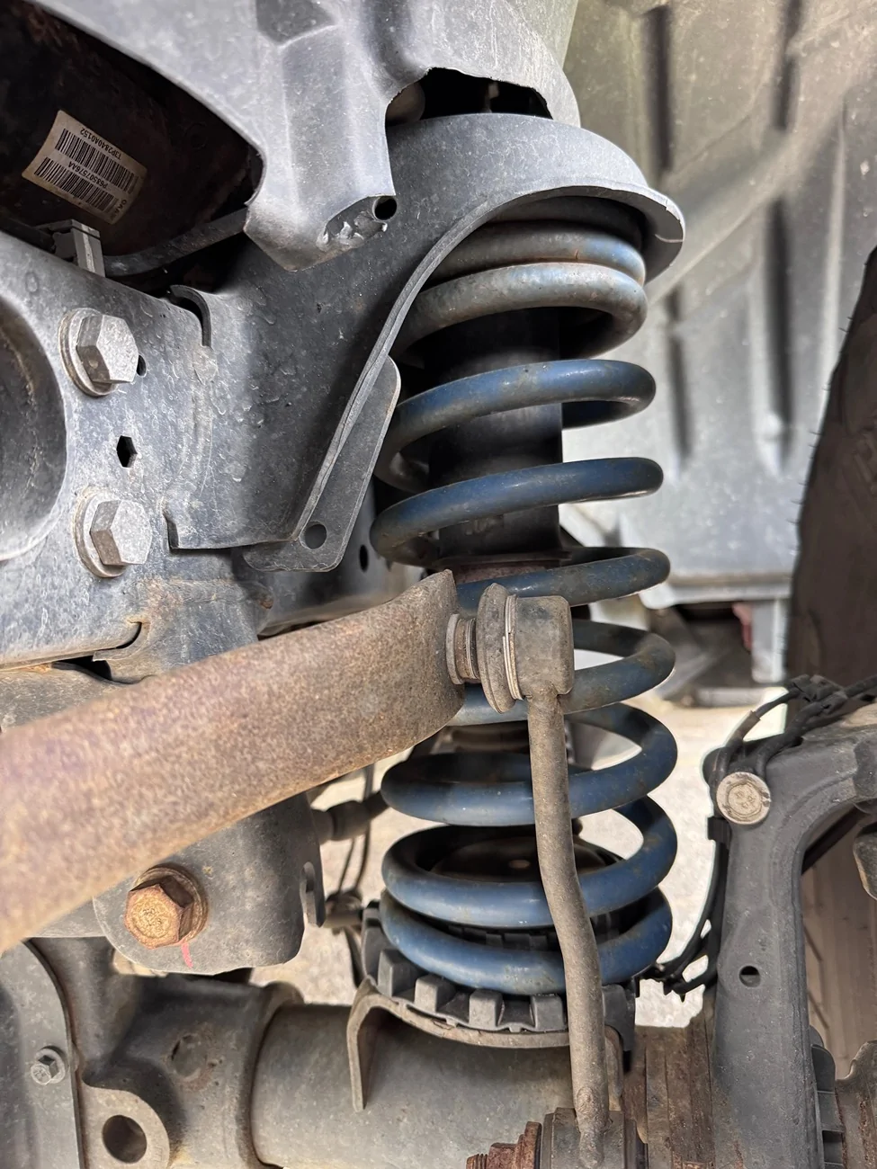

Here is mine for reference. As long as the end of the coil spring is seated against the notch of the rubber spring isolator, you're good. Or are you referencing the outward bow?
Jeep Gladiator AEV 2" after install.... IMG_8028
yes, but before, i value and respect experts here more than in the shop :) and i do mean it.... also learning experience for less experts (e.g. me) or others who feel the same... :)
looks exactly like yours so... how many miles on such setup so far?
First check if the front wheels have the same amount of distance from thd top of the spring tower to the edge of the wheel.
If this was an AEV spacer kit this fix is an adjustable track bar and Tera Flex and or Rock Jock coil correction pads for the bottom of the springs . Trust me this will solve 99% of it.
