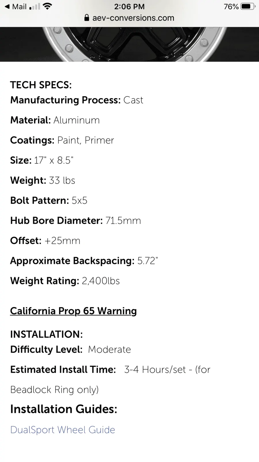

Huh ? Pretty sure all Borah’s are are 17’s and 80% of JL’s and JT Gladiators are 17’s
Lid, your reply was very appreciated. My mistake. I was thinking of the Salta wheel manufactured by AEV.
Has anyone mounted them on the Gladiator? It was designed for the JK Wrangler. Curious how it looks with the offset and stance mounted on a 35” AT

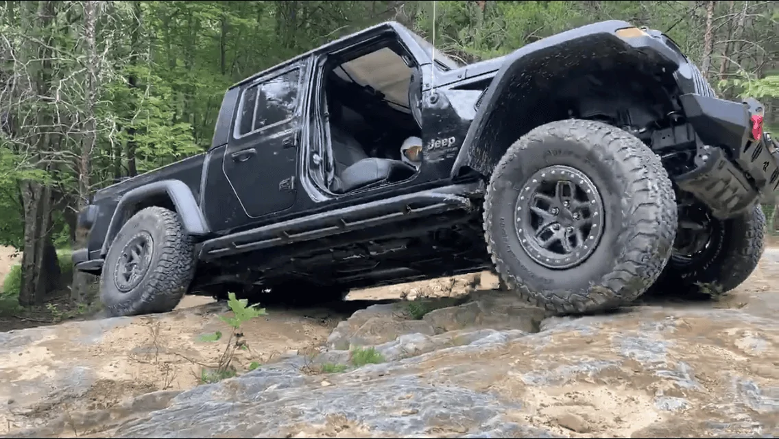

JL/JT Onyx Borah with silver bead lock ring and 37x12.5 Milestar M/Ts being assembled this weekend for my White JT....photos to follow...
I read in the AEV forum that there is a Salta redesign coming soon with correct JT/JL offset. No pics were posted though.

I am looking at the exact same tire's with the AEV Borah wheels. How have you been liking your setup.
See post above about mounting. The mounting lip on the Milestars are a bit angled. Actually ended up trimming them straight with a razor which helped mounting tremendously. Other than that fiasco, I love the setup so far. So far the tires have done very well in anything I've put them through.

The AEV Borah machined finish for the jk is $204 with the hardware kit.
I have the max tow and wonder how it will look with that specific backspacing....I don’t want it to stick out too much.
If I remember right thats a +4 offset.. Thats going to be hard to tell apart that stick out from all the many many 0 offset wheels all over the forum. I am going to pay the extra to get the JL version with its +25 offset which is in total about an inch narrower on each side compared to my current 0 offset wheels that stick out farther then I prefer

I should have mentioned that the mounting issue is ONLY if you are using the real bead lock rings. Traditional mounting is fine.
I wanted the JL offset also. In my opinion they fit perfectly under the flares. I did not want 1/2 the tire sticking out on the sides.

I have JK Borah’s in Galaxy Black on 285/75/17 Nitto’s on mine & they only stick out a little & have plenty of clearance with brakes these Trucks have really big brakes. I hear pintlers for JK have clearance issues. I have no lift & no issues
I like the way they fit. What is the Offset on the wheel?
