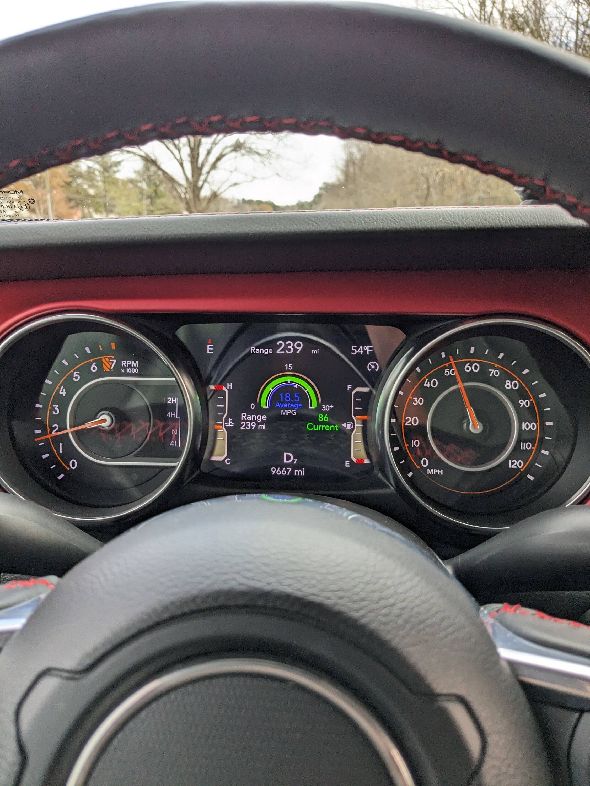

Well, with 37s, no re-gear, I'm getting great gas mileage still and cruised at 70-80 on the highway. The AEV procal snap for recalibration and shift point change....and the BFG ko2 are very light, and a little narrow, so not a lot of drag on the pavement....
Things to consider...
Or just go spacer lift and 35s....just couldn't do 35s when almost all of them weigh the same,....
It worked out. Good luck with your decisions...
How bad was the AEV procal install?
