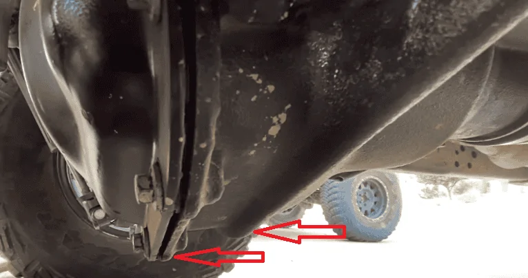

Remember - it's not just about blunt force impacts on the front of the cover - not peeling one back on the bottom edge is just as important. Brad from Trail Recon peeled back the stock cover on their van doing some mild overlanding. Ruined the whole rear end on the way home not noticing it was leaking (and eventually out of fluid).

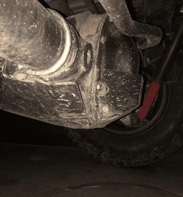

Silverator ,Wildhobo went with Next Venture Diff skids, check them out and you will see why the stock covers are good to use. The cost is a lot but you have to compare to guys buying diff covers and skids, and not buying a cover. They also protect the u joint a bit, you should probably not go to their website, their belly skid is to die for, bumper options are nice, and they are stepping up to protect Moab with giving a percent of profits to stop future closures.....Jack
Thanks - appreciated! Unfortunately, too late on the warning not to go to their website. Haha! I've already been there, and have their belly skid system on "my list". Again, thanks for the info! Cheers,
Also, profits to help protect Moab is a HUGE bonus!!!!!!

Thanks for the info. If you don't mind me asking - what diff skids did you go with? I'm on the hunt and can't seem to find a lot of info on them.... Cheers,
Next venture motorsports. The only company that protects the pinion.
